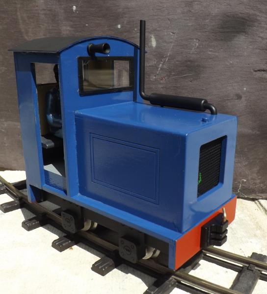

Since I haven't seen many examples of the Busted Bricks loco about I thought I'd post a pic of ours. There are a few imperfections, but overall I think it has turned out quite well.
Click to see full size image
Its got a few additions when compared to the stock kit: a horn, exhaust, brass buffer beams at the front and back with milled couplings, a little filler cap and a seat and raised floor in the cab. It has also been fitted with a reversing switch and we are wanting to fit a small DC jack and rechargeable batteries so the top will not need to be removed when the batteries are discharged.
Overall I think its a great kit, really well put together instructions and the slot construction makes it super easy to get everything aligned. The mechanism runs very well. Especially for the price its hard not to recommend this kit.

Post by steamie1 » Sat Jun 22, 2013 5:16 pm
You have made a smashing job of that well done..

Post by Chris Cairns » Sat Jun 22, 2013 5:39 pm
That has come out very well. Well Done.
As you know Michael sold off the Garden Railway business to HGLW who have yet to re-introduce them, and I see also that the rest of the Busted Bricks web shop has now closed as well.
Let us hope that HGLW will re-introduce the budget Garden Railway range soon, and even expand it.

Post by metalmuncher » Sat Jun 22, 2013 6:19 pm
I do hope that the HGLW expands the line-up of the budget garden railway stock. I think the design and aesthetic of the stock is fantastic. Michael's way of having the bearings slot into the side members is an excellent idea, I might try it if I decide to have some more custom stock laser cut.
And thanks for the kind words.

Post by metalmuncher » Sat Jun 22, 2013 6:40 pm
The horn was made on a lathe out of brass, with a small screw and nut to hold it to the cab. The exhaust is some metal pipe and plastic bent and shaped. The little filler is also a small bit of metal shaped on a lathe.

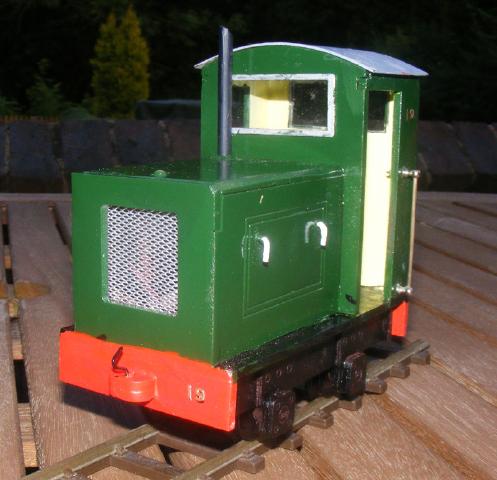

Post by MDLR » Tue Jul 09, 2013 11:28 pm
Got mine finished this evening...................

Post by metalmuncher » Tue Jul 09, 2013 11:35 pm
MDLR:85802 wrote:Got mine finished this evening...................
I really like the handles, nice work. :)
