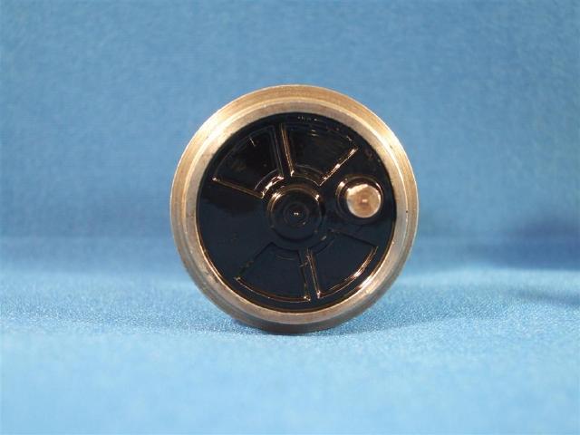

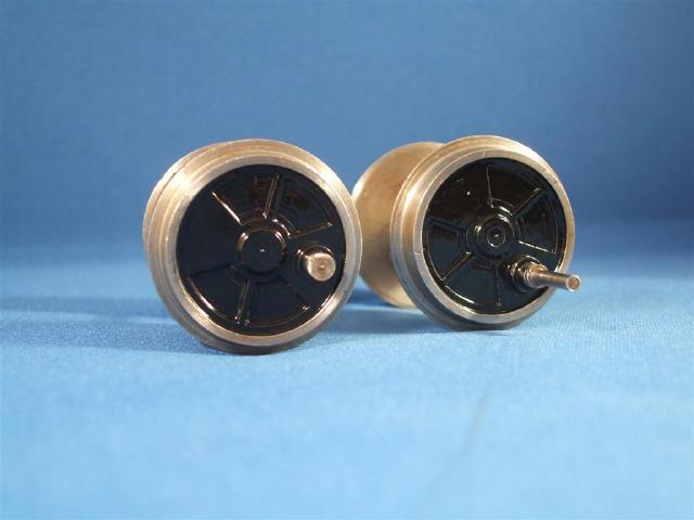

Thought I would post some progress with another little Mamod project I have on the go. This is the status of the steel wheel inserts to dress them up a bit.

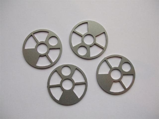

4 no. wheel inserts laser cut from 1mm steel
A pair of plain steel upgrade wheels - now improved

The wheel set I have used for these is a bit of an odd one as they are quartered opposite to the DS chromed ones. They are though, for all intents and purposes, identical to the DS ones. The chroming of the DS ones means that my CAD drawing needs some very minor tweaks. As I want the inserts to be an interference fit I am making a revision to the design again before I offer them to anyone. For these ones I had to get a small round file onto the connecting rod pin hole as it was a bit too tight to press in.
I would be happy to supply these inserts to others when I have the product right. I think it will be a mater of only a couple of weeks. I will update the thread accordingly when I get them fitted to the DS wheels (I have a couple of recently purchased sets to try them on).
I do have some IP wheels on my 0-6-0 and these inserts WILL NOT fit these wheels - they need a different design unfortunately.

Just had another look at your photo of the fitted wheels. It may just be the lighting but looks like the driving wheels do not have a balance weight opposite the crank pin, whereas the trailing wheels do.
It's just the effect of the lighting. All the inserts have a 'balance weight' opposite the crank pin. Below is another couple of pictures.
There is small white fleck on the drive wheel - a bit of fluff or something. I accept the paintwork could be better :D

Post by Superbiker_uk » Sat Dec 01, 2012 3:48 pm
First take some Dream Steam aftermarket steel wheels for your Mamod loco:
You will also need a set of 4 x 1mm steel laser cut inserts:
You can then insert them into the wheel recess and paint it black:
Or you can paint the wheel recess first (I chose black again) and then inserted the the inlay in plain steel:
I prefer them black. What do you think?

those wheel inserts make the plain sided upgrade wheels look a millions times better. I have a few questions though...
what is the diameter of the inserts?
And when fitting the inserts is it an interference fit or do you glue them on the wheels.
Sam

To be honest Doug, the cutting is the easy bit (for me) as I send them to someone else to laser cut! The hard bit and the bit that has required some investment - time and money - is the CAD drawings. I have purchased AutoCAD LT and had to learn to use it to get these parts made. I started with the coal bunker then the half cab back variants including one with working coal hatch. I then progressed onto these and am working on a few more bits and pieces. As to the Caledonian style stars - I am not sure my CAD skills are up to it yet but if the item can be drawn then in prinicipal it can be cut. You just need a good CAD file (.dwg) first. Looking at your link to the photo of the Caley 123 I will see if I can draw the star up in CAD.
Well Sam - I make these inserts with a diameter of 26.25mm
The inserts are an interference fit. The wheels are not all exactly the same so some very slight filing - I use a Dremel - is required. It is then a simple job of pressing / tapping them in with a suitable drift.
