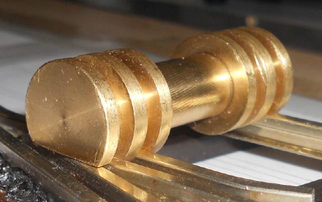

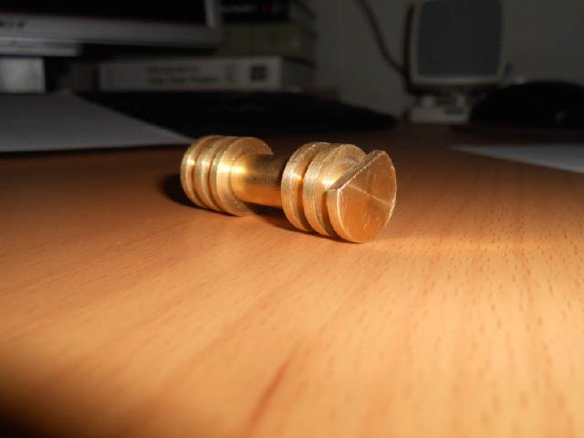

Just a quick follow-up with a handy little tip I got from a 4mm scale track-building book. It can be jolly useful to file a flat on one end of one of your roller gauges, to help with getting the crossing nose in position; this lets it sit over the splice rail and/or wing rail. Easier to show than to describe:

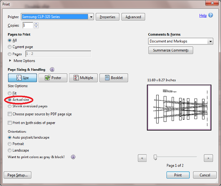

Is that from Dave Watkins' plan? The key when printing these from PDFs is to make sure you have "Actual size" selected under "Size Options". (At least, on my printer they come out spot-on right size with that selected.)

Hi Rchard, I think it was his plan I used, on my printer settings I use 100% this was ok with the points I made but I started the d/slip before I noticed the plan was a fraction under size, the rail gap is near as dam it 32m.m. but the center part is a bit tight to run over. I don't think it will be a problem with a bit of adjustment a four wheel coach ran over it quit well I have yet to try a loco. I will run a test soon and let you know.
