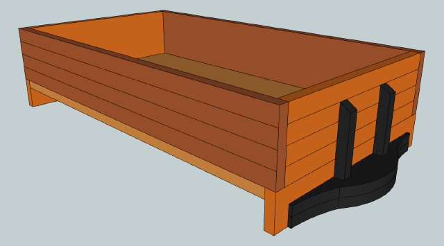

First, I made a CAD model of the wagon in Sketchup, then used an SVG exporter to get SVG layouts for the panels to be cut. Anybody who's seen IP's "Ezee" range might think that this looks familiar. :p
Click to see full size image

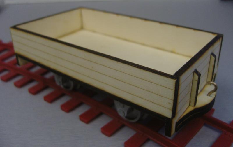

I then modified the layouts and optimised them, and sent the layouts to be cut from razorlab.co.uk in 3mm Laser Ply - it was quite expensive so next time I might try and borrow my schools laser cutter! Although, they did a good job with the packaging and it was shipped to me much sooner than I expected.
A few days ago I received the package and just today I got the open wagon built. I think it came out pretty well!
Now I need some axle boxes and wheels, I was thinking about some IP "Quarry" axle boxes, and 20mm wheel sets, have any of you had experience with these or can recommend some others? Any other feedback or tips would be appreciated too. :)

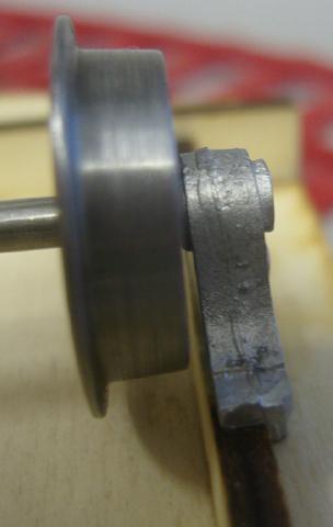

Thanks for the reply, I decided to get two quarry axle box sets and a set of 20mm wheels from IP. We have a lathe so turning our own wheels might be a possibility.
EDIT: Got the wheels and axleboxes today.
You were sorta right about the depth problem, even with 3mm ply there was a little bit of filing I had to do to make clearance for the wheels. My solebars also weren't high enough so I had to file a little away from the top of the axleboxes, but I got there in the end and got a decent first piece of rolling stock I think. :D
