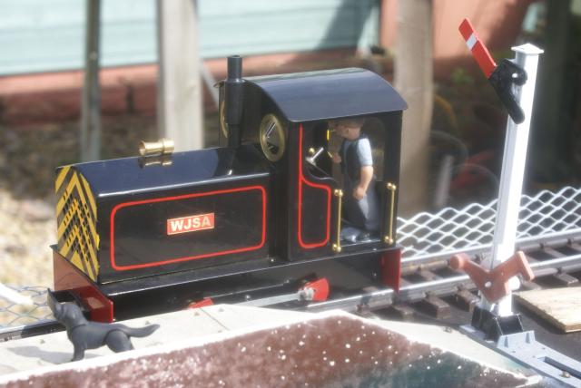

My Danny
Post by mandatrix » Sun Oct 16, 2011 9:14 pm
Having completed a similar Danny I found it went very well with a miniature RC 7.2volt battery as it seemed to last longer than on the multiple AA set up which is supplied.
TommyDodd
Post by TommyDodd » Mon Oct 17, 2011 11:41 am
Smart! Inquiring minds would like to know how you did those very spiffy wasp-stripes.
mandatrix
Wasp Stripes
Post by mandatrix » Mon Oct 17, 2011 11:56 am
It is called " Having a friend who is a Signwriter"
