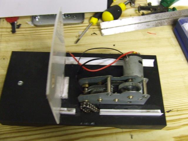

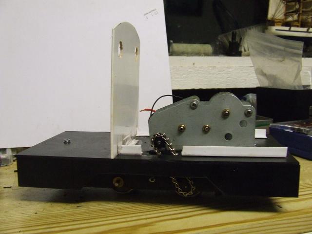

Noels old chassis and motor with a 'modified' gearbox from an old R/C tank! Mr F C decided he wanted it chain driven so that was his idea.
And he wanted me to show you his handiwork with the gearbox!

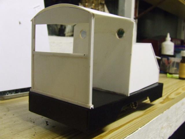

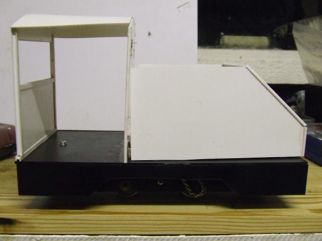

Body work starting to come along now. This is the first time we have worked with plasticard!
We wanted to be able to remove things easily if they went wrong so the 'bonnet' will come off.

I recognised the gearbox immediately, I've got stacks of Heng Long gearboxes about! :lol:
I've kept them all for just this purpose.

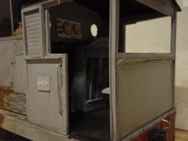

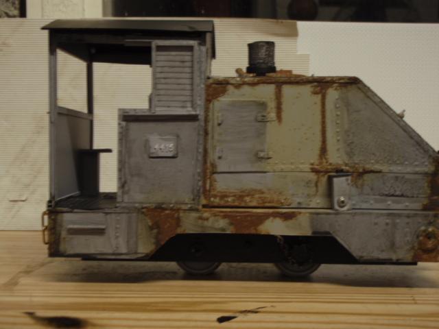

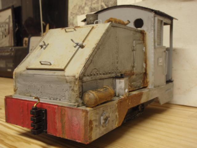

Thank you for the comments chaps! I was a bit worried about the rivets I have to admit and Steve accused me of 'counting them'!!!
There's 2 different methods there. One is 'stamping' out at equal distances the 'rivet' on a thin piece of plasticard with a posi screwdriver! Then cutting them out in thin strips with a guillotine, turn it over and hey presto a strip of rivets. That way it also looks like strengthening strips of metal! Just glued on where you want. But I'll be honest I wasn't particularly happy with those cos in real life they wouldn't all be along 'battening' would they!? So I then decided to 'dobble' (a technical word that one!) some PVA from a toothpick in the appropriate places and let it dry before painting. This way you could build up as much rivet material as you wanted depending on the size of the rivets required!
The really annoying thing was to finish it off and make it look like new and then spend time weathering it so it looks old again! Aaargh! :|
Anyhow here is the more or less finished article, some film to come soon with it running.
Well, we don't think it's bad for a girlie and a blind bloke???! May not be MOTY material but we made it in less than 3 weeks! ;)
Any suggestions for the next project? By the way, this is the first thing we have made totally from scratch (ie no kits) based (loosely) on a prototype! We have named it 'Max Cole' after our friend who died last year. He was also larger than life and a bit different!

Absolutely first rate job there Mr & Mrs F C :D You must be well pleased with the result, especially if it runs as well as it looks!
