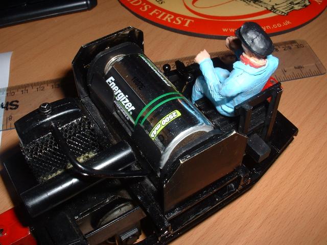

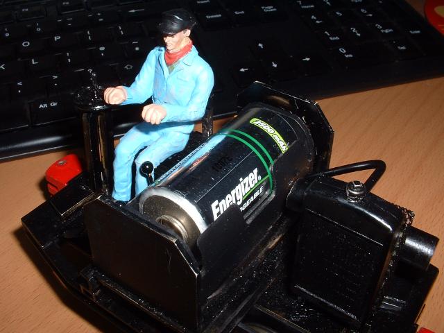

But then I took a look under the bonnet:
It's powered by a single 'C' cell. But isn't that an awful lot of wasted space? What could we put under there instead?
This set off a train of thought that led to the realisation that you should be able to fit in 4 'AAA' rechargeables, one of the really tiny Planet 2.4GHz receivers (the 4 channel ones are quite a lot smaller than the normal ones) and a MicroViper Loco speed controller.

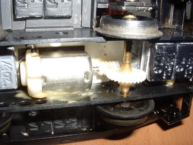

For completeness, here are some views of more of the underneath bits of my current Simplex. Sawn-off Cambrian plastic chassis:
With motor araldited to the frames! (Brian Clarke told me to, in the instructions:)
So that's where the switch is:
