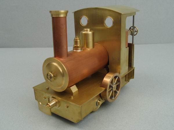

Rather like the idea! I made on on auto desk last year and me and my dad are hoping to build one each this year using two differant styles of bodywork! :) Heres mine...

I reckon that the spectacle plate on that loco needs to be a bit higher :?
MamodFan
Post by MamodFan » Mon Feb 21, 2011 5:44 pm
taliesin001:48695 wrote:I reckon that the spectacle plate on that loco needs to be a bit higher :?
Its just the large over sized chimney that i need to sort out! :)
