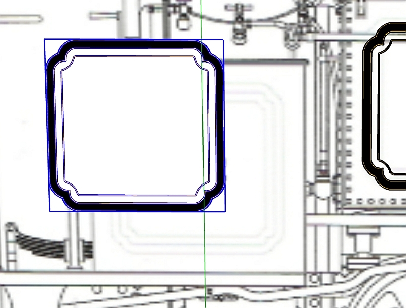

1) I was fortunate that the drawing of the F & B Manning Wardle 0-4-2 in the F & B book includes faint indications of most of the lining, and since I had already scaled the drawing to 16mm scale, all I needed to do was trace over the outlines on a separate layer and save it. If you aren't lucky enough to be in the same position, then you'd have to create a drawing of your lining from scratch.
Screenshot 2025-12-18 12.59.40.jpg (211.3 KiB) Viewed 134960 times

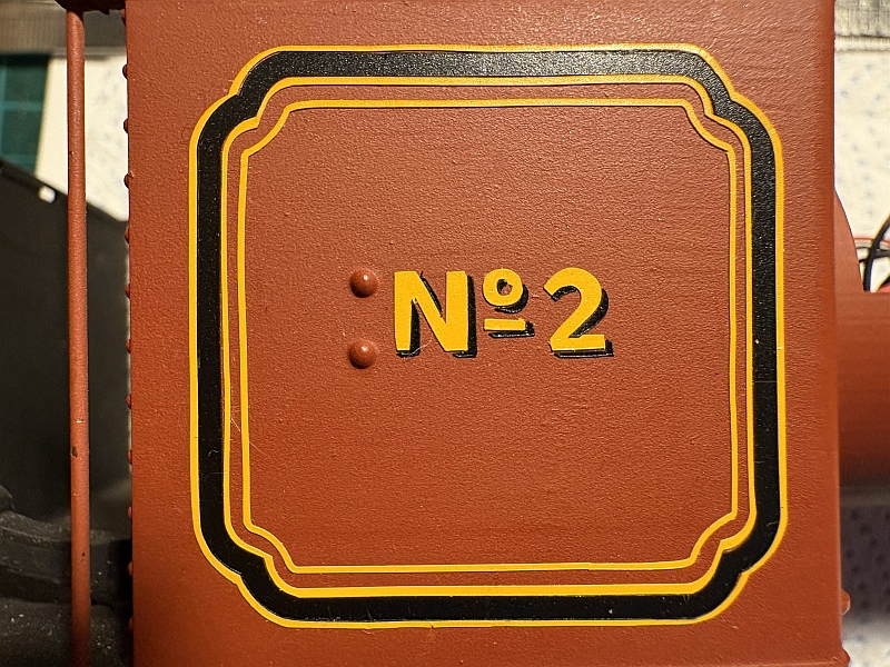

2) The F & B lining is quite complex, having 1.5mm black lines with yellow lines either side and fancy scalloped corners to the panels, on the cab and tank sides, and also a centre yellow only panel outline, plus there are yellow only lines outlining various features. In fact most of the 'yellow only' lines are double but I chickened out of the doubling!
Obviously the machine can't cut two different coloured vinyls at the same time so having drawn a complete panel, I then copied it several times. Then I deleted the yellow lines on one copy, leaving only the black centre line, and saved that. Then I opened another copy and deleted all but the outer yellow lines and saved that. Repeated that for the inner yellow lines and saved that. Then finally deleted everything but the yellow only centre panel outline.
3) The next thing to do is convert all of the saved drawings to be solid black colour. If not, the Cricut software won't 'see' it.
Initially, for some reason I thought the Cricut Design Space (CDS) would only import svg files, although I now believe it will take all the common graphics formats. However I've done all of mine as svg's. So the black line files need importing into the software, one at a time. I found CDS to not be particularly intuitive, mainly because it is really focused on cutting fancy pre-designed Happy Birthday, Fairies, etc, templates. I keep finding things that are semi hidden, like how to rotate an object, or scale it, or position it. Initially the software kept rearranging things where it wanted to put them, but then by accident I found how to lock it and print it as I had positioned things. If I had found this sooner I think it could have made keeping spacing much simpler! If anyone wants more info on using CDS then please ask.
4) Anyway, having arranged the broad black line drawings, next thing is to send them to the printer itself. This is via a Bluetooth connection from my Windows laptop. The machine first checks to see if it has a long enough piece of vinyl to get the design on and assuming it has, you press GO on the computer and a few seconds later it starts cutting. It is surprisingly quick, then it tells you it is finished and to unload.

6) Having stuck down the centre black line, I then needed to get the fine yellow lines either side. As I mentioned elsewhere the cutting registration is not precise and the thinnest I managed to get to work is a nominal 0.4mm. In practice this wandered from 0mm to about 0.5/0.6mm. 0.4mm is a scale 0.3 inches in 16mil, so probably not too far off prototype. I discovered that the very fine cut vinyl lines are stronger than they look, and starting with the outer border line, after carefully weeding it out from the sheet with the point of a scalpel and grabbing it with a fine tweezers, I could carefully pull the whole line away from the backing.
I started by positioning the point of one corner scallop as close as I could against the outside of the black line and then carefully eased it into position around the rest of that corner, using a combination of tweezers, scalpel point and fingers. this gives an anchored reference point and then I just followed round carefully until I got back to the start.
Then repeat for the inner line.
Finally using spacers. I positioned the inner separate yellow line.

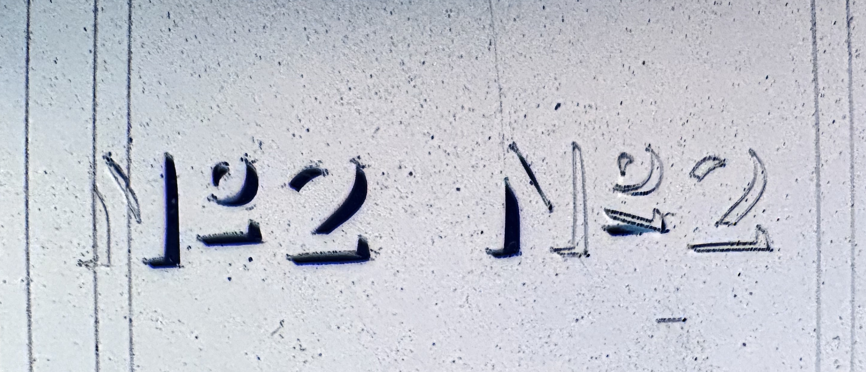

8) The rather more fiddly job was doing drop shadows on the "No.2", but basically used the same approach. Draw the basic lettering and get it to the right size etc. Duplicate it and move that down and to the right to get the shadow effect and then edit the dropped bit to eliminate the base letters on top. Then cut the main letters from yellow and the dropped bits from black and then fiddle about to get the dropped bits positioned where they should be, on the model!
This detail shows the black bits which form the shadows, to be applied to the yellow base letters.
IMG_0098 invert.jpg (1.81 MiB) Viewed 134960 times
To achieve something like this:
This also illustrates the variable width of the yellow lines due to the registration issue - they are all drawn at the same 0.4mm width.

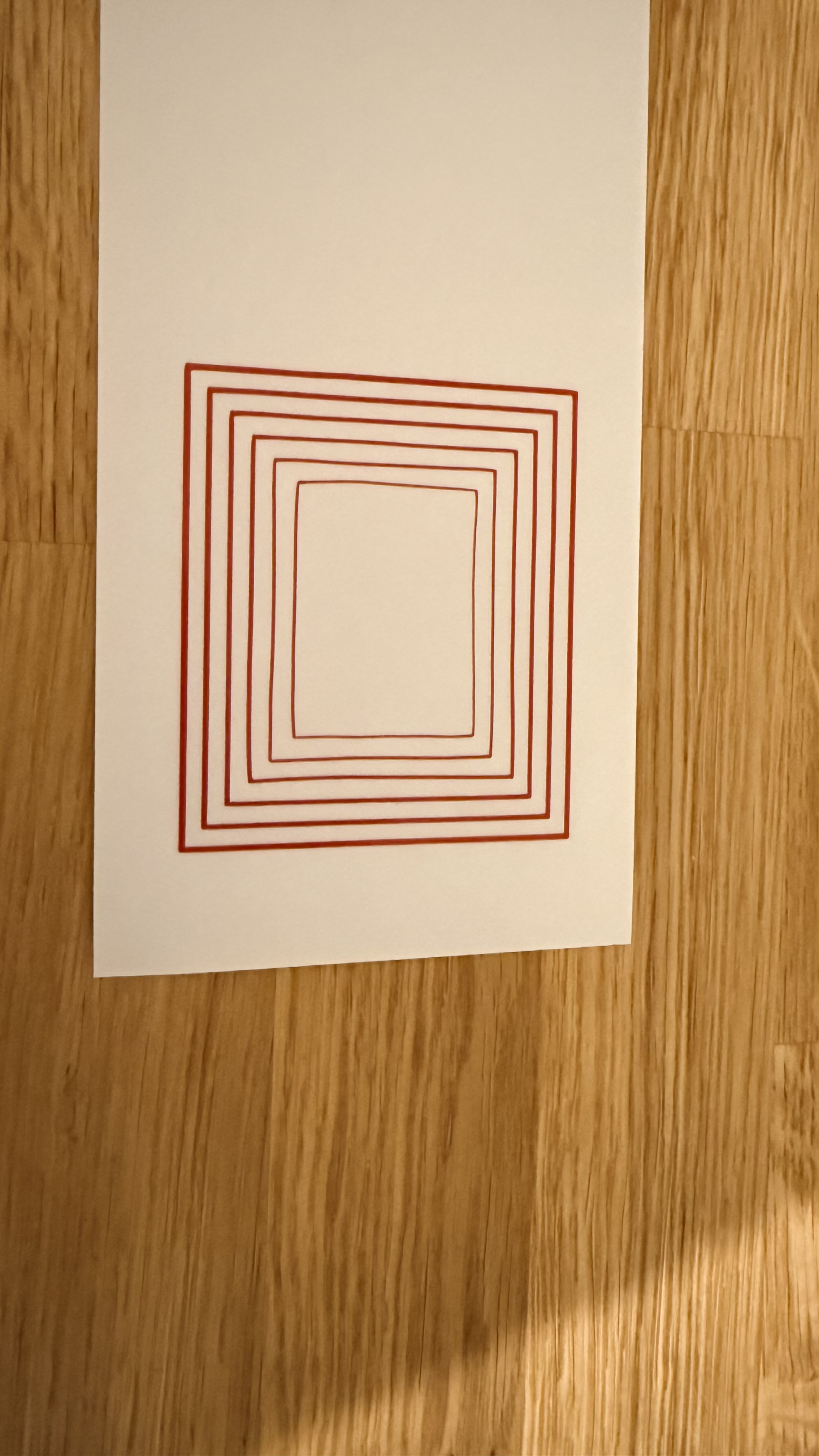

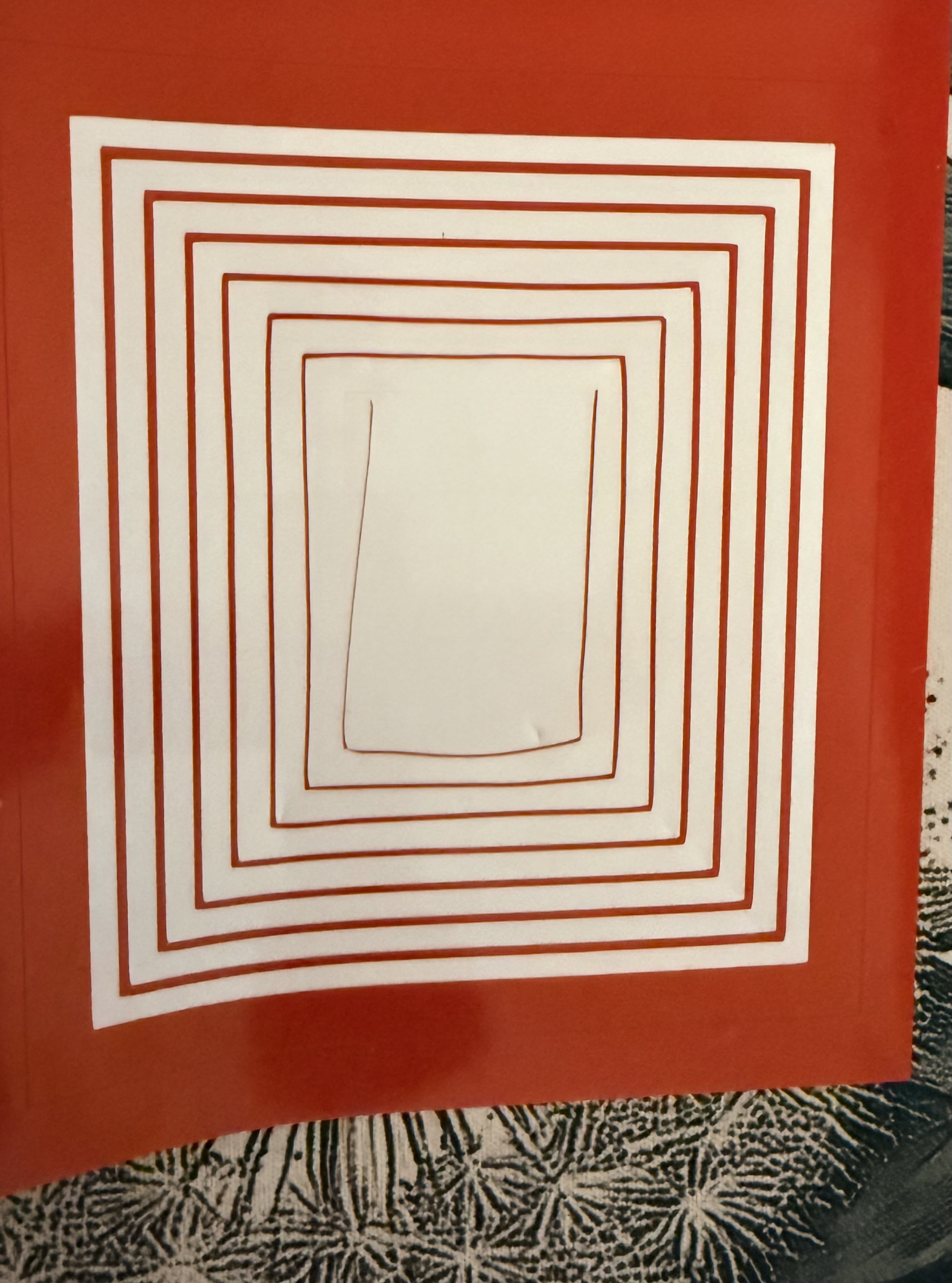

I’ve been doing some trials of my own to test what thickness of line the Cricut Maker will cut. I made a series of concentric rectangles starting at 0.2mm wide up to 0.8mm. The first image shows the vinyl cut and weeded but still on its backing. The 0.2mm line failed but 0.3mm upwards came out OK, so slightly finer than 0.4mm that Philip was getting from the Joy.
The second image shows the shapes stuck to a piece of paper having been transferred in one go using transfer tape. As Philip has said, the tape needs burnishing on to the vinyl to get it to stick. Peeling from a corner and encouraging the vinyl shapes to lift from the backing with a scalpel helps, once they start to lift, the transfer tape then takes over and pulls up the rest of the shape. A brayer helps to get the transfer tape to stick, as shown in the third image.
The blade on the machine I was using was the standard Cricut fine point blade and could do with replacing. My wife makes cards with the machine and it has cut a lot of paper and cardboard which does blunt the blade. This sometimes caused the vinyl to not be fully cut through so weeding out the vinyl can then be problematic, sometimes causing the lining to lift and distort, which you can see resulted in some lines not being completely straight. With a bit of effort, it is possible to manually straighten up the lines once applied. A dedicated blade for lining work would be sensible, Cricut does sell an upgraded ‘premium’ fine point blade which I have used previously and does give more reliable cuts.
Paul, I am sure your proposal to use peelable vinyl as a paint mask would work. The only things to watch for would be any reaction with whatever paint you use and any raised details on the surface that might stop the mask from fully adhering and/or cause the mask to distort.
