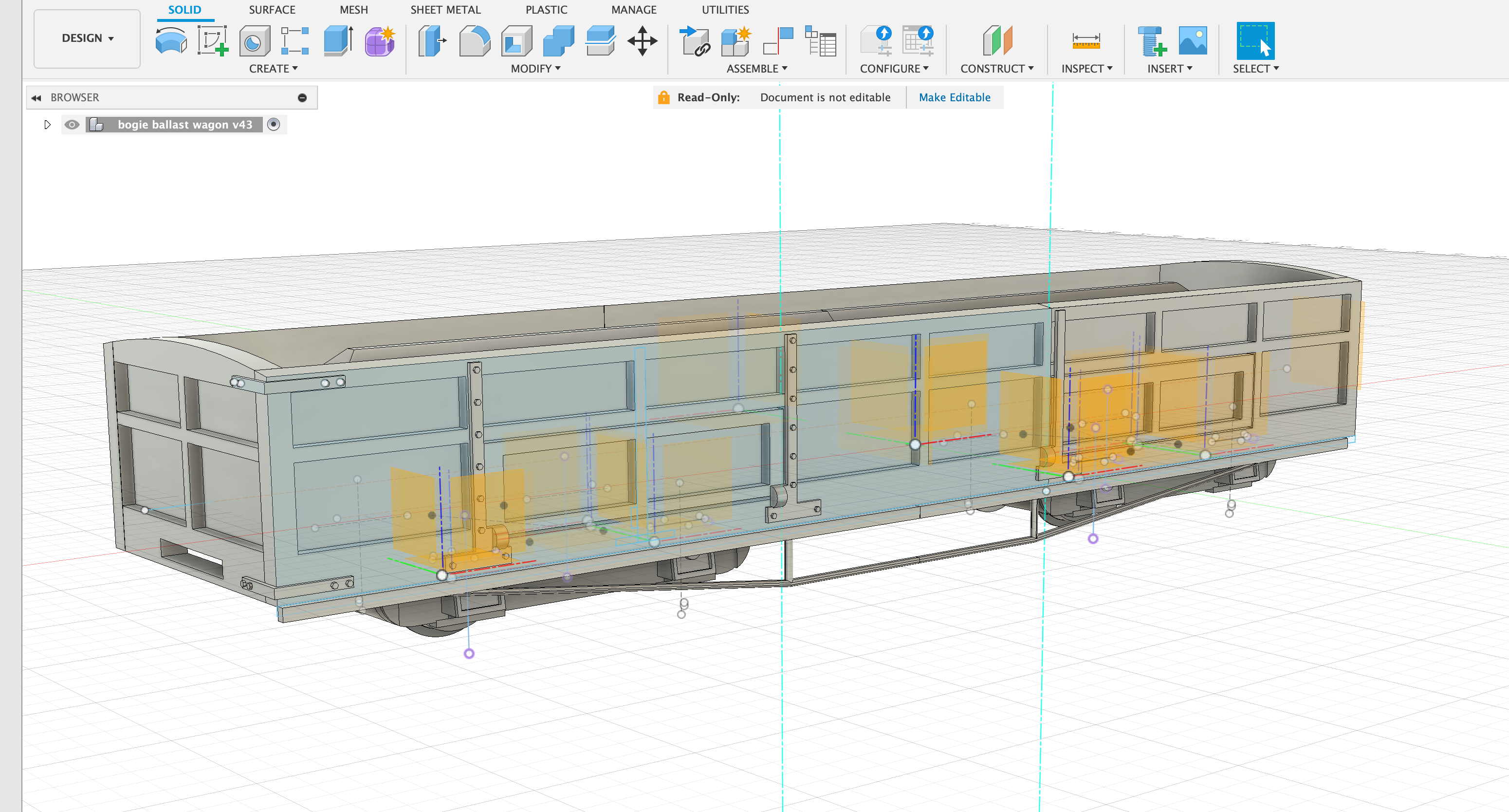

As part of my attempts to learn how to use Fusion 360 I have created the files to make a 16mm scale model of it. Note that the dimensions are not given - so there is a certain amount of estimation involved.
Here is what it looks like:
You will note that I haven't repeated all of the components where they are used multiple times, but you can get the idea of what it looks like.

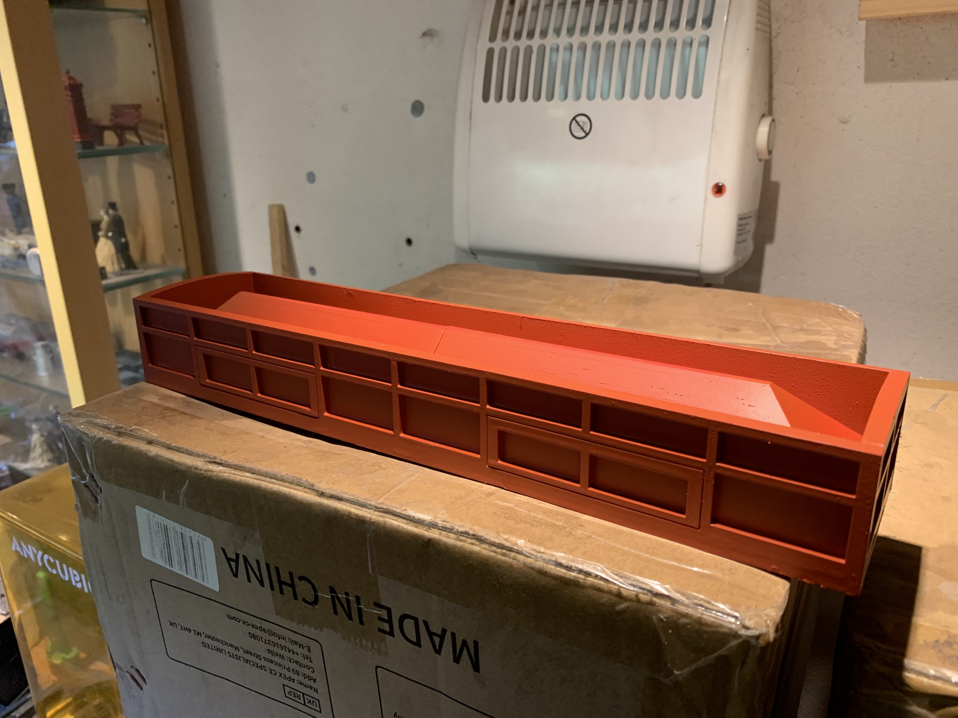

The stl files I exported from Fusion 360 printed faultlessly (no stl file errors found). Here is the main body assembled from 4 half sides, two ends, and a dummy load:

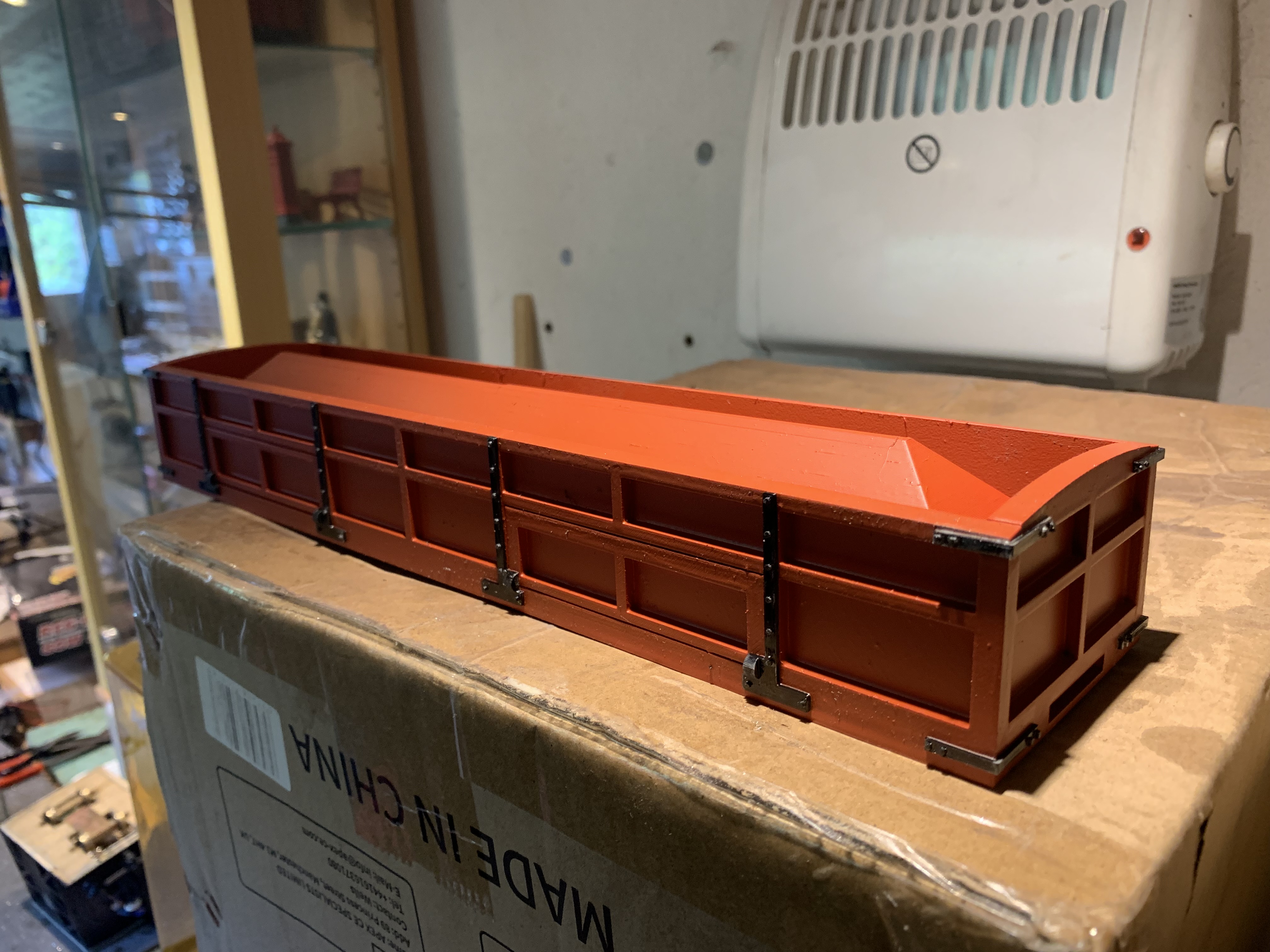

Progress to date. The first wagon assembled:
