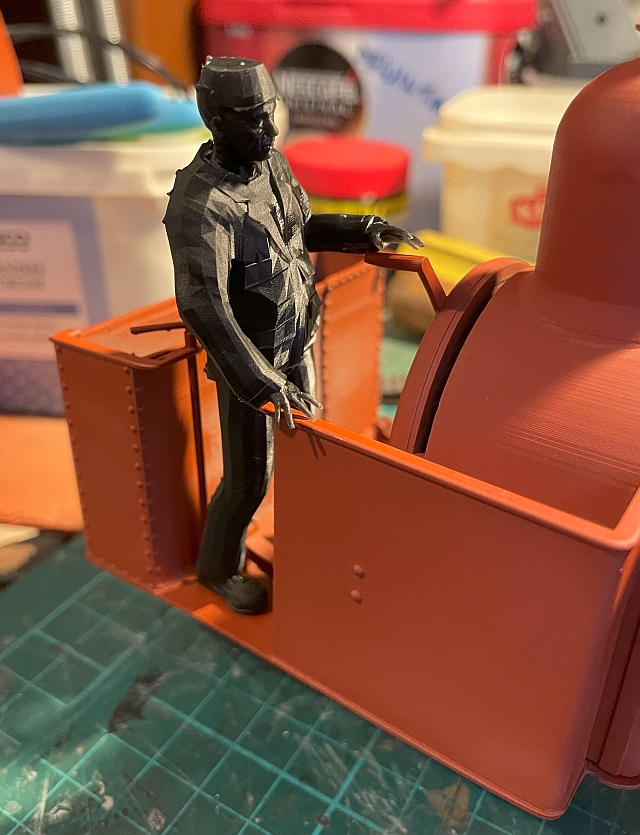

As for the end result, yes it is aimed at fantasy/cartoon users but all we want are 3D models to print and don't need fancy 3 headed monsters and fur or scales.
I knocked this driver up in half an hour yesterday to fit in my F & B loco. It still needs some work but mostly that is just tweaking the size and probably slight adjustment to his arm positions.
