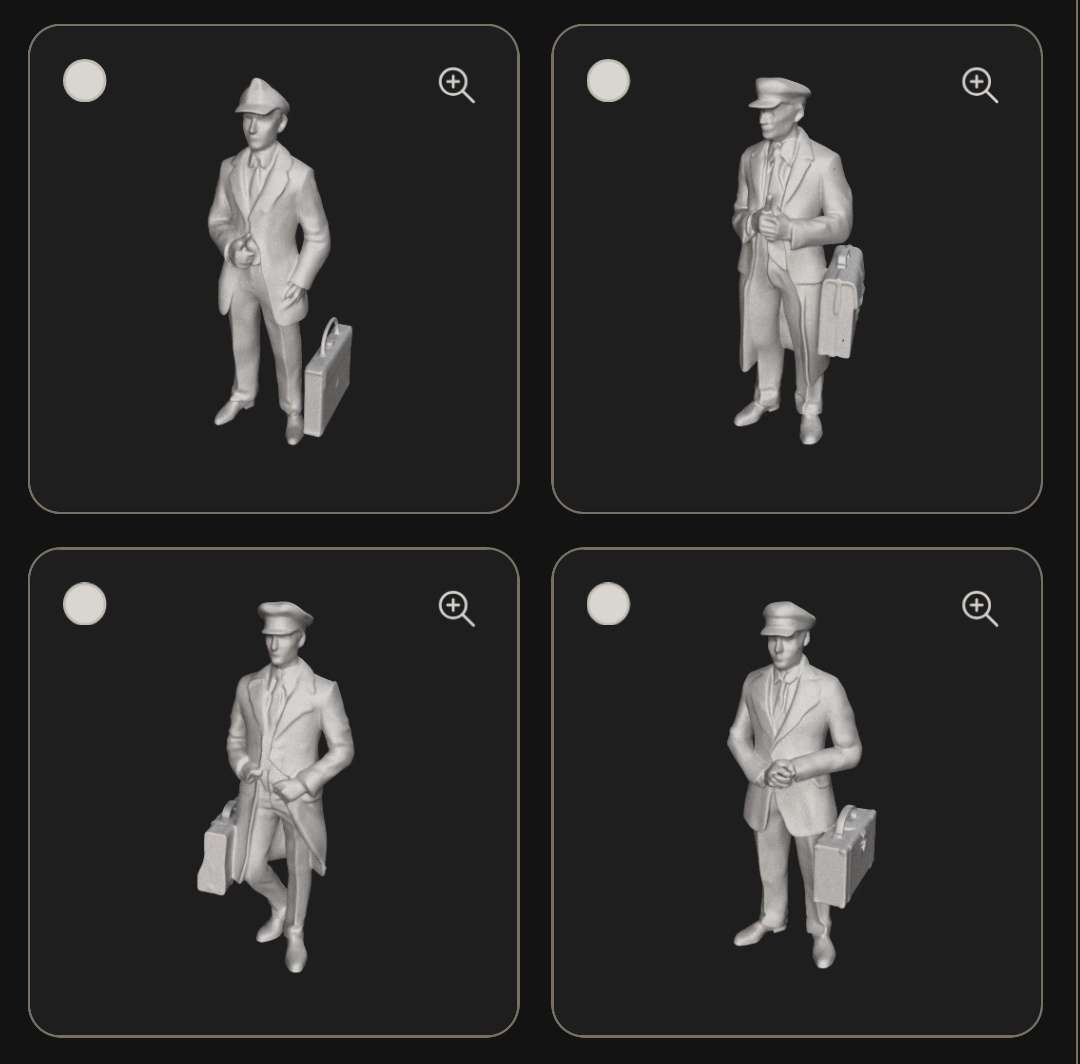

Dear all,
I have been busy on other subject for the past month but I am back to model railway. As my station is empty, I searched an easy and cheap way to have figures on the platform.
I have a Sidewinder X1 printer so I tried to print with this printer to see the result.
I tried Makehuman and blender but I had some errors in the print (holes in the face due to the presence of eyes and mouth cavity in the makehuman model) I am still looking how to correct that.
But during my time spent on youtube I found a video talking about an AI to generate 3D models. So I tried and the result are not bad at all !!
So the first thing to do is to register on :
https://www.meshy.ai/
You can go for a free account, because you have 200 token each month so you can generate few models. Actually it costs 10 token to generate a model.
Once connected you have to go on "text to 3D print"
Write a prompt to describe what you want and clic generate. Few seconds later the AI will propose you 4 designs. Here is an example :
mettre une photo sur une image
You can choose either one of the 4 desing and check if it is ok for you, then you can download it directly in STL for free.
After that I imported the STL into Cura slicer, scale it down to fit G scale (1:22,5); and that's it !!
To print it on my sidewinder X1 with elegoo grey PLA I use a 0,4mm nozzle with 0,1mm for the layer height, other parameters are for the PLA standard to avoid stringing and other problems.
Here is the result juste after printing and after support removal :
The quality is very nice even if it is not a resin printer. It took about 3 hours to print this model, but I have plenty of time for that.
The next step will be the final clean up and the painting..... I will probably ask to my wife to do it !
I hope this will give you some ideas, and after we can share our STL

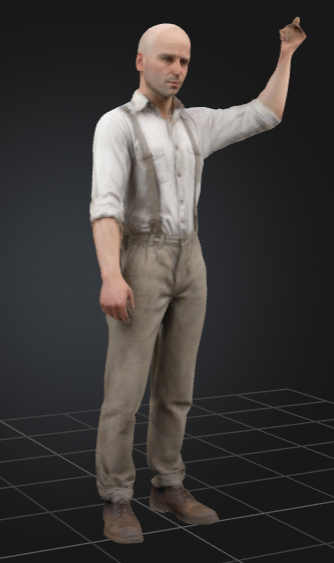

I've been having a deeper look at this and think I'm making some progress. There are quite a few Youtube etc so-called guides which almost without exception are aiming at fantasy D&D type non-humans. None that I've found tell you how to generate a realistic 19xx's loco driver!! :lol:
No you don't need French can do it in English. :D
Soooo.... I've tried to describe a fairly basic, generic workman type figure, just to see what it comes back with.
My "prompt" ( which is what it calls it ) is as follows:
Male human figure 5ft 6inches tall standing with right leg slightly forward of left leg. Slightly stooped forward pose with right arm raised to shoulder height. Somewhat worn workmans trousers, shirt with rolled up sleeves and laced shoes but no hat. hair short and balding
The figure generated from that is:
Screenshot 2024-12-07 06.14.38(2).png (141.39 KiB) Viewed 333961 times

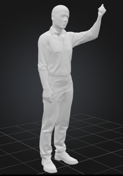

So, it appears to be unable to tell right from left, obviously I didn't tell it to point upwards and it seems to have ignored the short hair instruction and just gone for bald all over!
There does seem to be a lot of potential in this though, but it will depend on ones ability to describe the desired end result in great detail.
Edited to add that I've just discovered the "Texture" button, which auto colours it and shows a lot more details than the basic grey version. The hair is there but of course I didn't tell it what colour, so it is seems to have done it very pale - my fault. :roll:
Screenshot 2024-12-07 06.35.39.png (154.28 KiB) Viewed 333959 times

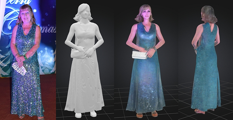

As well as describing a person to generate a model, it also has the ability to generate a 3D figure from a 2D photo.
I've been playing :lol: and, from L - R... a lady in a sparkly dress... the basic generated model... the same thing textured... a rear view of the textured version, which is obviously completely synthesized. It has knocked a few years off her apparent age and for some reason has adjusted the position of her arms and handbag, but that is a minor point.
Potentially this could enable specific real engine drivers, or whatever, to be generated wearing their correct clothes or holding tools or whatever, and then 3d printed!

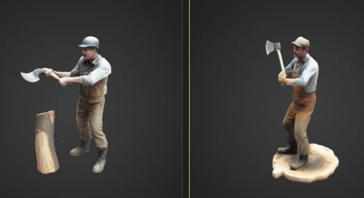

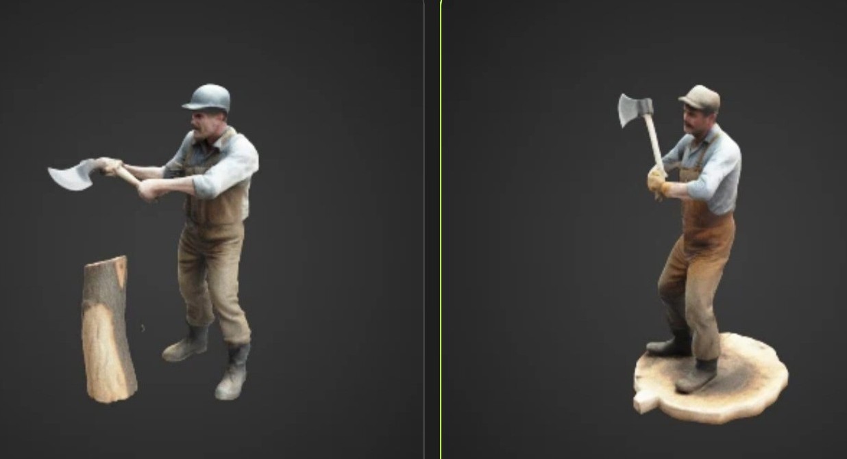

Post by ge_rik » Sat Dec 07, 2024 9:31 am
Just had a quick play on my phone. The interface isn't really suited to a small screen but here's what it produced with the prompt "vintage workman swinging axe to chop a tree"

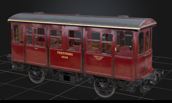

Seeing your axeman , I had an idea and tried an experiment.
I put in "Festiniog and Blaenau 4 wheel railway coach".
I got 4 very different offerings, none of which more than remotely resembled a prototype, which was no real surprise, I didn't really expect it to know a pretty obscure and short lived Welsh line, but this is not a bad stab at a generic 4-wh coach.
