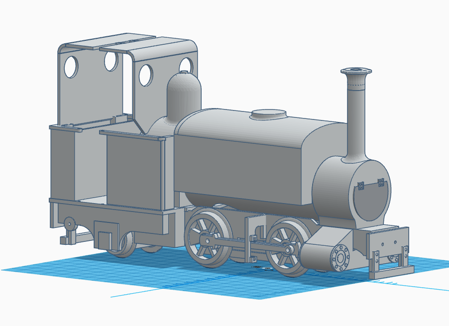

...or more accurately, What will it be when it is finished? Answers on a postcard...
The lads in the E & D Erecting Shop have been a real pain recently. Following their success with the Quarry Hunslet they've been moaning about having nothing to do and, as a result generally creating havoc around the line.
The E & D Chief Draughtsman recently acquired a new book and in it found some drawings and photo's which inspired him, so he had a word with Chief Operating Officer, who took a quick shufti at the Chief Financial Officer's books and decided that, with the number of bits already in stock, it was a viable proposition. Plus, constructing this loco would kill several birds with one stone. So, the drawing commenced and this where we are at atm. Still a lot to do, obviously:

A very early England loco?

Festiniog & Blaenau Manning Wardle?

The driving wheels are a giveaway........
Built by the third builder in Jack Lane, for the other Festiniog.

Both Stuart and Graeme are spot on! ( I almost left the wheels off because I thought that might be too much of a clue - I obviously should have done!)
I haven't yet decided whether it will be No.1 or No.2 but not a lot of difference between them apart from the sandboxes.

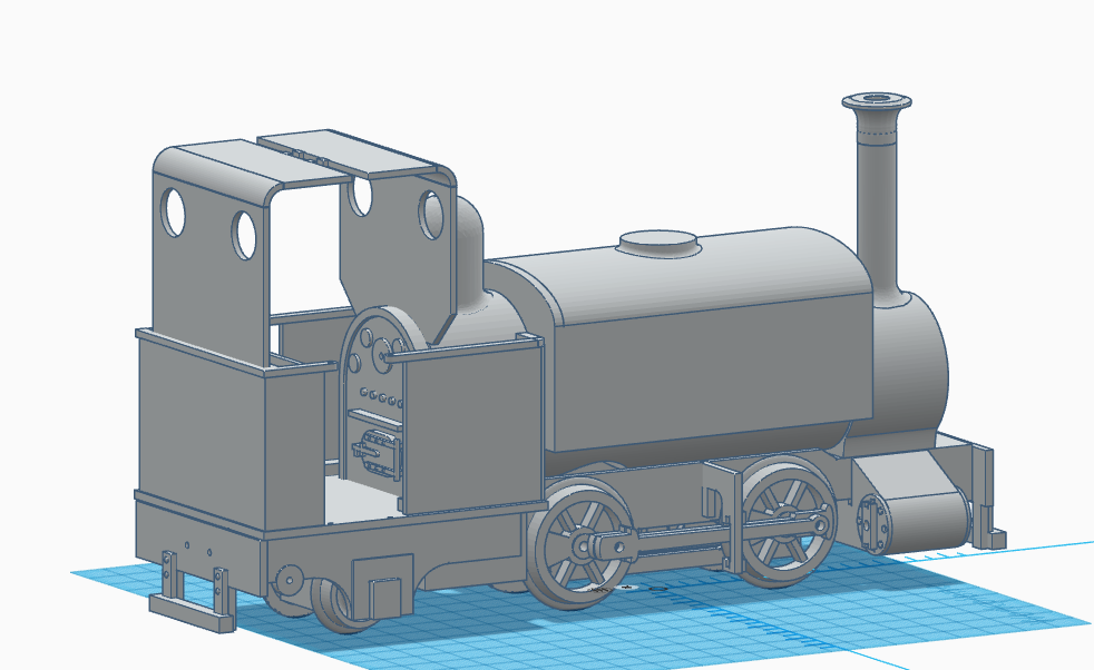

It looks like the trailing wheels are fixed rigidly rather than swivelling. If so, I wonder how it will cope with tight curves and pointwork.
Are you going to cheat or have them fixed to the chassis?

Not decided yet. I've printed a simple chassis, put wheels in and pushed it round my tightest curve and I think it just makes it, but I need to do it a bit more scientifically under its own power. I think that unless the trailing axle is load bearing balance would be an issue, so a simple pony truck wouldn't achieve anything. The rear driving axle is only a couple of mm behind the centre of the loco.ge_rik wrote: Wed Oct 16, 2024 1:05 pmJust realised that I have that book and now see that the author speculates that on the odd occasion when the loco ran on FR metals, they would probably have had to remove the trailing wheels.ge_rik wrote: Wed Oct 16, 2024 12:49 pm It looks like the trailing wheels are fixed rigidly rather than swivelling. If so, I wonder how it will cope with tight curves and pointwork.
I've been wondering about a sliding double axle to give a bit of sideplay. I can get about 49mm between frames and allowing 40mm between wheel faces should give me +/- 4mm play which should help considerably if needed, as long as I can get a smooth enough slide. I've got some 3mm bore oilite bushes and I'm hoping they might work in this situation.

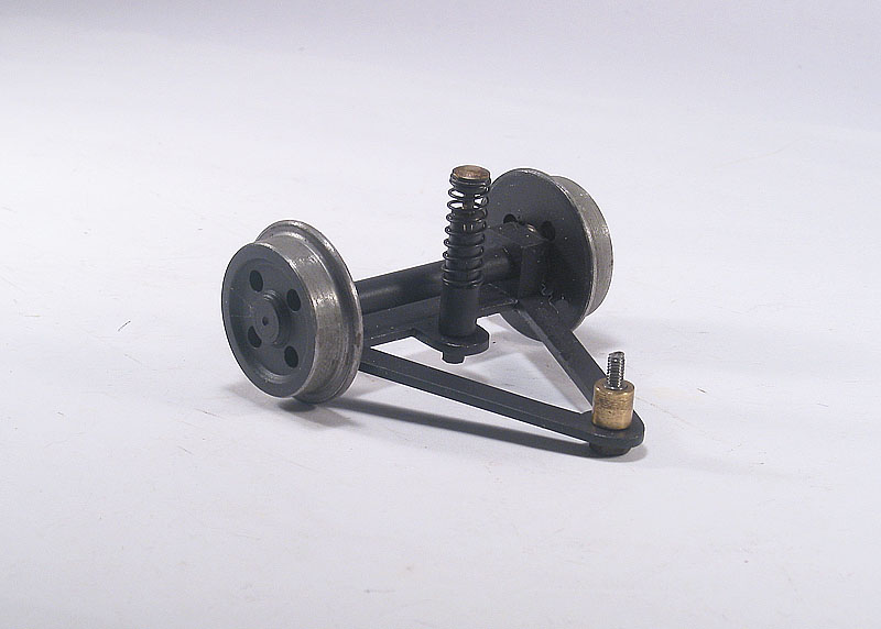

I went through the same issues with an 0-4-2T wheelbase when building my KS Skylark that you'll have with this little MW.
When Nipper and Scorcher were built the Bissell truck was a newfangled yankee invention and radial axles were also new. MW were a conservative old fashioned company and appear to have used a rigid wheelbase, effectively a long wheelbase 0-6-0T. With that long a wheelbase a model will likely need vertical flexibility, as well as sideplay, on the trailing axle.
My solution to all this was to fit a spring loaded Bissell truck (pony truck) and fit the batteries as far forward as they'll go, right up against the smokebox door if possible. The spring plunger rubbing against the underside of the cab floor also tends to damp out any side to side movement and stops the back end of the loco slopping around when running cab first.
Have fun........

Graeme, where did you position your spring - directly above the axle, or bearing on the linkage between the axle and pony truck pivot?GTB wrote: Thu Oct 17, 2024 1:09 am
I'm thinking that this might be the better way to go

A picture is worth a thousand words they say.........philipy wrote: Sat Oct 19, 2024 5:14 pm Graeme, where did you position your spring - directly above the axle, or bearing on the linkage between the axle and pony truck pivot?
The pic is from the Skylark and is my usual arrangement, although a couple have a simple T-shaped frame. If I'd thought more about it at the time, I'd have put the spring behind the axle on the Skylark, so there was space (just) to have the motor under the cab floor, instead of sticking up through it.
https://gardenrails.org/viewtopic.php?t=13529
The pivot is located by Baldry's Rule, which along with the spring seems to give stable, derailment free running in both directions. I've got nine of this type running in various locos in the collection, as leading trucks, trailing trucks, or both.

Re: What is it? An F&B 0-4-2
Yes, the Skylark motor mount also has to carry the rear truck pivot, as Baldry's Rule located the pivot under the motor gearbox......philipy wrote: Sun Oct 20, 2024 8:37 am I did vaguely know of Mr Baldry's Rule, but have never had need to use it before. However applying it to this loco gave me a problem, in that the pivot point came out bang slap in the centre of the N20 gearmotor.
Putting the motor between the drivers sounds like a reasonable solution.

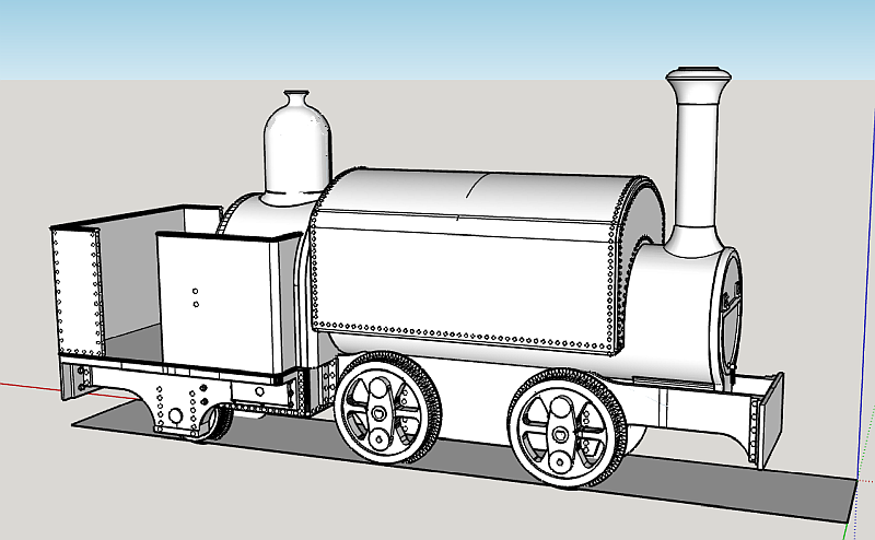

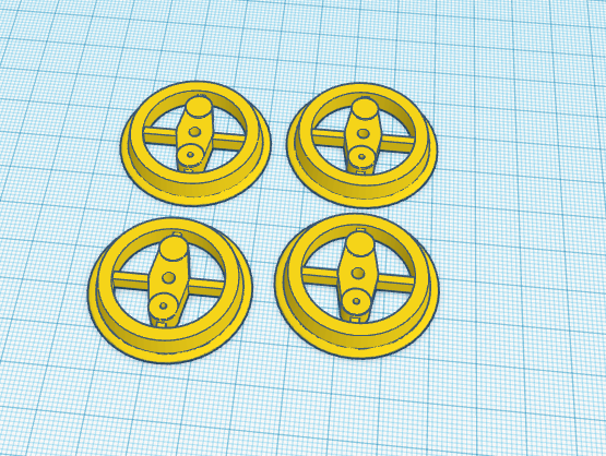

I would have guessed a Manning Wardle from the wheels too as they are exactly the same as I did on the ones for mine that I did a couple of years ago, lol.philipy wrote: Wed Oct 16, 2024 7:32 am ...or more accurately, What will it be when it is finished? Answers on a postcard...

Goodness, I actually posted it up with the wrong wheels, these were my wheels.
