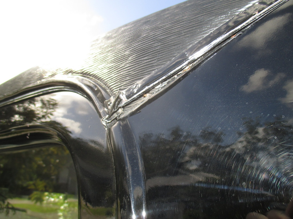

Whomever restored this car in the US, (thought at the time to be 20 years prior) used straight-shank nails to hold the roof trim strips on.
Through vibration and the spring action of the (badly hammer-battered) rear trim, these have pulled right out.
Besides a single bead of bathroom silicone in the wrong place across the front, there was zero sealant to be found. Also small holes in the vinyl.

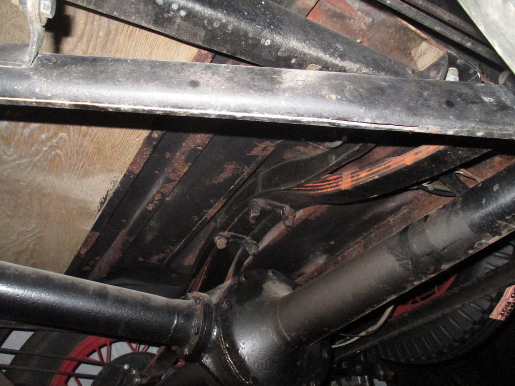

Underneath wasn't too bad, just surface rust and a complete lack of any protection for the 3/4" plywood floor. Nothing damaged.
The car had no shock absorbers on it, and the previous owner said he had it up to 50mph/80km. That tells me the springs aren't doing their job.
If they were, the car would be uncontrollable over 20mph. You can see they're rusted stiff. They groaned louder than the brakes when you got in it.

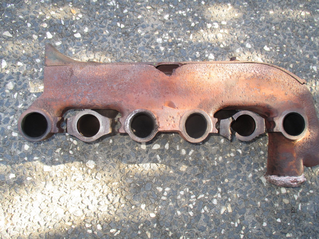

Yup, those manifolds were cooked.
Not one of those ports was sealing. Cheap and nasty muffler (installed wrong of course) didn't help either.
Interestingly, this is an aftermarket heater manifold. There was a hot air outlet in the floorboard. Won't be needing a heater in QLD.

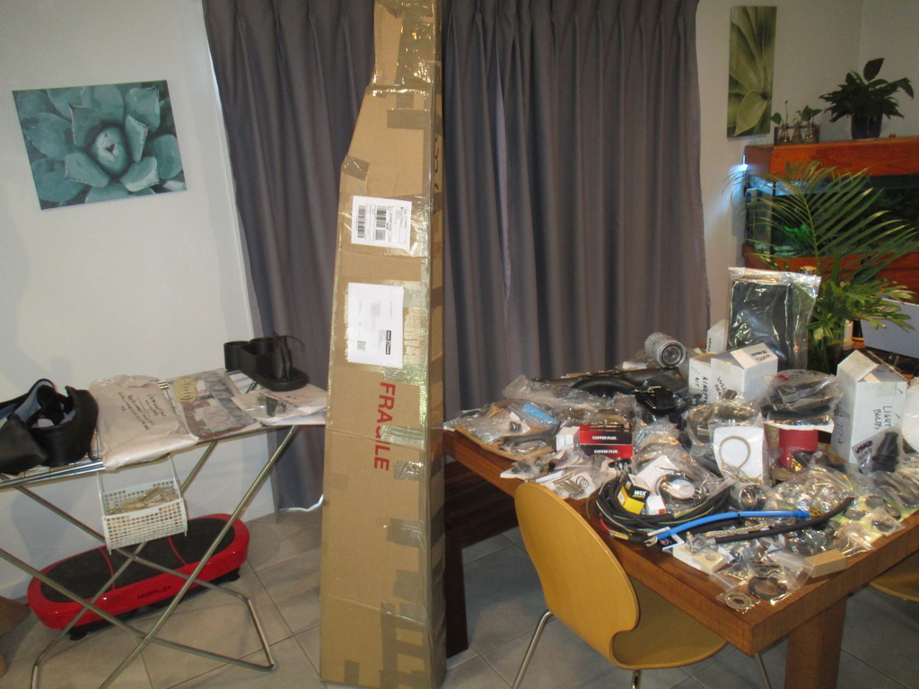

"Enough parts including new manifolds, exhaust, wiring and misc. bits to get it roadworthy."
How wrong I was..

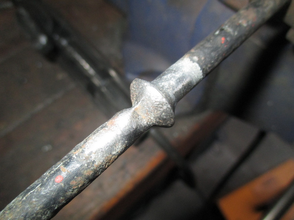

3 of 5 Rear RH wheel studs are loose in the drum. Looks like I'm going to cast irons now rather than down the line.
You can really see how the front end sags when the front spring gets weak and stiff. Crooked, adapted 1928 headlight bar too.

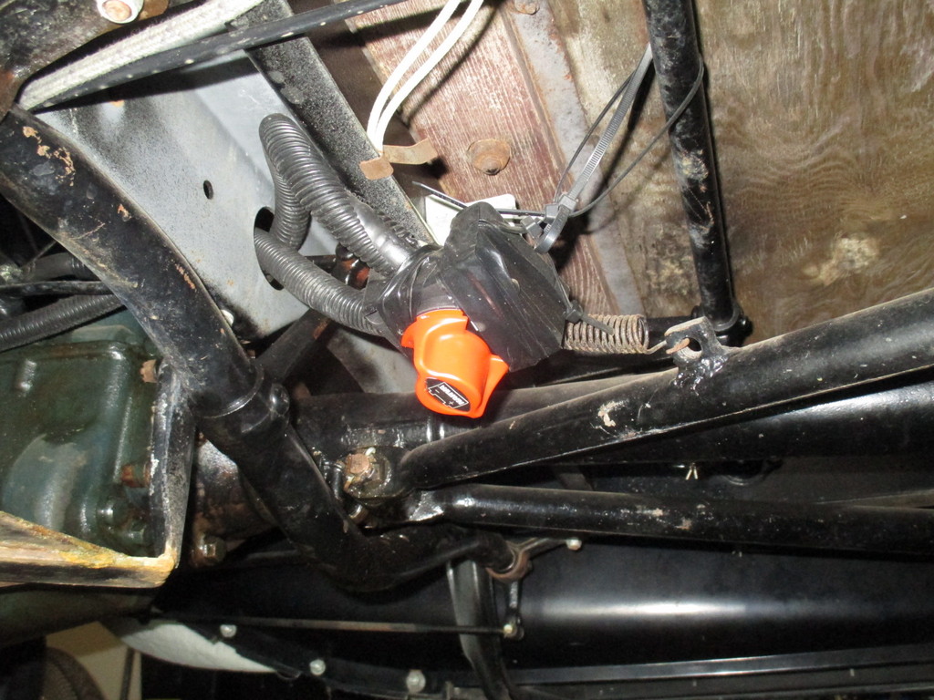

Why you would put a battery shut-off in such an inaccessible place is beyond me. The corrugated conduit over the cables was to protect them from rubbing on the service brake rod, because buying a longer cable and routing it sensibly is too hard, apparently.
A proper cut-off is on hand, and will be fitted through the floor so I can switch it under the driver's seat - on the ground side, unlike this thing.

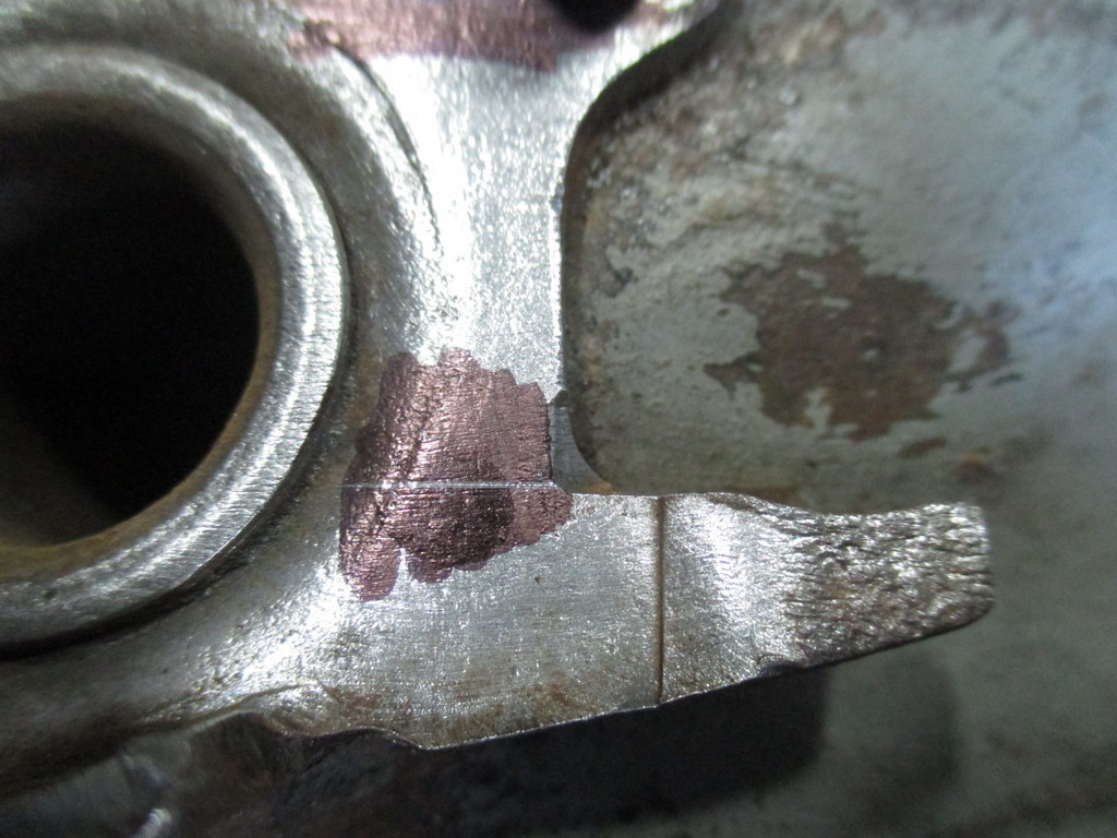

Main bearings have tins of shims - but they haven't been taken up in years, now the centre main is hammered out. I didn't bother checking the rods.
This engine is thoroughly ruined.

Plenty more to do in the meantime, I'd bought all those (badly needed) parts after all. No longer a "slowly spruce it up as you drive it", but rather a full-blown re-restoration. If I wasn't working on this, I'd be working on something else. Bring it on then.

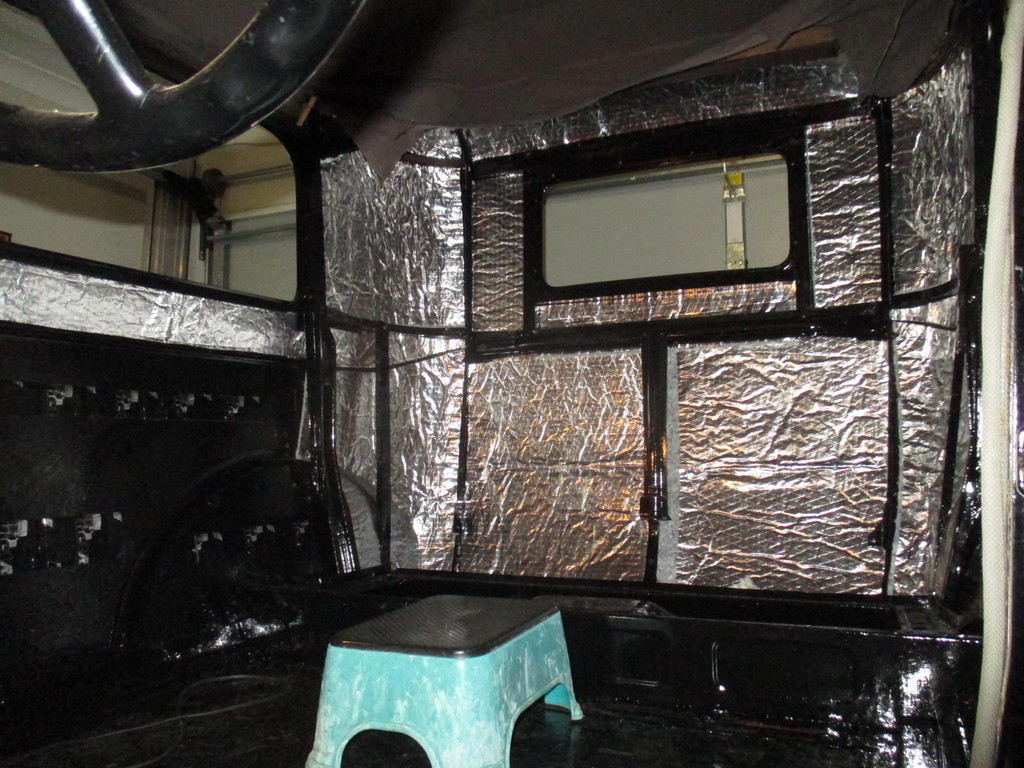

Interior stripped, cleaned, Penetroled and painted with epoxy enamel.
Fuel tank removed, cleaned and resealed into the cowl to keep the rain out.

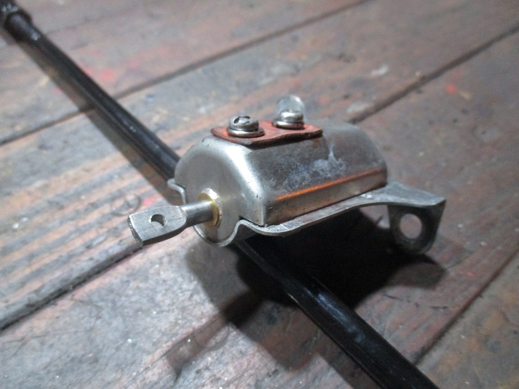

The cowl lights needed rebuilding and converting into indicators. Or I could use them as headlights elsewhere. :lol:
17/06/22
Insulation followed after paint. Rear window resealed properly, no more bathroom silicone.

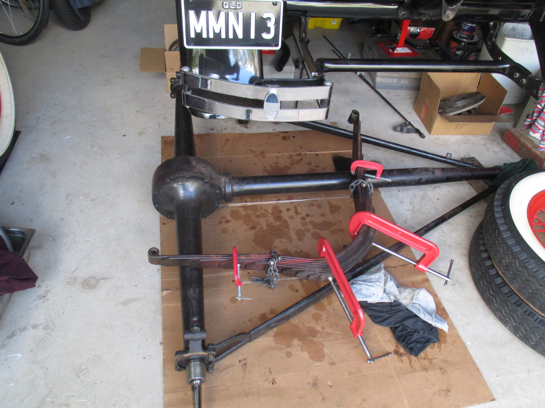

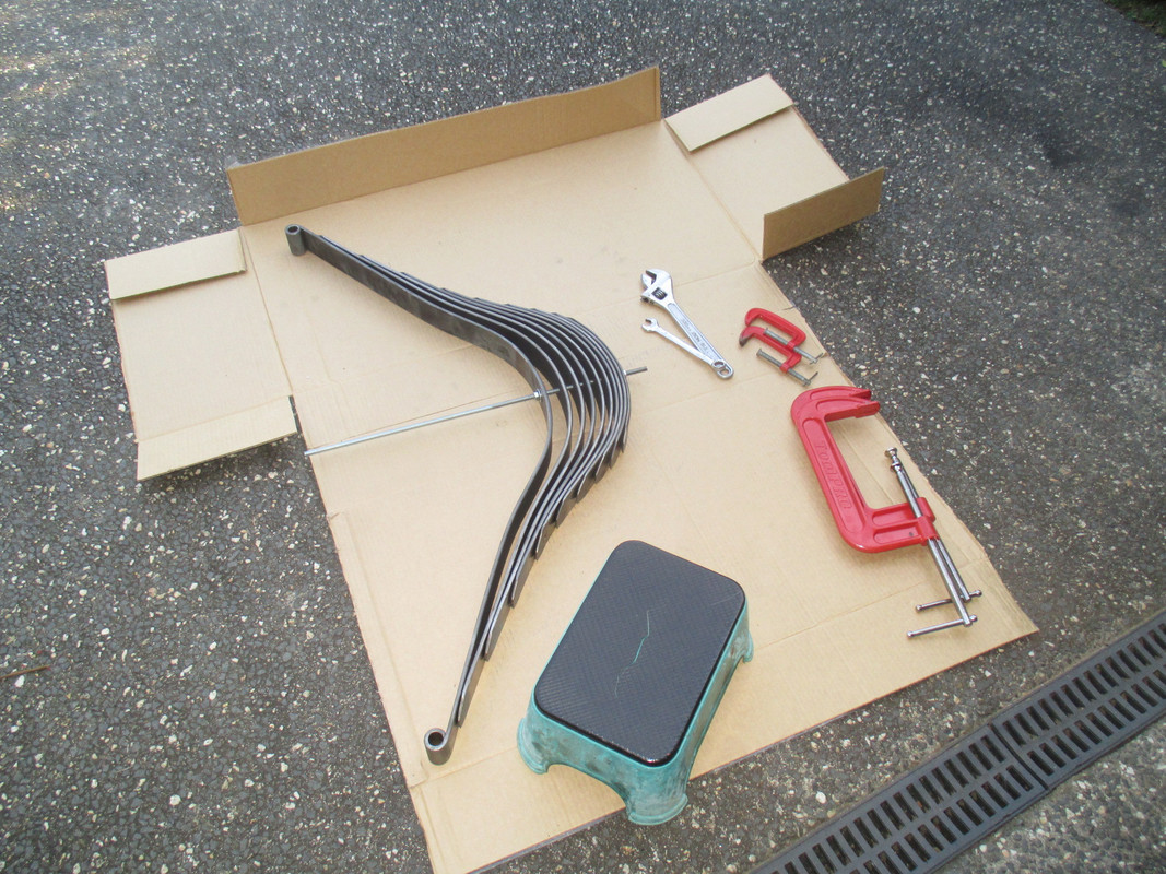

Removing the rear axle involves pulling the rear spring for overhaul. They call these "widowmakers" because you need a very beefy and specialised spring spreader to remove it safely - some people don't bother. Those people watch a spring punch through their shed roof and get 50ft of air. If they get to see anything at all..
You then clamp the leaves together with big "G" clamps. Remove the rusted-stuck centre bolt (usually cut off the head with a grinder and hammer the shaft out) then replace with a length of threaded bar and nuts. Remove the clamps and gently back off the nuts to allow the spring leaves to relax and separate.
Each leaf was thoroughly wire wheeled and checked for cracks. No issues found, but as you'll see later on the front spring, each leaf wears into the leaf below it over time. This wear needs to be ground smooth, and the ends of each leaf need a relief ground underneath, so they don't dig into their lower leaves again. The worn shackle bushes in the eyes at each end of the bottom leaf, were replaced.
The underside of each leaf was then painted with special graphite paint to lubricate them, so they can slide against each-other in operation.
Once assembled with a new centre bolt and clips, the complete spring could be primed and painted. Once refitted to the car I'll fit dust covers with oil-soaked felt pads, to keep the springs cleaner and better lubricated.

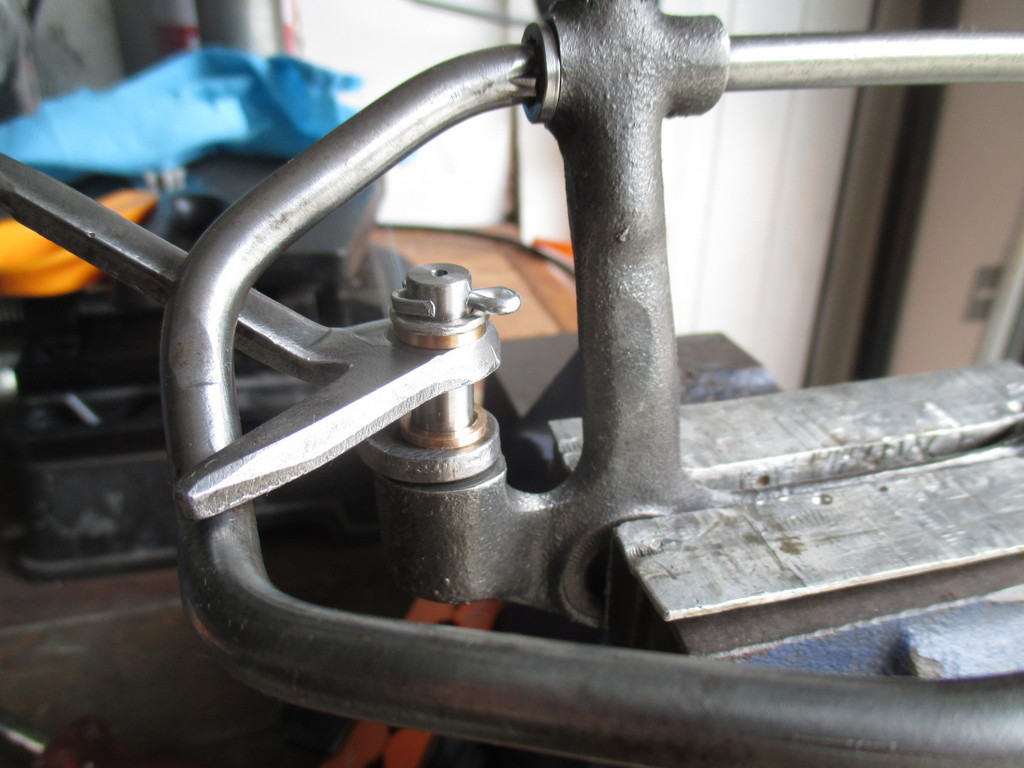

The original cross shaft bushes were steel shells with a brass-wire-reinforced, graphited-cloth lining. You don't oil these. :roll:
And to replace it, the end arms need to be de-riveted and removed.
Most people (myself included) replace these with a two-piece brass bushing. I've added a grease nipple to the clamp and cut lubrication grooves with the dremel.

Rear spring/axle assembly refitted after stripping, treating and painting the underbody. Oh! And new spring end shackles fitted.

Front axle was bent from the centre, as they always are. Someone tows them out of a ditch or barn at some point, the axle just bends.
Press at Dad's work took two attempts after it sprang back in a few weeks, but it's straight now.
Wasn't able to remove wishbone to check for twist, but looks very good otherwise.

The brake rods are the usual dangerous mess. Worn halfway through where the flat return springs bear on them.
Nothing the electric glue stick and some files won't fix..
29/10/22
Can't skip the little things. This is the cheaper reproduction brake light switch that was on the car. When you hit the brakes, the shaft down the centre of the switch is moved by a linkage.
Brass bushes for the switch shaft were made on the lathe and soldered into the switch body, as factory originals had.
If you don't have bushes in your brake light switch, it tends to be noisy, wear out and stick "off" - a recipe for getting rear-ended.
