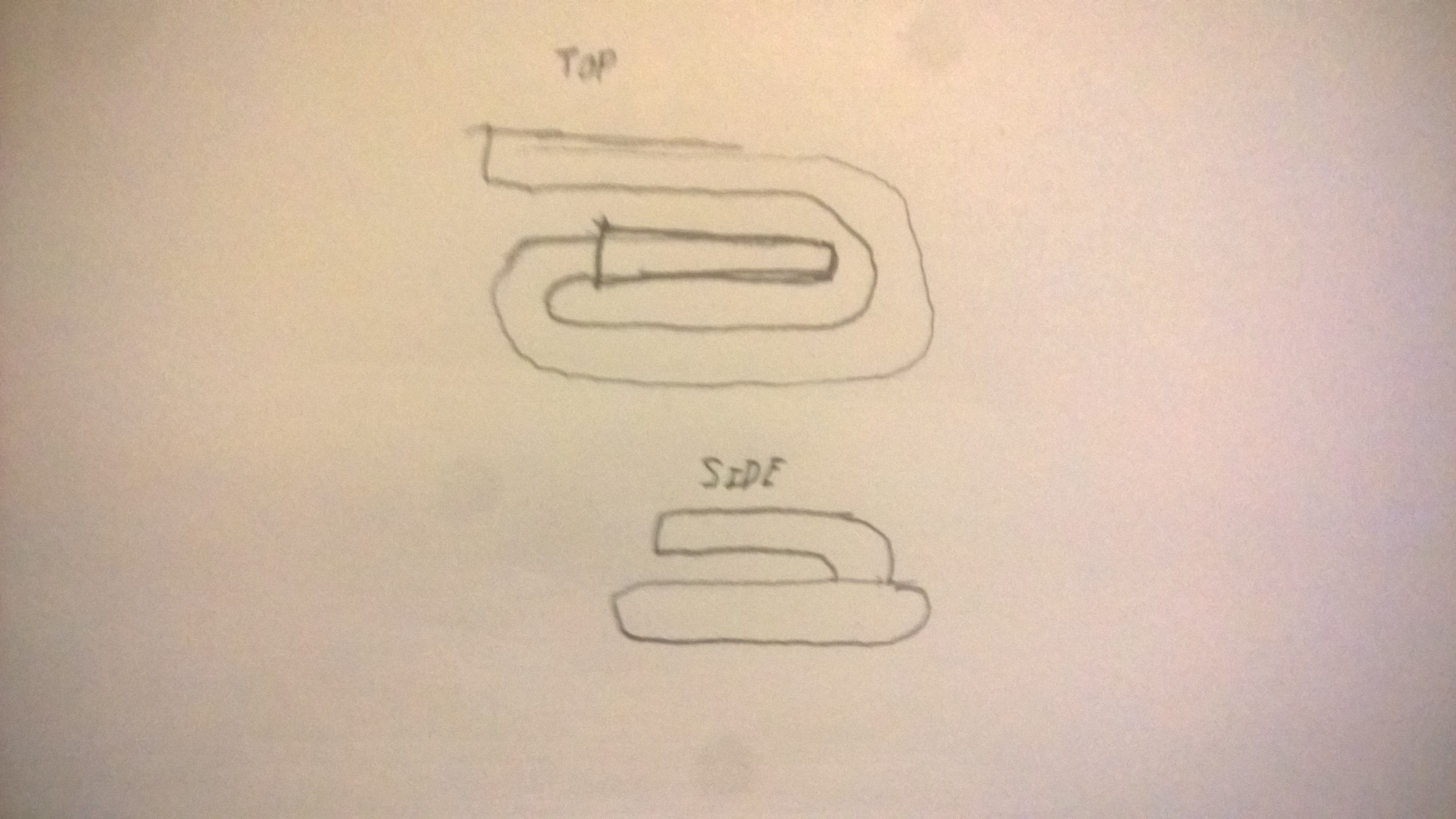

So I decided to make do with what I had and use this skinny stuff to make a water tube boiler.
This was the idea, although I drew this afterwards. The proportions were supposed to be nicer than this but as you'll see it ended up completely different.

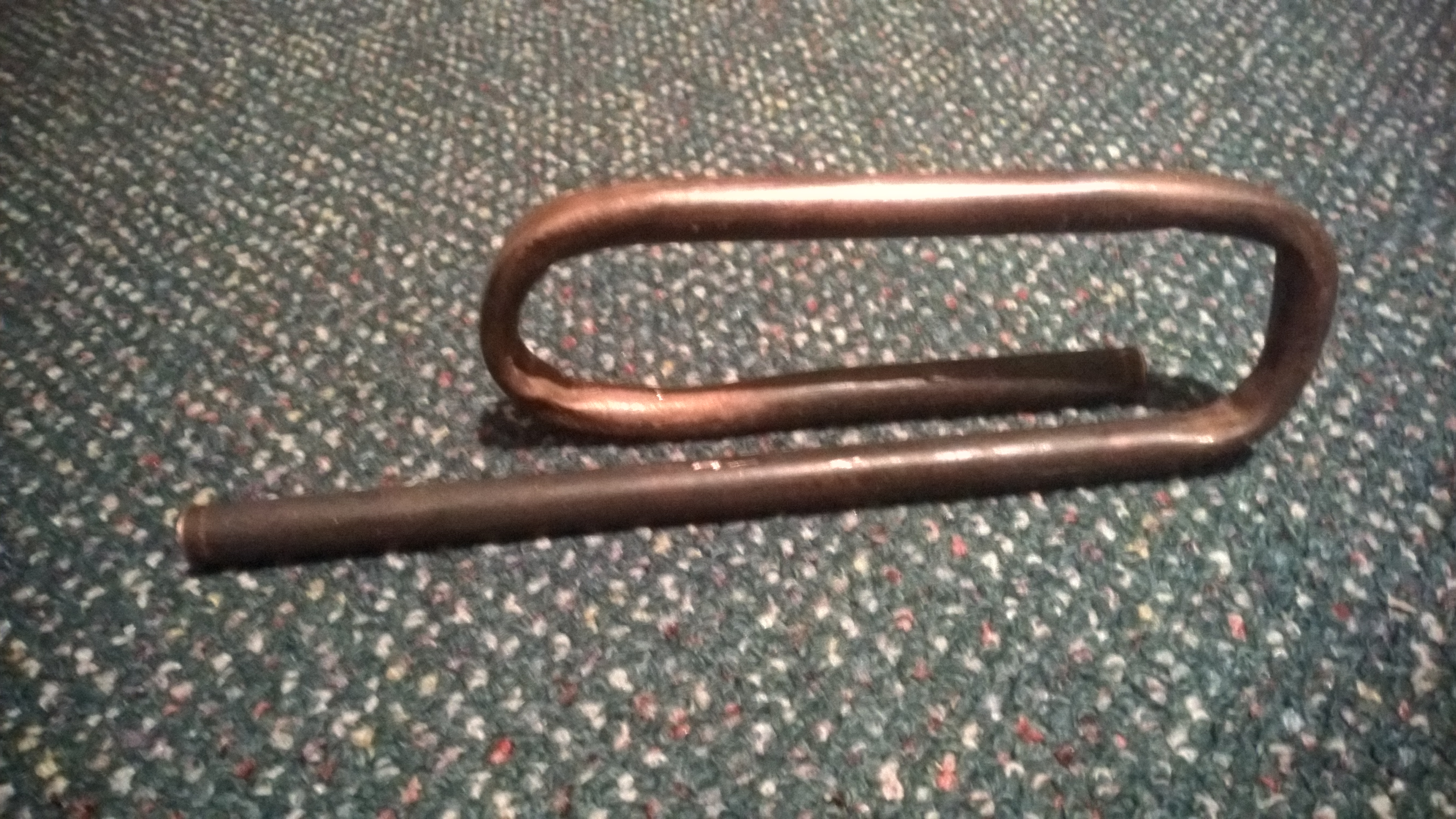

Here's the result.
I couldn't resist :lol
WP_20231212_16_54_40_Pro (3).jpg (284.72 KiB) Viewed 21923 times
As you can see I kinda failed to bend it correctly, yeah I annealed it and tried to use a handheld pipe bender but I ended up just using a vice.

I haven't tried it yet but I have heard that in the absence of a mandrel, a copper tube may be bent without crushing if it is first filled with sand. (Or maybe it was salt?) Linus Tech Tips did a super sketch budget water-cooler using that method several years back, I'll have to see if I can track that down.

Yeah I thought of using sand but I didn't do it for some reason. I'll have to try that next time.

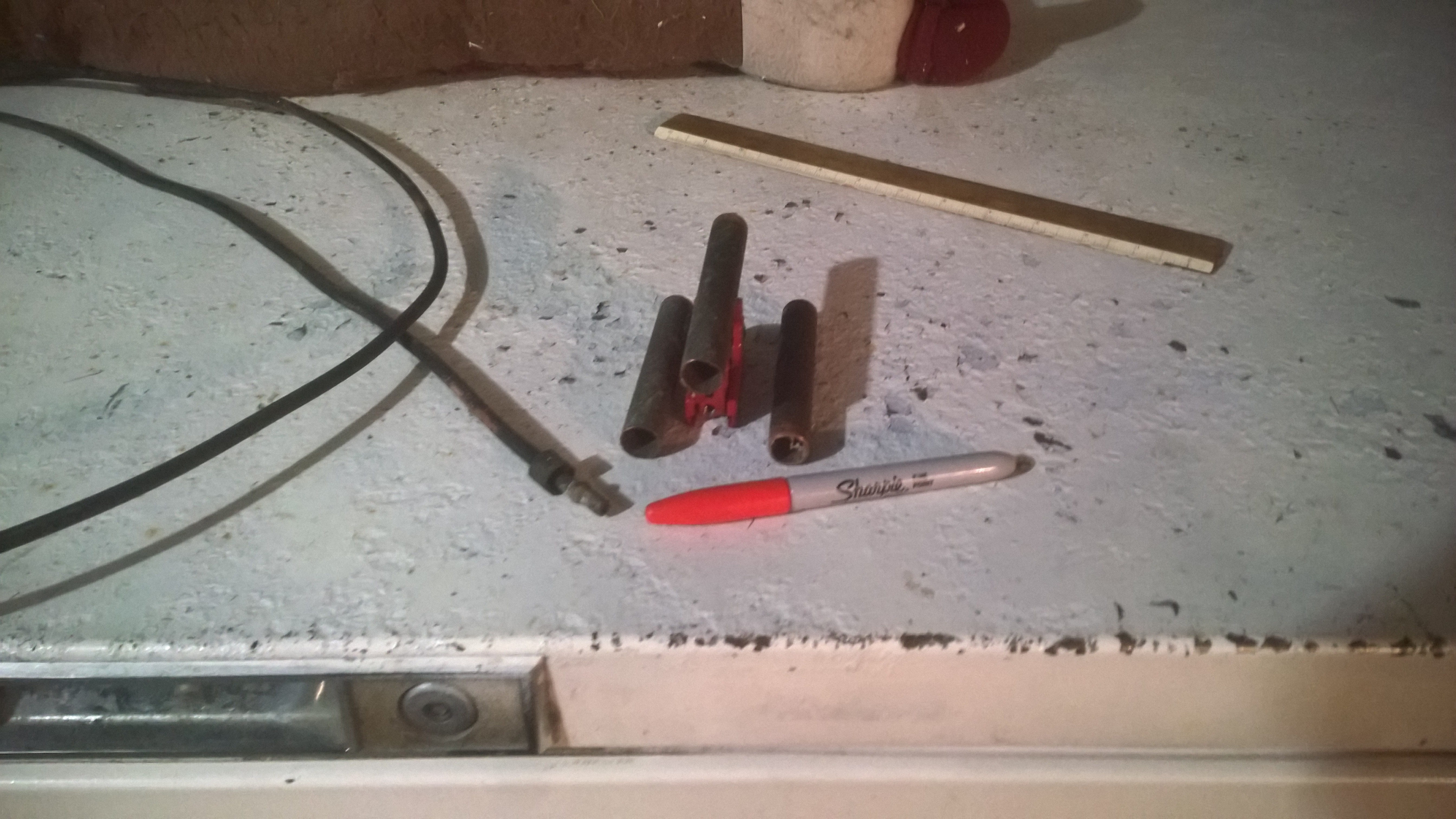

I have a new idea, a triangle design, whatever it's called. The 3 lengths of larger 5/8" tubing are about 4" long. The skinny stuff would be the water tubes and I think there would be seven or eight per side. It's 1/4" diameter. Sharpie for scale.
WP_20231213_20_32_49_Pro (3).jpg (2.95 MiB) Viewed 21861 times
I apologize for the poor quality photos, it's an old phone.
