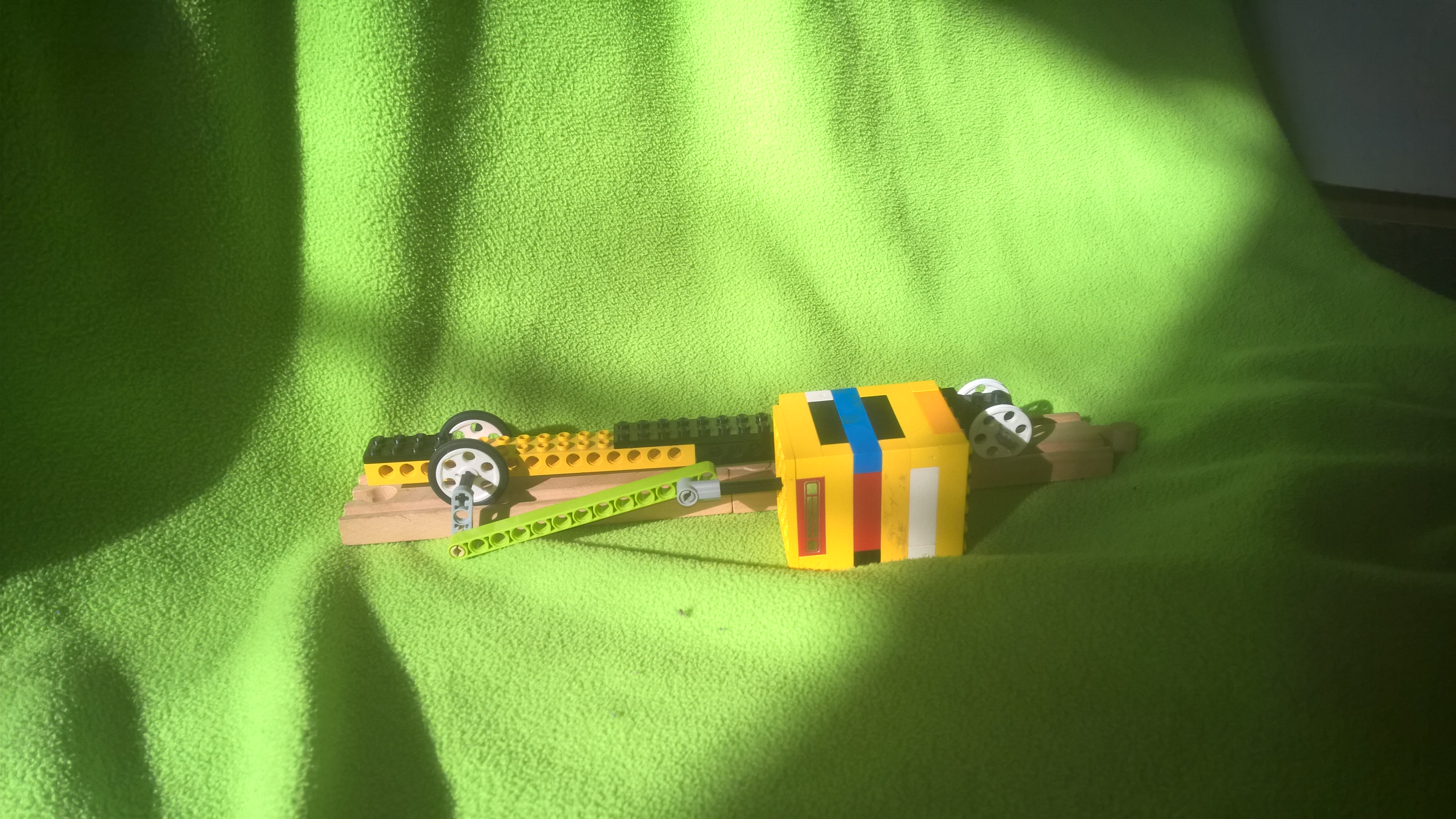

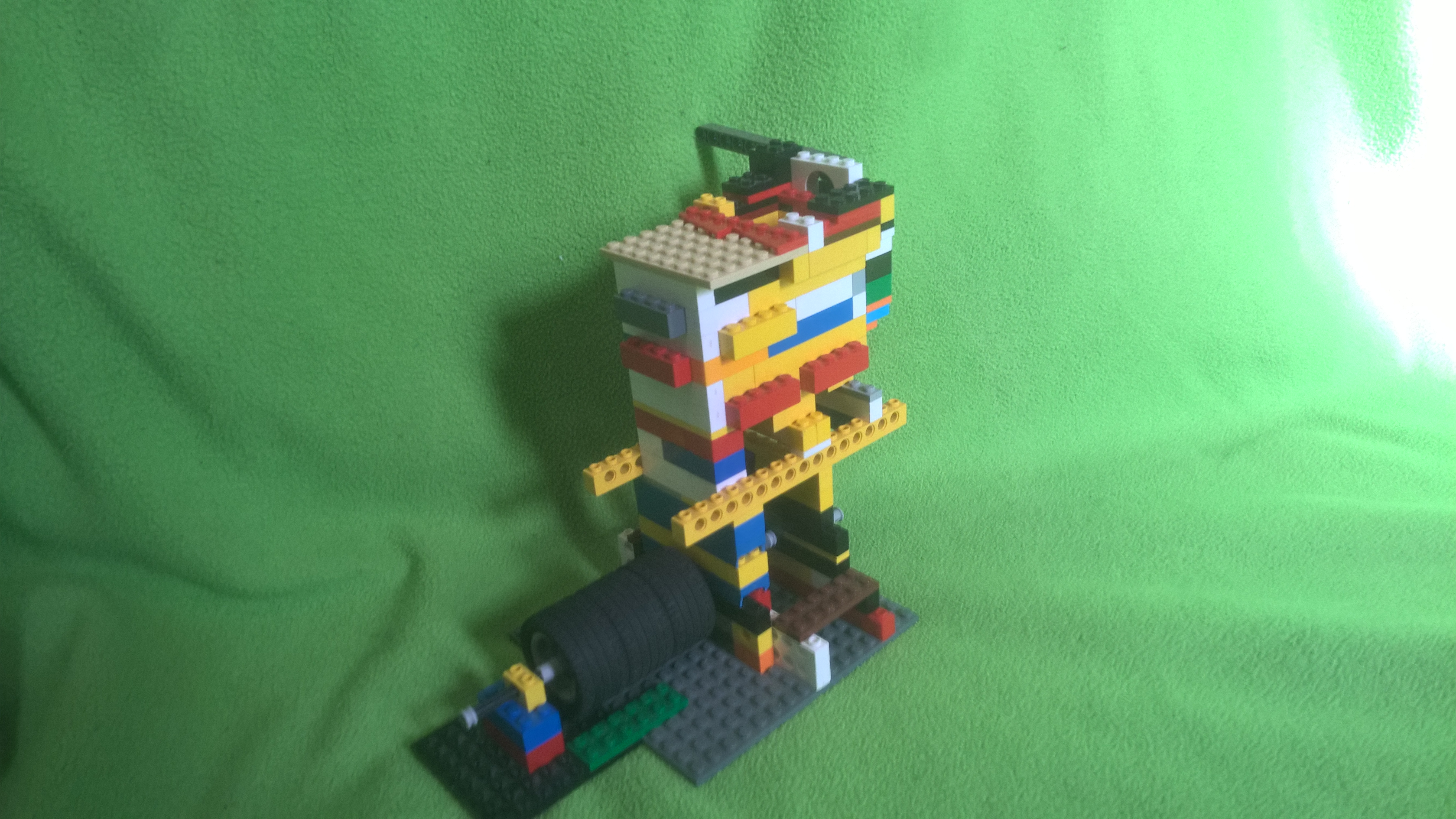

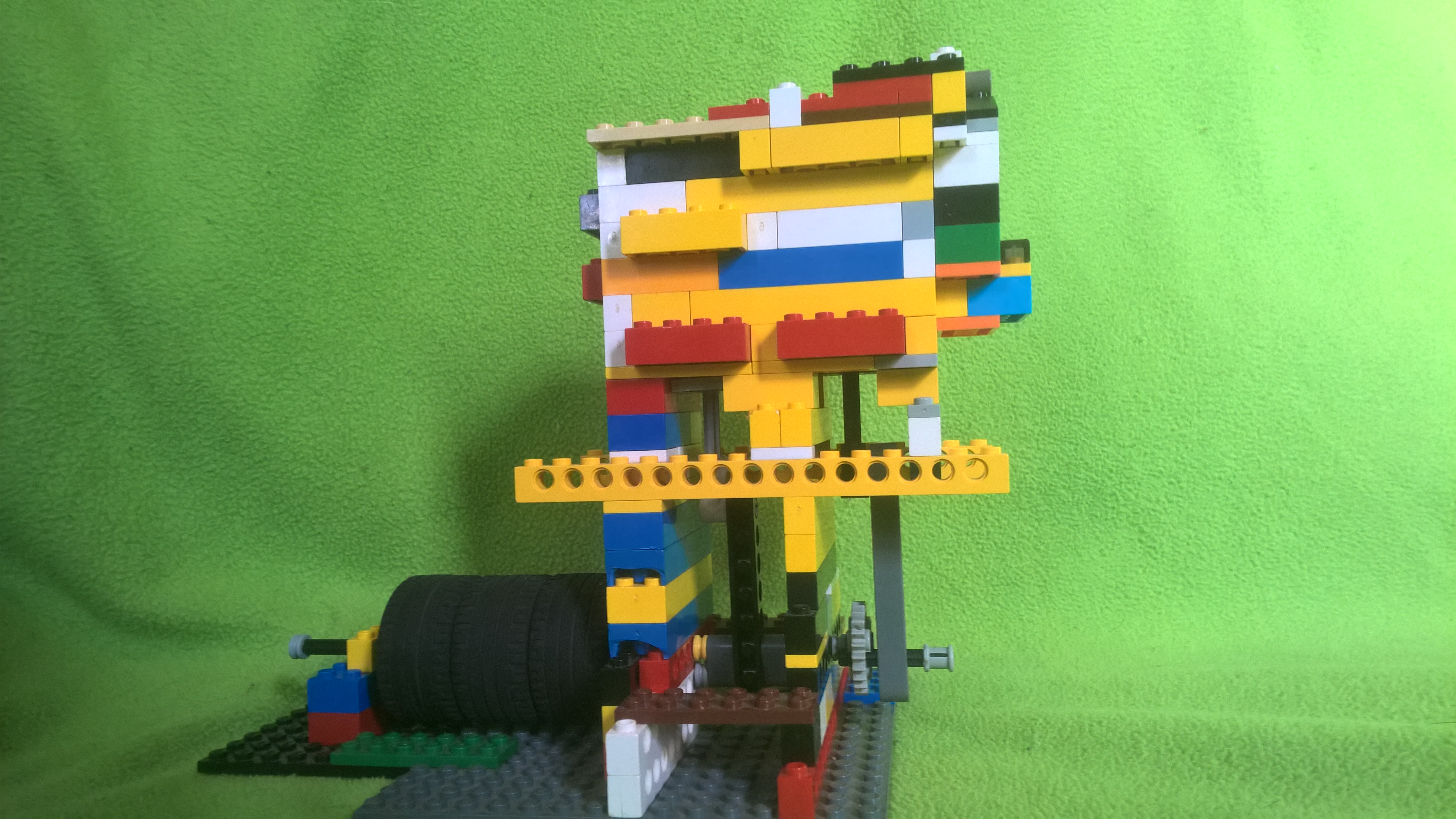

Here's a LEGO vacuum engine I built, "vacuum" referring to a readily available power source, a vacuum cleaner - it has nothing to do with a flamelicker. (Look up Lego Vacuum Engine on YouTube, they get pretty impressive, I'm talking v16s and stuff.) Anyway, this one here is a double acting single cylinder, it's very smooth. I'm thinking I could make 2 of these and mount them on a frame with a compressed air tank made from a 1-liter soda bottle, and have a "live air" LEGO fireless...

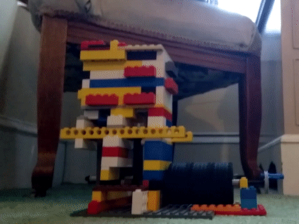

It doesn't need three flywheels, they just make it smoother

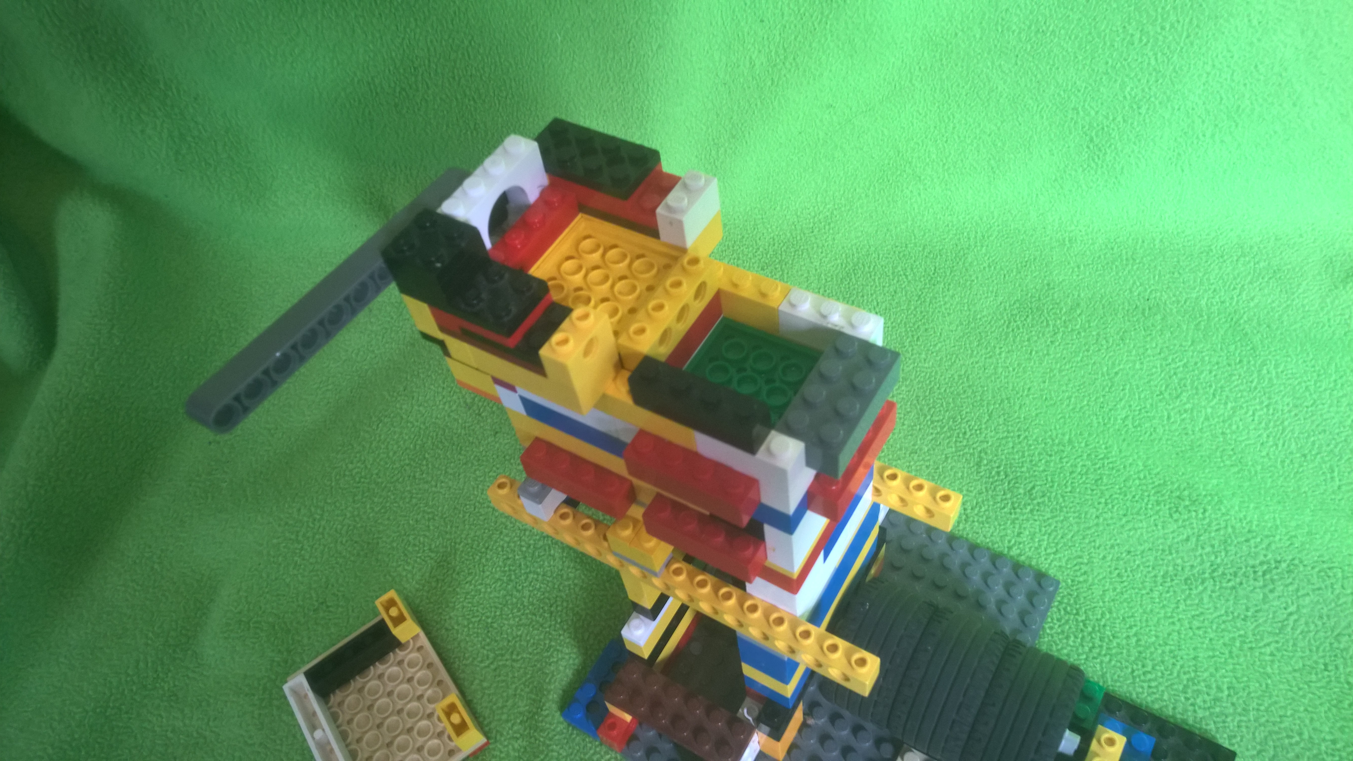

Upper half
Upper half

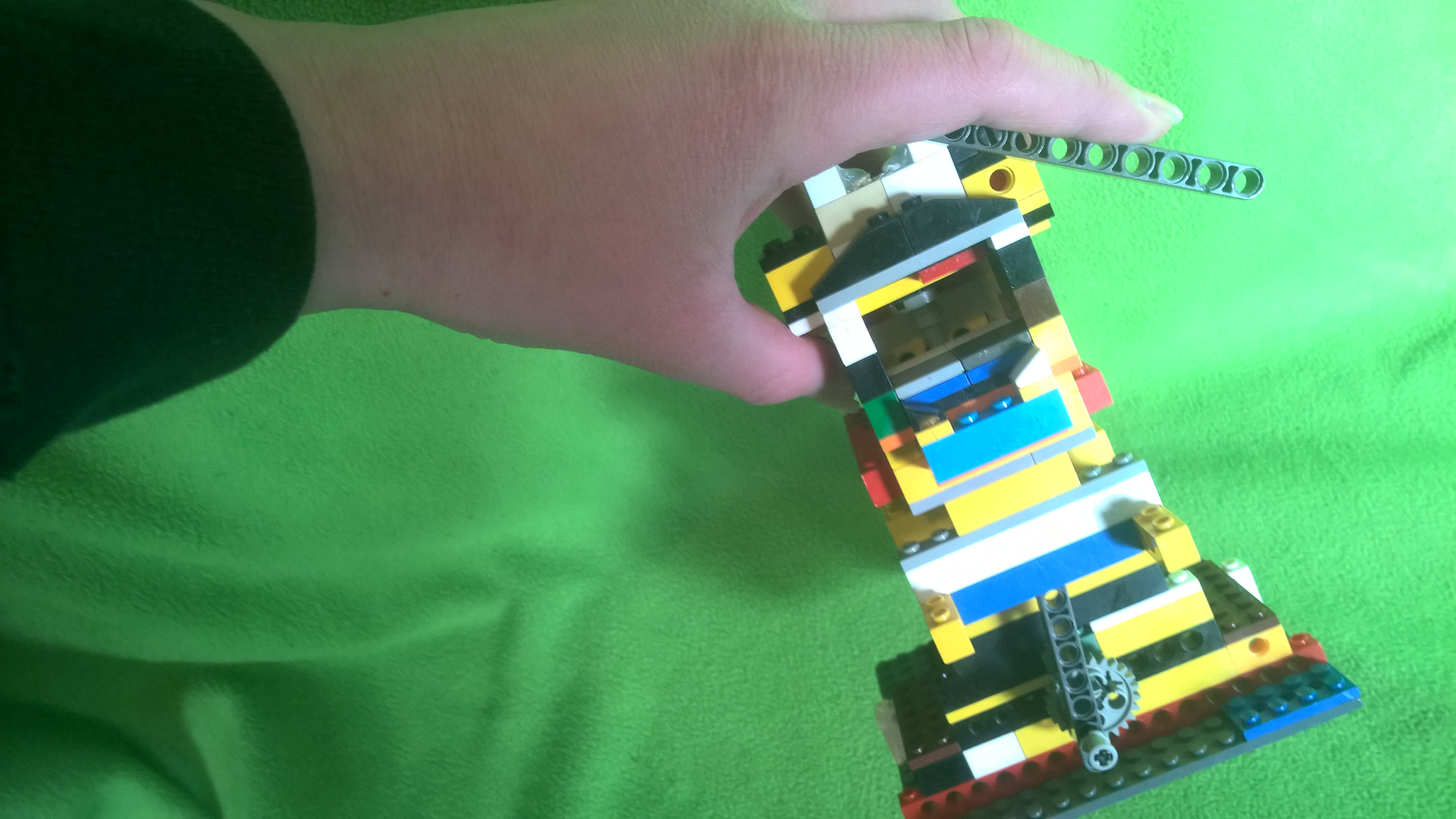

Throttle for vroom vroom noises. Here you can just see the lower port
