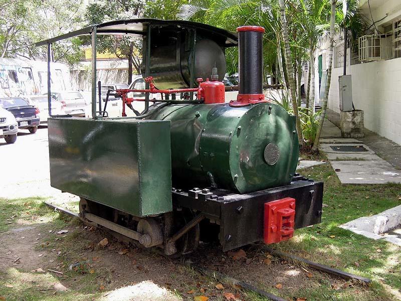

I am trying to find a small 0-4-0 STEAM loco to model with a recently purchased loco block – from a Bachmann centre cab diesel.
It will not be a true model – I am just after ‘ideas’.
It will have to be an outside frame type and I would prefer it to have inside cylinders so I don’t have to model them! Small 0-4-0 Porter locos seem to fit the bill, but I haven’t found any with inside cylinders. The largest size Porters would fit the bill of around 200mm long for my indoor line. First question is what is that vertical thing inside the cab? I’m guessing it is the steam dome. Then what is the long ‘chimney’ on top?
I have found a couple of pics of a loco made by a company called ‘Bell’, which seem to be outside frame and inside cylinders. It has a big air? tank inside the cab.
Any ideas what it is or any other info please.

UScdesigners rarely used inside cylinders on steam locos., mostly on early ones copied from UK practice. In later years, the yanks preferred the working parts of a loco to be accessible for maintenance, unlike pommie designers.gregh wrote: Wed Oct 11, 2023 1:25 am
As you guessed, the lower part of the 'thing' in the cab of the Porter is the steam dome. The safety valves are mounted on the dome and the cylindrical extension is basically an exhaust duct so the safety valves don't fill the inside the cab with steam when they open. Small british locos tended to use two exhaust columns if the safety valves were in the cab.
Bell locos were a geared design, with the cylinders inside. I guess you could regard them as the US equivalent of a Sentinel steam loco/railcar. They were based around the working parts of a Stanley steamer road vehicle, including the wire wrapped high pressure boiler. The tank in the cab is probably the fuel tank. Stanley steamers ran on kero, so I assume the Bell locos were the same.gregh wrote: Wed Oct 11, 2023 1:25 am I have found a couple of pics of a loco made by a company called ‘Bell’, which seem to be outside frame and inside cylinders. It has a big air? tank inside the cab.
You'll find some details of Bell locos on the first link below, which might give you some ideas. The second link is for interest only, as it details the Stanley boiler design. Not sure I'd fancy sitting on a 600psi boiler any more than I fancy sitting on a lithium battery made by Tesla.....
http://www.gearedsteam.com/bell/bell.htm
http://www.stanleymotorcarriage.com/Parts/Boiler.htm
