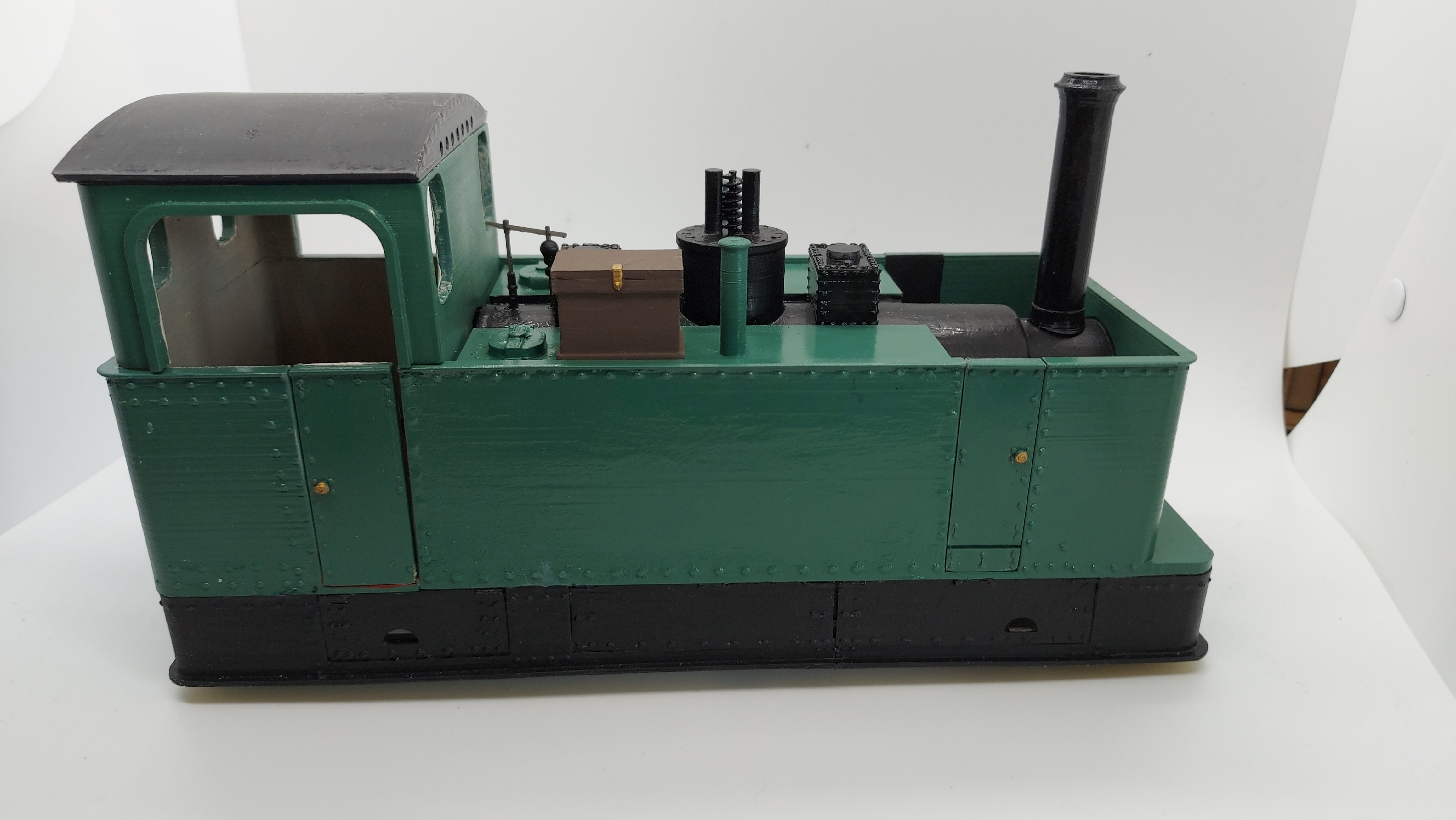

I have a rule that I won't start one project until I have cleared the backlog of others, particularly larger and more expensive things like locos. As the current Mrs Three Minutes of Fame was out for much of today, I had a chance to finish these two to the stage that I could take them for a run.
This is my Glyn loco, built from 3D files downloaded from here. It's fitted with a couple of motors, and a radio control, and has shown itself to be a powerful little loco. More pics in the Glyn Valley thread in 3D printing - https://gardenrails.org/forum/viewtopic ... 29#p174429

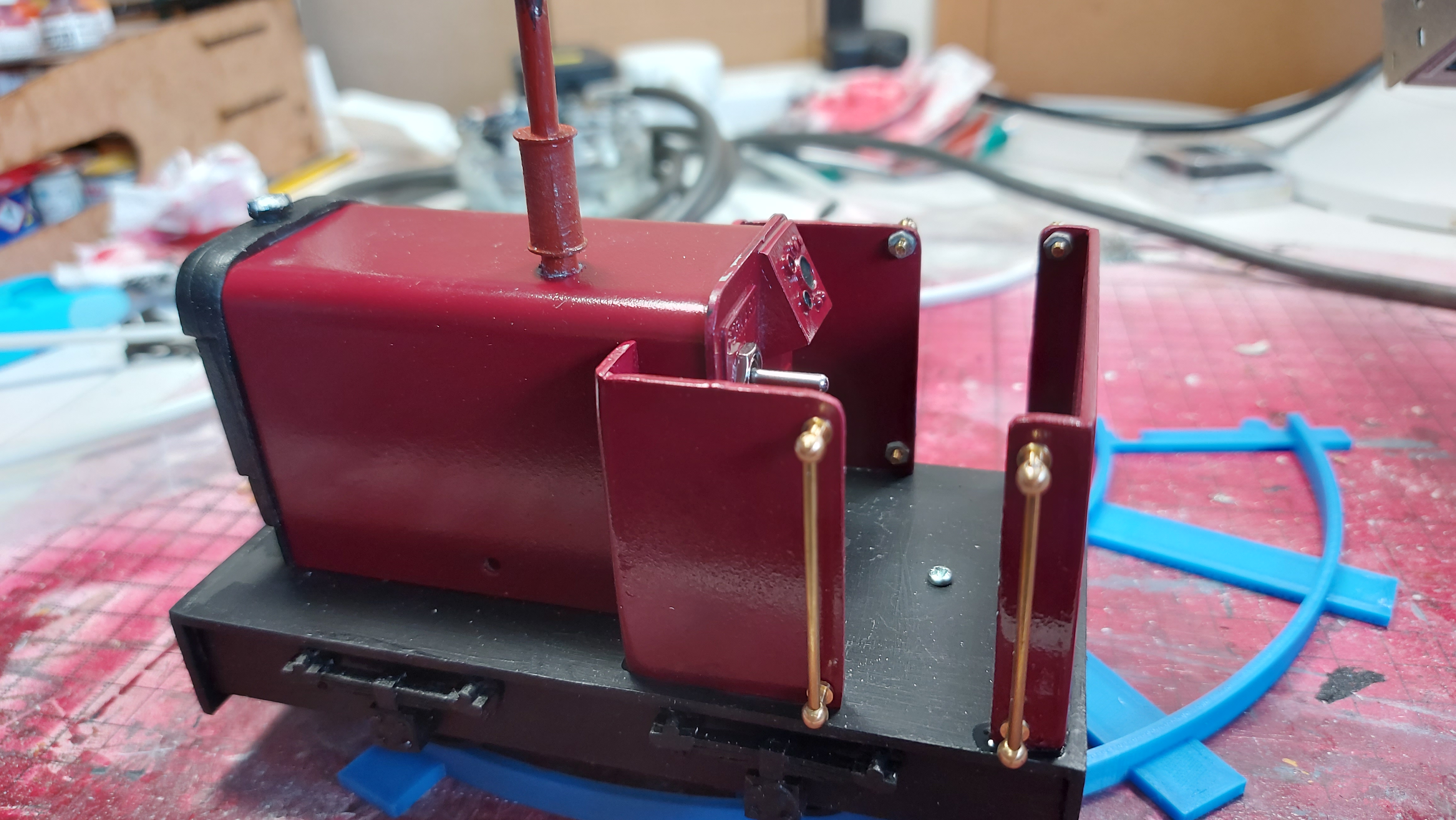

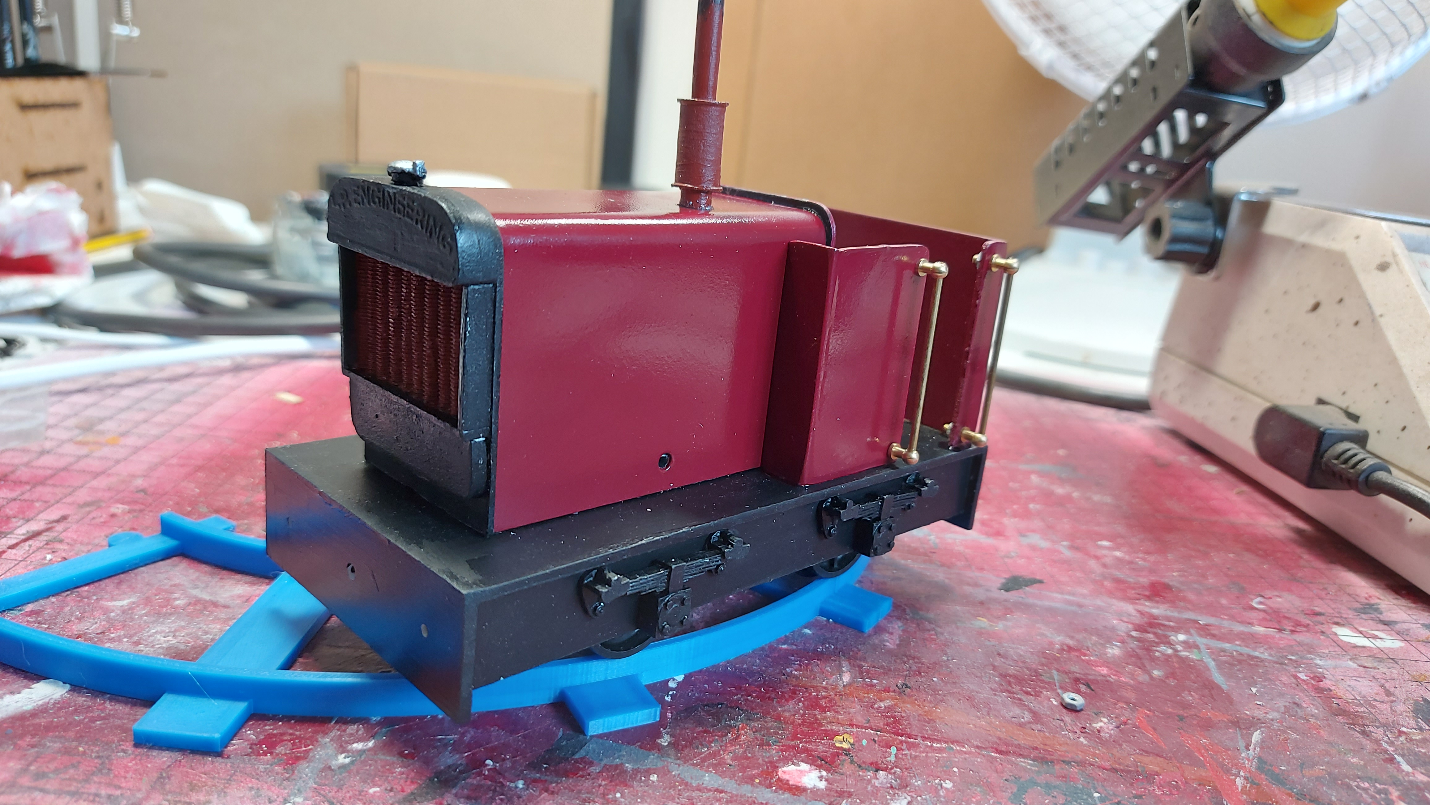

And this is a little IP Engineering Mary kit, bought last weekend from a model show, and just too cute to leave on the shelf too long. Pictured here on some Locoremote 3D printed track. (And yes, it will negotiate the curves!)
Some more detailing to do on both of them, but I think I now have the right to crack on with this..

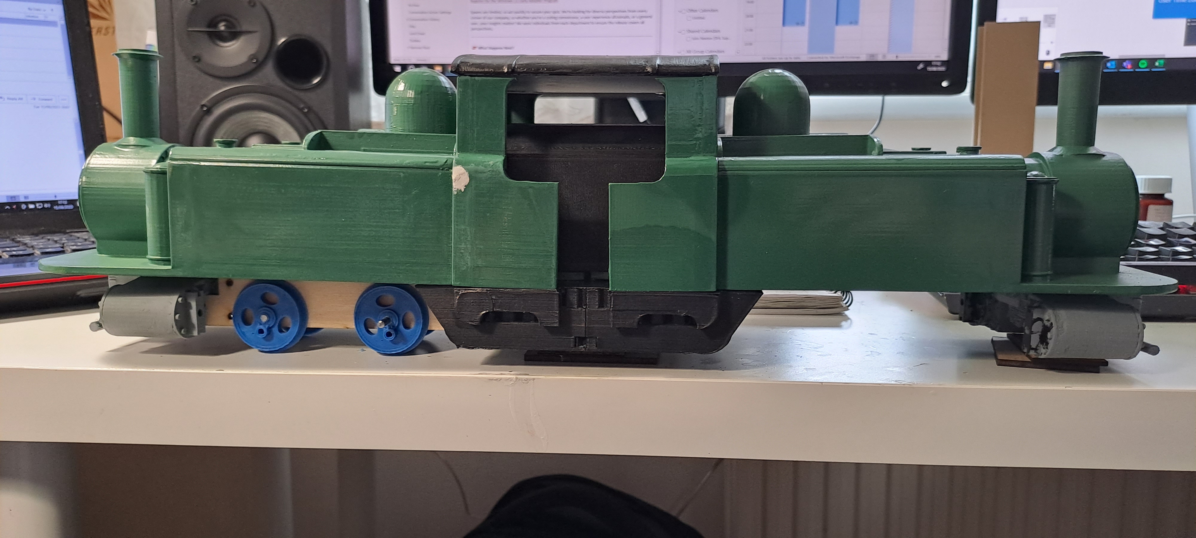

Regarding the Fairlie, it's a blow up of an 0-16.5 design, and will have a scratch built chassis with a couple of PDF Models motor gearboxes. It's printed on a modified Ender 3V2 printer, which minimises the lining effect, and uses Simplify 3d commercial software with surface ironing to give a really good finish. The model has a few gremlins in terms of poor geometry, which I've had to fix, but there's a few areas it's been easier to fill post print. I'm about 45 hours into the print so far, with around another 15 to go, to do the roof and cylinder blocks. It will be about 1.2Kgs of filament once all is printed, plus a CNC machined chassis and detailing parts.

Progress has been a little slow, but the Fairly Fairlie has had a couple of coats of paint, and I've built a couple more bug boxes. Train colour is a little lighter than FR paint their trains, but not as khaki as the photo might suggest.
I am hoping to get the chassis designed this week, and possibly even cut. Let's see how it goes..

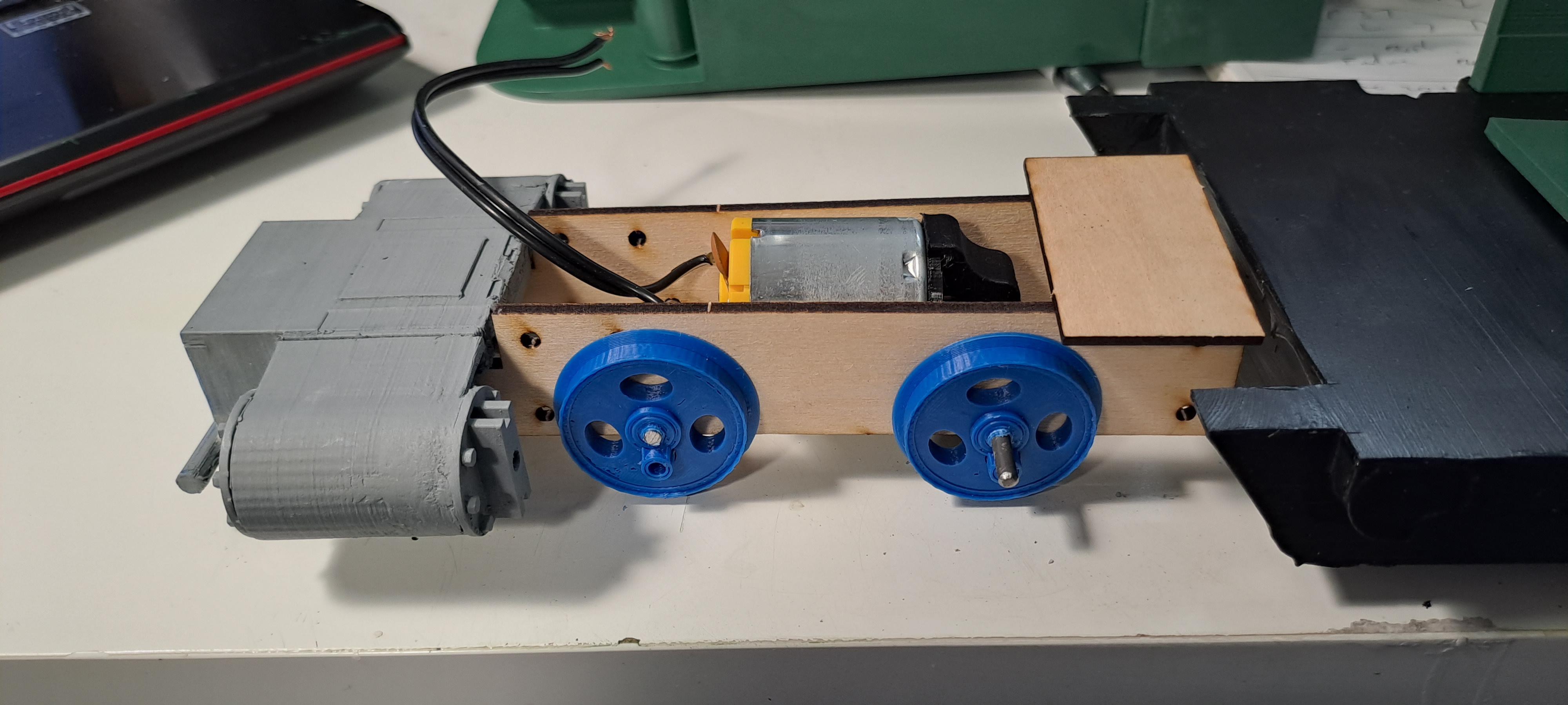

The Fairly Fairlie is coming along. I laser cut a chassis out of wood to check the fit prior to milling it out of aluminium. Wheel size might need to be increased, but they do need to be a little bit undersized to give more room for the bogie to swing.
- -steves-
- Posts: 2473
Re: A couple of locos ready for testing
Looking great so far. I have to agree about those wheels looking undersize, a quick fix I am sure
