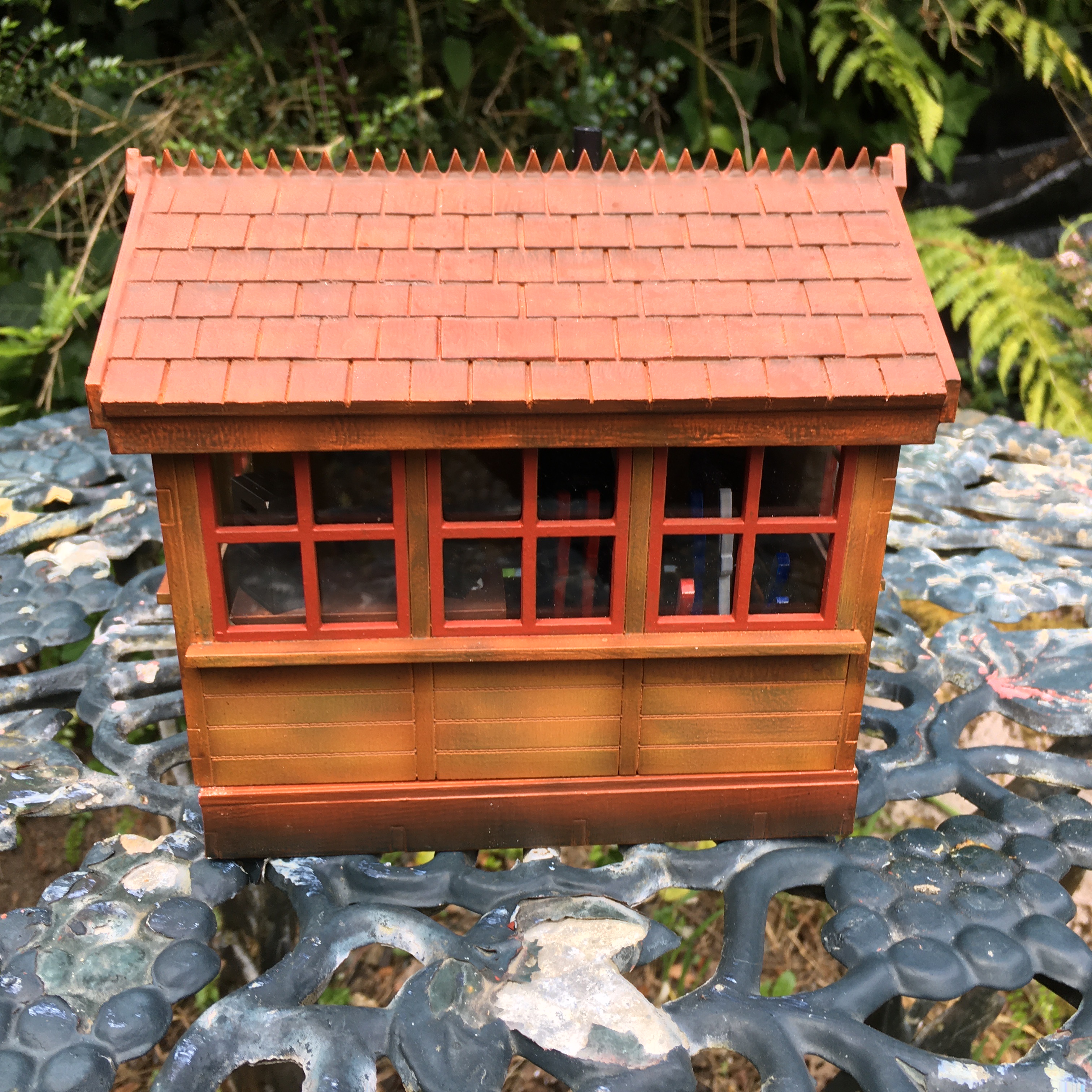

This is a signal box kit. Look at the roof. Firstly a thin line of black was airbrushed into all the gaps between the shingles straying from low down so the paint goes into the cracks. Then it was overpainted with the lighter brown, but with the spray directed from overhead so that the paint couldn't reach the cracks. Then a redder brown was painted on to the lower half of the shingles. Then the walls something similar but then concentrating on just opening the trigger to apply the darker paint around the edges of the panels to try to suggest the darkening of the wood in the ends of the planks.

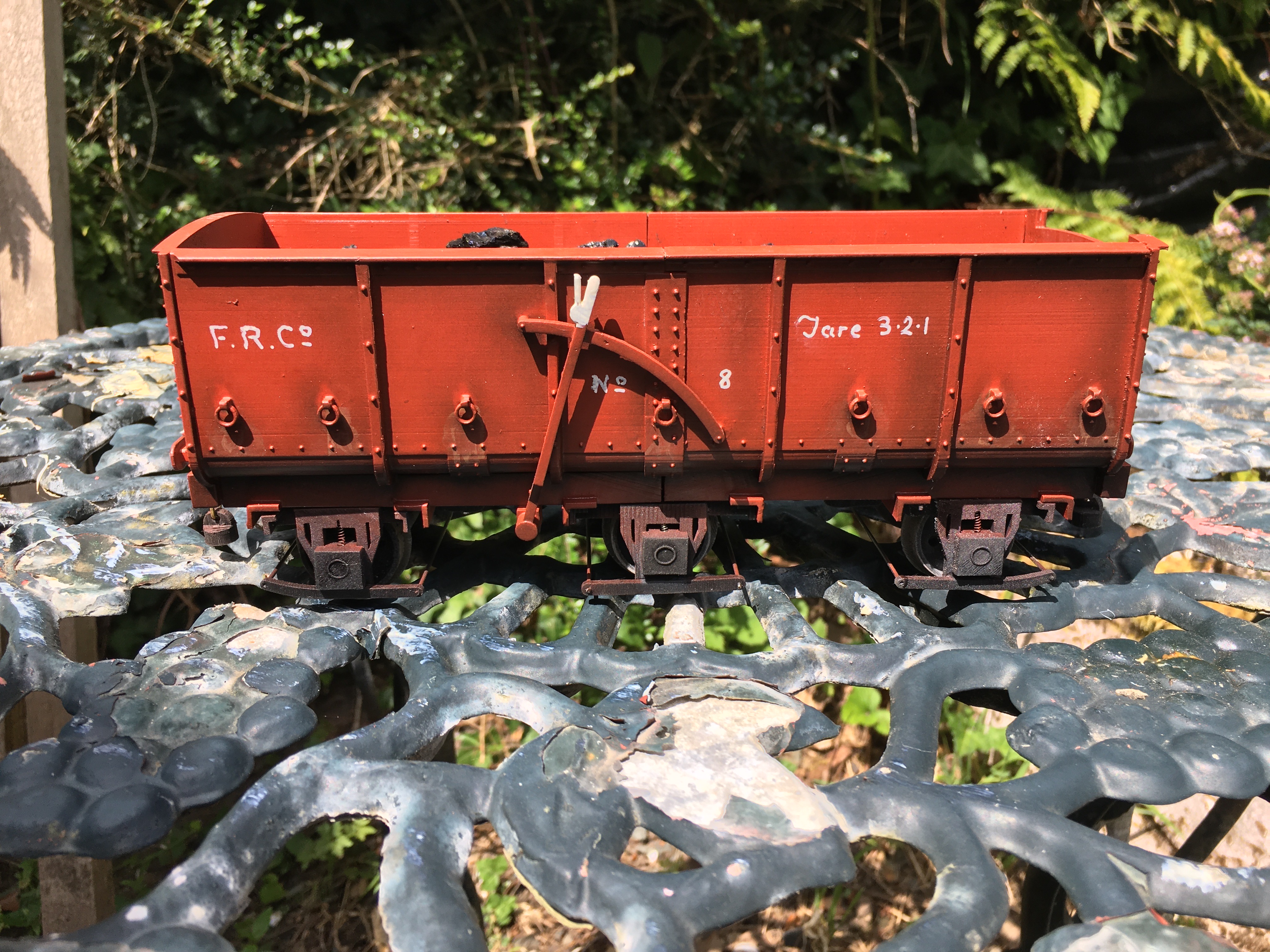

My Cleminson 6 wheel coal wagon. Painted all over with many layers of the basic red paint. Then a light spray of black, from low down, onto the chassis itself, and then very lightly from underneath to "dirty" the bottom of the body, trying to just get a thin layer of black where the dirt might accumulate. I noticed in photos that there ware rust marks below the rings - so a light covering of light brown just in those areas. Because it is airbrushed it fades out and is not and even coat - which is what it needs - I want it to look like rusty water has run down in rivulets.

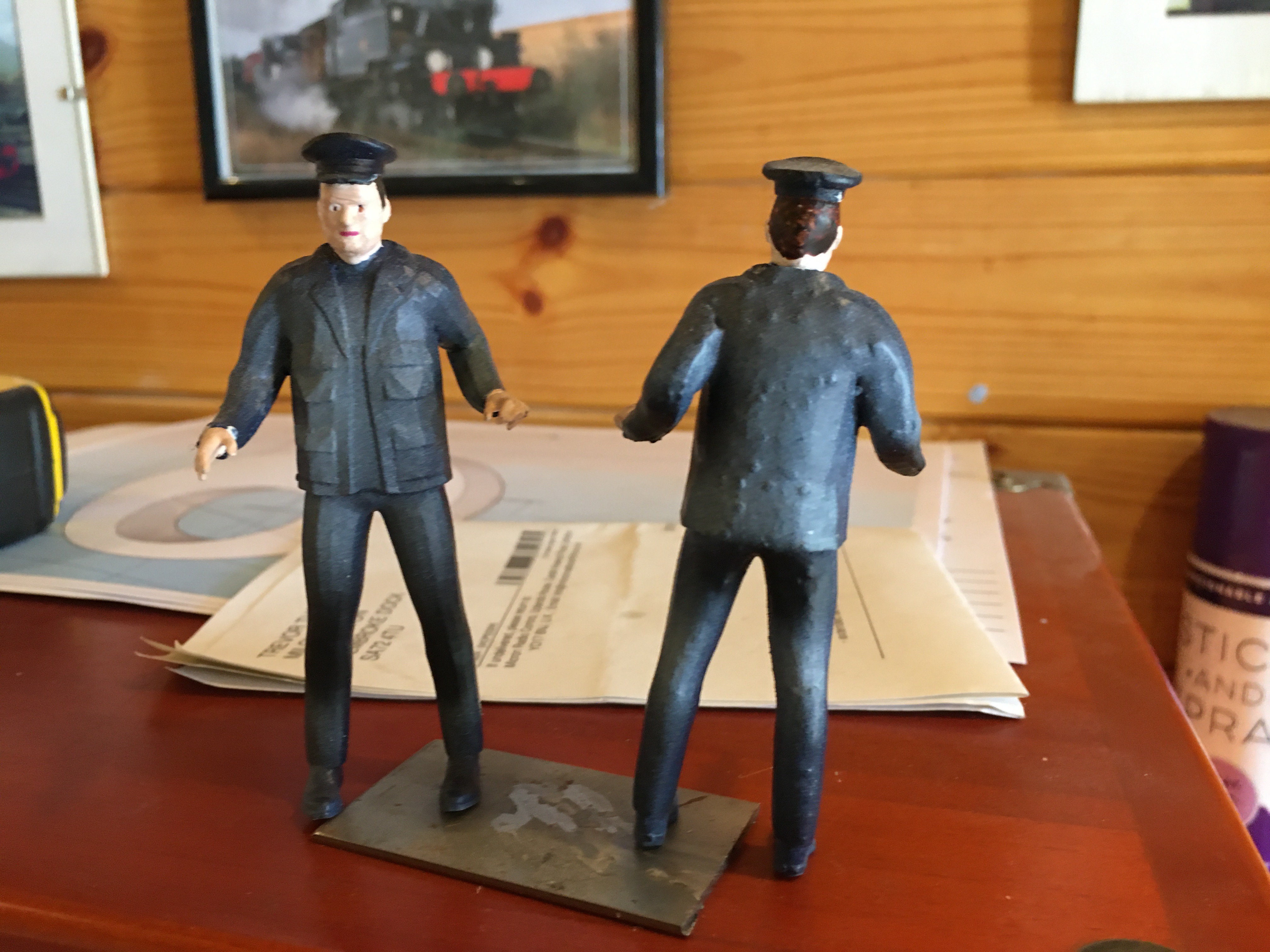

Lastly people. Bear in mind that I am modelling the 1870's and dark clothing at that time was not colour fast. Modern loco drivers may wear dark blue clothes but in that period many working clothes would have looked very faded. You can see photos of Ffestiniog drivers with dark marks above the knees, etc. So taking that as an explanation for what I am trying to do, The clothing is airbrushed (Hats included). Firstly the dark blue all over, a couple of coats to achieve a solid colour. ( airbrush acrylic are often slightly transparent which is intended to help with the creation of effects by building up different coloured layers). Then selectively light coats of lighter blue, and then even lighter coats of white. Then black lightly sprayed on all the places where clothes get dirty, knees bums, arms etc. You might not like what I have done - but I think it authentic for the period. Shoes airbrushed.
The faces and detail are all hand brushed. I try to include the whites of the eye and the eye ball - using a magnifying lamp.

PS The Cleminson waggon looks great Trevor!

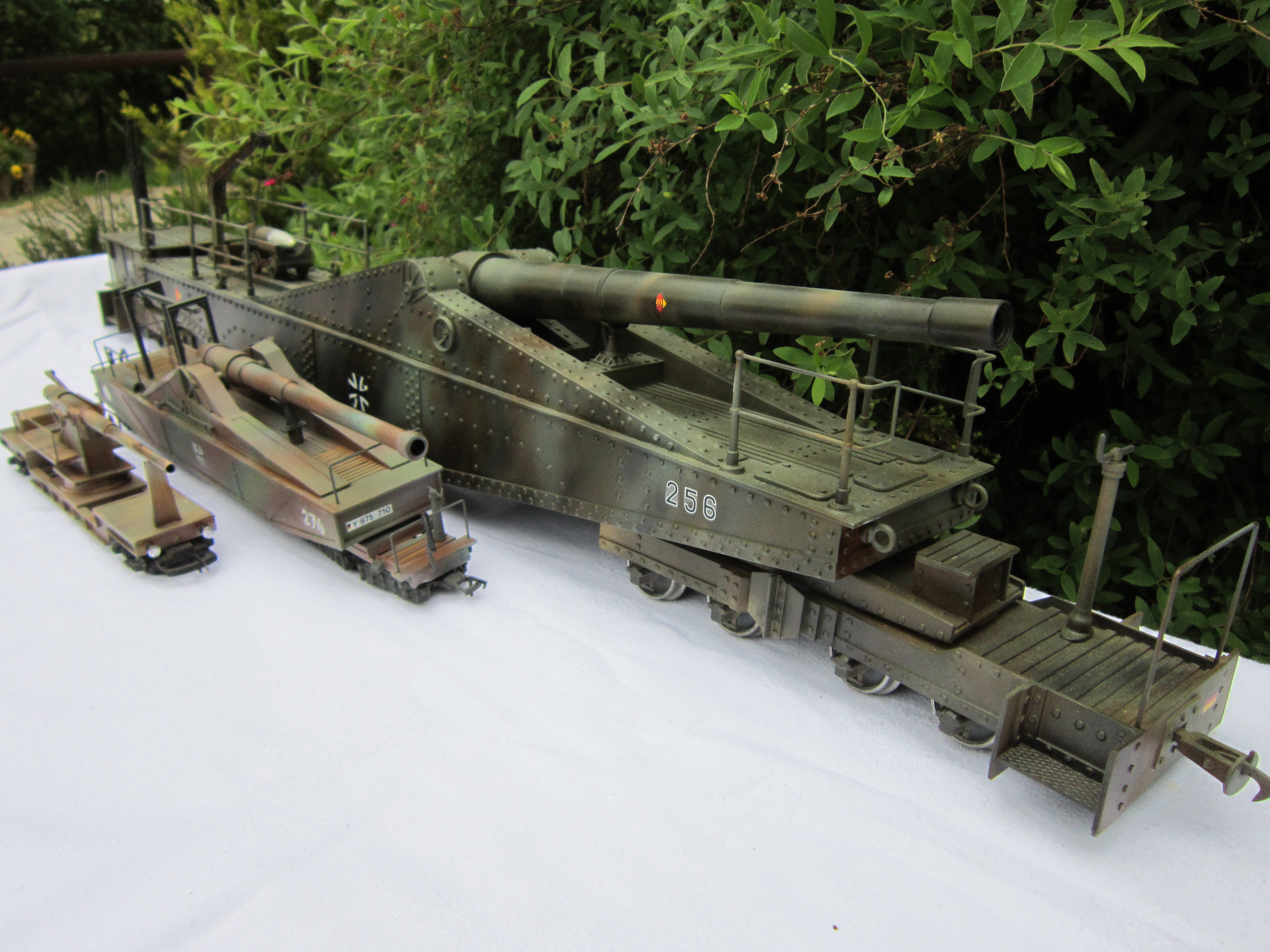

Cheap chinese - Always gives differing results, always gets blocked, a nightmare to clean and some don't even come apart all that much.
Unfortunately, as with most things, you do seem to get what you pay for although I honestly couldn't tell you what the differences are, other than one works well and one doesn't. As with all these things, this is just my personal experience.
If anyone has seen Hughie, that was all done on an airbrush.
Hope that helps.
