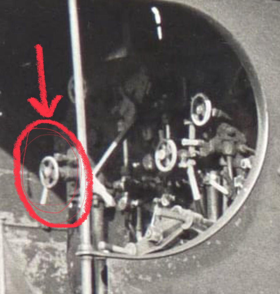

Does anyone know if there is a business who supplies little brass handwheels, like the ones found on locomotives and in ships? I mean the kind upon which one of the spokes sticks out farther than the others.
I think one of those would look nice on a Roundhouse loco in lieu of the solid brass knob on the gas regulator. I don't even know what these are called to do an online search.
Anyone seen one, particularly on a Roundhouse gas regulator? I have attached a photo of the kind I mean, and I've drawn red circles around it and a red arrow pointing at it, so yo7'll know which one I mean. :roll:

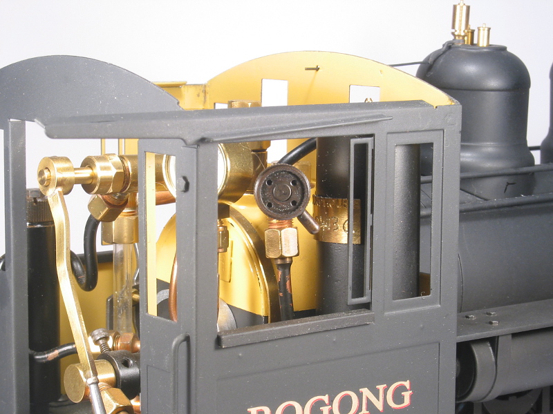

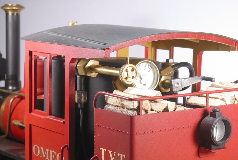

On recent models I've made and fitted gas valves disguised as a brake standard, but the photos show a modified RH gas valve knob that I've used on a couple of RH based models and a couple of sizes of scratchbuilt hand wheels used on other models.
If you've got a mate with a lathe they are easy to knock up. Even a Unimat would manage to turn them in brass.
The first pic shows the modified RH gas knob (which is 1/2" dia.) on my SR&RL #24 and the Hunslet saddle tank has one as well. The RH knob now has a decorative groove and some holes in the front face and the knurled section has been shortened a bit. The side handle is just a piece of 1/8" brass rod threaded M3 at one end that is screwed into the grub screw hole after the grub screw is fitted. The handle provides more leverage to adjust the gas and if you set it up right it acts as a pointer indicating the gas setting......

The last pic is the large 1/2" version of the scratchbuilt hand wheel that is fitted to the Accucraft Shay in lieu of the r/c crank that the factory fitted. I need to make another one of these for the Accucraft Climax when I start modifying it.
