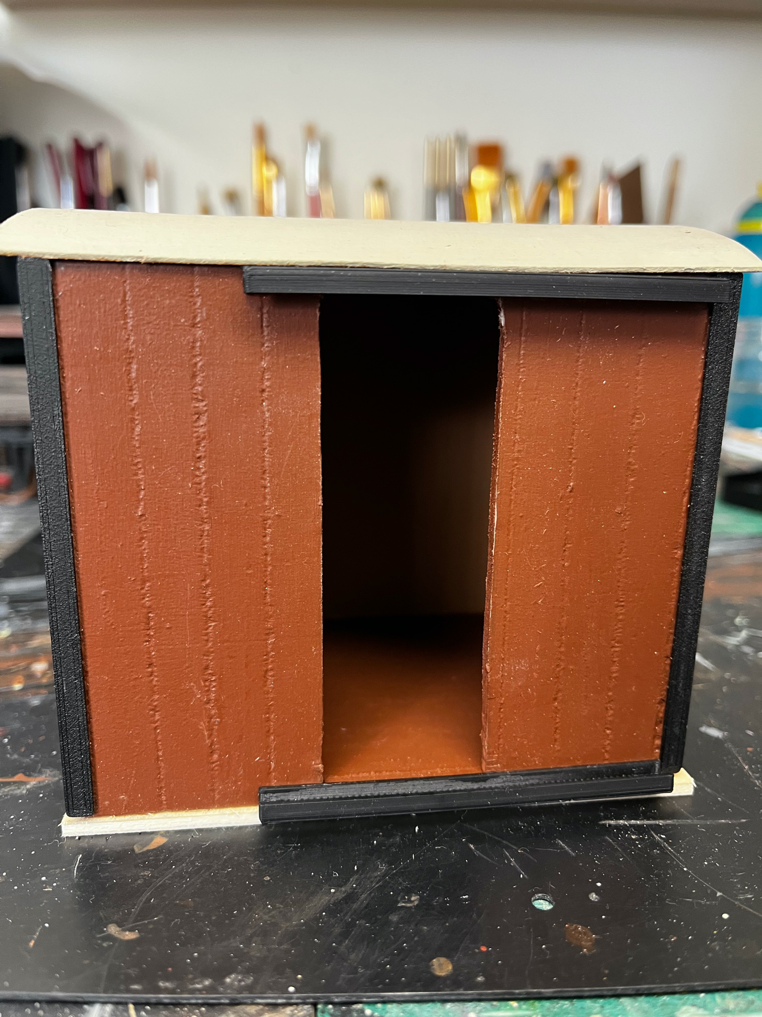

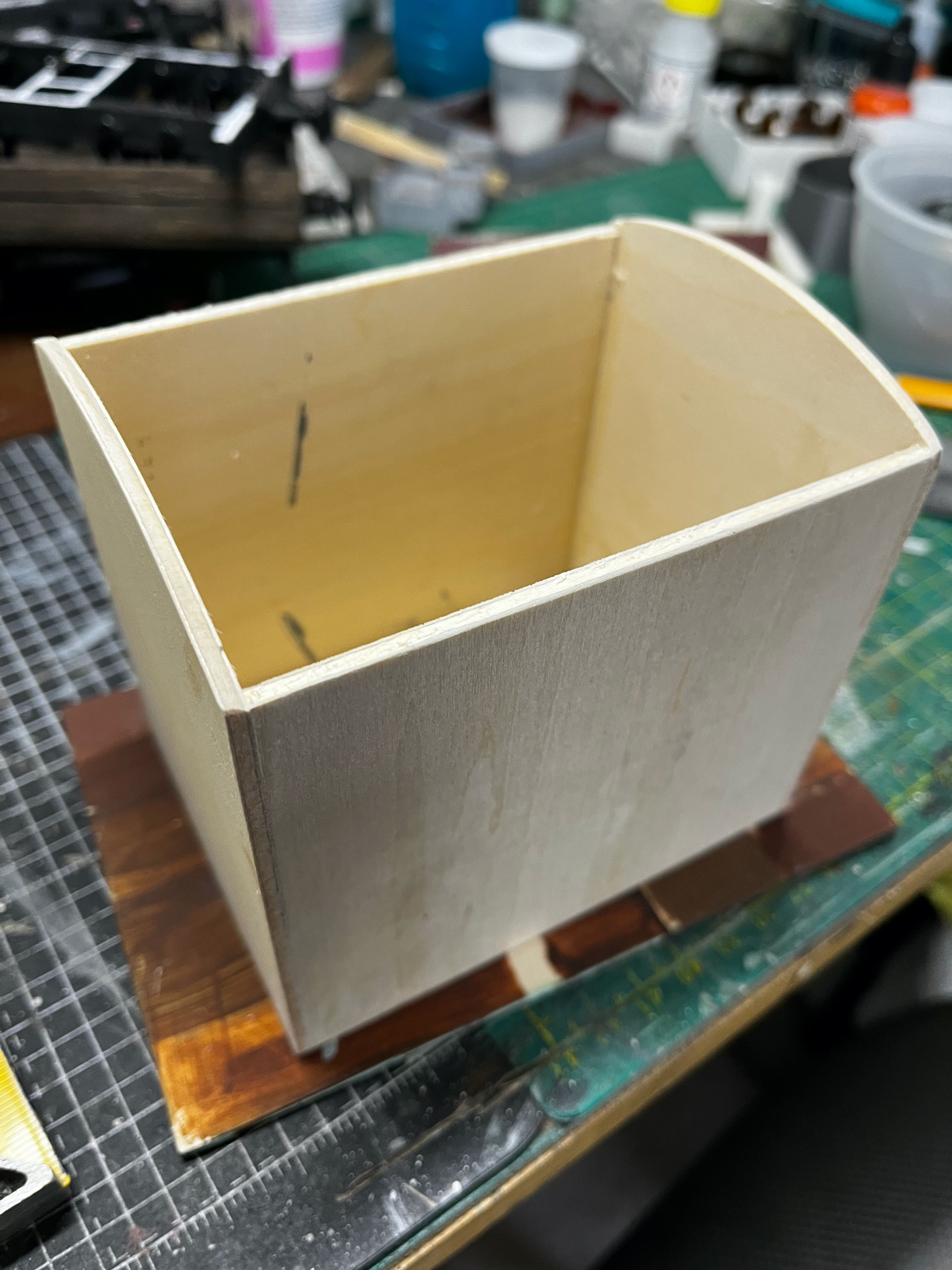

While I haven't been to good with those stupid health problems not allowing me to do much on our line, I have been busy with others things. Some railway related, some not. So I had been thinking at attempting to fully scratch build a van, of course without me making any steel wheels.. :roll:

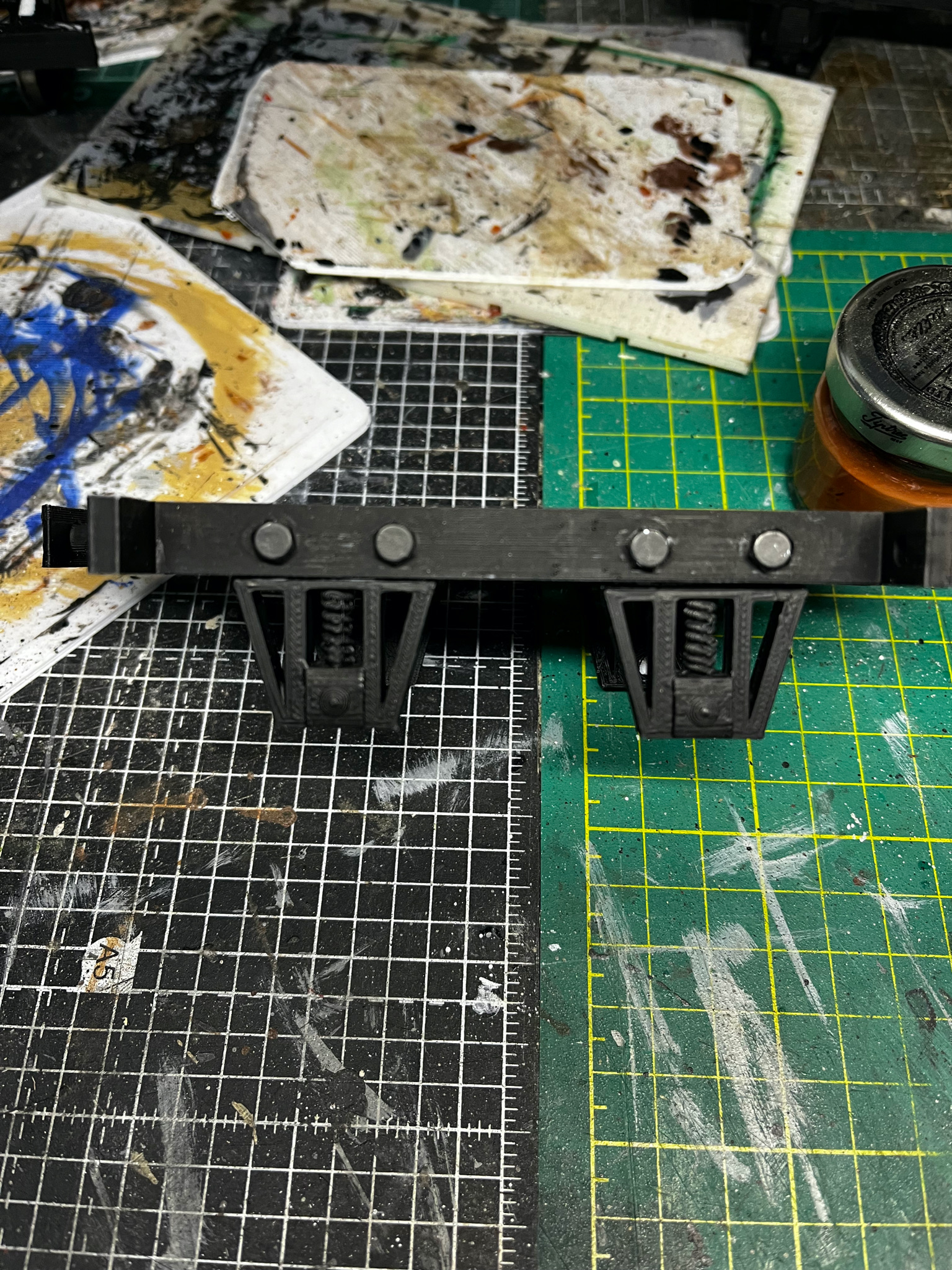

So I have now finished the van. It has taken me about 8 weeks, I know that's a long time. Members will remember I think, that I have been 3D printing some chassis, I did get a bit carried away with them though. :lol: :lol:
The van is made from ply and my own chassis and buffers. Me being me, I haven't taken photos of all the build. SORRY GUYS. :cry:
The chassis I used. It doesn't have any ironmongery on it.

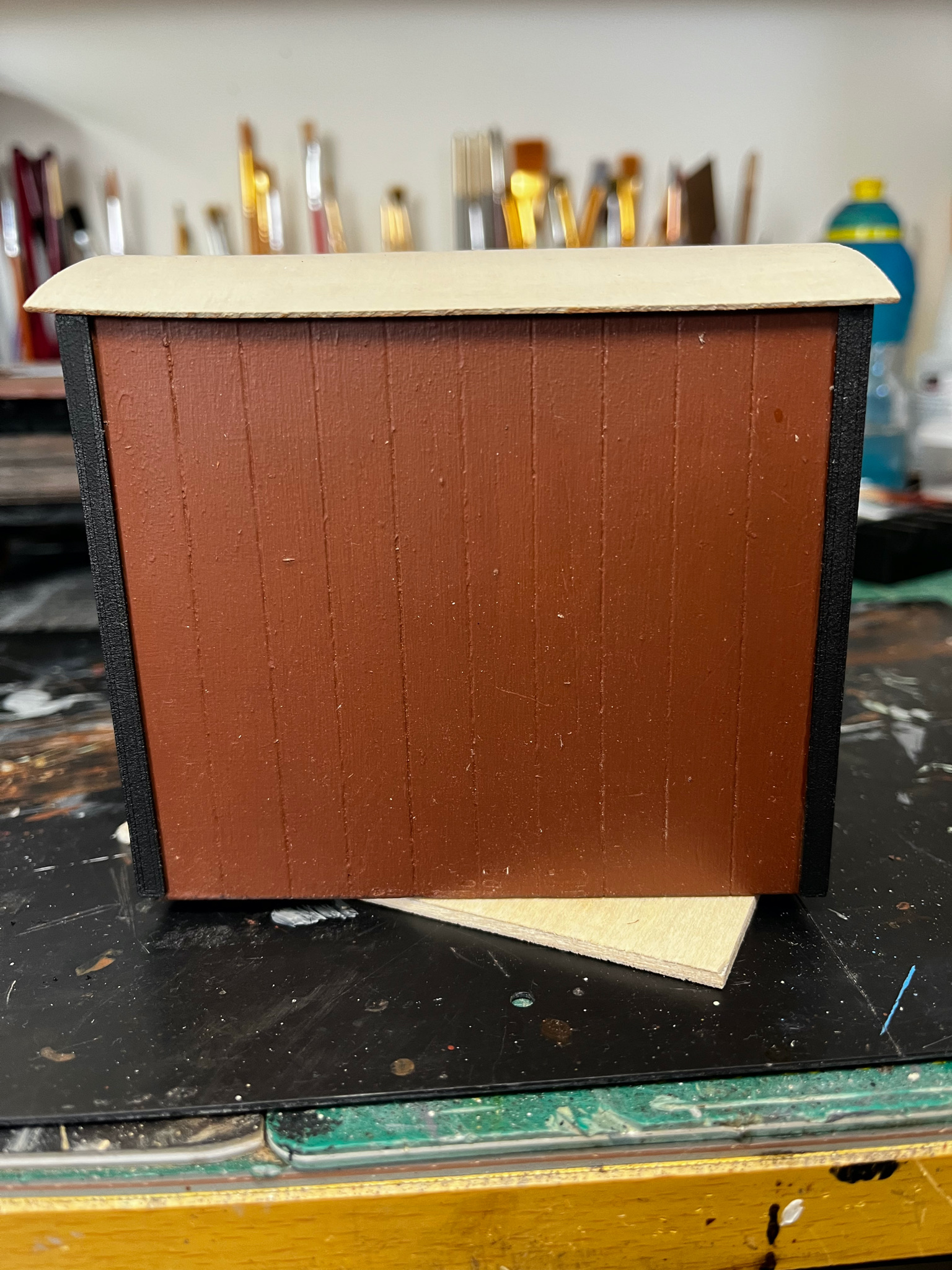

The build of the van without the roof, which I did with 1,5mm bassboard.
After painting it inside and out, I did paint the inside without the roof on. I realised I also didn't put any lines in for the separate boards. This blooming memory is getting worse... :lol: So I had to put them in after, it's not a job I recommend though. I sliced my fingers a few times :roll: Still I managed to pull it off I think.

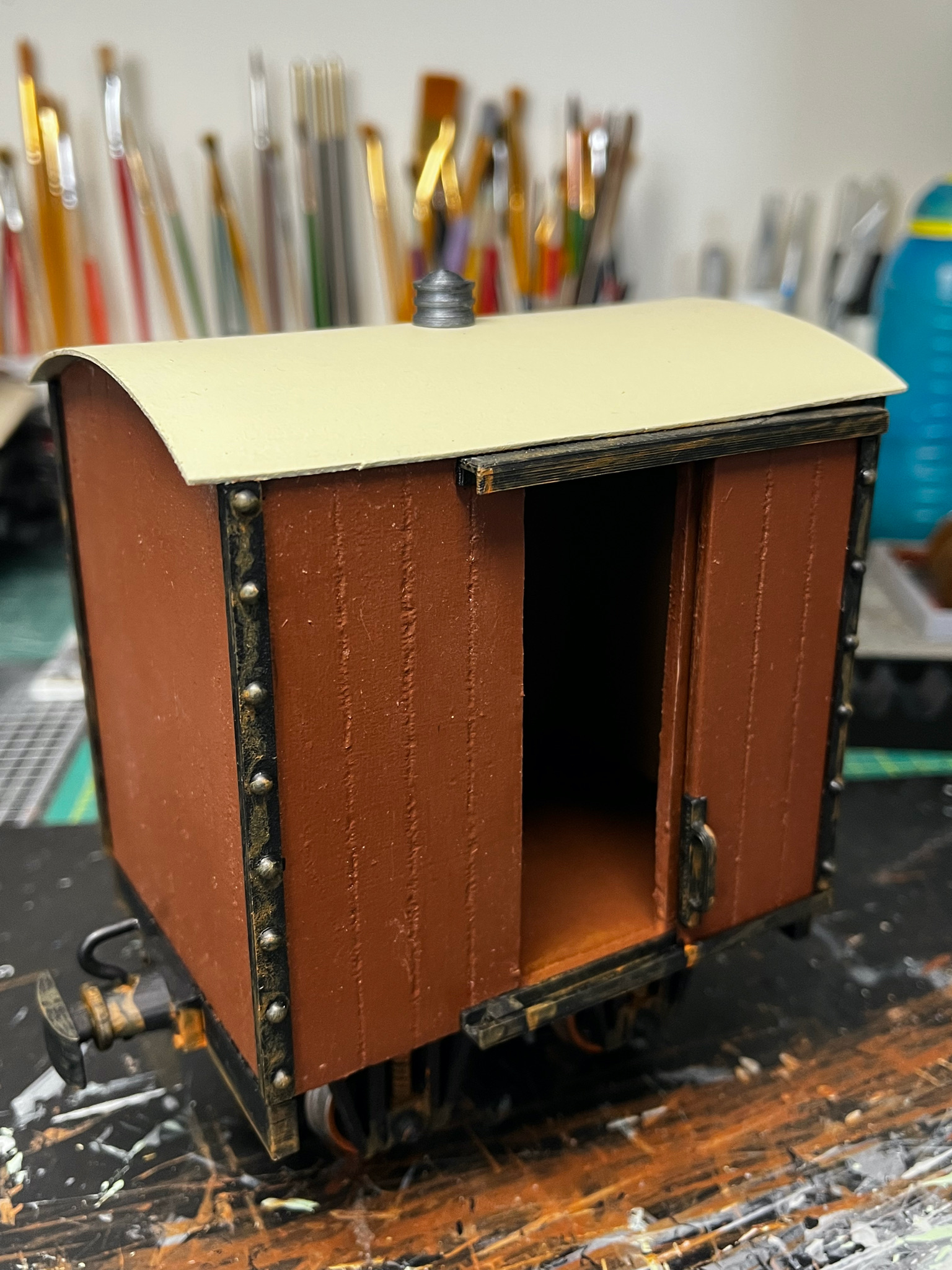

There was something I complete missed of course, how the heck do the railway workers get anything into the van. Now I could have just put some straps on and put a handle at it would have passed looking like it had someway of loading things, but me being me thought that wouldn't do. So out came the 3mm drill bit and drilled a series of lines along were I thought was the middle. I did measure it.... Then out came the little saw and cut through the remaining wood and smoothed off with sandpaper. It turned out ok I think.
The ironmongery was then 3d printed along with the door handle plus the roof vent Also little gem art were then glued on and a little bit of weathering and the van is finished.
It is a little bit light, tried it going over the bridge and around the very tight curve on the right of the line and it kind of stubbled.... a lot.....So some lead will be added underneath and then hopefully it will be ok.

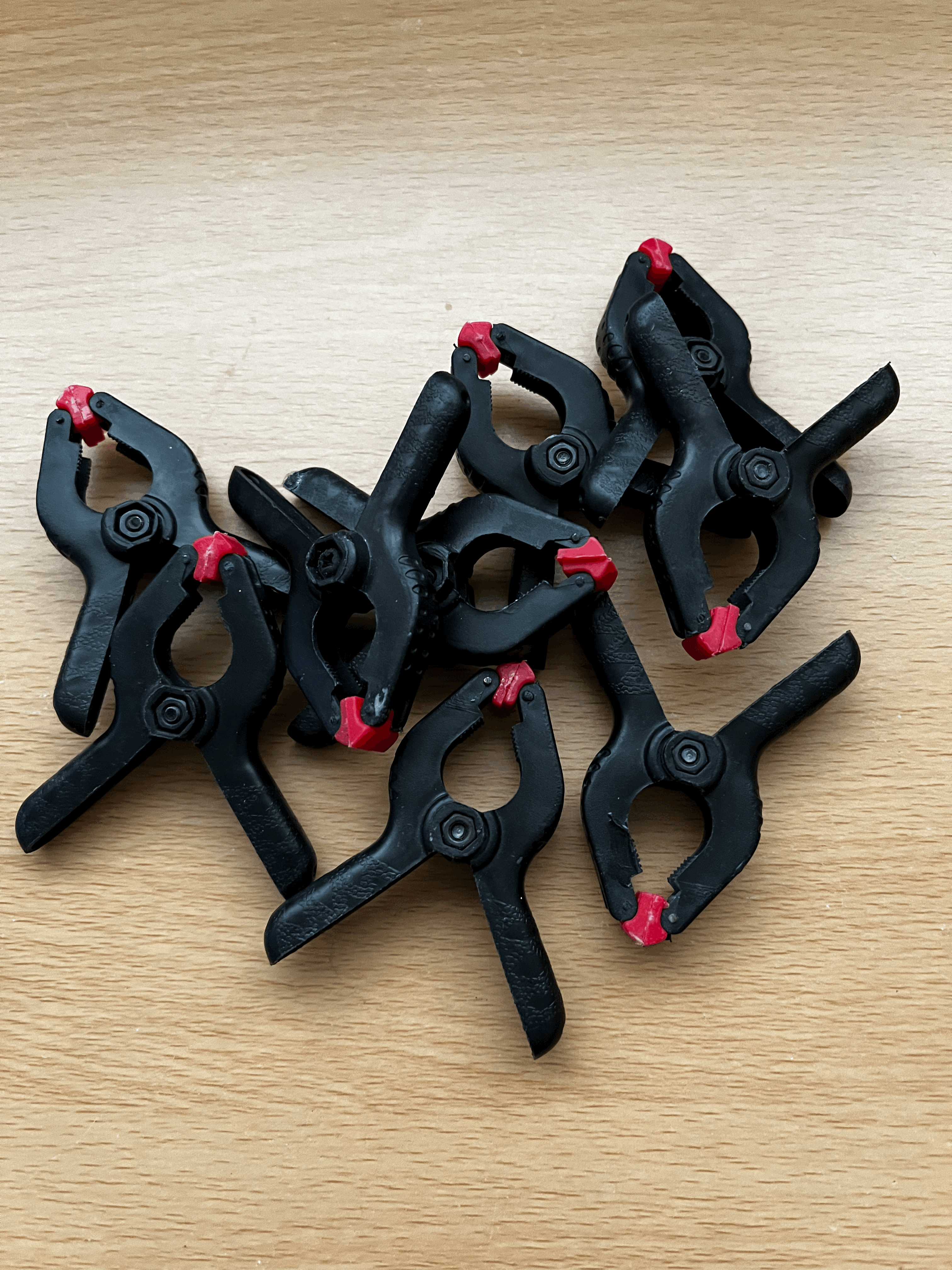

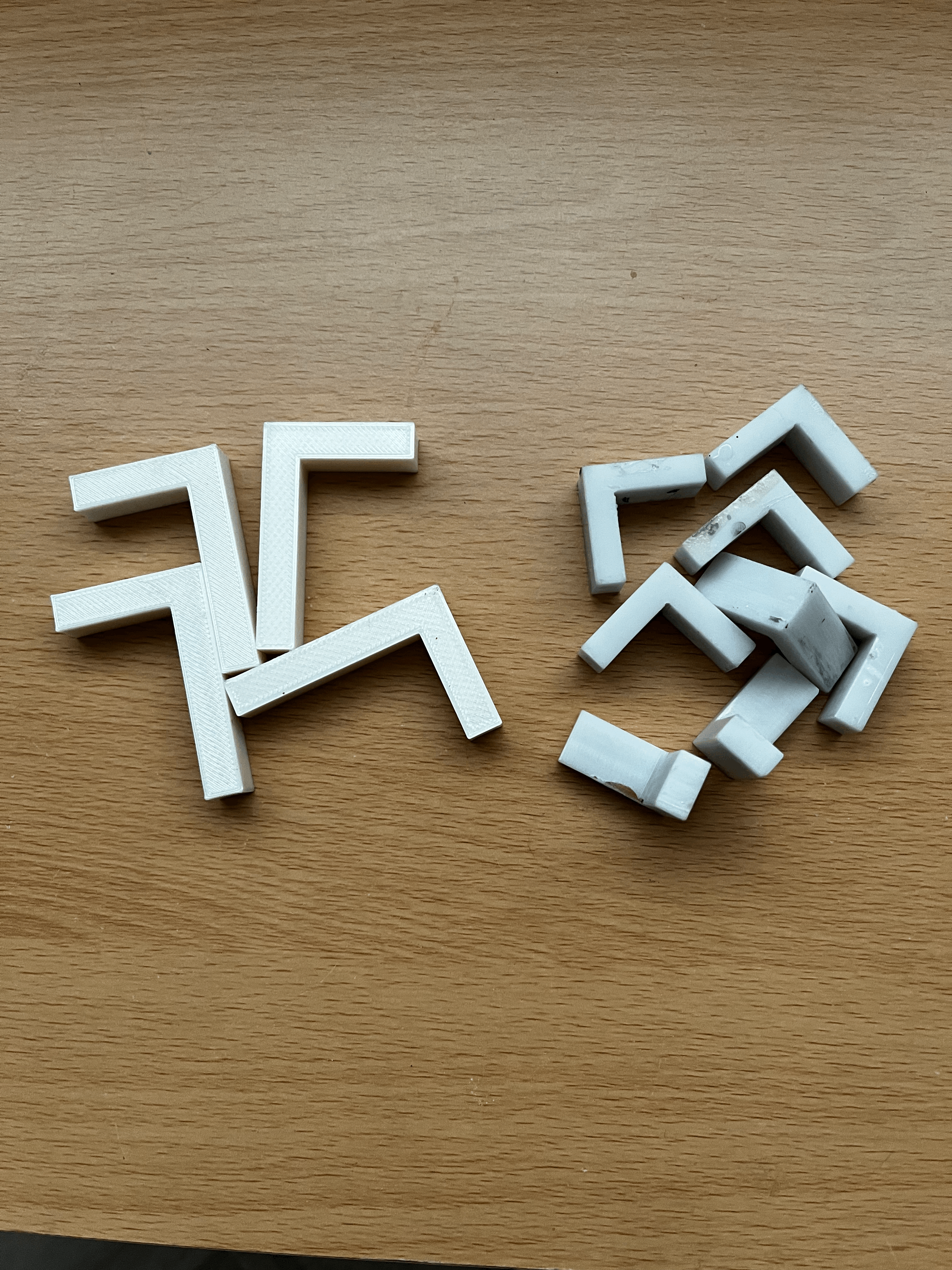

I've done some scratchbuilds, but I always have trouble with getting the corners to line up. I noticed the corners on this van are really neat... Do you have a trick for measuring/lining up the joints?
Re: LITTLE VAN FOR FWLR
Post by FWLR » Sat Jul 15, 2023 6:15 am
I use these Drew.
The small ones are ceramic and the longer ones I 3D printed.
I also use these small clamps.
Like this.
It's a bit fiddly, but it works. The same goes for the ends, but then I will use the longer ones. You have to remember to put the squares away from the glue, even the ceramic ones will catch a little bit. The 3D printed ones will stick no problem..Don't ask.. :lol: :lol:
In the photo I have used the larger g clamps to hold the middle of the sides down, because the small clamps are just that, too small....
Hope this helps Drew, with a little patience you will be able to get neat corners, well mostly if you cut your wood or HIP clean, by that I mean square. I use a little modelling saw for the bench now, Anne bought it for my Christmas last year. It is such a brilliant little saw, wish I had it years ago.

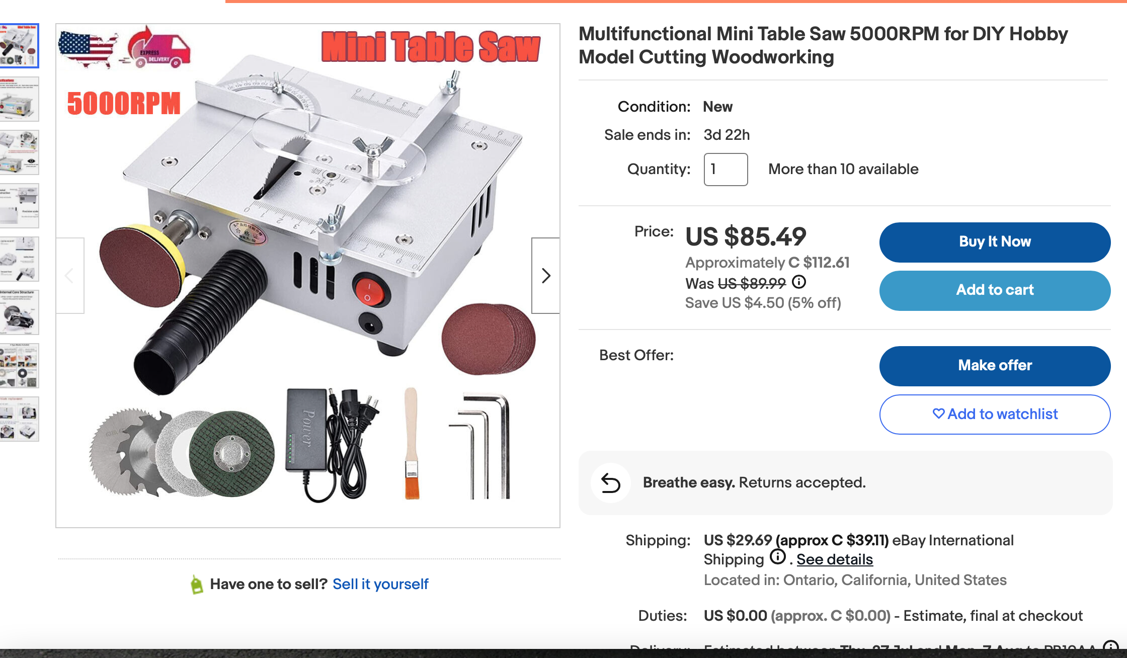

Nice jigs Rod, you've already got my gears turning. I'll see what I can come up with for the 3d printer, and I'll look into the modeling saw as well. I typically use my big bandsaw for the little stuff but it's hard to get a clean straight line on that, even with a fence.
Post by FWLR » Sun Jul 16, 2023 8:26 am
This is what I found on the web. It's in the USA and looks a decent machine, better than mine that's for sure. It has the advantage of a sanding disc and four blades.
I am not involved with this company, so it's your choice if you decide to buy one.
I would though...

I just love those 90 degree jig brackets that you use for making things square. I will be printing myself a few of these off. Thank you very much for the idea :thumbup:

Wow, that looks pretty good... I'd been looking into building a table and fence I could clamp onto my dremel, but this would certainly be easier. Hmmm.

No problem Steve, hope you get your builds nice and square now. It's very easy with them, just remember to keep any glue, especially super glue away from the squares otherwise it hell trying to remove them, believe me I know... :lol: :lol:
