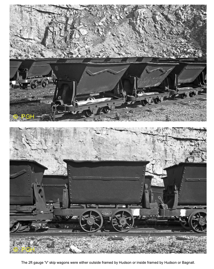

1. Operation - Do they hit the wheels when tipped?
I can see (from the interweb) that some internal framed skips and tipping mine cars have bars or stops to stop travel of the titled bucket. For other there doesn't seem to be stops - so does the skip body hit the wheels? on the side? or the tread? I can see that some may be prevented from hitting the wheels by contacting the chassis first - it just seems some bucket V shapes might not let this happen and some have wheel flanges really close to the top of the chassis. Some examples I am interested in are below question 2.
2. Does anyone know where I might find drawings of inside framed skips?
Here are the examples:
source: https://www.rmweb.co.uk/topic/72947-ici ... the-1960s/
The Bagnall inside frame skip (in the lower picture) doesn't seem to have any method to stop skip body hitting wheels.
Source MERL online archives https://www.reading.ac.uk/Adlib/search/simple Source Leeds Engine site http://www.leedsengine.info/leeds/galle ... owler/Misc

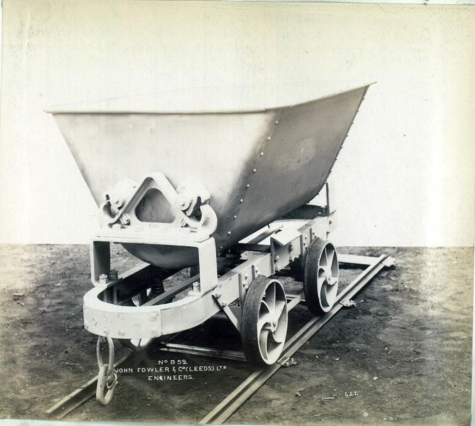

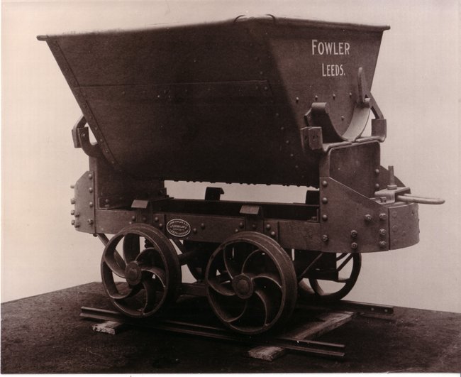

And these two John Fowler have stops.
Many mine tippers don't seen to have stops either
All help gratefully received!
Andy

I think the lower ones tip until the skip hits the angled plates on the frame?
Those in the other pictures, have reinforcement along the sides, and I think that contacts the frame when tipped?

Thank you for the reply and ideas Phil. The Fowler's definitely have stop plates. The Bagnall doesn't seem to have anything. The only thing above the the chassis looks to be the bolts for the axle boxes.

I think the reinforcing bars on the skip body are there to act as the contact point on frame/wheels on the wagons in the top pictures.

Looks like those plates bolted to the side of the hopper are designed to protect it from dints caused by the wheels. I suppose the added advantage is that the bucket acts as a brake while the load is being tipped.

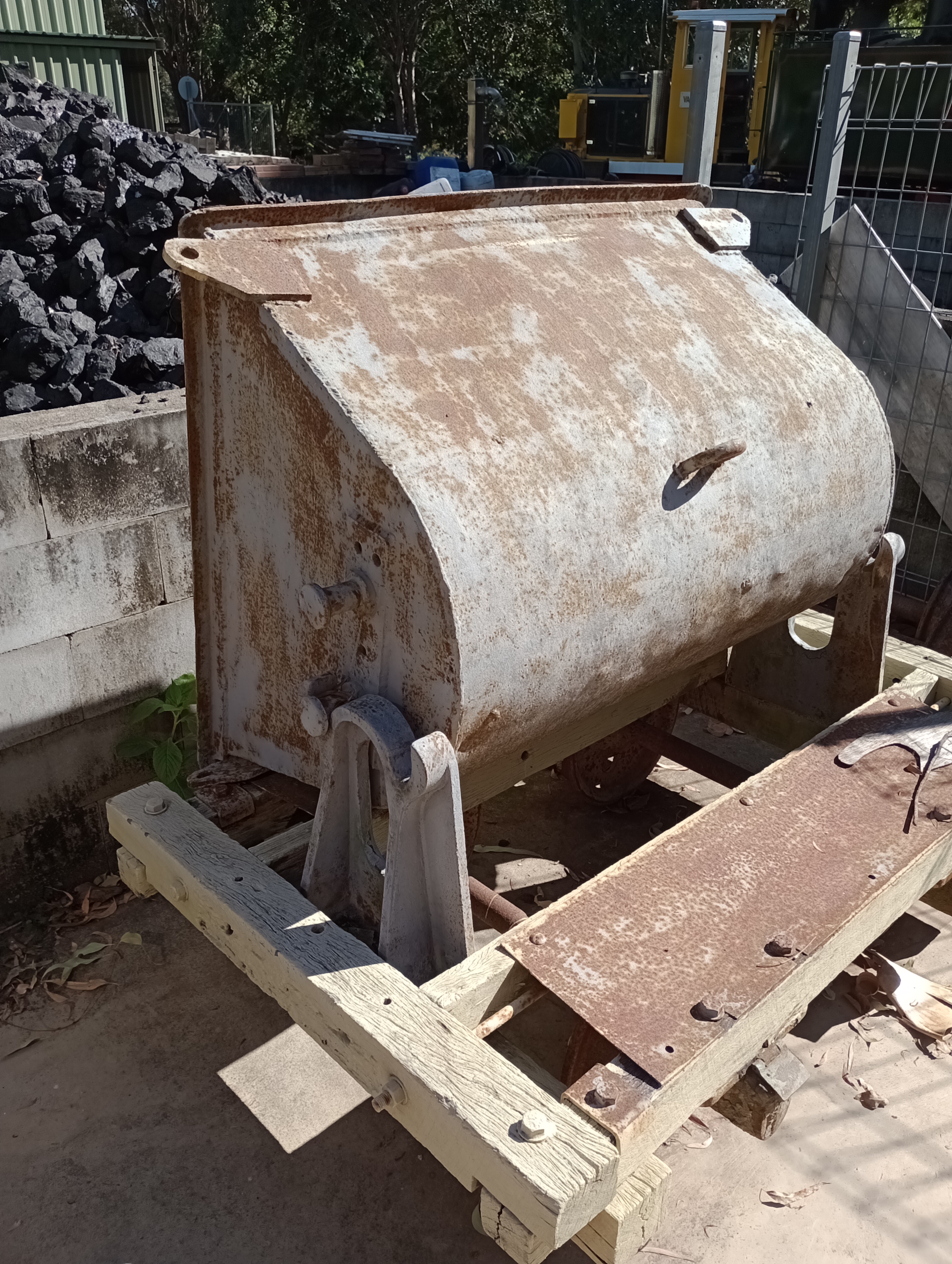

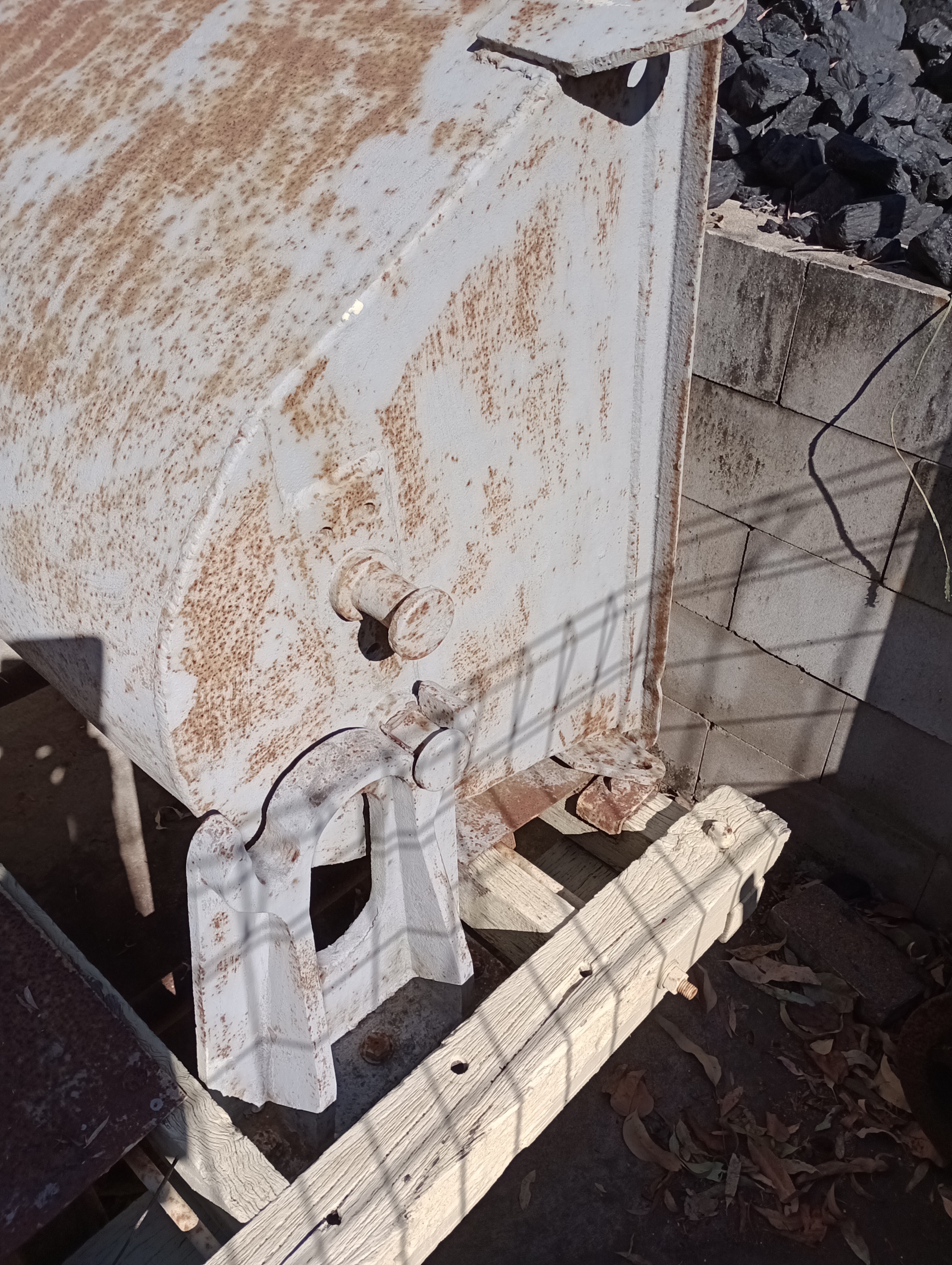

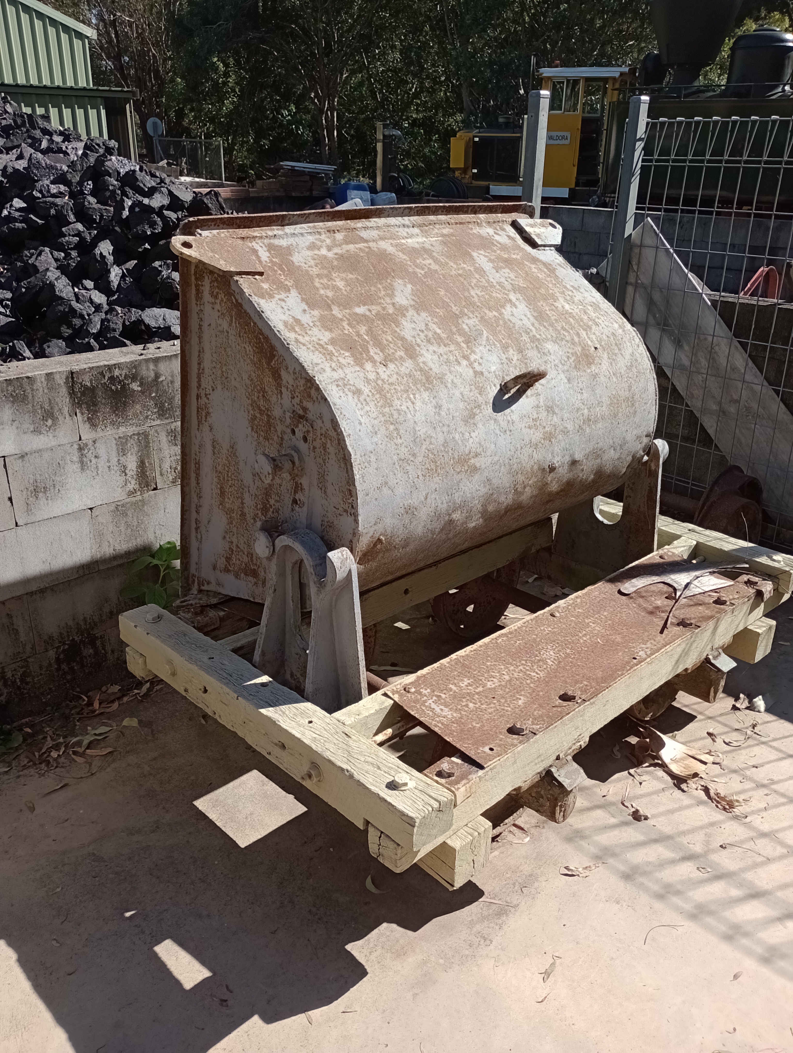

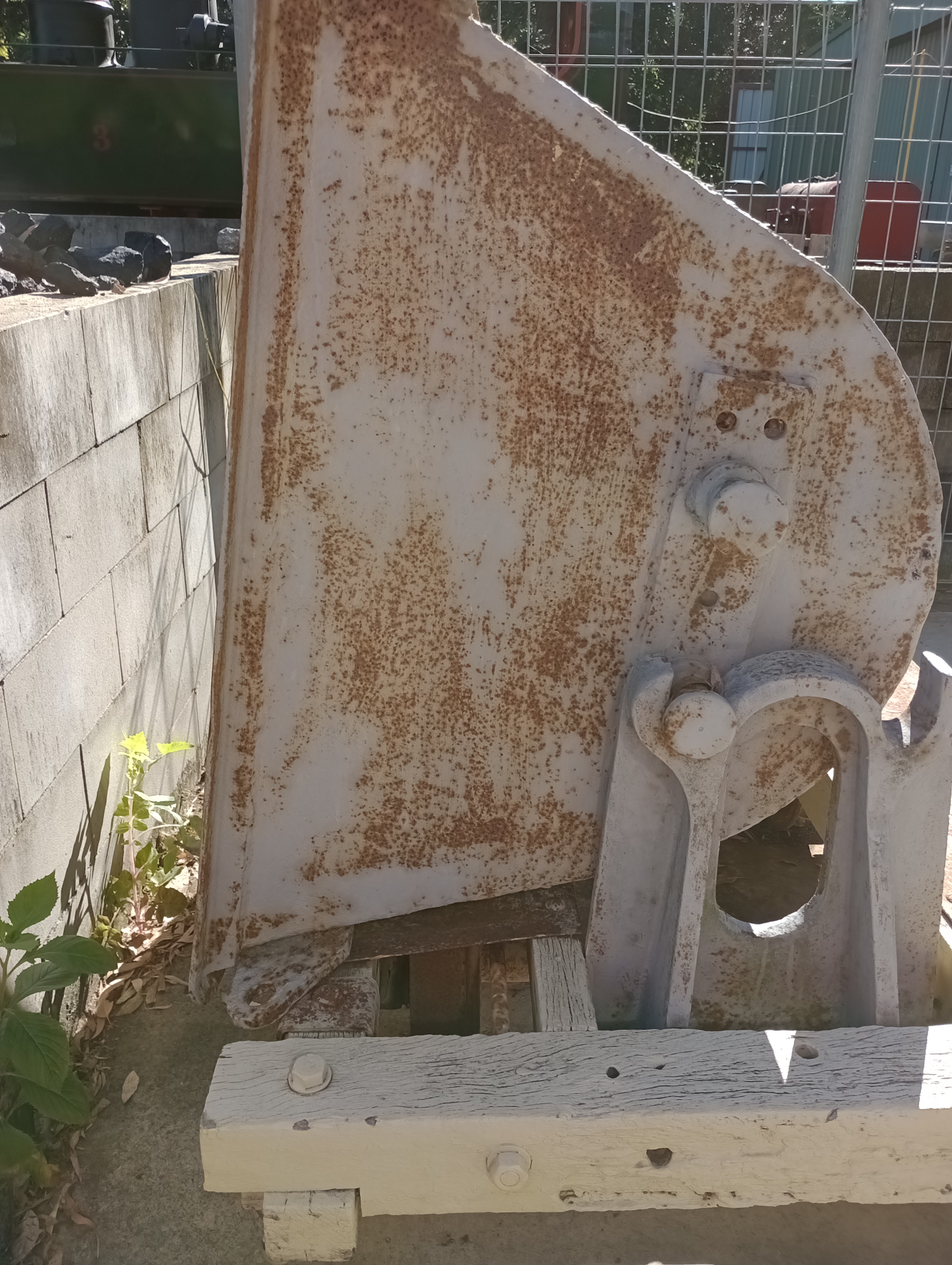

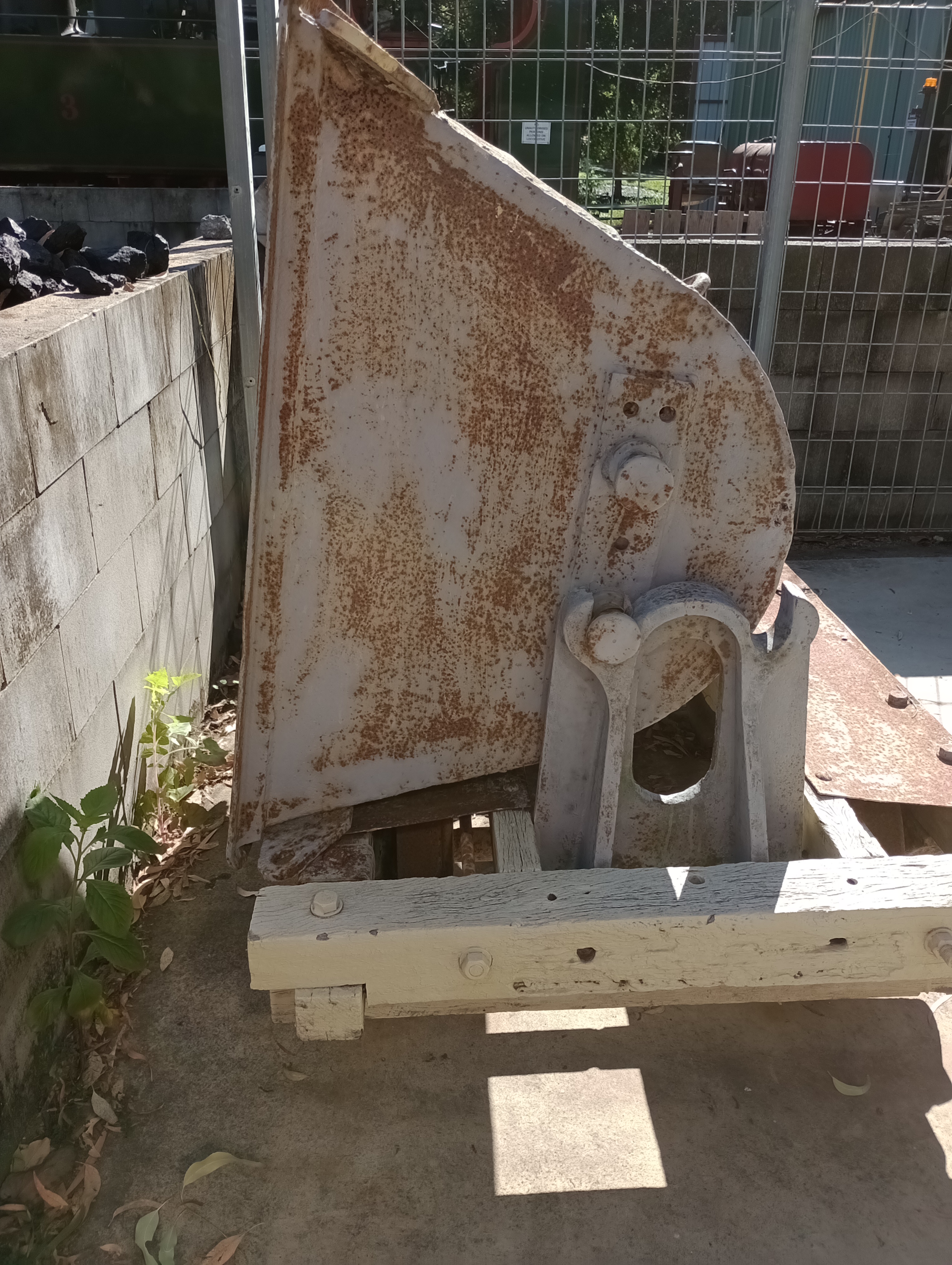

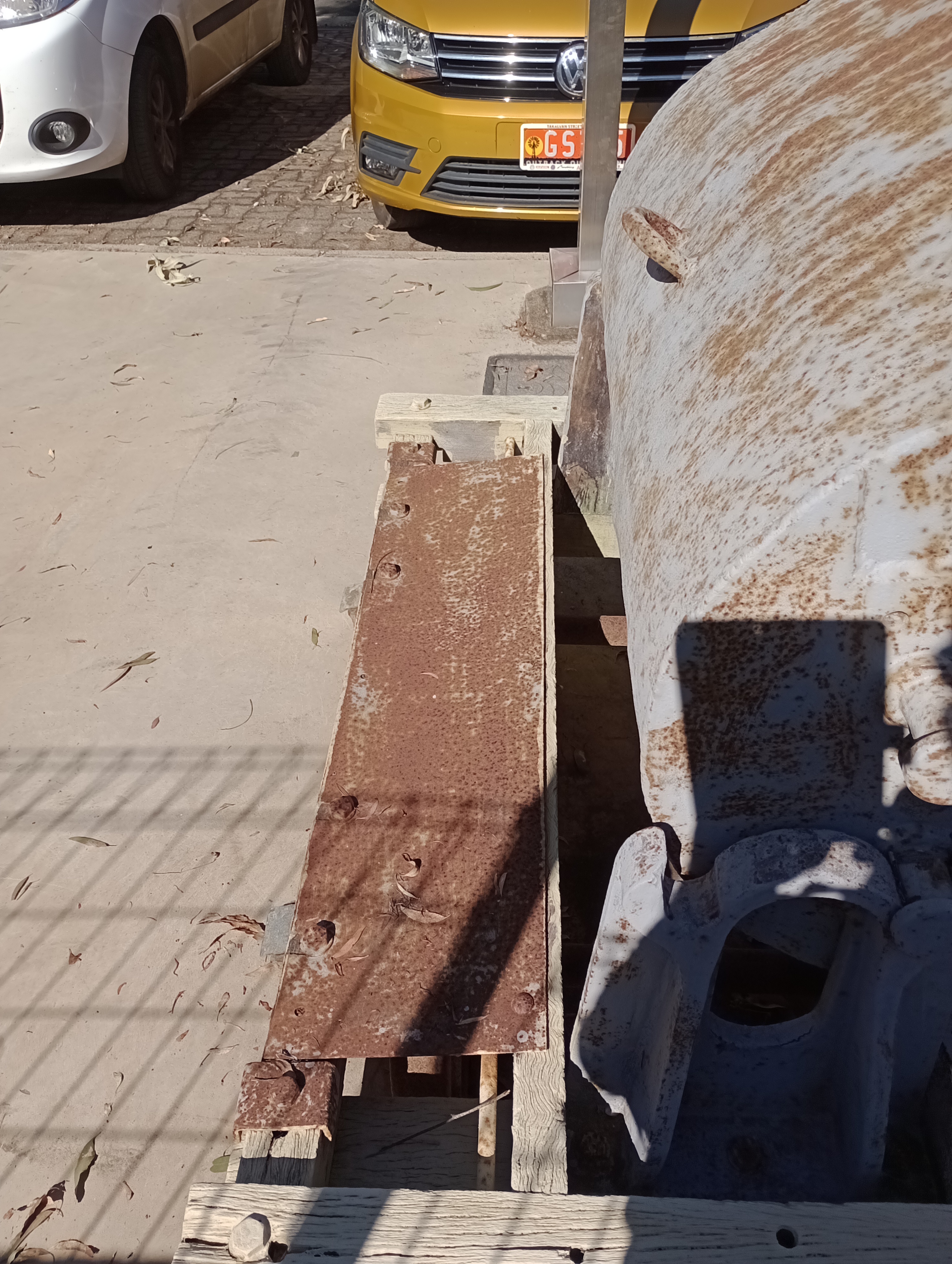

Here are some pictures of a skip wagon that was used on sugar cane lines to haul ballast.
It is displayed in the tipped position they may be of some use to your research.

Harris0169
- Posts: 17
- Joined: Sun Sep 02, 2018 8:39 pm
Re: Questions: Inside Frame Skip Wagon - Operation and any drawings
Hi Graeme
Many thanks! Very helpful and informative.
Thank you for taking the time to post these
All the best
Andy
All the best
