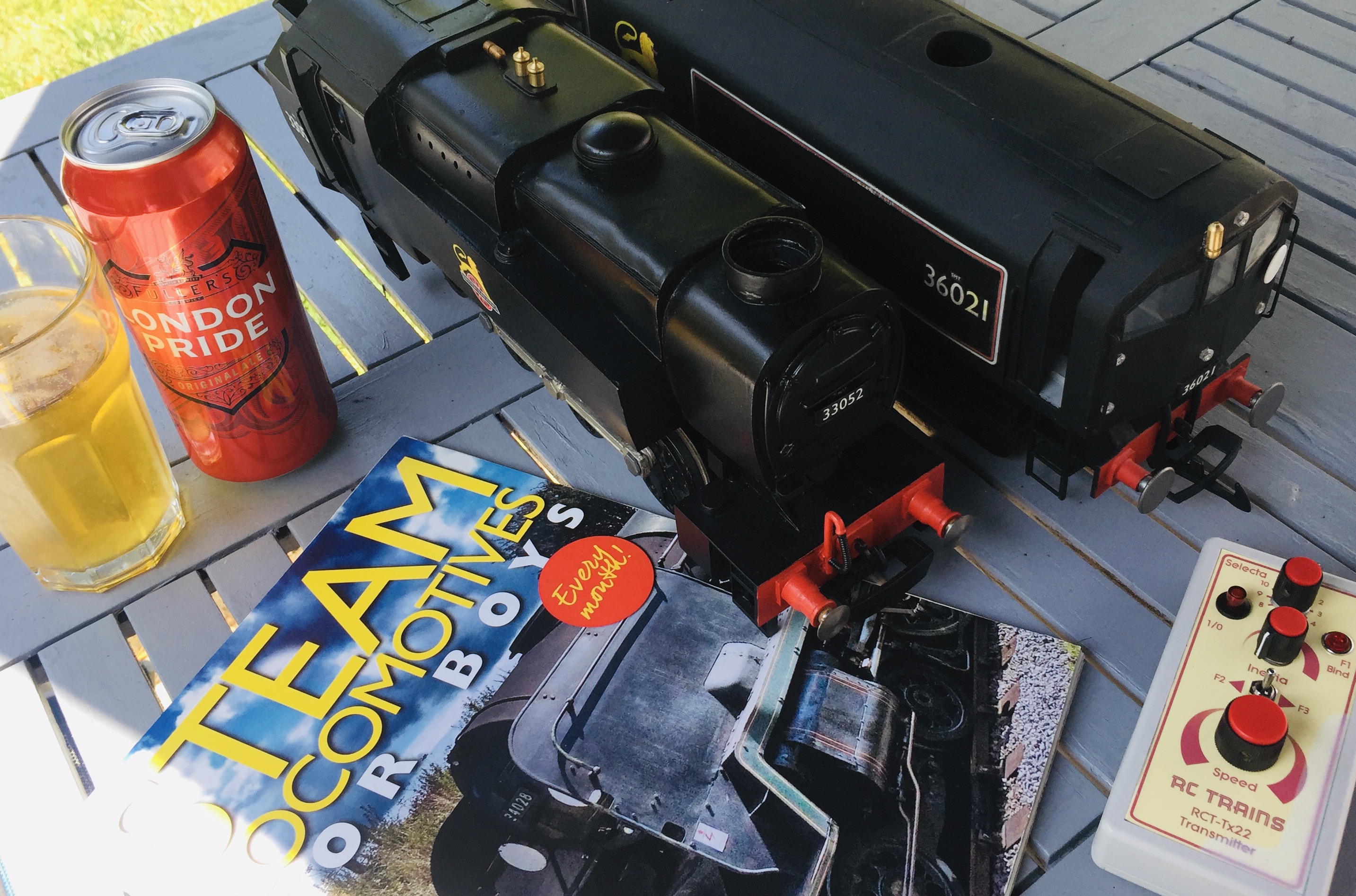

Most on the forum do 16mm — but here’s some semi-G-scale Bulleids, shot for a video a couple of years ago. I suspect you can tell that whatever’s in that glass, it’s not London Pride.

Marvellous looking transmitter that .......BertieB wrote: Tue Feb 14, 2023 10:10 am Most on the forum do 16mm — but here’s some semi-G-scale Bulleids, shot for a video a couple of years ago. I suspect you can tell that whatever’s in that glass, it’s not London Pride.

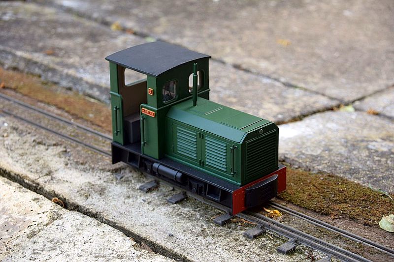

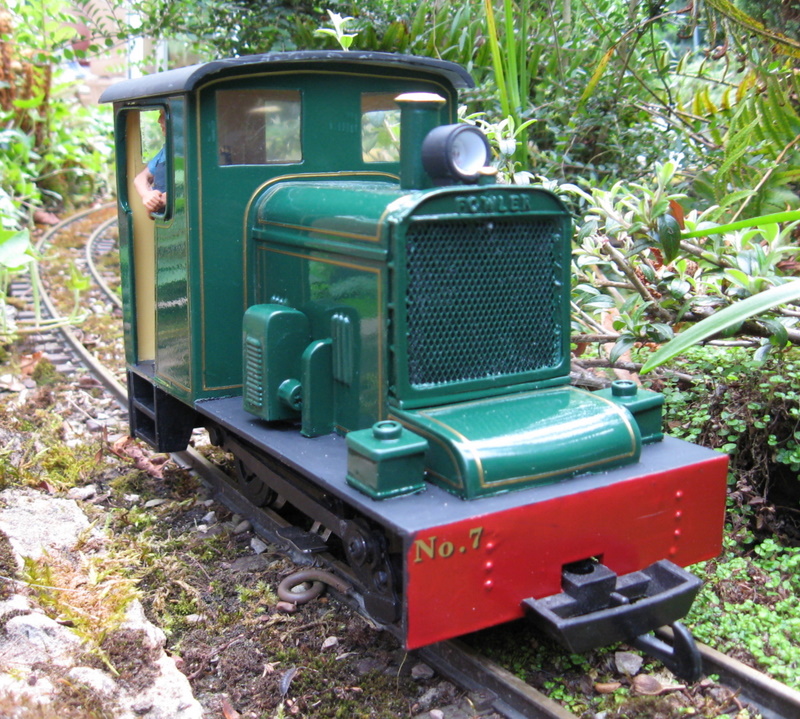

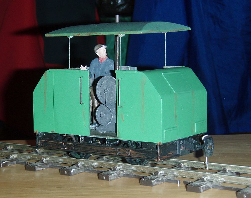

My first semi scratchbuild was a Fowler-ish 0-4-0DM. I couldn't find any photos or plans of a 3' gauge Fowler so it's a cross between a standard gauge and 2' gauge model in SM45 scale .

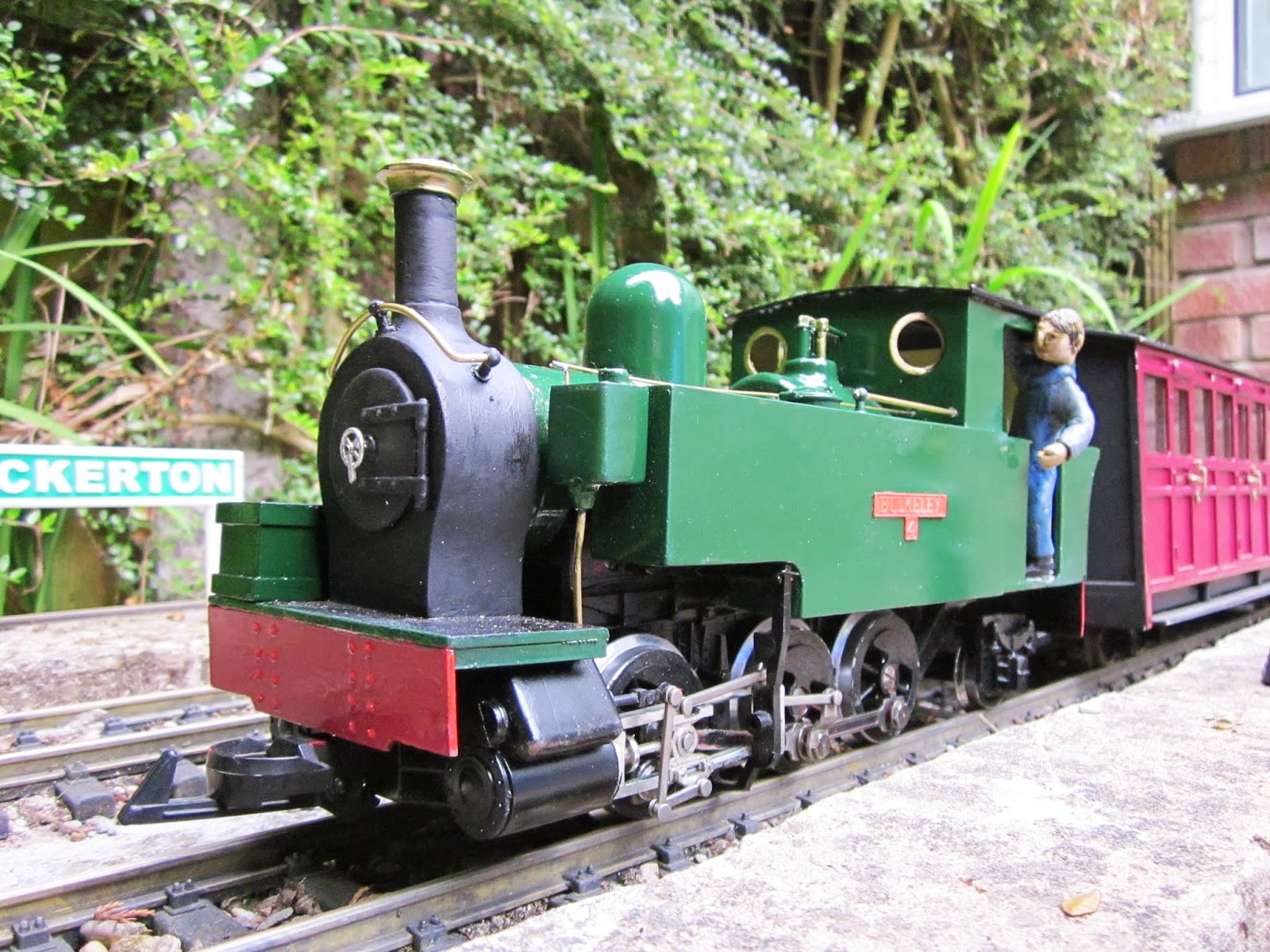

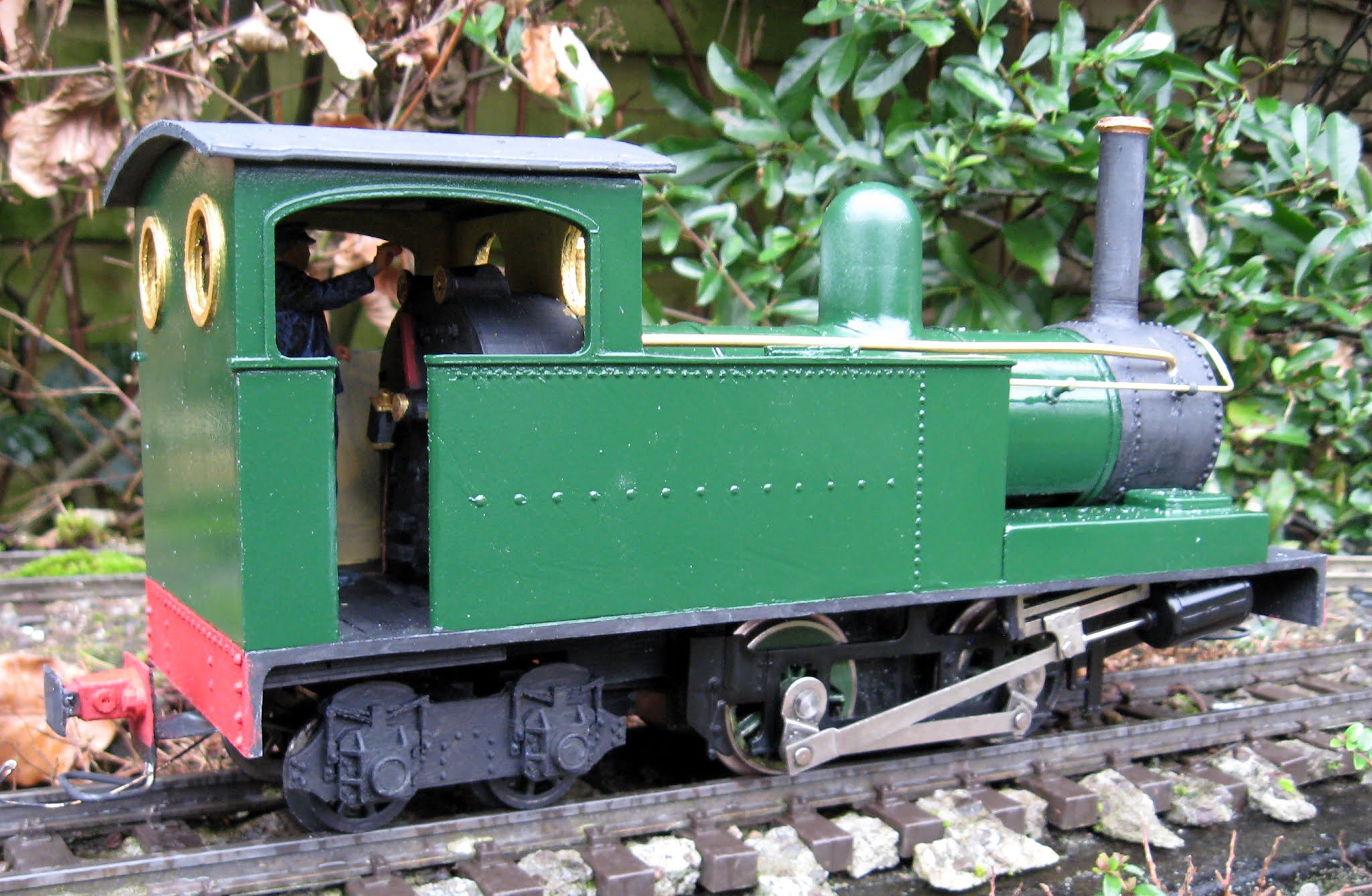

My next model was a representation of the Southwold Railway Manning Wardle 0-6-2T No. 4 in Fn scale. The scale was dictated by the wheelbase of the LGB motor block which wasn't quite right but 15mm scale was closer than 16mm scale. .
I then turned to another Southwold loco, on of their Sharp Stewart locos, the 2-4-2T No. 1, Southwold. The Playmobil motor block was closer to 16mm scale so this was chosen, which means I rarely run this loco and the Manning Wardle side by side as the scale difference would be too noticeable. .
I was then attracted by one of the Davington Light Railway's Manning Wardle 0-6-0T locos. The Piko motor block was closest to 16mm scale. .

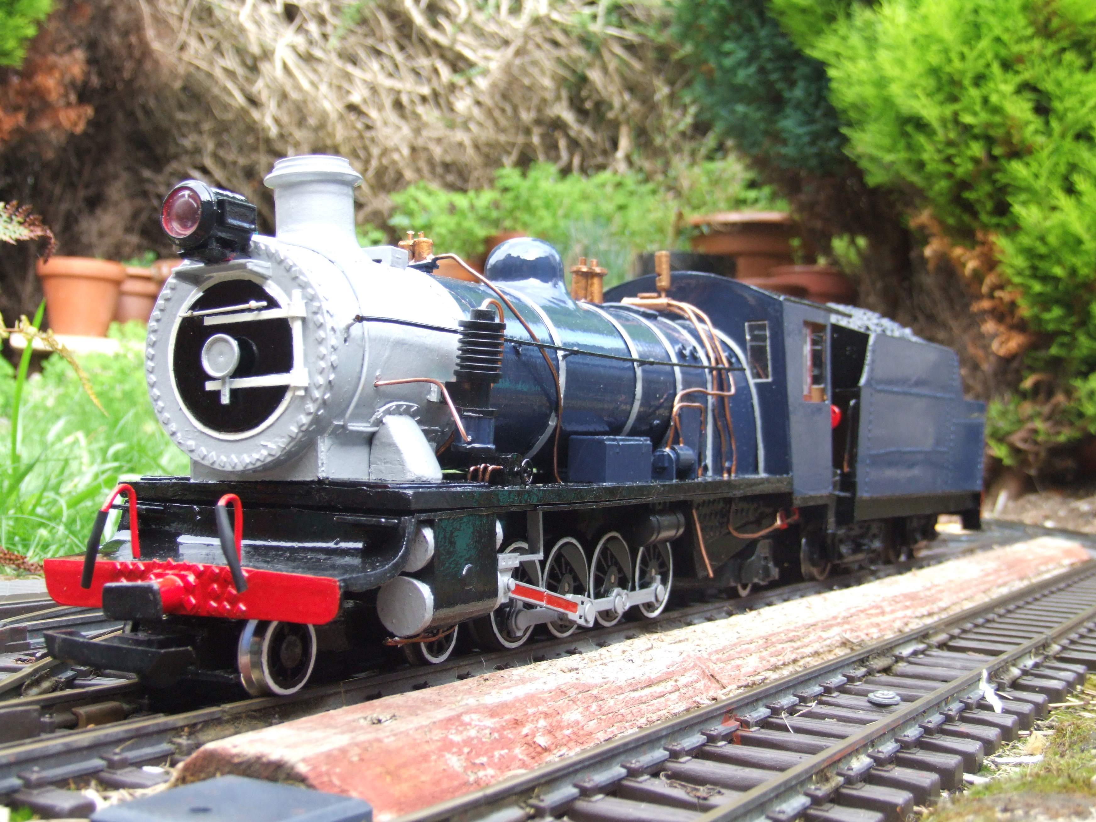

Don't see a lot of South African gear outside the 2ft stuff. Love it!
Where did the motor block start out in life?

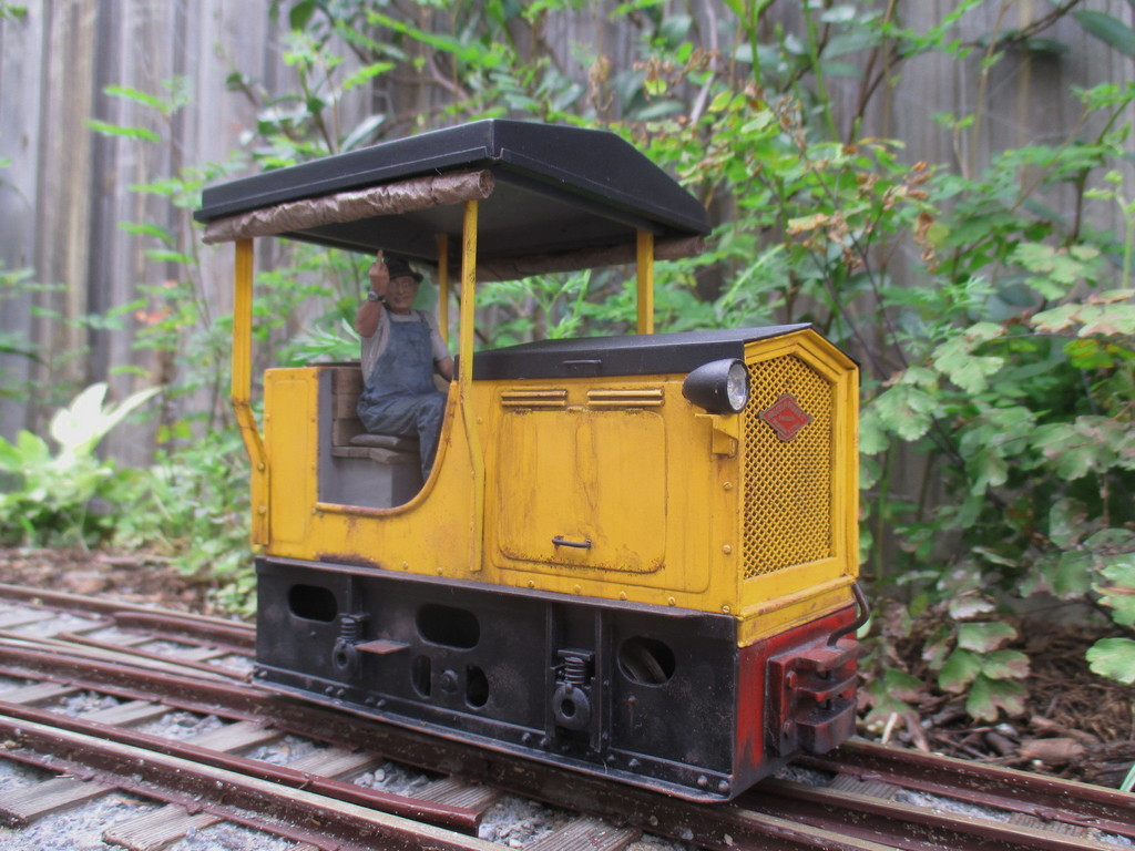

Rik, in regard to printed models being scratched or kits depending on context: this isn't the first time you've articulated my thoughts better than I can.
I've only one scratch-job, the rest being modified kits and RTR.

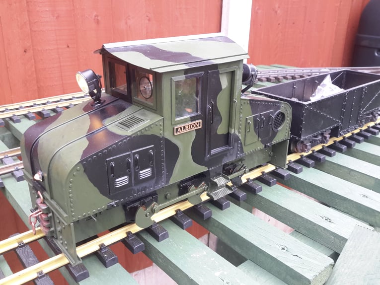

A Malcolm Moore loco, built for the Australian Army in WWII. The prototype was 2ft gauge, but I built mine wider as a fictitious 3ft gauge conversion, to fit the 1:20:3/Fn3 scale I was working with at the time in 2015. In mid-2022, I decided to finally bite the bullet and convert to 32mm, and model 2ft in 16mm properly. Converting this loco to 32mm and a scale width is more work than it's worth, so I will unfortunately have to sell my first scratchbuilt loco, once I've built a replacement.
It runs on three 14500 Li-Ion cells, through a Deltang Rx63, driving a shortened IP Engineering chassis with added delrin 4WD.

Love that, Aaron. The weathering adds finesse

Not quite as fictitious as you think Aaron. Four MM's were sent to Borneo and regauged to Metre gauge http://media.lrrsa.org.au/amoz186/Light ... ys_186.pdf

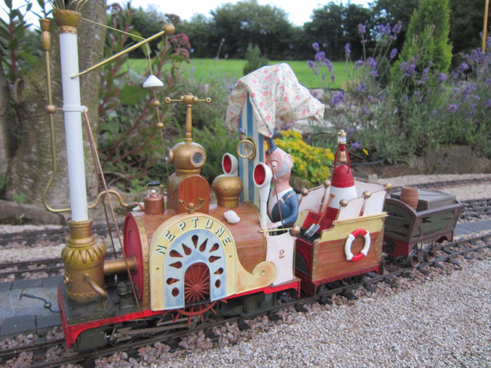

Scratch-built R/C locomotive model, 'Neptune'. Originally built to run on the 'Far Tottering and Oyster Creek Railway' 18" gauge line,1951 'Festival of Britain.

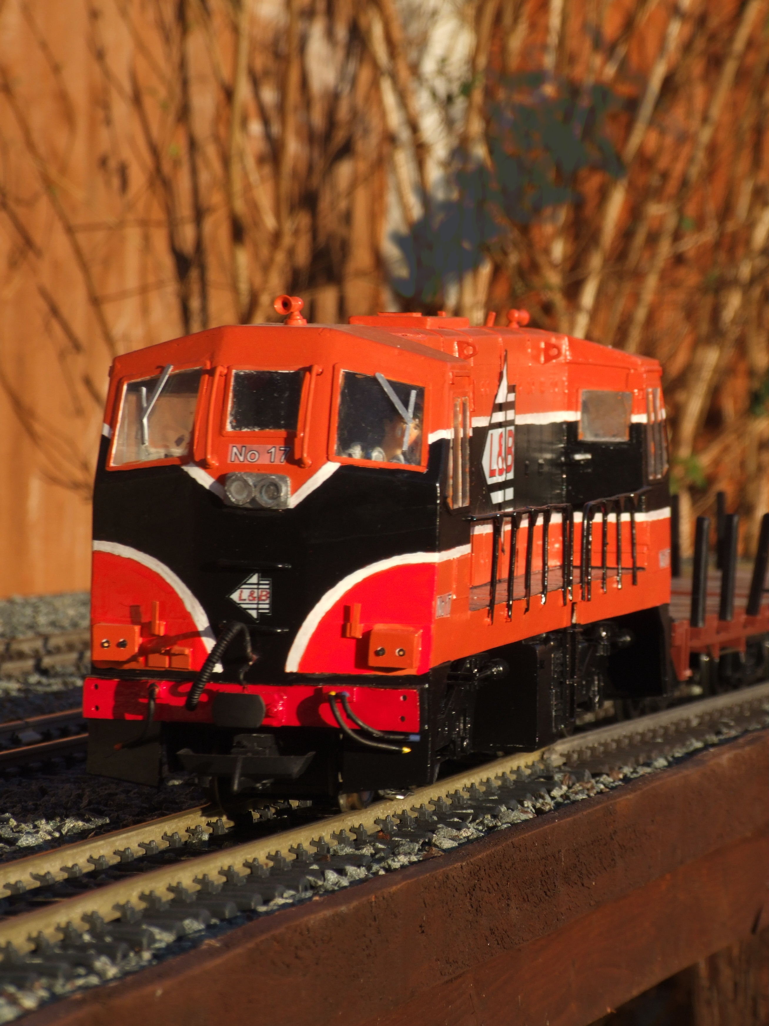

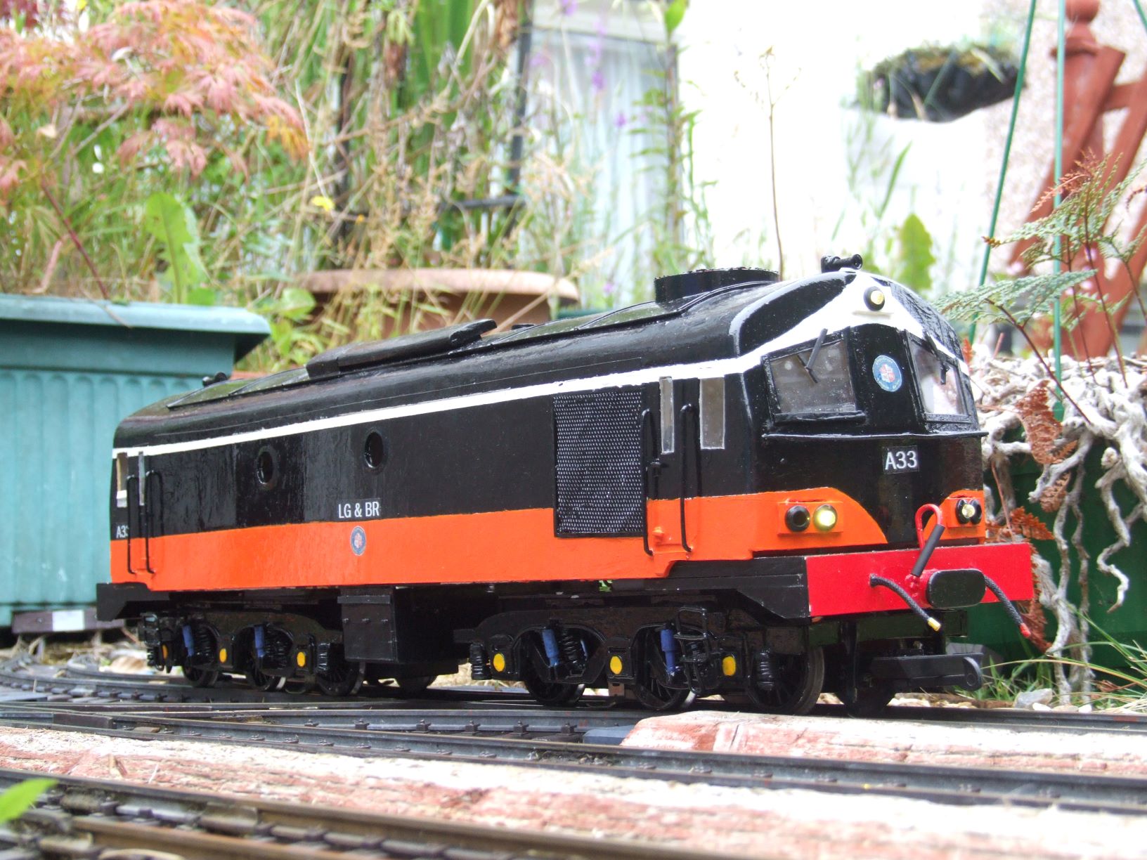

Here is some of my scratchbuilt efforts an eclectic mix of locos steam and diesel . ( I think I have scratchbuilders bug !!

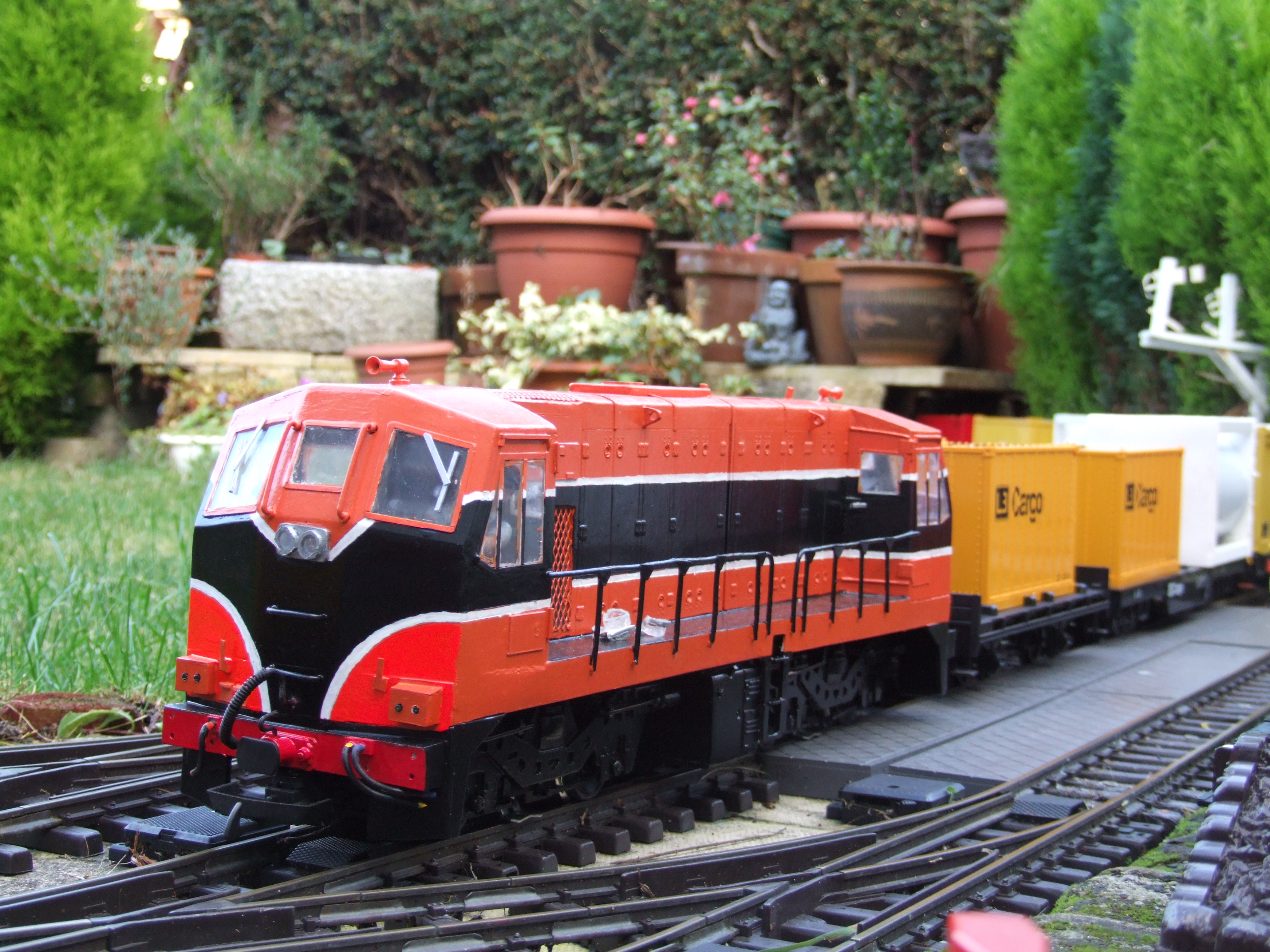

Number 13 Titus a 2-8-0 of South African origin using an old Delton chassis ! An Ex Irish Rail class 141 using USA trains power bogies bearings rotate as per prototype lights etc .Not fully finished here

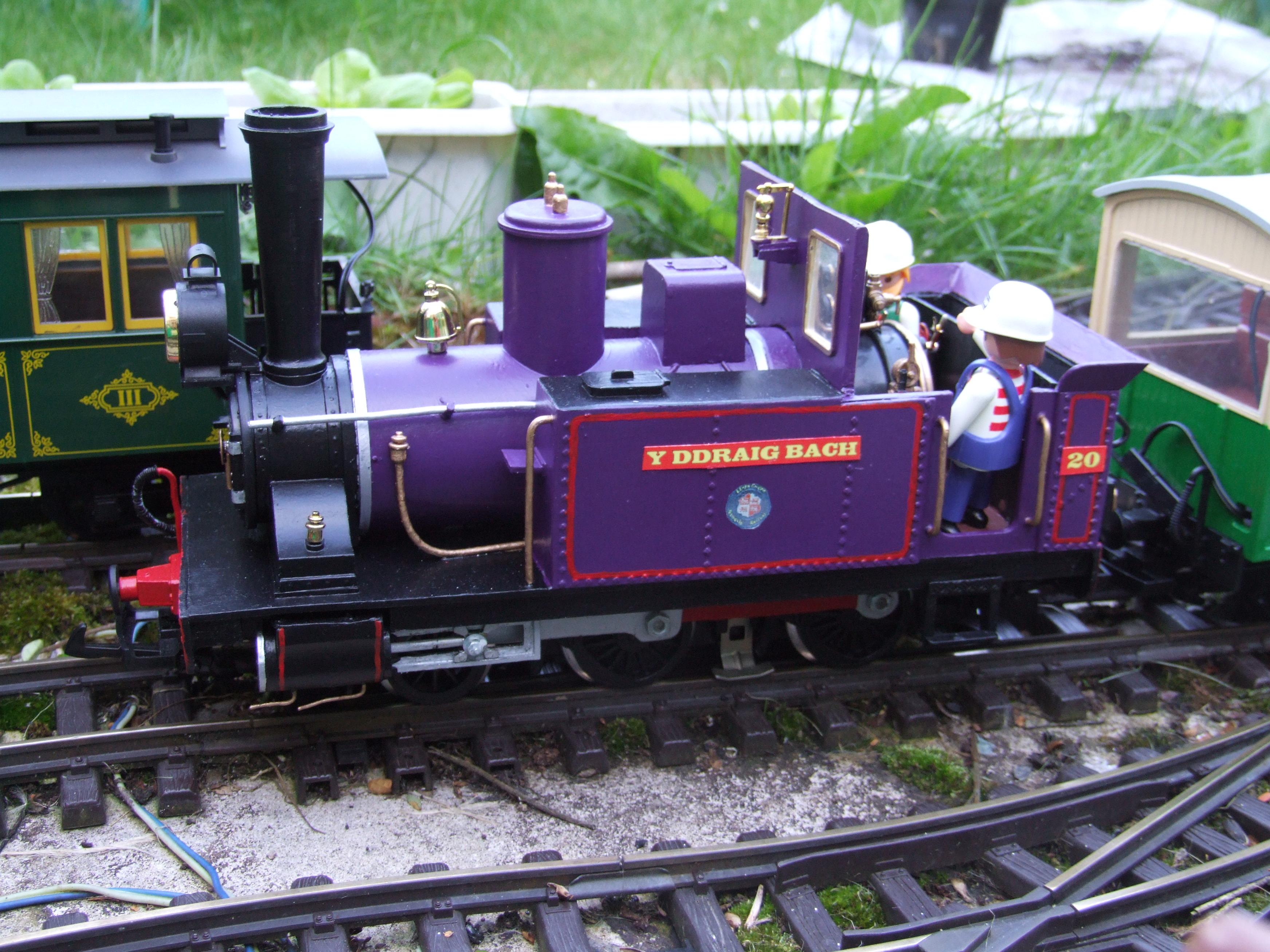

Next a Sudo Beattie Well tank Y Ddraig Bach (Little Dragon !!) Built with bits from the scrap box and a Playmobill chassis

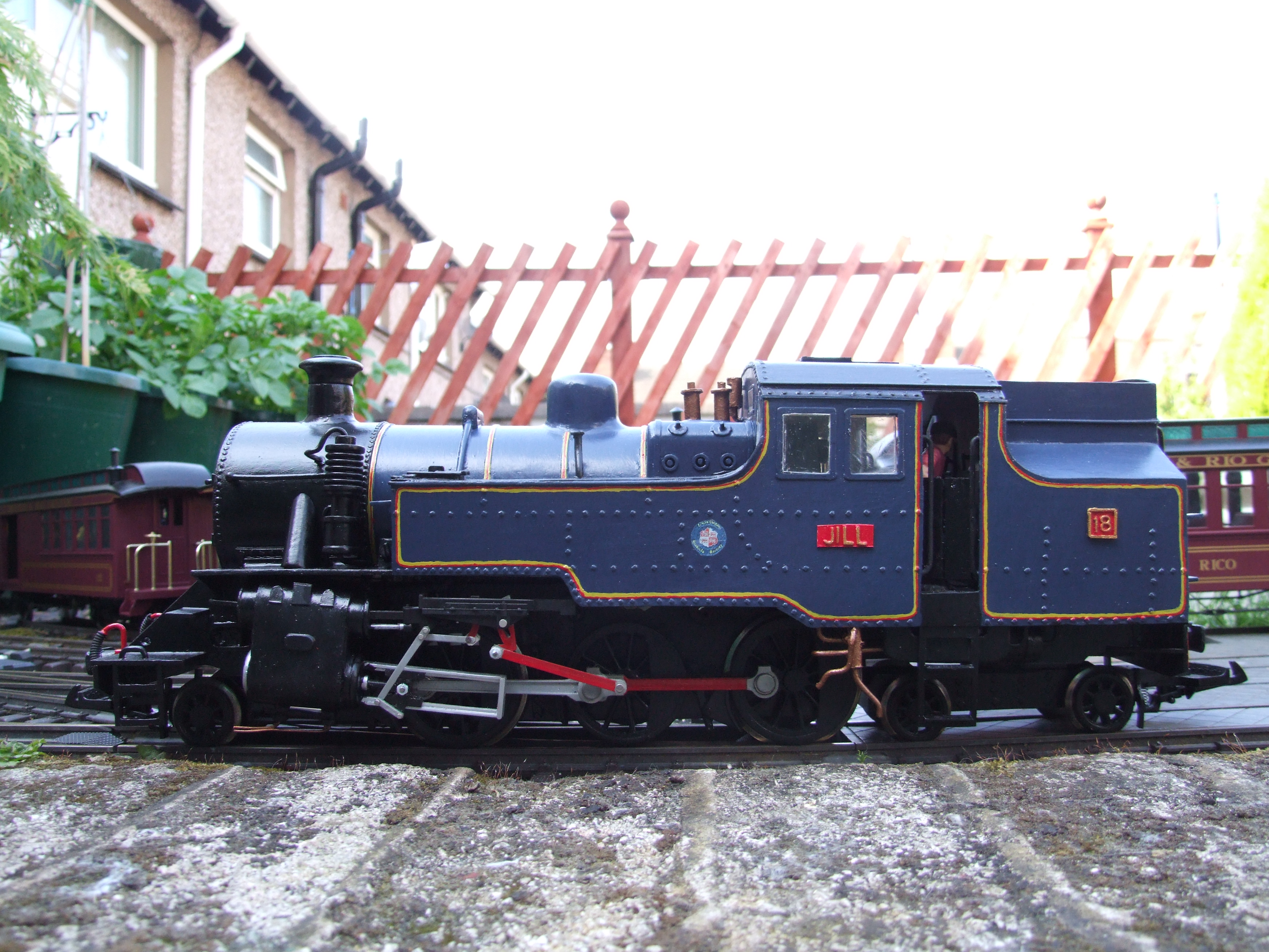

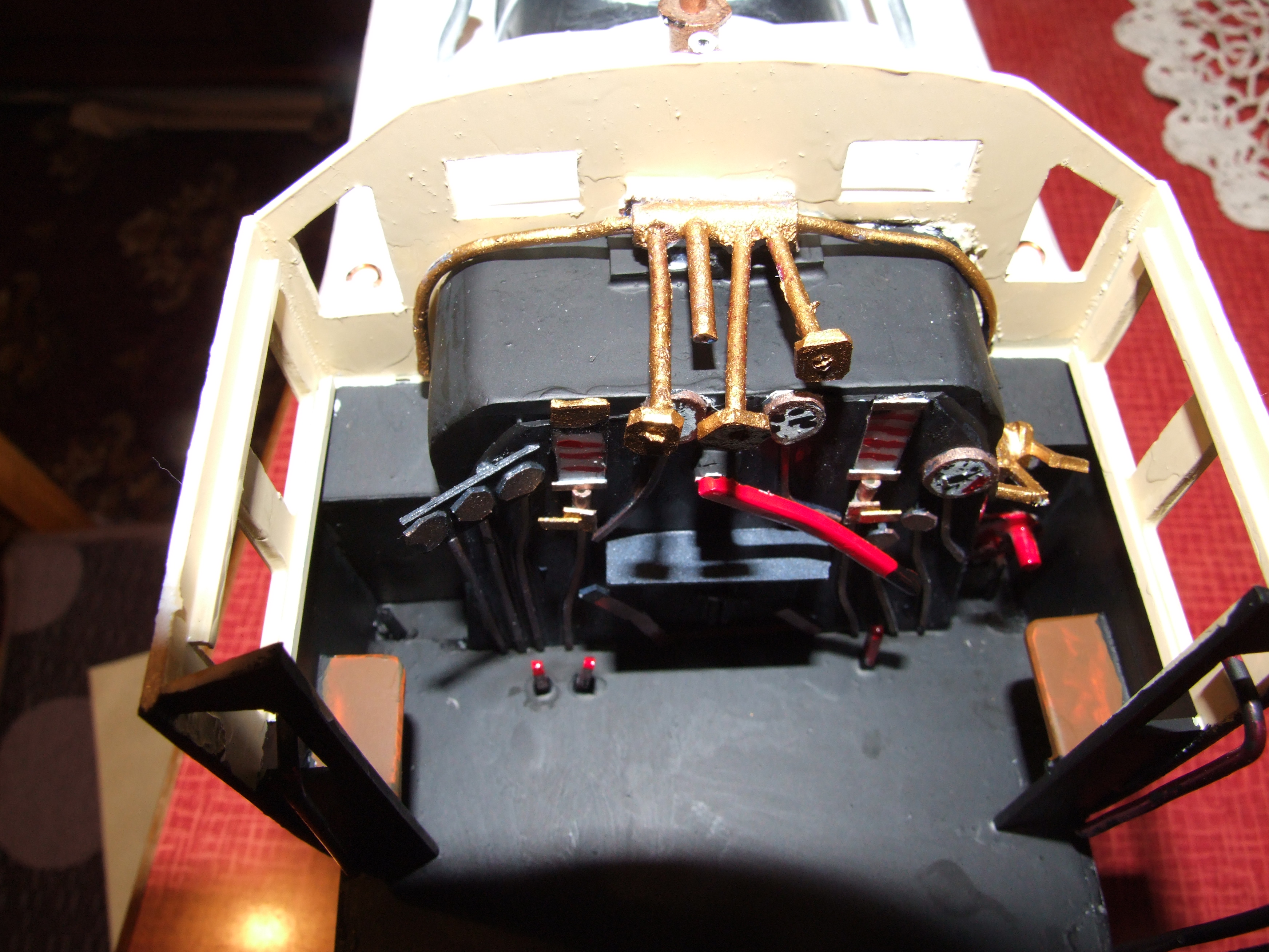

Next a Sudo NCC 2-6-4t " Jeep " Jill built on heavily modified Bachmann 4-6-0 chassis nice machine Cab interior !

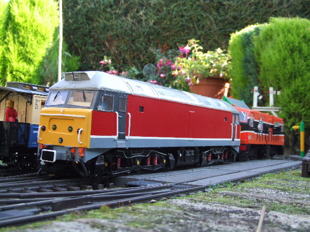

Class 57 or Rhodesian DE 4 diesel totally scratchbuilt aprt from USA power bogies named Commonwealth Spirit after much loved 47 local to N Wales
Seen here when running in and testing

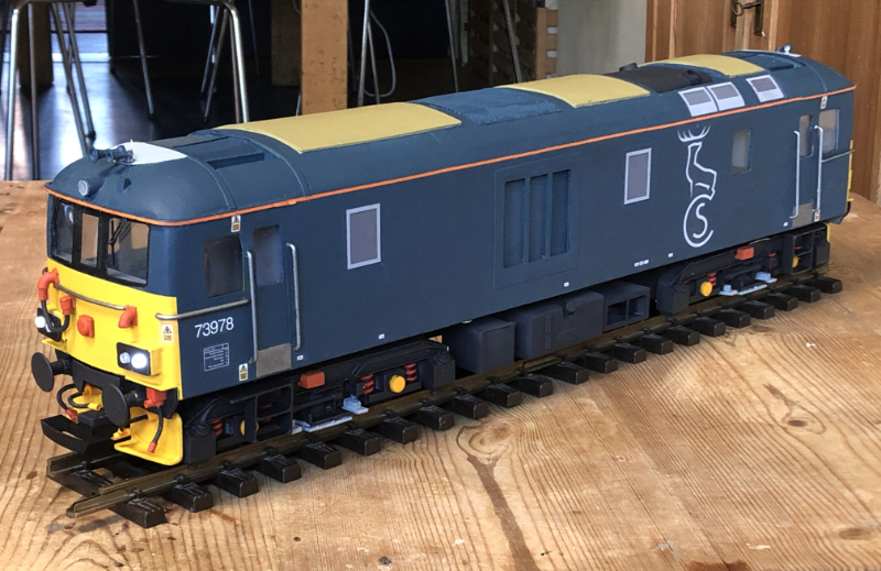

Ooooh! That 47/57’s very interesting…
A garden railway just can’t have too many big tank engines and even bigger diesels, I reckon. Here’s my fun-scale Class 73 from not that long ago (I assumed I must have posted a snap of it complete before but it seems not).
