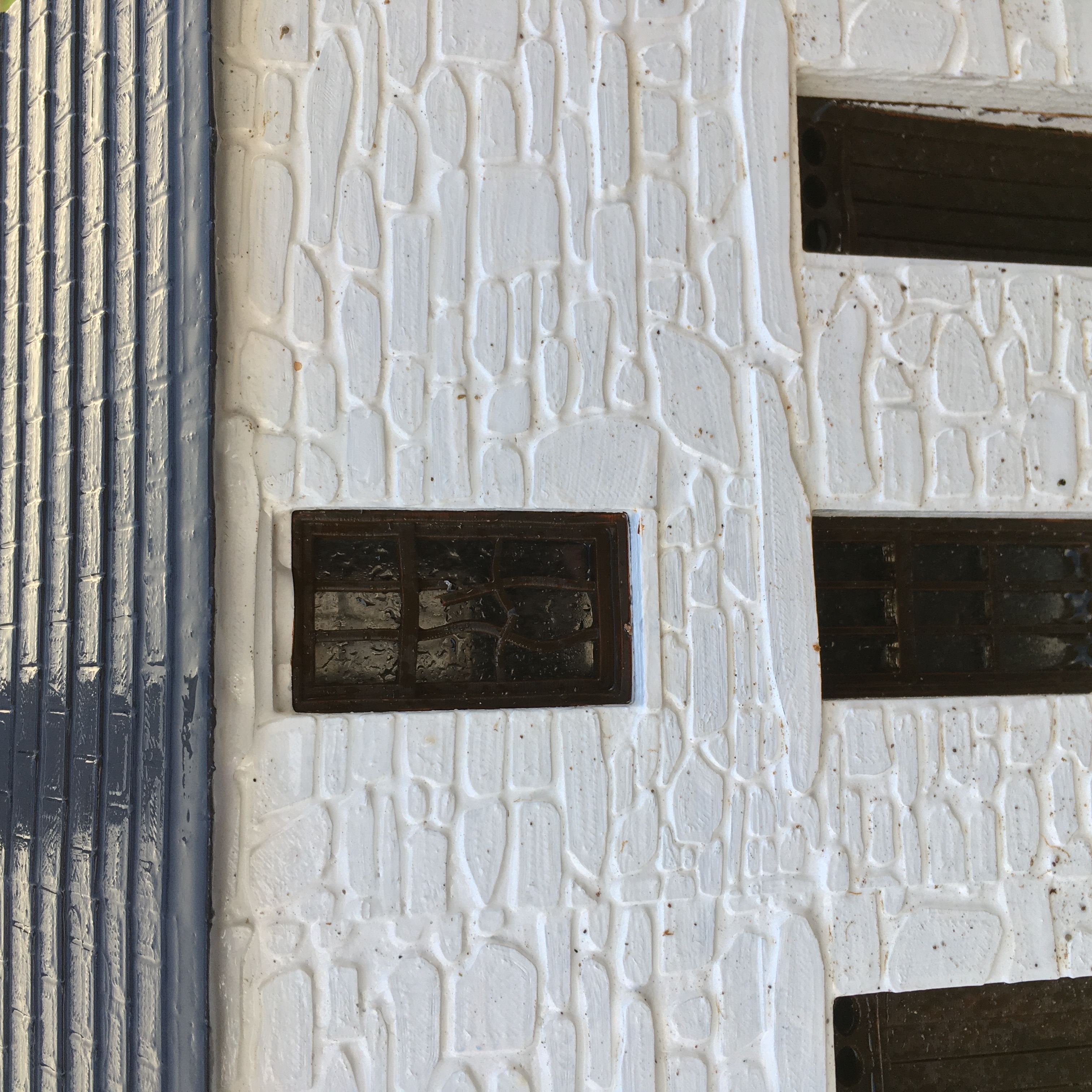

During last summer I left resin printed figures and post-boxes outside for 2 weeks. Laziness really - but the result was a bit of a surprise.
The post boxes developed large cracks - and sort of exploded - but very slowly. Something similar happened to some of the figures.
I was overhasty to throw the damaged items out - and I can only really share this one with you. It has the early signs of what I am talking about:
You can see the dark cracks along the torso, and the left shoulder.
More recently I have left the row of cottages outside - again for about 2 weeks. This went out as soon as the paint was dry. Look at this upstairs window:
The framing has expanded and fallen apart.
Look at the door in this photo:
The doorstep has curled up, and the door has expanded pushing it into the building. On the other hand the filament printed window next to the door is perfect.
I could show you lots of things which have been outside and not deteriorated in any obvious way - but the difference is that they have not been left outside for any length of time.
So what can I tell you which will help to shed light on this. Firstly I have used different resins over the past 18months and I cant really be sure what was printed using which resin. I was using a cheap uv Lamp to post cure things - and have only recently bought a wash and cure machine. So there have to be doubts about whether I was curing things properly.
All of these things were painted with acrylic primer, and 2 coats of acrylic paint, mostly airbrushed.
At the moment I suspect that resin printed models/components, can't be left out in the weather for any length of time. However it would be reassuring to hear that others had had different experiences.

How thick are these items? Unintuitively, resin seems more robust for thin sections rather than thick or solid items....I suspect this is because the inside takes a really long time to cure especially with darker resins. Prolonged UV exposure will cause internal stresses.to develop leading to cracking of brittle materials.
If I was planning on leaving something outside I would use a light colour resin, preferably not too brittle and make the structure as thin as possible (transparent resin would be good for the former .....for a building, thing more like a real building in miniature rather than traditional model building (IE use a closer to scale thickness wall with pillars / braces etc rather than a uniform thick wall). I would then leave the print outside for a week or so before painting it to allow slow but full curing as far as possible.
Of course all this is based on theory so it's entirely possible that it would still crack eventually!

You may be correct - and in many ways that is what I wondered myself.
The figures which I have which have bulbous skirts were hollowed in the slicing software. These seem to be undamaged so far. I am currently using a gray resin, and I have just placed a hollowed postbox outside.
I will let you know what happens.

The resin printed post box has been outside in the weather for 2 weeks now. No sign of deterioration so far.
I am fairly sure that my problems were caused by not curing the resin properly in the first place. Having the wash and cure device should make sure that this is a problem of the past.
I am currently using an own brand "ABS like" resin from Technologyoutlet.co.uk which seems to work well. Strong stable and takes drilling and filing well.
