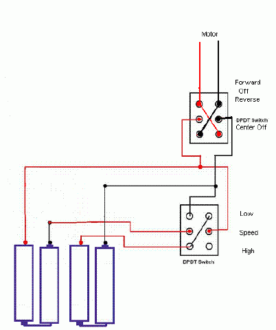

Crackingjob
speed control
Post by Crackingjob » Fri Jul 31, 2009 1:39 pm
Can I point you to the web site of cambrian...who do a series of controllers for both types of batteries ie gell and the other??!!
plus lots of other 'ittle bits and bobs'.  The controllers can be bought pre made or as a kit (saving a few quid...the wife says pre made is worth the money saving the swearing and smell of burnt flesh/electrics) Ideal for the budget credit cruch engineer.
I can recommend....
http://www.cambrianmodels.co.uk/
Also recommend.....
http://www.timpdon.co.uk/timpdon/index.htm
and for those with a few more pennies (and expensive trains) the upmarket   http://www.brianjones.free-online.co.uk/
All are very helpful and in the case of Mr Jones sells batteries,chargers etc and all will help taylor your rquirements.
If my links fail..look in the www.16mm.org site and go into Links and Resources and to the bottom of the page where you will find links to these and other traders
I have a few other diagrams i will post but add one i have which cuts out a set of batteries (drop voltage up amps i 'tink') You use two switches as opposed to speed pedo controller.

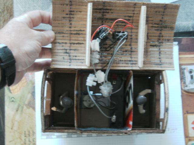

Crackingjob
Also as seen on 'Peda J' my camborne & Redruth Mineral Tram
ps I have fitted one into a Faller loco ..converted from 12v track to 9volt battery and into my vertical loco...also small in size
Happy electronics!!!!!

New Haven Neil
Oops - again
Post by New Haven Neil » Mon Aug 10, 2009 8:55 pm
Ta daaaa, here it is - this is a blag from either Carl on the continental forum, or Neil Robinson on GSM, I don;t recall which, sorry guys.
Now, I see it doesn't have the values on...oh here we go again, another bit of paper I have lost.....I do however have several in use so can look at them!
To reverse, add in a dpdt switch like in the post above in the leads to the motor - NOT the input from the battery. If you do that, the magic smoke will be let out of the transistor.....and it won;t work any more...... :twisted:
