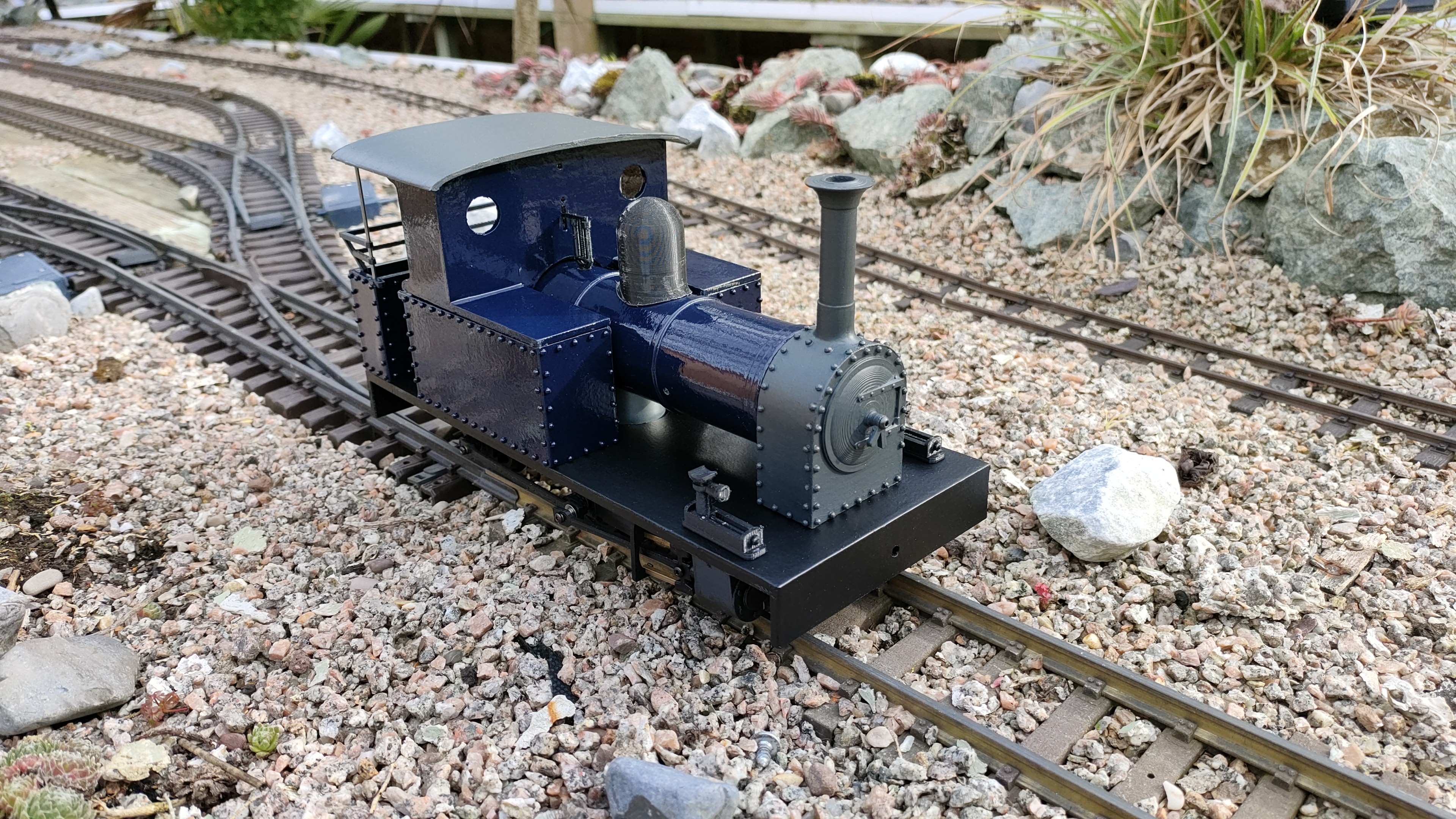

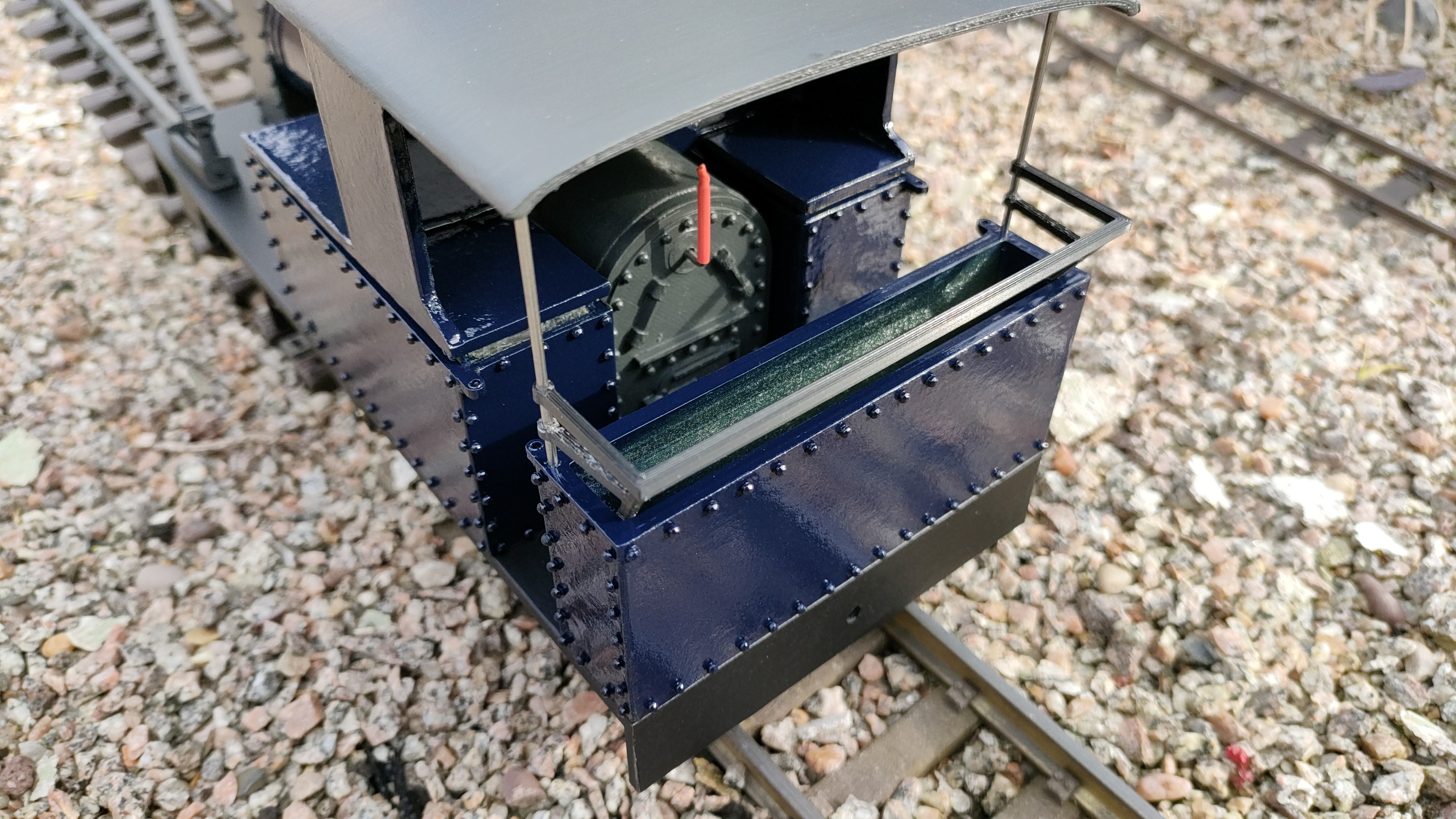

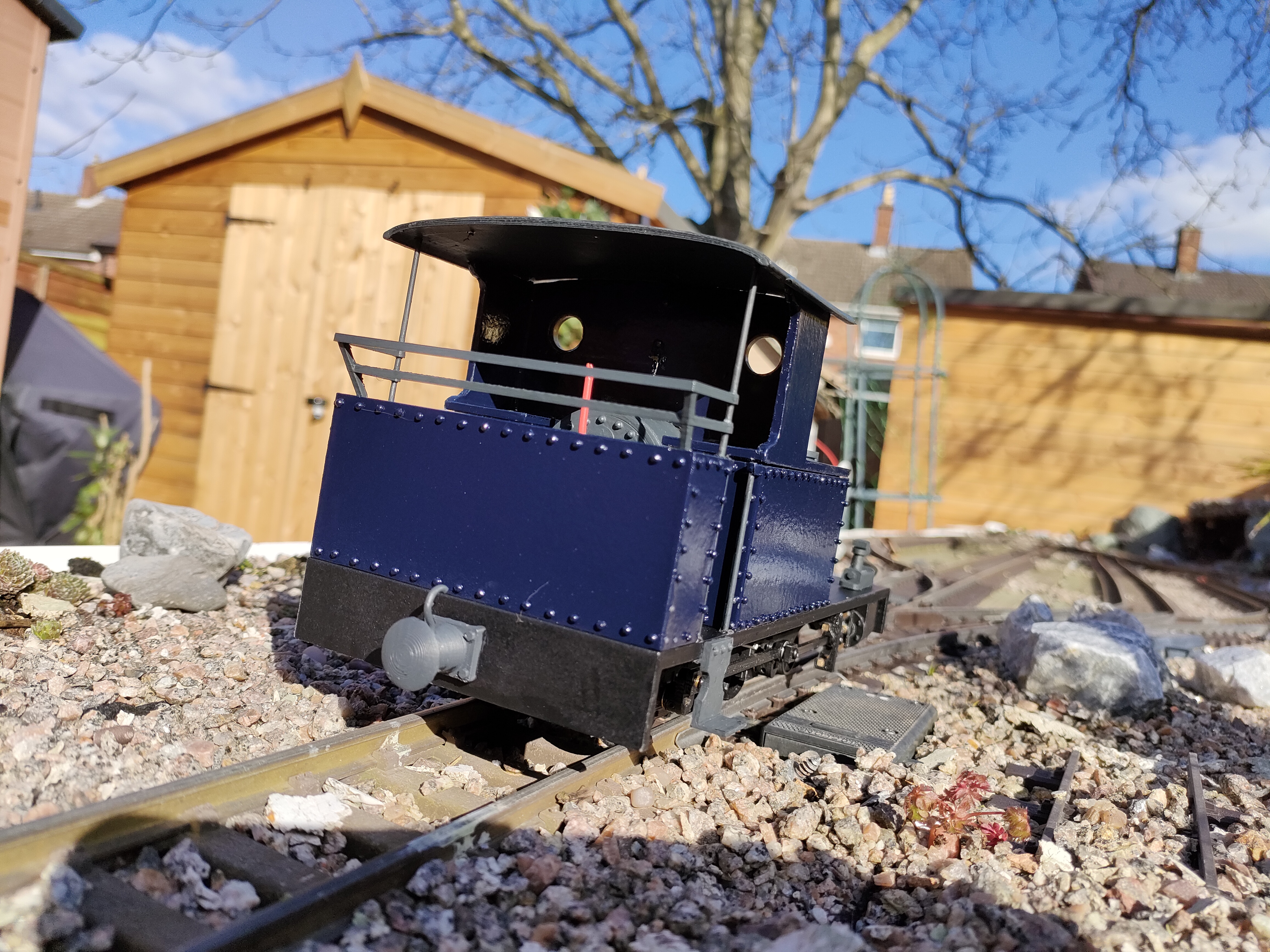

A little update on this. Been busy beavering away with CAD and printing and this is it so far. It has a ling wat to go to be finished but it's definitely starting to take shape. :thumbup:
Note lack of print lines on the finished parts, the model was papered prior to painting. I know they still show on the roof but this has been fixed by printing the roof separately, so any future ones will be line free with papering as well.
Posts: 8037
Re: Yet another project - sorry
Post by ge_rik » Thu Mar 17, 2022 9:08 am
That's an attractive little loco.
Have the rivets been applied after papering?

ge_rik wrote: Thu Mar 17, 2022 9:08 am That's an attractive little loco.
What Rik asked, and could you give a little more detail on the 'papering' process please? (adhesive used, paper type) It's clearly not wood chip or anaglypta :lol:
Papering is done with Canford craft paper, it's quite thick (https://www.londongraphics.co.uk/daler- ... 1kEALw_wcB)
Wood Glue (PVA) is applied to the model, after a minor rub down to remove any protruding parts and the the paper is applied with a Paper Creaser Bone (https://www.amazon.co.uk/Creaser-Folder ... 0399&psc=1). The paper is trimmed with a razor blade to ensure sharp crisp edges,
Rivets are added after primer. I currently use self adhesive nail gems, but they are rather large for scale. The ones I will be using in the future are smaller and applied with a drop of PVA every 5mm.
Then just paint as per usual, either hand painted or spray. :thumbup:
I think I mentioned this process in a previous post on the Secondus project. https://gardenrails.org/forum/viewtopic ... t=secundus
Any further questions please ask away :thumbup:

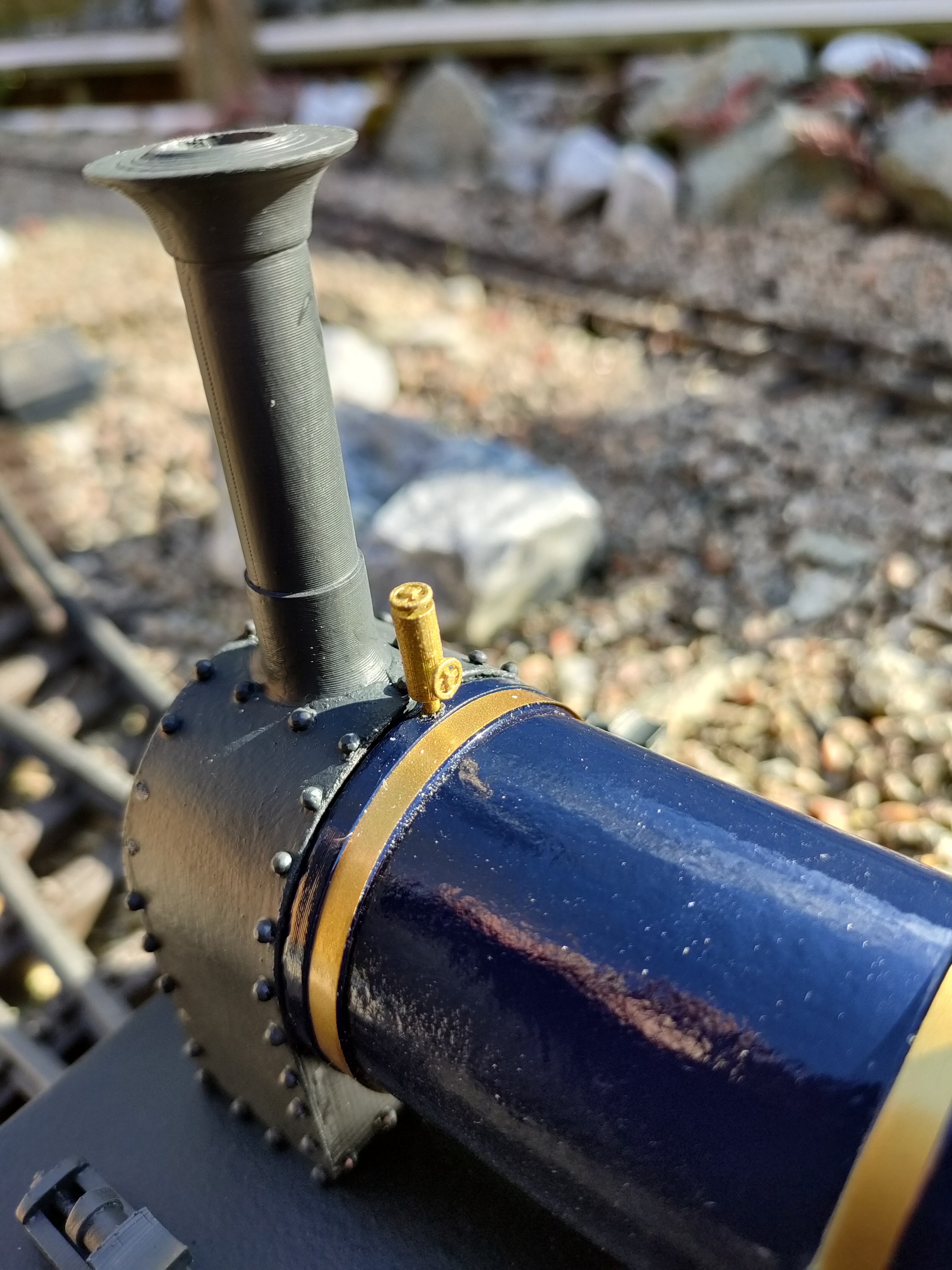

What are you planning to use Steve? My current nail gem supply are a little on the large side - they look fine individually, but too big when used close together to recreate prototype rivet patterns. At least I'll have something juicy to discuss at my next Rivet Counters Anonymous meeting...

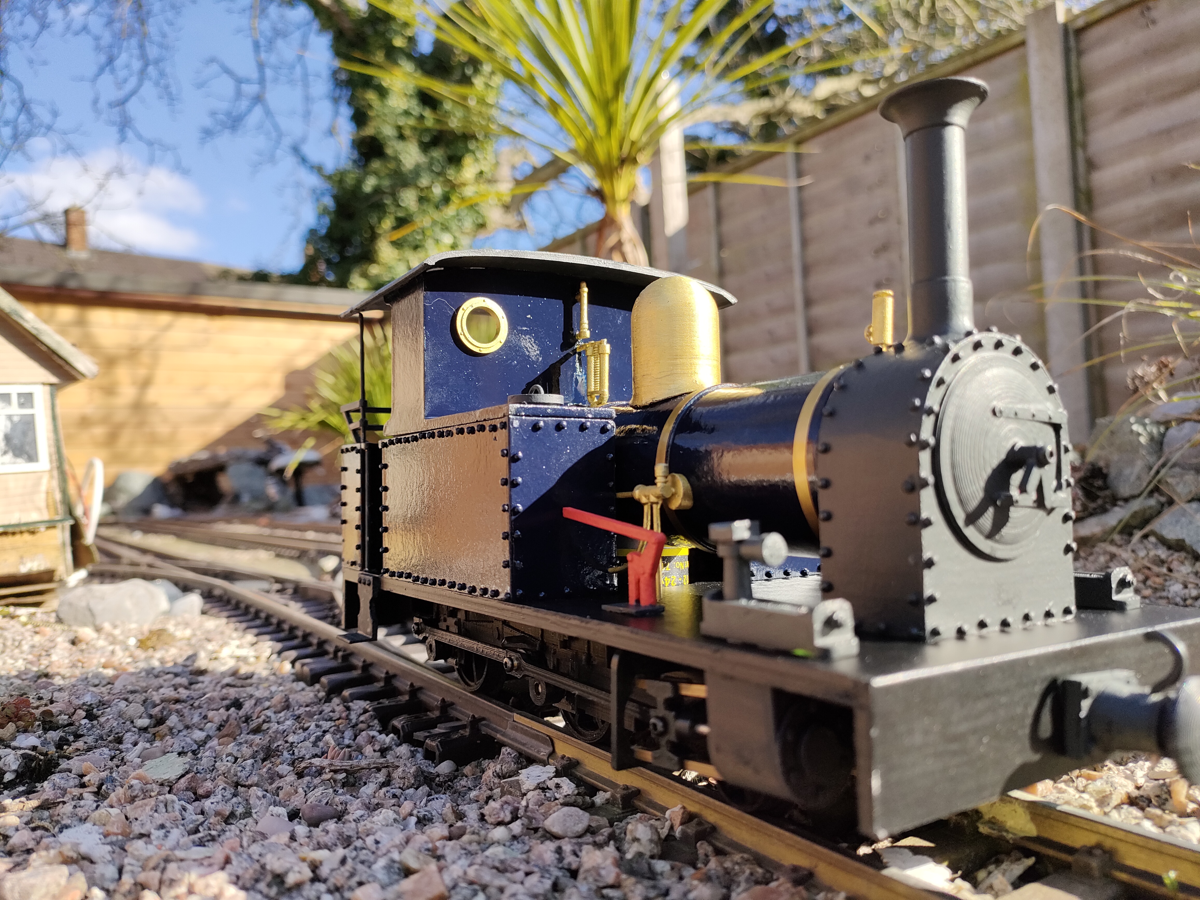

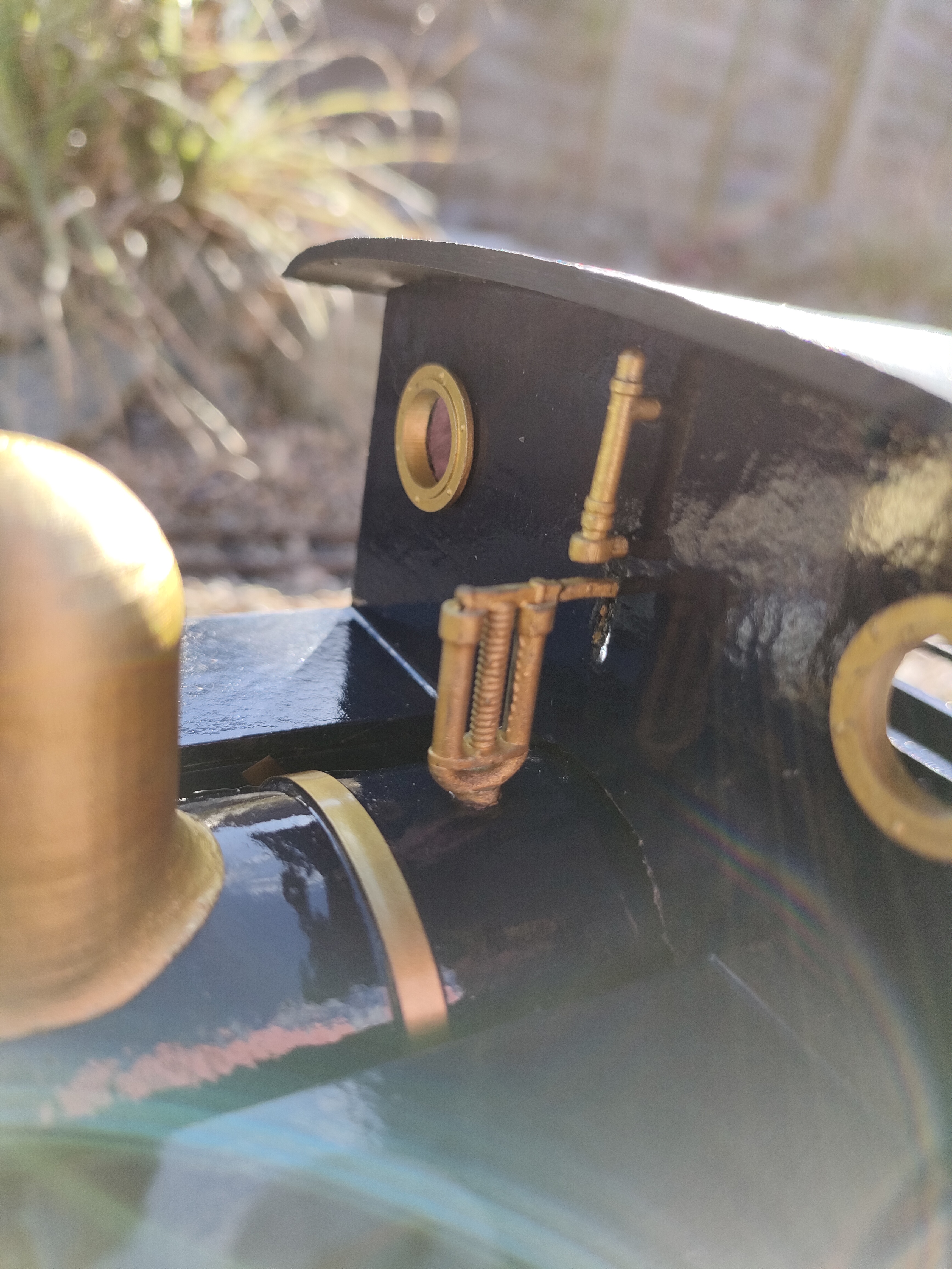

A little more detailing done today, still loads to do including the lining and name plates, but all in good time :thumbup:
Tiny little lubricator with 2 hand wheels, but I think it looks the part.
Sorry about the really bad picture but it shows the bad painting on the other little detail parts, all in resin of course.
