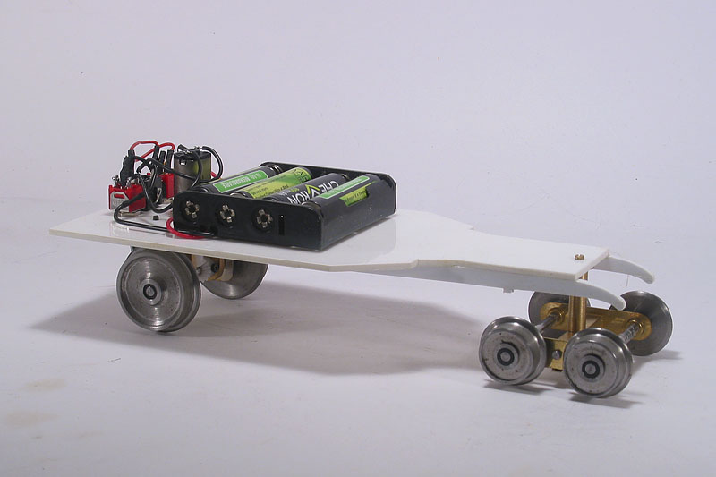

The first pic shows the working chassis about a year ago. The main difference between this chassis and the one under the rail ambulance is that this one is fitted with a leading bogie. It was given a test run on the track, found to be a bit fast and the number of battery cells reduced to three, to bring the speed down to about 20 smph. ....... and there it sat until a few weeks ago, while I moved onto other projects.

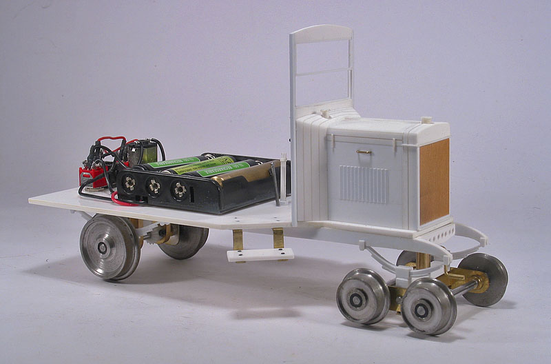

When work restarted, the first job was to finish the chassis detail and fabricate the radiator, bonnet, scuttle and windscreen unit and fit that to the chassis.

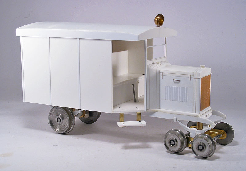

Next job was the van body. None of the surviving photos show the interior of the body, so this is based on the cabs of restored Morris Commercial trucks of the period, less the leather upholstery and carpets most of the restorations have. Unlikely on a depression era timber tram, where any upholstery would have been a folded chaff bag.........

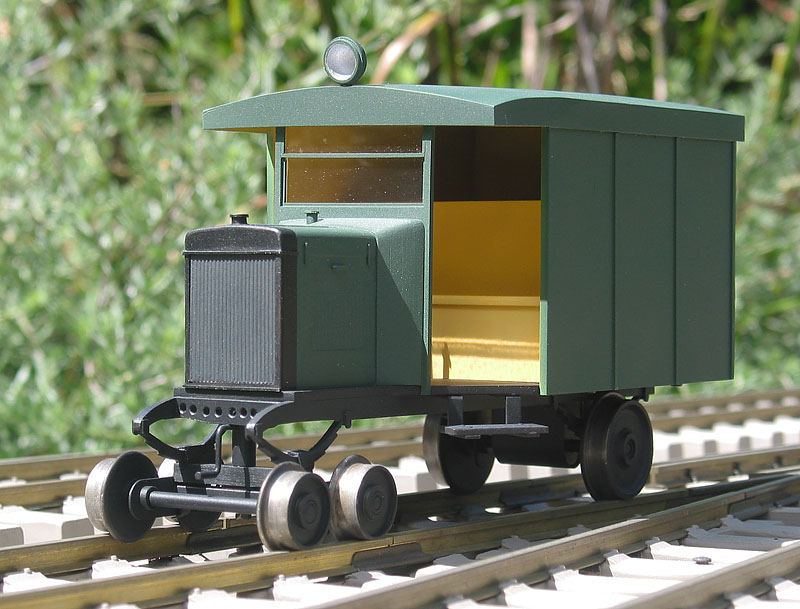

Then it was on to the paintshop and the usual fight with modern paints, not helped by the weather we have been having. The only tin of paint that co-operated was a 30 yr. old tin of Humbrol used on the interior. The next photo shows the final result sitting on the track in the sun earlier today.

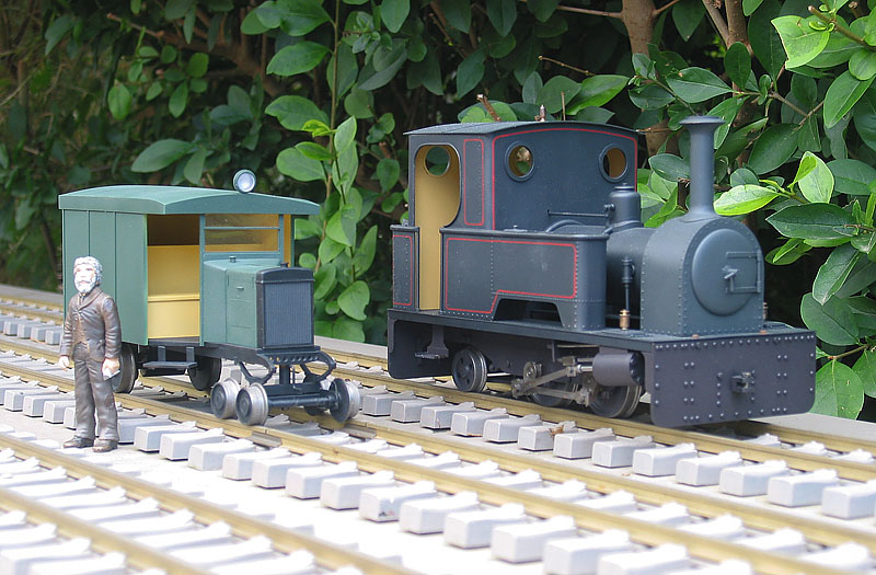

The last photo shows the rail van in the transfer yard with the TVT engineer for scale and the Kerr-Stuart Skylark from the other timber tram in the background. This thing is tiny and should probably be renamed a stealth van, as it more or disappears against the green background out on the track.

Traction power is provided by a Pololu 6V 50:1 micro metal gearmotor (a #998), with a mitre gear final drive in a milled brass gearbox and Eneloop long life NiMH batteries. As usual on my small rail motors there is no speed control, just a reversing switch, an on/off switch and a charging socket. Bodywork is in polystyrene sheet and strip.
