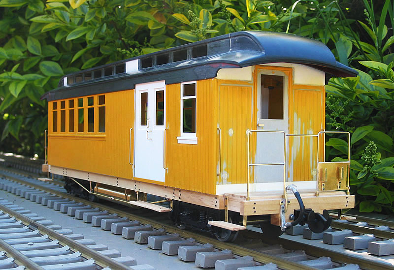

The first photo shows the model as received. A standard Bachmann Jackson Sharp combine. This one had been modified so it could be used with head end power for the lights, instead of the battery box that comes built into the underframe on these models. The bodywork hadn't been modified, but the underframe had seen better days. The first order of battle was to strip everything back to the basic plastic mouldings, by removing the rats nest of wiring and sundry blobs of epoxy holding the wiring in place.
The next photo was taken a couple of weeks later and shows the model modified and ready for the paint shop. The plastic wheels have been replaced with my own steel ones, a new wooden underframe has been fitted, the roof extended at each end, the US type sliding door replaced with VR style double doors and an extra window fitted in the van section.

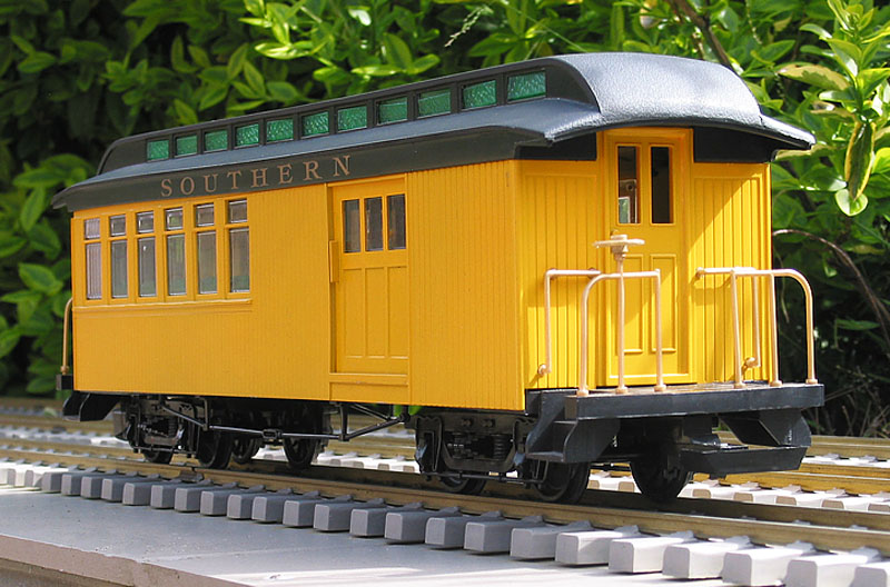

The last photo shows the model painted in the TVT passenger colours sitting on the track this afternoon, when the rain cleared for a few hours. By the time the sun comes back again, the paint should have cured hard enough for the model to enter traffic.
The effect aimed for is what the VR would call a passenger car with van and the bodywork is functionally similar to the VR narrow gauge NBC vans.

Love the new carriage - I'm particularly enjoying the crisp lettering and the guard's ticket window...
