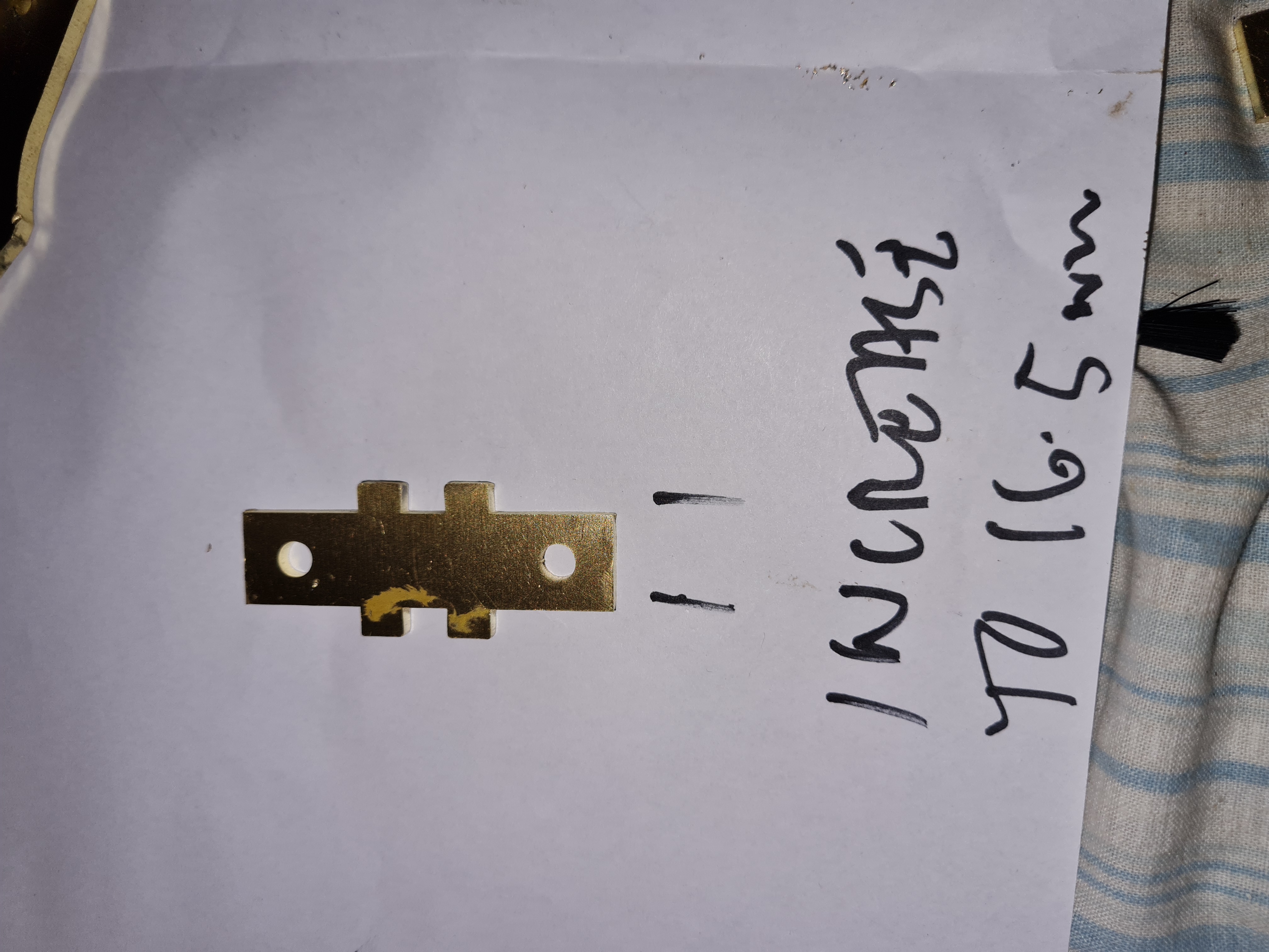

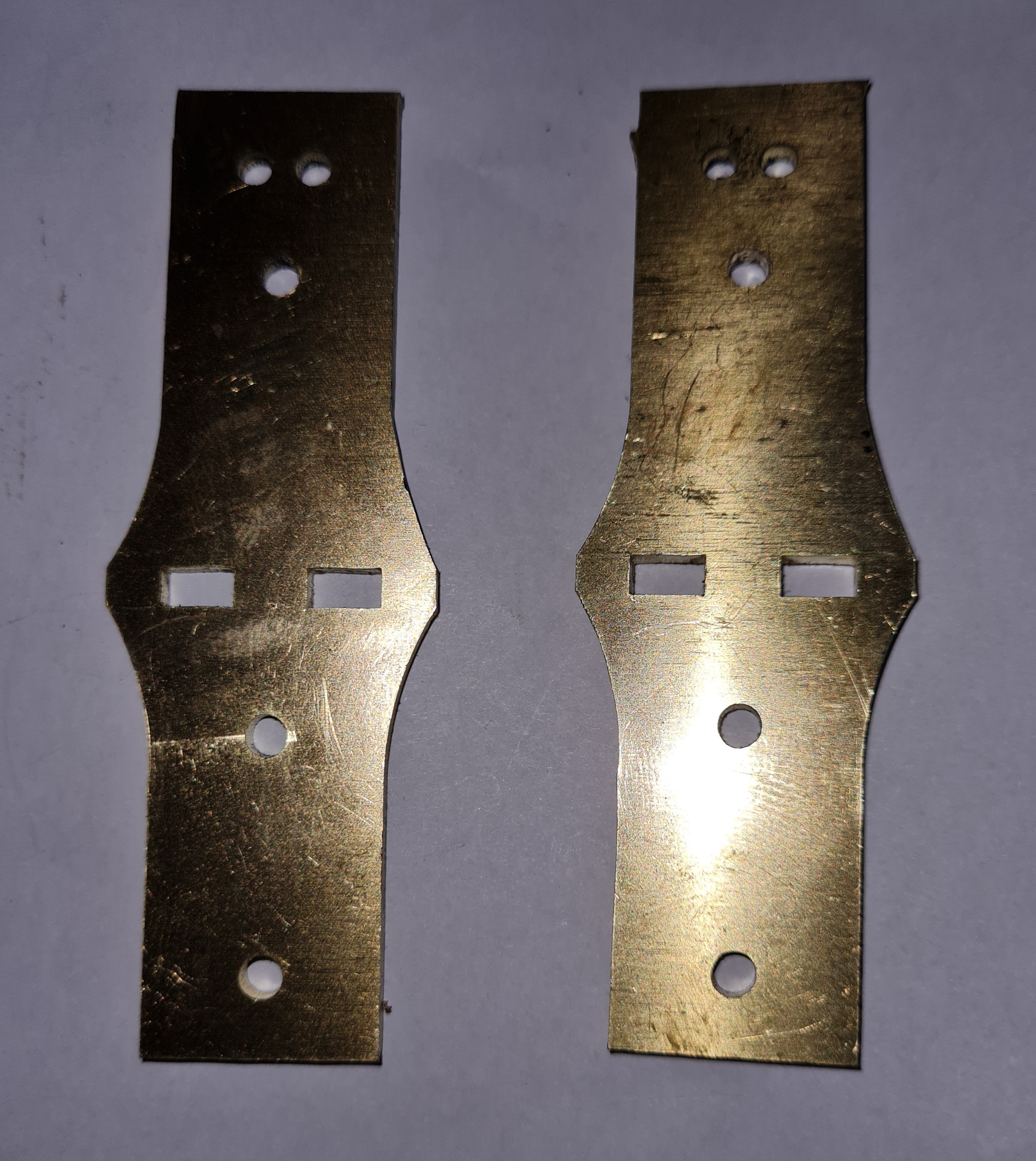

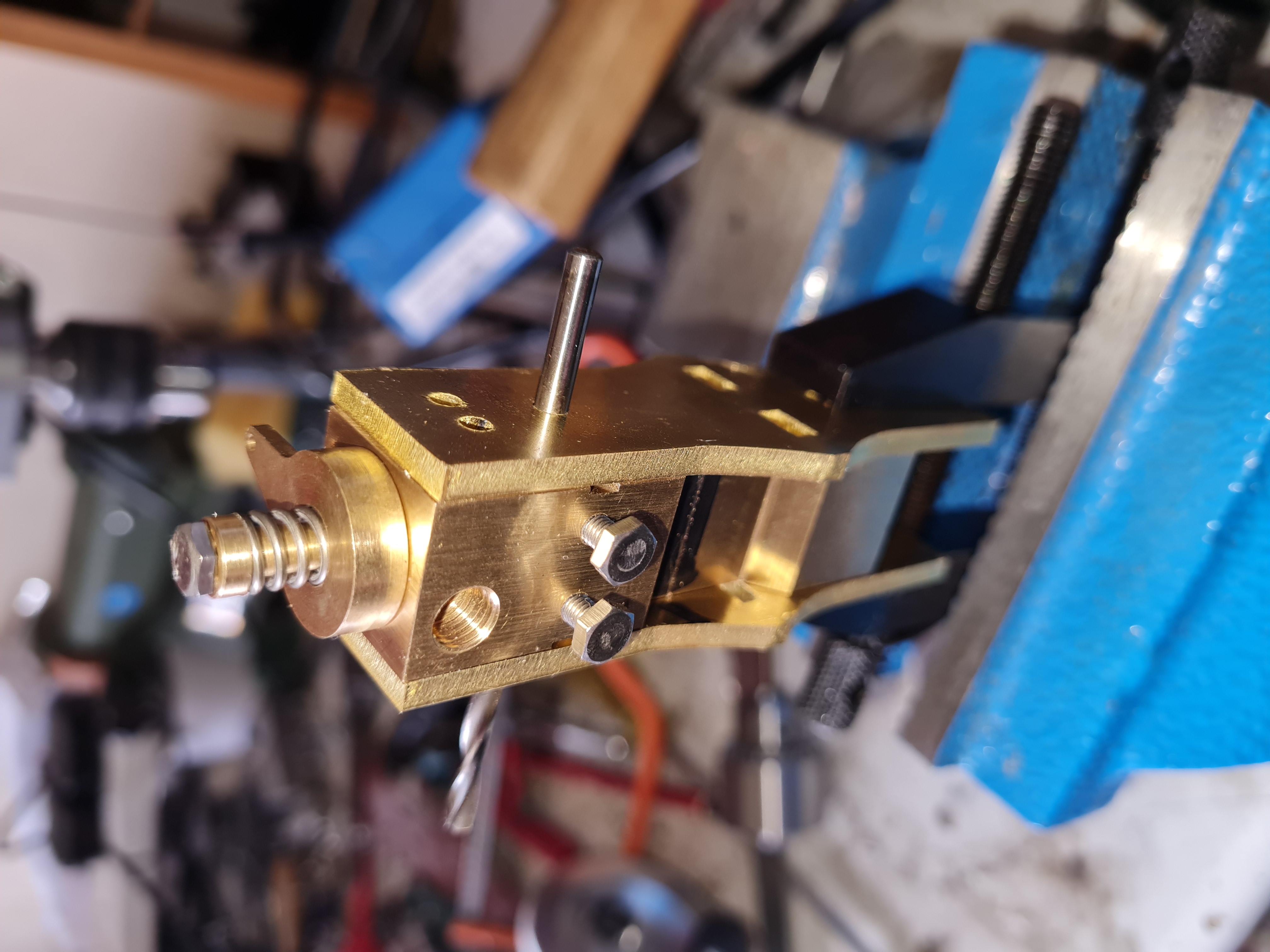

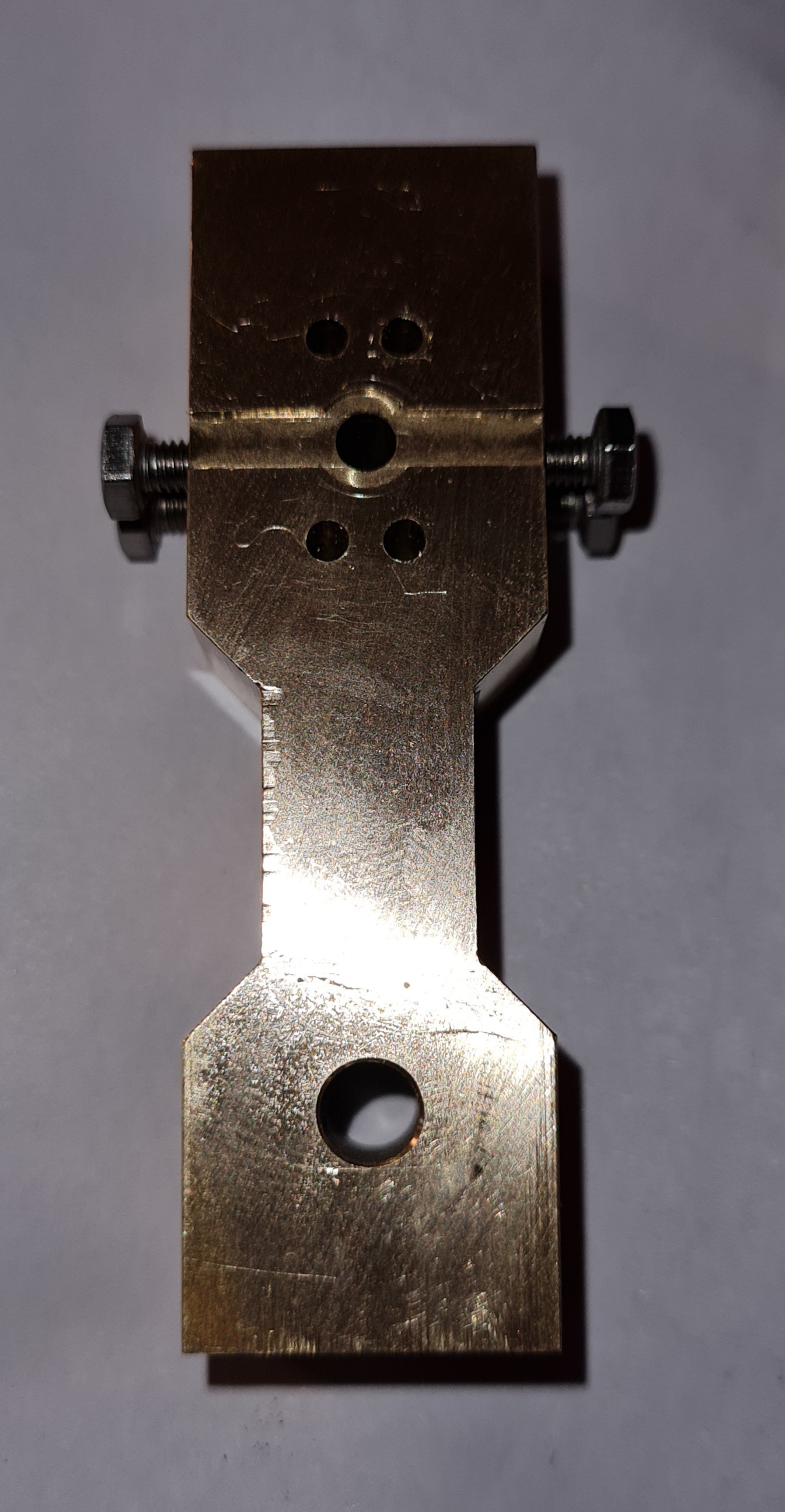

I have arrived at a solution for converting from single acting, single cylinderto double acting twin cylinder and it is surprisingly easy. I bought the standard and reversing valve from Jerry at Clevedon Steam, it is what is used on his Virgo engine. It was almost made for the job! It will be cut on the line shown in the pictures and silversoldered between the laser cut engine frames I got from Camden Minature steam. In order to make the ports line up, I will use a 1/16 ball nose end mill to machine 1/16 deep grooves on the inside faces of the two laser cut frames/standards before silver soldering the three parts together. I will need to make a new spacer piece to accomodate the 16.5mm gap between the engine frames. The 16mm gap will just about acommodate the flywheel and drive gear, which will be pinned to the flywheel. Job done! (In theory at least!).
The following photos should explain....
Standard sandwiched between the two laser cut frames.
Standard as supplied by Clevedon Steam. It will be cut where marked in first photo.
Frames as supplied..
Frames marked fot port alignment grooves.
