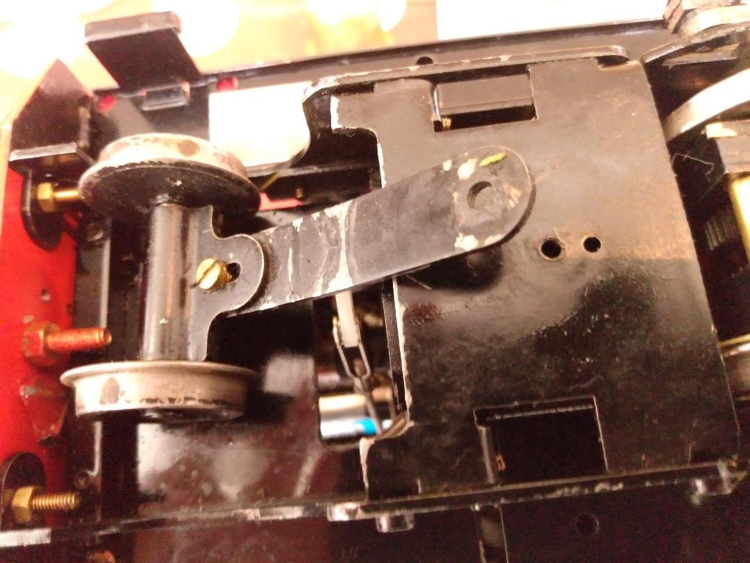

The run up the line was somewhat erratic, lots of stopping and starting, and when the train reached Clarach it would go no further. Looking at the valve gear I noticed at least one of the problems - a screw had worked loose, with this result:
I placed the loco on the deck to cool down, then brought it indoors to take the above photo - at which point the rear pony truck fell off!
Naturally, the screw which had secured it slipped between the decking boards, never to be seen again...
Both problems look like they should be fairly easily resolved by obtaining the right screws - can anyone advise what they are please?

Andrew,
The valve gear link in the picture is purely cosmetic.
Perhaps the loco stopped because the loose link or the pony truck jammed.
Anyway, a phone call to Roundhouse will sort you out.
Tel: 01302 328035
Email: mail@roundhouse-eng.com
Rob (also owner of an elderly Russel)

You get days like that.... All part of the rich tapestry of life.Andrew wrote: Sun Jun 13, 2021 7:23 pm This afternoon I took Russell out to run my first steam service in over 6 month - all did not go well...
The missing bits connecting the anchor link to the dummy combination lever are a nut and a bolt. M2.5 in current locos I think, so you've got two parts that are MIA.
The rear pony pivot on a Russell is probably the same as the front one. Again two parts are MIA, a pivot screw and a coil spring on a Russell, I think. The pivot screw will likely be a shouldered screw, so not a standard fastener.
Best thing is to talk to Roundhouse. One more advantage of owning their locos is you can usually get parts, especially custom fasteners, unless the model is very ancient.

Yes, that makes sense - in retrospect, it was when the loco stopped that I noticed the flapping valve gear link, so I put two and two together and made at least four and a half... Thinking back, the loco came to a grinding halt on the barrow crossing, and I had the same issue there a few years back when a pony truck screw had worked a little loose and fouled the crossing.MRail wrote: Sun Jun 13, 2021 7:34 pm The valve gear link in the picture is purely cosmetic.
I shall indeed drop RH a line - but at least I know roughly what I'm asking for now, thank you!GTB wrote: Mon Jun 14, 2021 4:28 am
