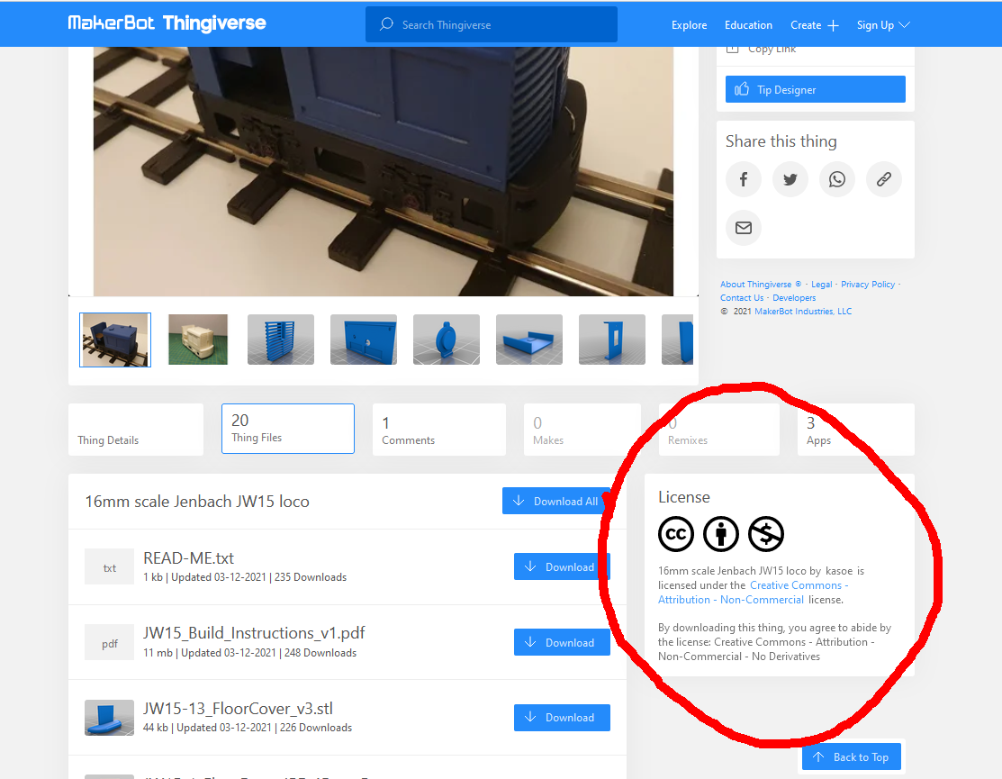

Rod, I've edited your post to add the CC licence info from the Thingiverse page, which we ask people to do with thses links, to avoid any pirating as happened with my platform front.
To add the picture, you first need to download it from Thingiverse and save it to your phone/computer. Then upload it to your post on here.

Sorry Phillip, I forgot to add that. How did you do it please. Is it the information on License and just copy and paste it.

FWLR wrote: Fri Apr 23, 2021 9:16 am Sorry Phillip, I forgot to add that.
No prob.
FWLR wrote: Fri Apr 23, 2021 9:16 am How did you do it please. Is it the information on License and just copy and paste it.
Just copy and paste the bit I've outlined in red.
Screenshot 2021-04-23 11.47.08.png (261.25 KiB) Viewed 121496 times
Re: 16mm scale Jenbach JW15 loco
Post by FWLR » Sat Apr 24, 2021 7:25 am
Thanks Phillip...

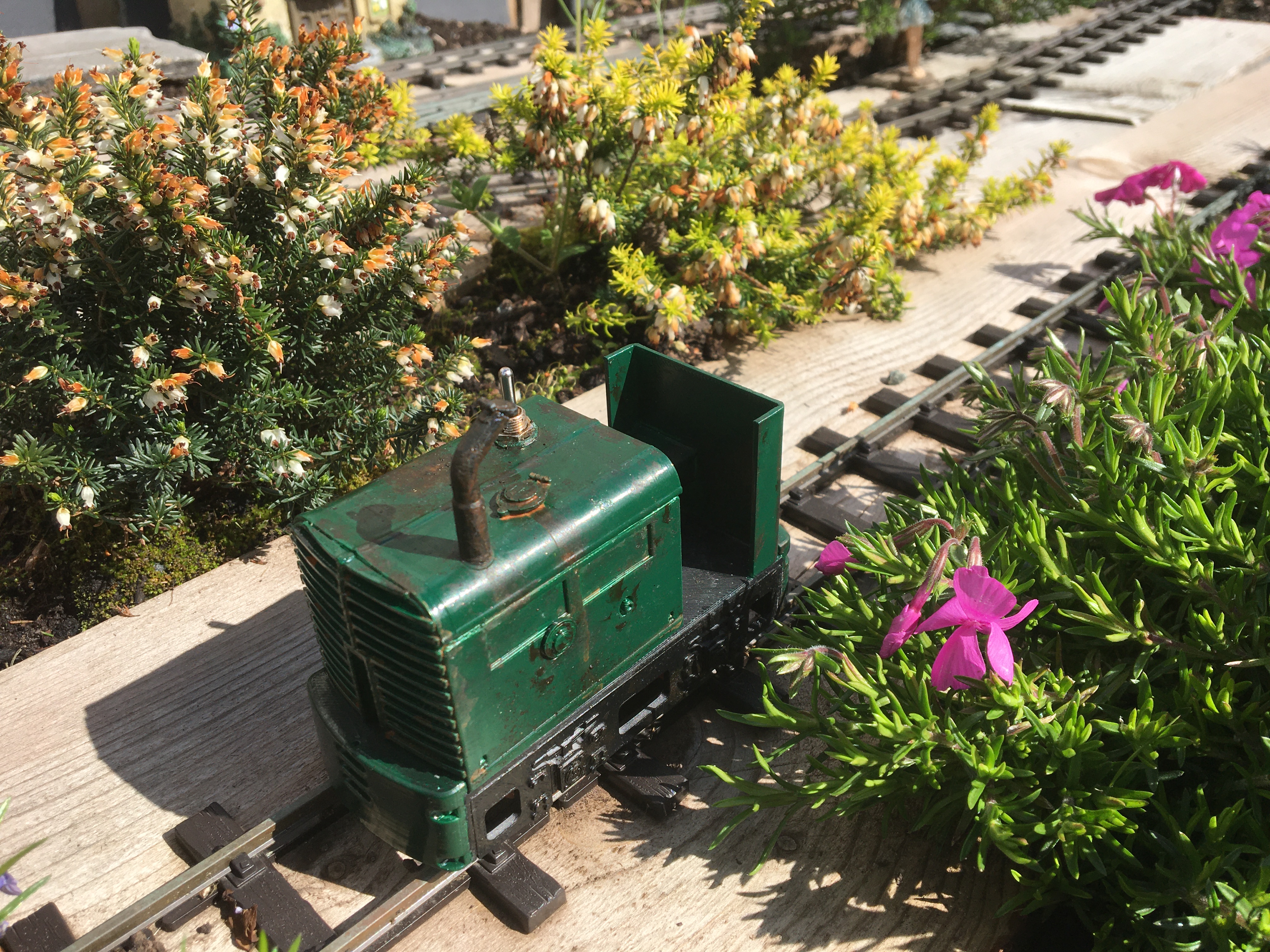

Post by FWLR » Fri May 21, 2021 3:07 pm
Well I have finally got around to finishing the JW15. It's turned out ok I think, although there is no room to put anything else under the hood. The running of it is not that brilliant either even with the same motor I think that Steve got, it keeps on moving slightly forward, therefore binding and jamming...I printed another exhaust for it also.

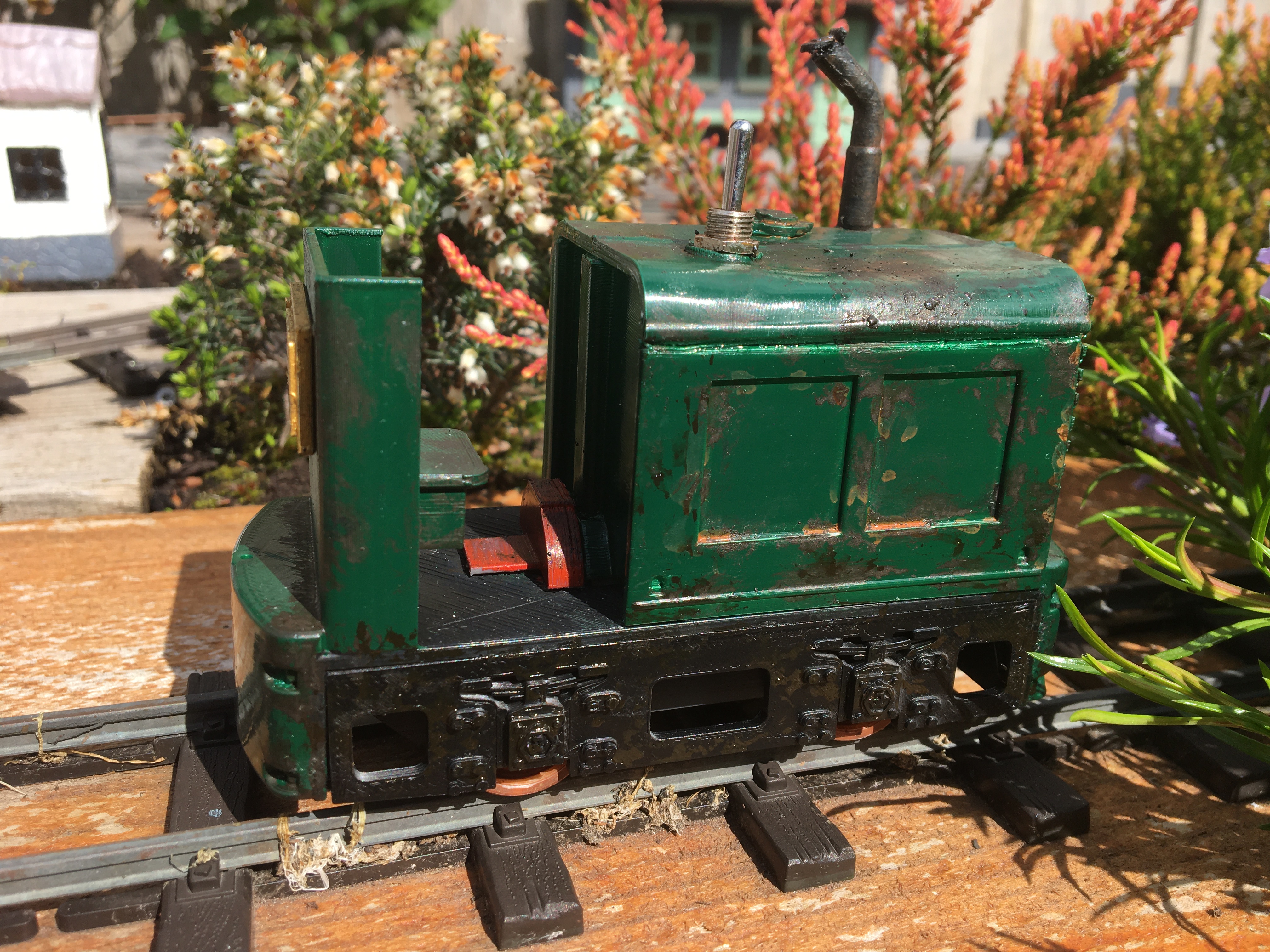

Post by FWLR » Fri May 21, 2021 3:09 pm
It as my youngest grandsons name on it, which I also 3d printed.
Post by FWLR » Fri May 21, 2021 3:13 pm
Last photo sorry for doing it this way. I haven't been sleeping to good and I am really really tired.
Also while I had the hood under a desk lamp in the garage trying to help in the drying of the paint, it was throwing it down for 5 days up here when I decided to paint it with a rattle can, the heat from the lamp distorted the hood a bit. I think it makes it look better..... :dontknow:
Post by Andrew » Fri May 21, 2021 3:29 pm
Looking good Rod!
It's a pain that it doesn't run as well as you'd like, but even if it just ends up as "scenery" (gently rusting at the end of a siding or as a load on a well wagon) that little loco's a great addition to your line. The garden's also looking very good, by the way - mine's a windswept wilderness at the moment!
Post by FWLR » Sat May 22, 2021 7:26 am
Thanks Andrew, your kind comment is very much appreciated :thumbright:
It does look good on the line I must admit. I will have one more go at trying to get it to run, maybe just run it with 2wd instead of 4wd......

Post by ge_rik » Sat May 22, 2021 8:15 am
FWLR wrote: Sat May 22, 2021 7:26 am It does look good on the line I must admit. I will have one more go at trying to get it to run, maybe just run it with 2wd instead of 4wd......
It certainly does look good, Rod. Good idea to start by removing the 4wd mechanism, then you can narrow down the reason for its running problems.
