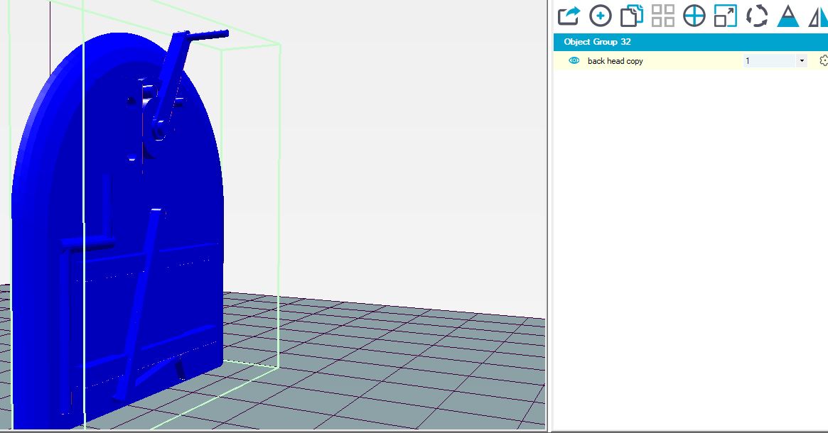

I tried printing the water tank. It told me there was something wrong with the mesh in cura but I continued with it and when it printed all the rivets just fell off at touch at the base of one of the sides, like they are not attached properly. I "doubt" this is a printing issue as the printer has been turning out perfect print after perfect print up till now. Suggestions? Could it be because I am not using a Mac for some bizarre reason? Any help would be appreciated.
- Posts: 6036
Re: Welsh Pony
My guess would be that the rivets are separate, i.e that the backs of the rivets are still there. I've had similar problems before myself.-steves- wrote: Wed Apr 07, 2021 9:16 pm I tried printing the water tank. It told me there was something wrong with the mesh in cura but I continued with it and when it printed all the rivets just fell off at touch at the base of one of the sides, like they are not attached properly.

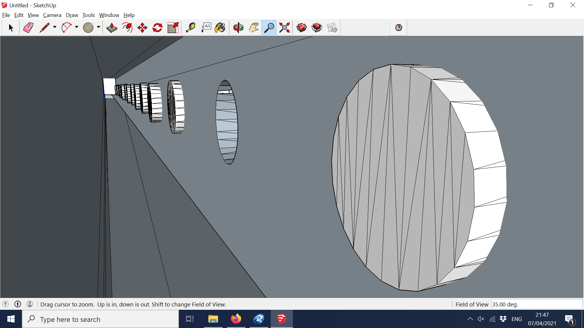

I've just downloaded and looked at your revised water tank stl.
I'm not sure in what way you've altered it, but it doesn't seem to have changed the actual drawing? I suspect that you've simply grouped the whole thing again, but if so I don't think that helps, because as I understand it, slicers ignore groupings.

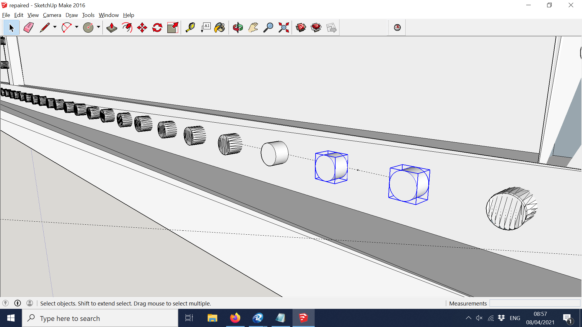

I've just taken one of your new sides and exploded it right down to the basic drawing and then removed the inside face of the tank, to see what is going on.
Then I took three of your rivets off and relkaced thrm with three that I've just drawn, keeping the same diam as yours but only 0.5 long.

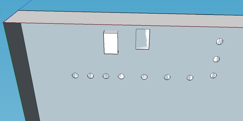

On the following screen shot, you can see my three. The RH one was placed on the surface as a group and then ungrouped and as you can see it is an integral part of the skin.
The middle one is still grouped and hasn't intersected and this is how the RH one looked before I ungrouped it.
The LH one is grouped and has a back on it so it is a solid cylinder not a tube. The same view from the front.

All of the models I have drawn which incorporate rivets have the same problems. It is really an issue about how well do I understand sketchup, and how it works. I have got away with this for this long because my printer and its dedicated slicing software can correct these things and usually prints what I expect - so for me and others with the same printers it isn't an issue. That doesn't mean I don't need to know what I'm doing - I often come up with problems getting sketchup to do what I want! I am sure there are others who would welcome the deeper understanding.
So I will go back over one of my drawings and try to sort out the rivets! If I understand correctly what I am looking for is for the inside view to show a hole - and for the outer surface of the component to show a continuous face.
I understand that the rivets need to be ungrouped - I didn't actually group them but drew one, copied and pasted it , selected both and copied and pasted them. I think I also have to intersect the faces in the component itself. Can I have the rivets as components and the frame as a component and successfully intersect the faces - that surely must work? I will follow your instructions later and see how I get on!

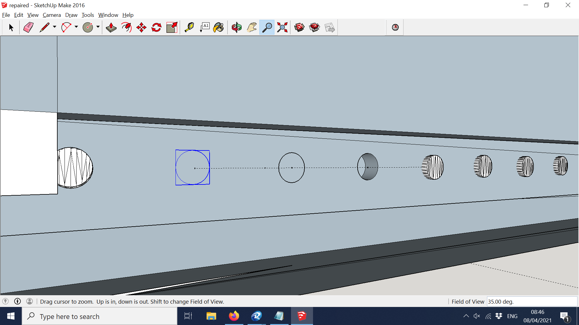

This may get a bit long, so bare with me!
How to create equally spaced multiple copies of an object such as a rivet in Sketchup.

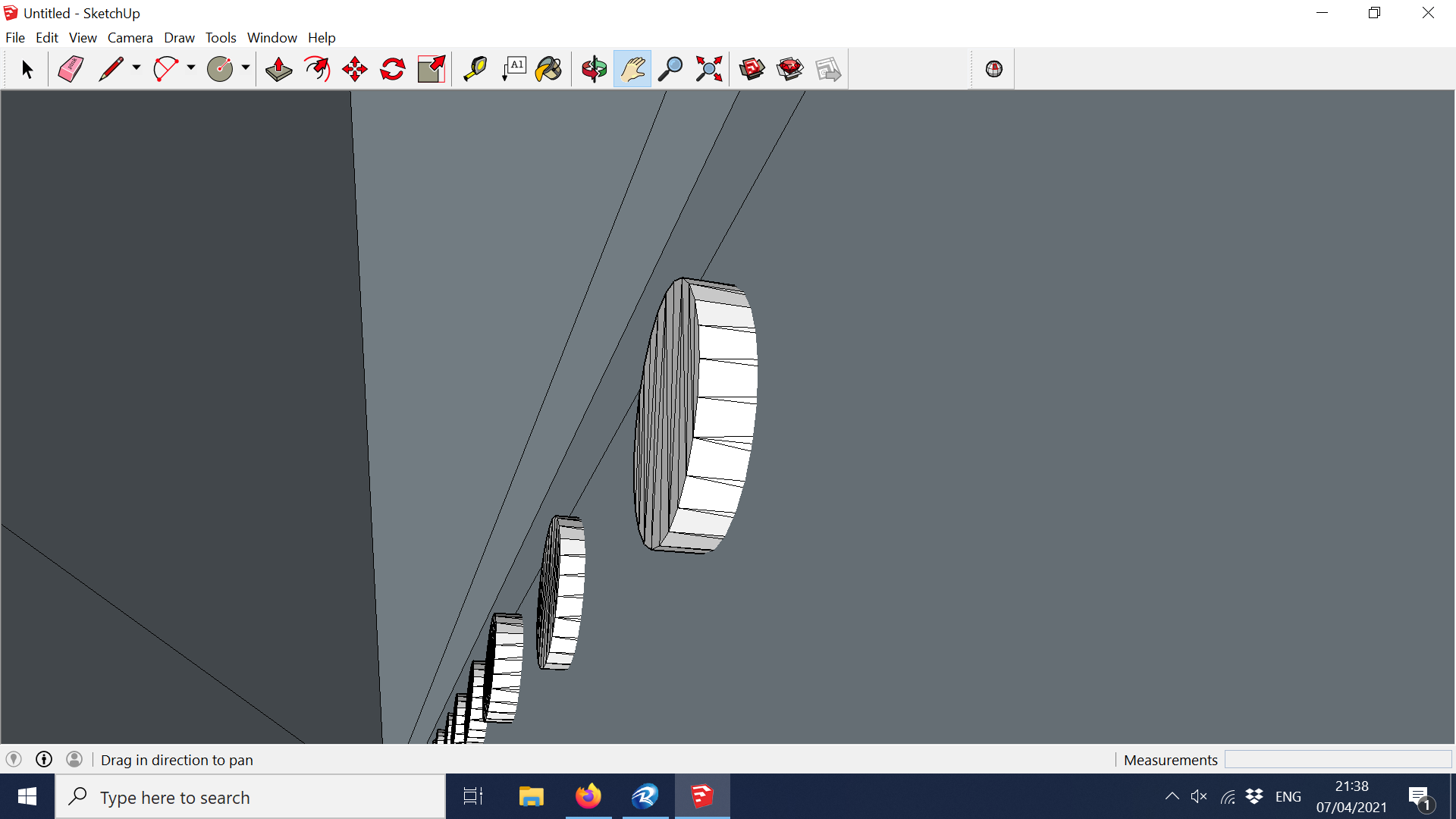

Note for illustration I've created a small block and deleted the back face to enable a view from the inside:

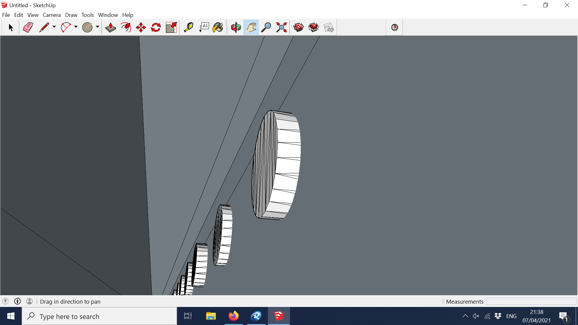

1) Draw a circle of the required diameter ( these are 0.5mm radius - 1mm diameter ). The picture shows the circle is visible from both outside and inside.
2) Extrude it to required depth ( I've used 0.5mm extrusion). This picture shows it is extruded above the surface and from the inside is a hollow cylinder that is part of the 'skin' of the base block.
3)'Select' the rivet, then copy and paste, then make the copy into a group.
4) Copy the group and do Ctrl V to paste it onto the surface of the block twice.

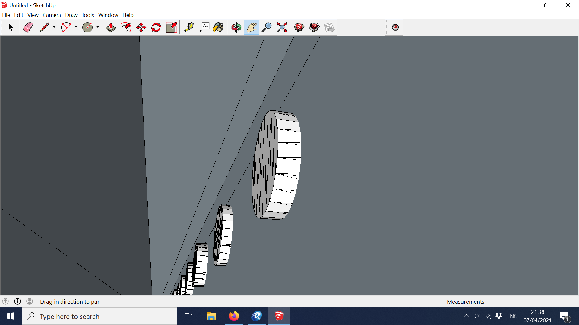

5) This picture shows, from the inside, that both are on the surface but have NOT properly joined it.
6) Explode one of the groups. From the inside it will still look the same except the blue square bounding box has disappeared. The circular base lines will look thick, so zoom in until you can see the individual segment lines of the 'circle', then use the pencil tool to draw over one of the segment lines, click at the end of the segment and the whole circle will change to thin lines.
7) Click in the centre of the circle and it will go mottled, then RIGHT click and select 'erase', or simply hit your delete key, and the circle infill will disappear and the hollow rivet will become visible.
This routine is handy if you need to do any corrections subsequently or add an odd one for some reason, but it would obviously be a real pain to cover a long length of tank side with rivets this way! Fortunately there is a much easier way to do that, although it does take a bit of getting used to!
OK.... go back to (2), i.e you have a hollow rivet on the surface, with no back face.
8 ) Draw or place a rivet where you want the line of them to start. Then draw a guide line in the direction you want the rivets to run.
9) Select the start rivet so that it is shown in blue, then select the 'Move' tool ( 4 arrows) and then IMMEDIATELY hit the Ctrl button. You should see a small ' + ' appear at the bottom corner of the 4 arrows.( I can't show this because tools don't show in screen shots for some reason)
10 ) Click on the start rivet and slide the cursor in the direction you want to multiply it - you should see a duplicate rivet move away from the original.
Let go, then type the separation distance you want between each rivet, ( I've used 2.5) then type the number of duplicates that you want ( I've typed 4) and they magically appear. If you look inside you'll see they all are hollow and therefore part of the model.
11) It is possible to do it the other way round by typing the overall length and then the number of rivets you want followed by / instead of x i.e 50/20

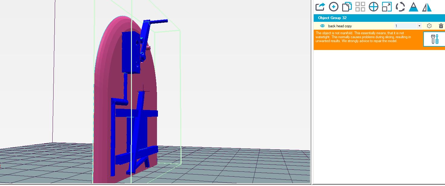

I can "correct" rivets as you have suggested. However it still leaves me concerned. I use "components" extensively. Lets say the rivet is a component (which it is). I can copy and paste them, I can copy them a set distance apart along a guide line. I SHOULD be able to successfully print an assembly which consists of a number of components - without having to copy and paste all the components into a single component - which is basically what you are doing. It is good practice to use components, for a number of reasons.
I have been printing assemblies of multiple components so far - successfully with my software ignoring the message in solid inspector about nested items. On the basis that there are nested items - all of the components. They print successfully for me like that . So how do I reconcile this?

1) Draw rivet
2) Highlight it ( turns blue)
3) Select "Move"
4) Hit "Ctrl" ("Command" in Mac?) and small + is added to Move icon.
5) Click and hold on 1st rivet, then drag in the desired direction - a copy appears and moves with the Move cursor.
6) Release mouse
7) Type "2.5" and hit Enter ( the copy should move to the set distance)
8 ) Type "4x" and hit Enter and it should duplicate 4 more so that you end up with a line of 6 in total.

I've been playing this morning with a simple line of rivets and components:
1) Drew a simple block 50x25x2, took the back off and and made it into a component.
2) Drew a simple 1mm diam circle on the surface of the block component. Looking at the back, the circle shows with a sort of shimmery semi-transparent centre.
3) Extruded the circle to a 0.5mm high rivet. Still looks the same from underneath.
4) Made the rivet into a component, still looks the same but with a blue bounding box.
5) Tried to duplicate the rivet multiple times and it worked perfectly and each one is a component. Looking from underneath, they all have the shimmery face infill. I suspect that this effectively shows the boundary of the component rather than being 'real'.
So it looks as though drawing on the surface of a component works as though the component boundary isn't there, and placing one component onto another makes it join automatically. This may explain why your angles don't fall off.
As for why the rivets are a problem, I may have found the answer to that. I drew a simple rectangular block, made it component and then inserted it through the surface of the block, not on the surface. When you look from underneath it is still the complete block, it hasn't joined it. However, placing a 2nd copy (component) actually ON the surface, looks exactly the same as the rivets, with the shimmery infill.
I remember reading that slicers ignore component and group boundaries and treat the objects as though they were combined, but presumably this doesn't hold good if they are not co-planar.
I can see the advantage of only needing to make alterations to one component for others to alter automatically if you are using multiple instances, or if you use the same component in multiple drawings. It isn't something I've found to be a limitation so far, but I must think on it more.
Re your point about open backs and why your angle strips didn't fall off when the rivets did. It was Steve who had the problem with rivets falling off, so although I have seen that problem myself in the past without knowing why, I don't have direct experience on your drawing.

I've been doing a bit of investigating myself. When I import an stl into Sketchup, it loses all the component and group boundaries so to some extent I'm guessing what you did to start with.Trevor Thompson wrote: Tue Apr 13, 2021 11:20 am I have had problems with rivets falling off. I thought I had got around it by dropping them below the surface - so I was sure they intersected the surface. Perhaps a better way is to use a guide line to encourage them to sit on the surface.
However, from my experiments, a component rivet will sit ON the surface and 'bond' with it automatically as long as you get the first one in the correct place, ie you get the little tooltip that says " on surface". Once you have the first one in the right place, you can then multiply it as we discussed a few days ago and they will all bod to the surface and shouldn't subsequently fall off.
Similarly if you get two groups or components they will snap together, just position them roughly then zoom in, select and grab one of of the objects and drag to to where it should mate with the other one - I find a sharp/square corner is the easiest place to do it..

OK, time for an update from me.
There are a number of unprintable stl files in a couple of items, I wont go into it too much, but suffice to say Cura is really not happy with some of them at all and refuses to print certain parts as they are not attached. At the moment my only fix is to import them in to Repetior Host and force a fix on the stl, which most of the time it manages quite well, but sometimes just gets rid of a bit of the file, like one of the borders on a name plate, bizarre!
This is what it looks like in Repetior before and after it fixing it
