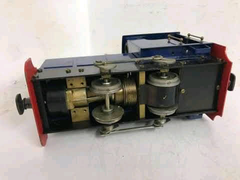

That's a very interesting loco.. It's a small chassis and the motor with clutch and drive fits very nicely in the outline.. The big question I have seeing this, is how does it cope with the heat of the motor? There is no propellor forcing wind through the ribs.. Another big question would be about the noise. I imagine this outline with a small 4 stroke engine to reduce the fumes and a healthy silencer to keep the noise acceptable, when it doesn't overheat it would be a very nice addition to any live steam layout. 8)
