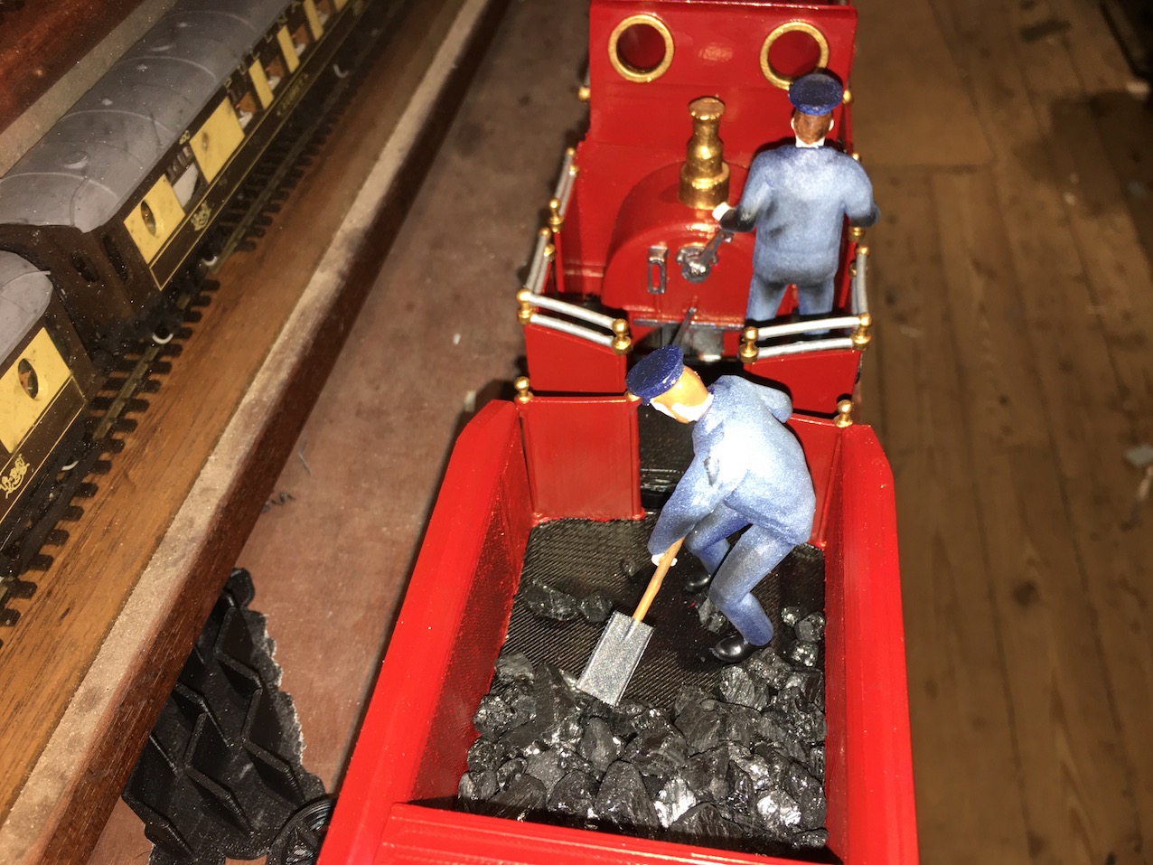

Yes the files are huge, 280 and 310 MB. Why they are so large -is beyond my current knowledge. Are all figures produced this way so large? Will look further into it.

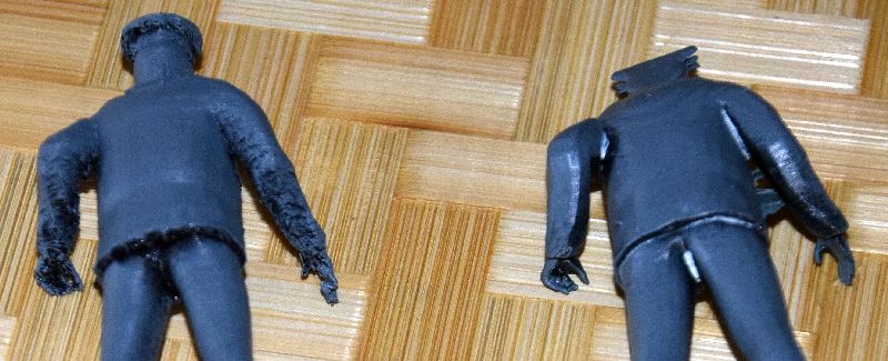

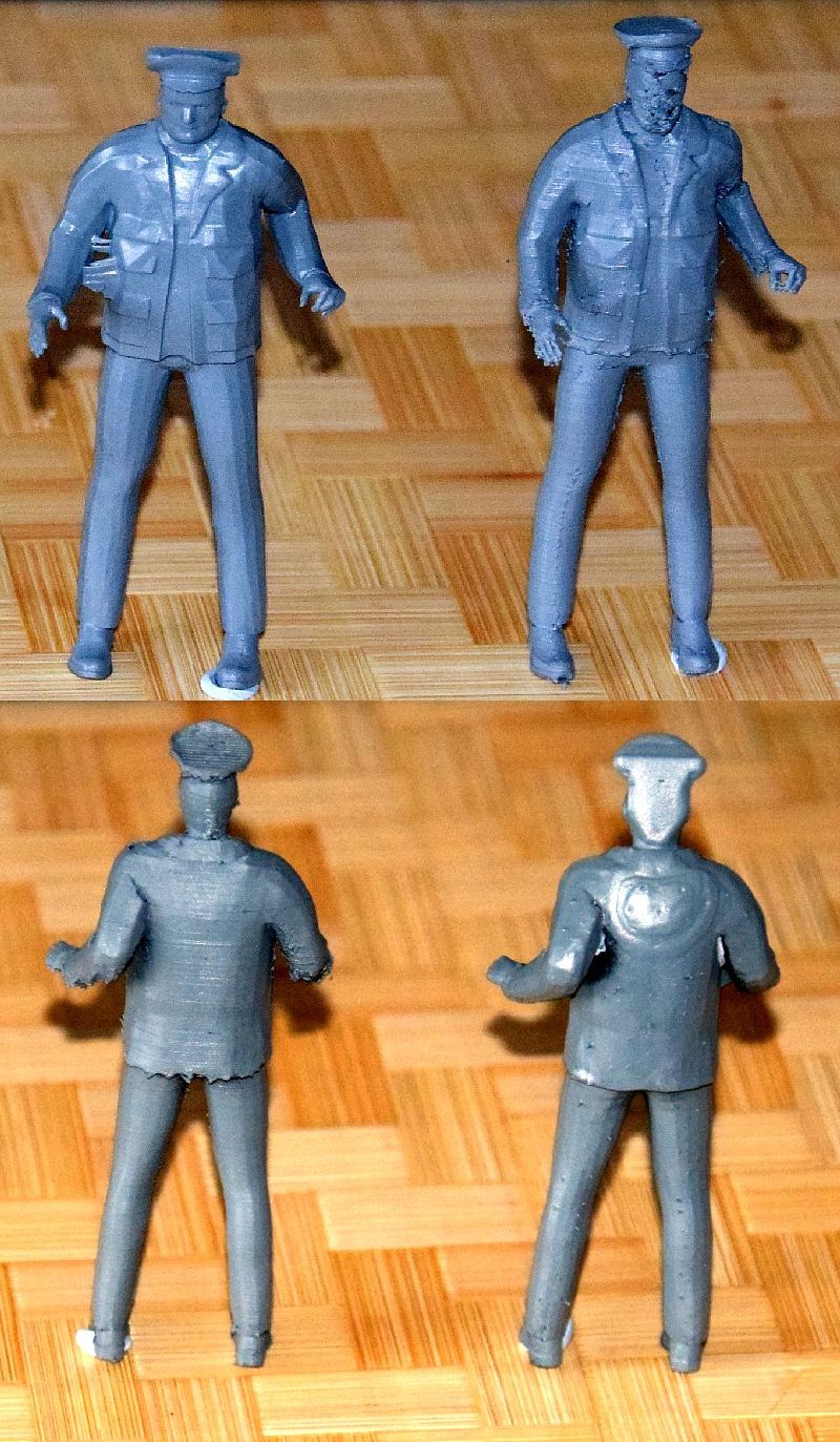

Just out of curiosity I've printed your driver figure on both filament and resin machines, with interesting results. Firstly though I must say that these aren't properly cleaned up, I just roughly took the supports off and quickly sprayed with primer and haven't done any filling or anything.
The resin one seems to have undergone some sort of partial headectomy
. Not sure why but I'm guessing the stand off from the raft wasn't enough to allow for the angle when printing.
Other than that, it is a much better print than the filament version. Oddly, the facets are much more obvious on the legs than the body.
There is some bridging between the right arm and the body, which is there on the stl itself and isn't a printing artefact.
The filament version suffers from holes in a mangled face, which I virtually always get when printing figures on my machine, so it wasn't a total surprise except that your one looks perfect, so it must be something to do with my slicer settings I think - what infill % and layer thickness did you use? Mine was 20% and 0.1mm.
My filament version also suffers from major yeuck on the underside of the arms, plus raggedyness at the bottom of the jacket, which I'm guessing has the same root cause.

I have to admit that I have been a bit premature in sharing these - and I really didn't intend them to raise all of these issues!
However I know about that film joining the arm to the body - I couldn't stop meshmixer doing it and I think there has to be a problem with the mesh somewhere in that area. When I printed it it fell off without much persuasion so I didn't see is a much of a problem.
I haven't tried to print these figures with my filament printer - I just assumed that if the resin printer could print them that indicated that they were solid and without mesh errors. My previous experience had led me to think that way.
The way these figures get flat planes on them is interesting. They go all the way back to makehuman and must be related to the file size there. I wonder if they can be altered? Certainly it is clear that meshmixer cant remove them it just makes the file size huge to achieve the same planes.
To show how they have worked out:
I will find the time to go back and try to improve the files! It is all a learning experience. I never would have thought I would be printing all of these people and "things" 15 months ago!

Sorry, I wasn't having a moan, I just thought it might be helpful to see my results.
I agree that 'flash' connection isn't a problem,it came off easily in the fdm version, I just didnt bother on the resin one and thought I'd point it out.
I'm not sure that my raggedy fdm results indicate mesh problems, I rather suspect my slicer settings as I said i.e infill%, wall thicknesses etc, allowing the inside to compromise the shell.

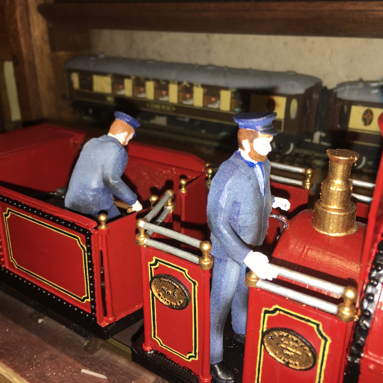

The end results on your loco look superb, I'm really envious and it just shows that your files do work. In fact my resin one is fine apart from me screwing up the position on the plate and getting him to close.
