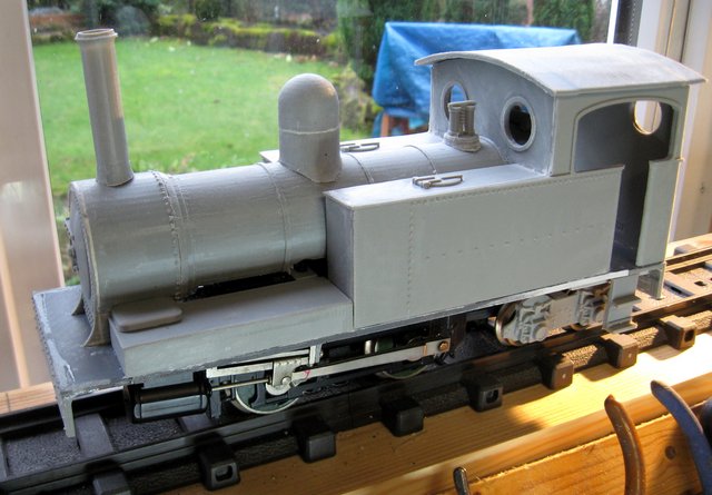

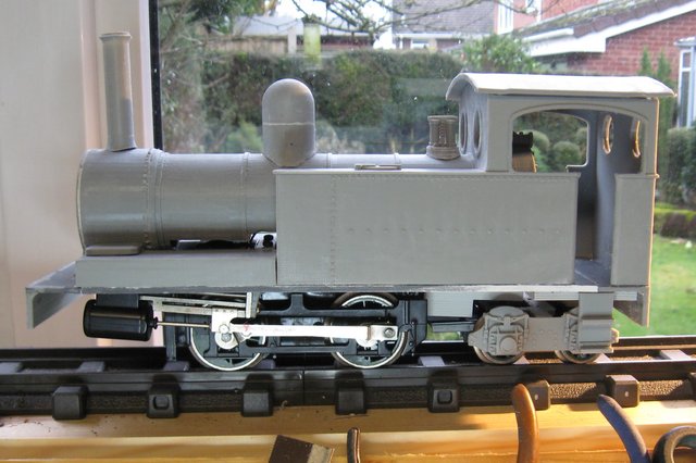

Although the Bachmann Lyn looks OK and runs reasonably well, she is not happy on my tight curves and so I'm planning to convert her into a loco similar to the Nasmyth & Wilson 4-4-0T which ran on the Schull & Skibbereen Railway. However, I quite like the wheel arrangement of a loco which they inherited from the Cork and Muskerry Rly which was an outside framed 0-4-4T and so I'm going to give them an illicit wedding. The wheel diameters and wheelbase is another heavy compromise, but all I can say is the outcome will be unique.
I've decided to 3D print this one - just to see if I can. Here's what the body shell looks like so far.
3D image1.jpg (94.3 KiB) Viewed 18456 times
3D image2.jpg (87.32 KiB) Viewed 18456 times
There's still a bit of tinkering yet to be done - a few more rivets and some of the gubbins below and above the running plate - but drawing her was actually quite fun.

I'm impressed, even more so to have produced that level of detail in tinkercad.
I've worked out how you've done the rivets (duplicate tool combined with a rotation and duplicate again, do an opposite pair so they rotate about the centrepoint).
However I am intrigued by the flare at the bottom of the chimney and steam dome.

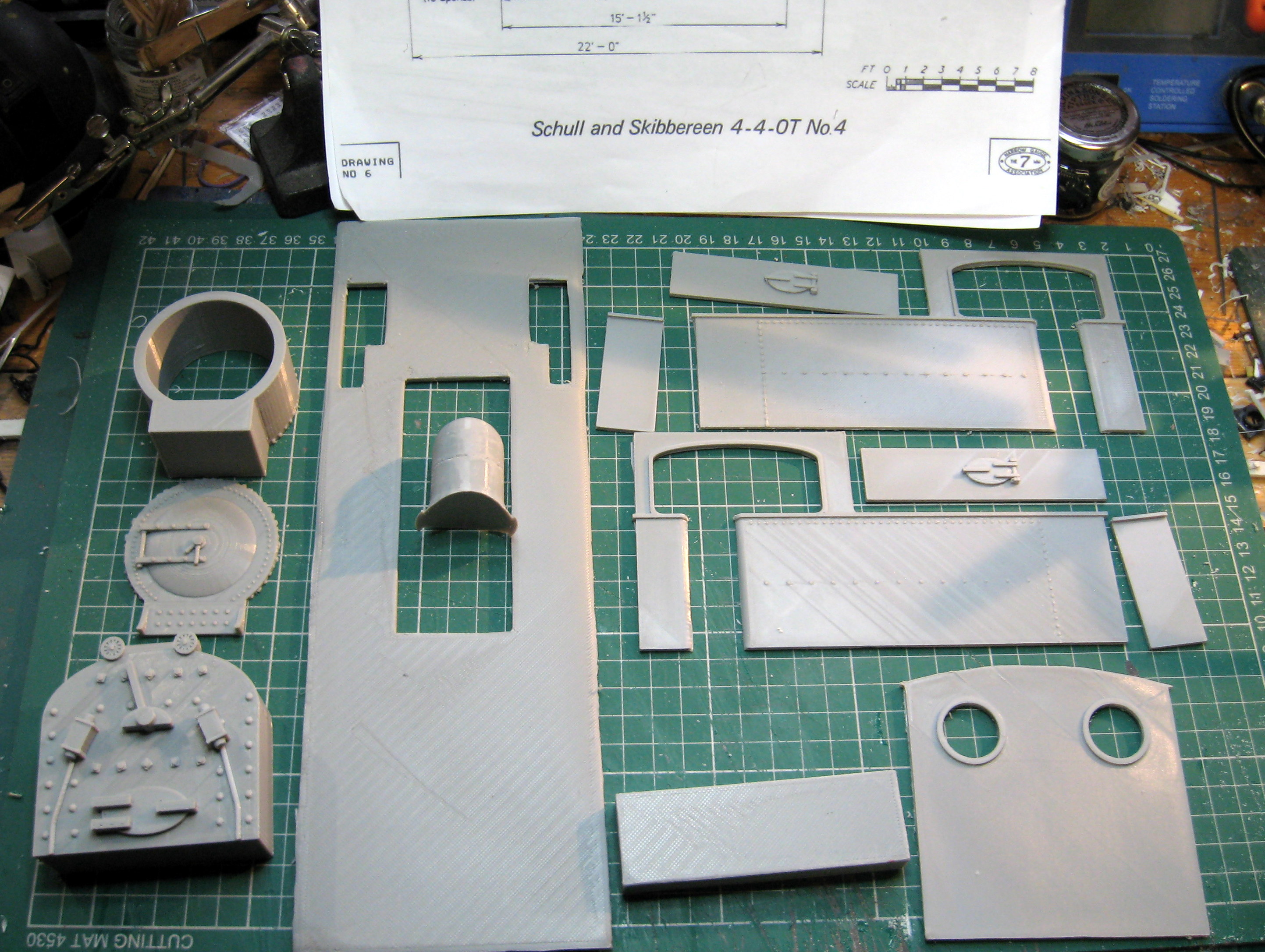

BorisSpencer wrote: Thu Jan 28, 2021 4:10 pm However I am intrigued by the flare at the bottom of the chimney and steam dome.
Not quite perfected the technique but I used a torus as a hole to cut the flare into a disk.

I take it you have all the parts for printing and are not intending to print it as one?
Looks great, I see someone else is spending far too much time in Tinkercad too, lol.

-steves- wrote: Thu Jan 28, 2021 8:34 pm I take it you have all the parts for printing and are not intending to print it as one?
Oh yes. All parts exist separately, disassembled and oriented for printing. I thought I'd design the loco this way. Normally, I do each part separately and end up having to figure out the dimensions. Well if this is going there, I need to take off 2mm for the thickness of that and add 1mm to ensure it fits into the other, ...... This makes it a lot easier.
Exactly the same as I did with my tram this time and for the same reasons. Not sure if it is great minds think alike or small minds differ little, lol.
I've done the same on occasions although this was where I found the shrinkage issue, that we've discussed before, rears its ugly head when tolerances are tight.

Post by ge_rik » Sun Feb 07, 2021 9:51 pm
About half way through printing out the parts ..... all OK except my heated bed has suddenly decided to develop a cold spot in the centre - so now having to position everything near the edges :?

Post by ge_rik » Tue Feb 16, 2021 1:22 pm
Taken a while, because I've been tweaking the design to fit the motor block. At first, the body was sitting too high up so I had to do some internal hacking to get it to sit lower.
I'll now have to go back and redraw some of the sections of the body, but I am happier with the way she looks. I also want to infill under the smokebox - it's looking a bit gappy there.
