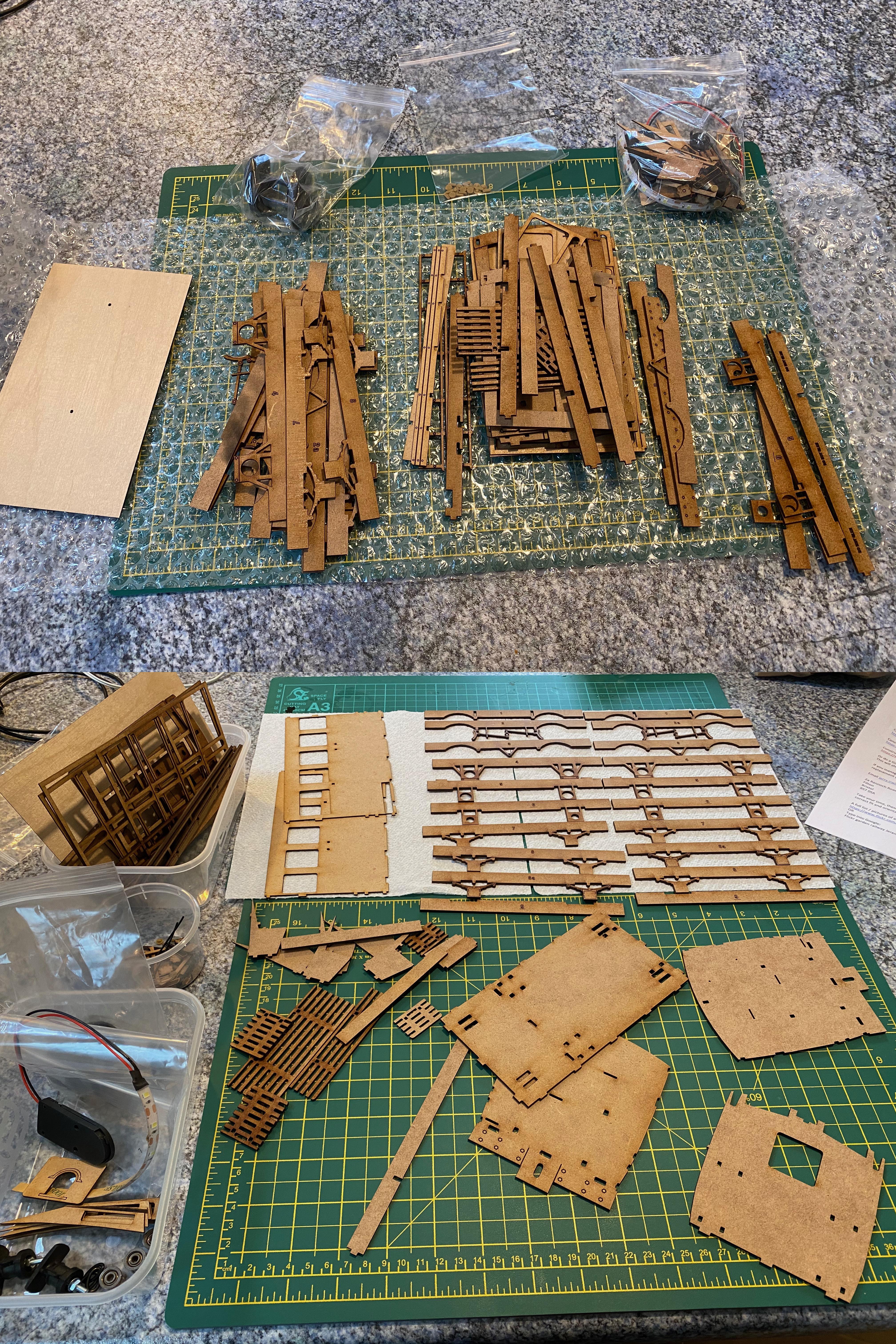

My latest project to while away the hours has been to build a freelance victorian guards carriage kit from Jeremy Irwin.
Having only built IP engineering kits previously I was blown away by the quality and contents of this kit. Other than glazing (and paint!), everything you need to build a highly detailed model is included.
* all carriage parts laser cut from MDF
* wheels + ball bearings
* lighting kit inc batteries
* 3D printed door handles + roof vents
* buffers
Here are the parts laid out on my kitchen table.
Having spent some time watching the build instructions video provided by Jeremy, I decided to start on the interior. Rather than paint the interior, I decided to try a wood stain + MDF sealer + lacquer approach, which I think has worked quite well. The floor was sprayed with PlastiKote grey after sealing with MDF sealer.

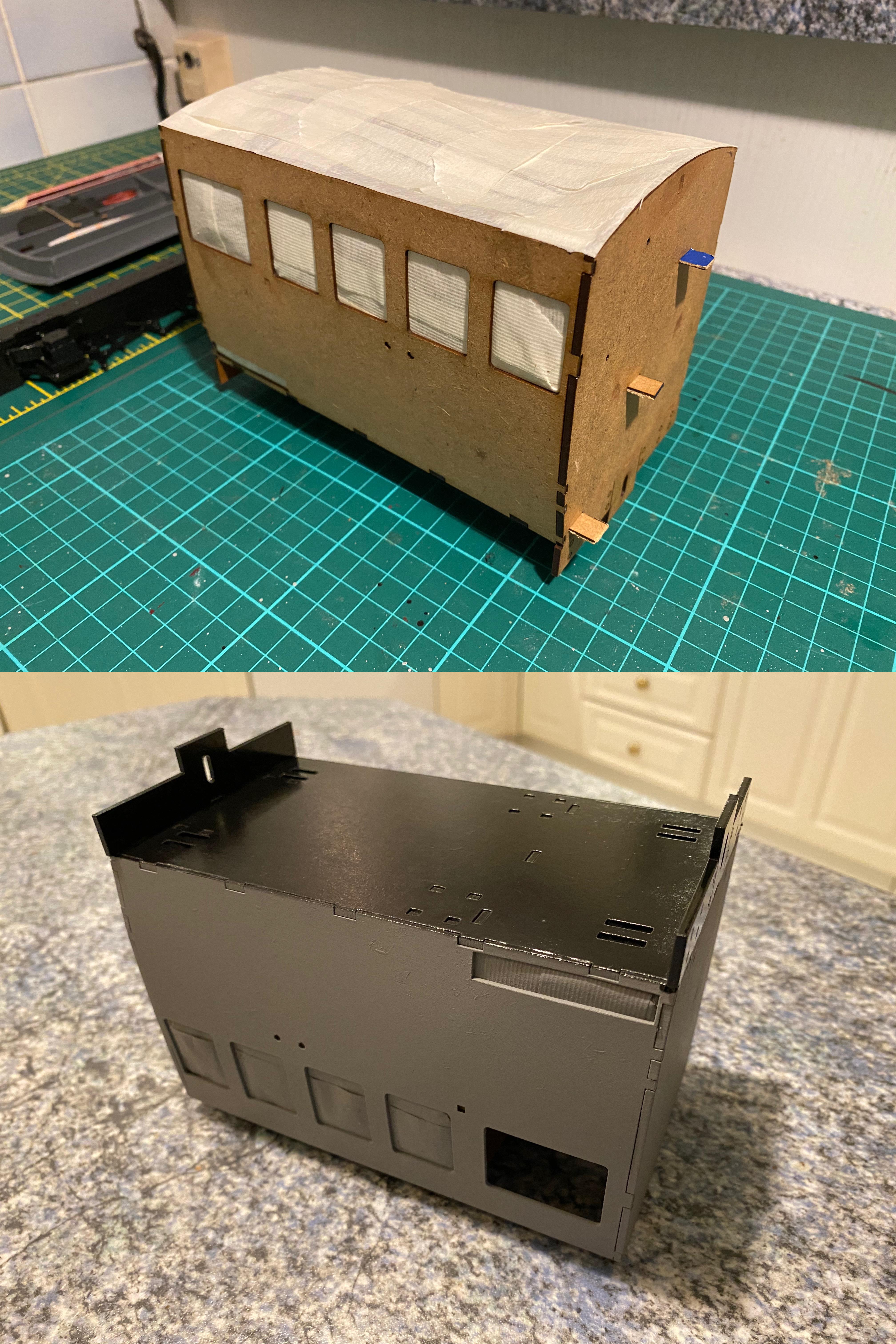

With the interior completed and the main body constructed, I started painting. The roof was assembled and painted as well as the ~ 10 layer sides for the under frame.
First off I covered the windows + roof opening with masking tape from the inside to protect the stained interior. The carriage was then sprayed with grey primer, I've been using Rust-Oleum Surface Primer Grey so far which seems to work well for me. The bottom side was painted with Satin Black spray paint.

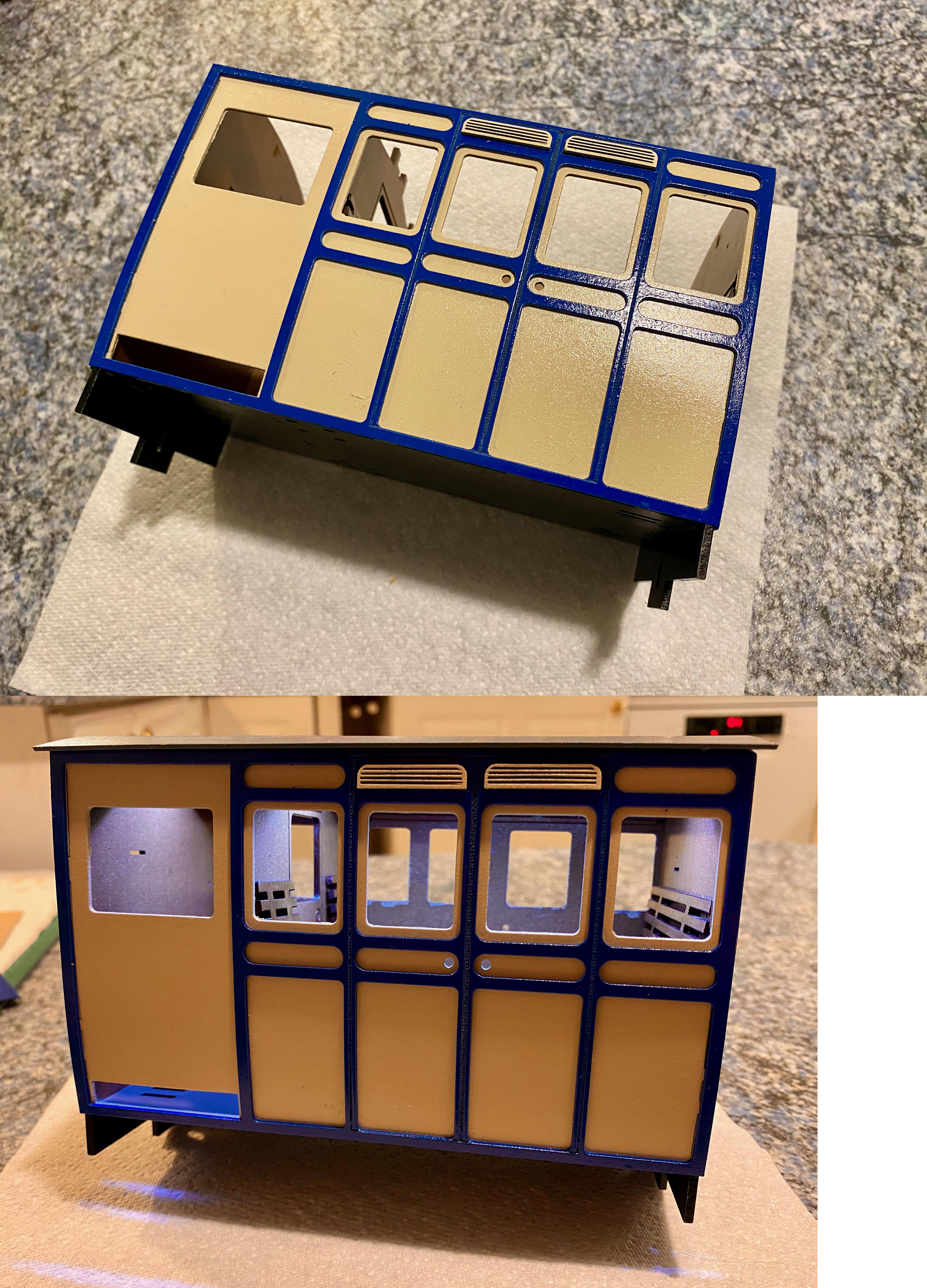

After some discussion the forum, I changed my plan to do a split cream & blue livery with black overlays to a simpler cream & blue colour scheme.
Cream - Hycote XUK1027 Ford Sierra Beige
Blue - Plastikote Gloss pacific Blue Spray Paint (ral5010)
I learned the hard way that these paints do not like each other's company, having painted the duckets in blue then attempting to overspray cream. The paint reacted and cracked up. I stripped the paint, re-primed and then painted separately. I think i'll try and get paints from the same manufacturer if possible.
The interior lighting was fitted and a quick test, everything looking good so far!

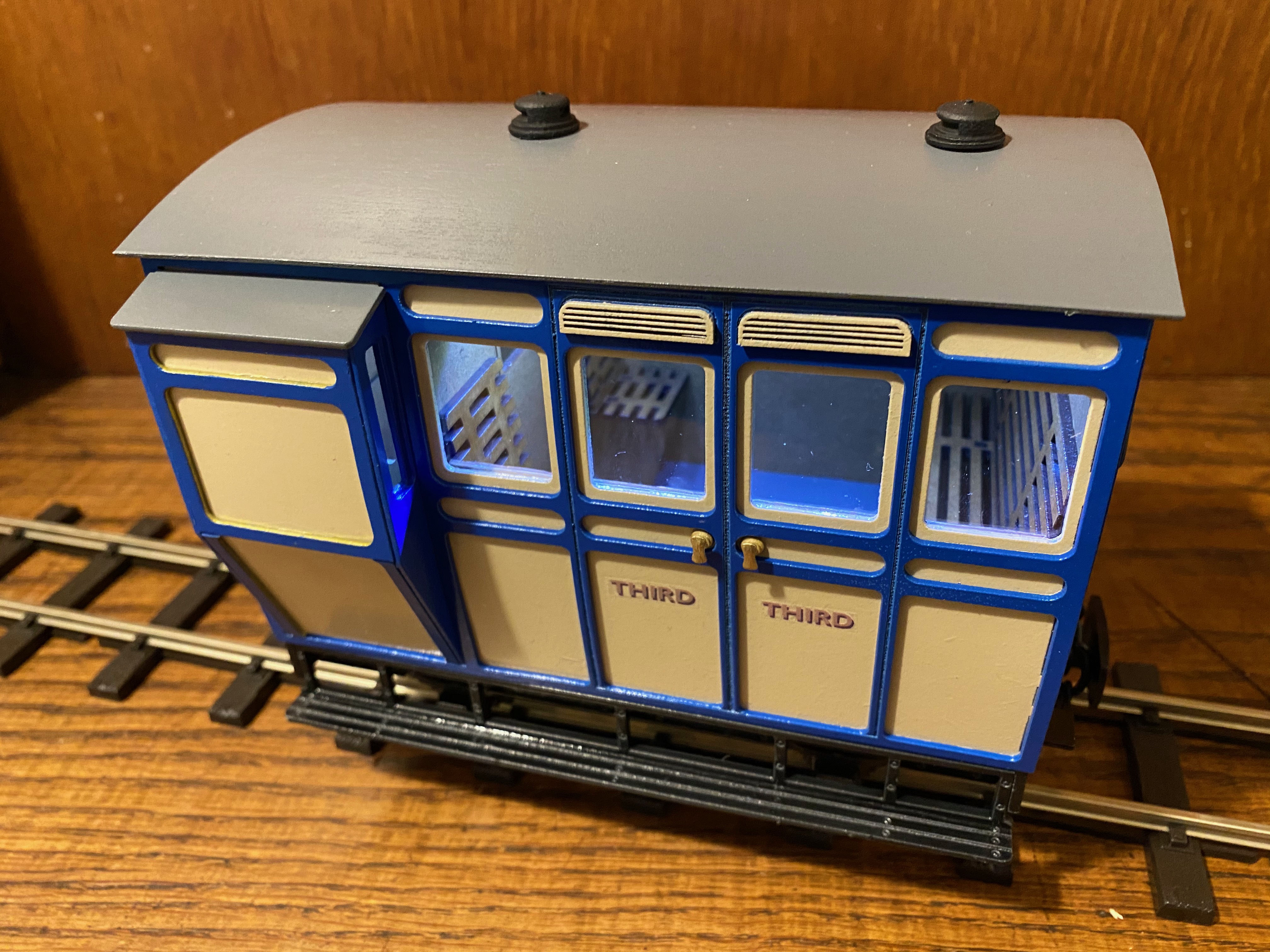

Decals from IP engineering were applied followed by a coat of semi gloss lacquer. Steps and hand rails were glued into position, as well as fitting the under frame and wheels. I splashed out on some brass handles from swift sixteen for the exterior. For the interior I used the supplied 3D printed parts. For simplicity I used a single run of 1mm perspex for glazing. Given I had made some effort to present a well finished interior, I tried to mask the perspex with some balsa cut into strips, stained with wood stain and then lacquered. The finish could probably be tidier but at least it covers most of the perspex from the interior.
The spray paint job isn't perfect but for my fourth carriage build I'm pretty pleased overall. I picked up some new tricks after watching Jeremy's build videos so hoping to continue to improve on my skills for the next build. I have two more kits from Jeremy to build next, both 3 compartment victorian carriages.

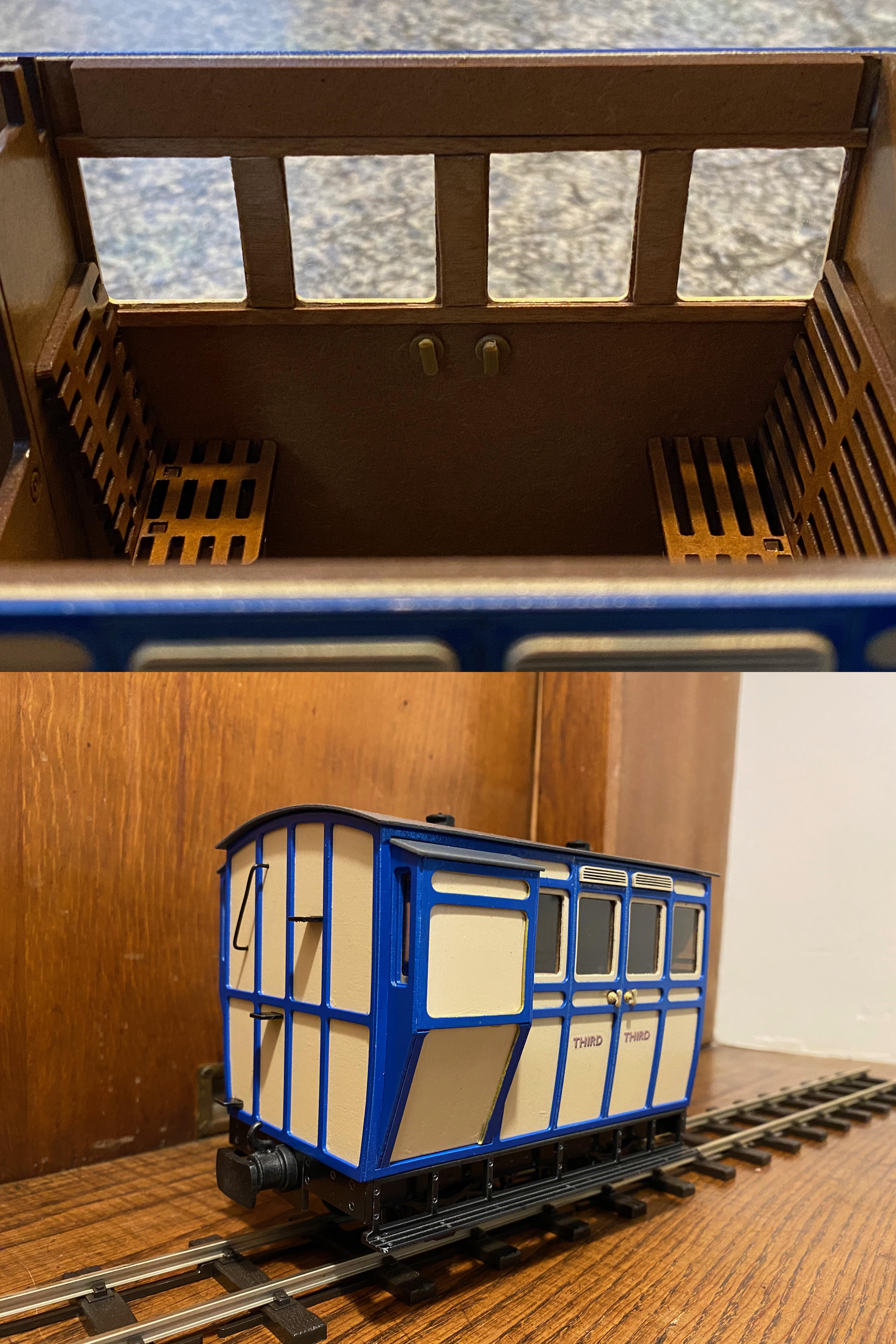

I've almost finished the second carriage in the rake. All that's left is some interior tidy ups to cover the perspex windows with some stained balsa wood. Less photos to share on this build.

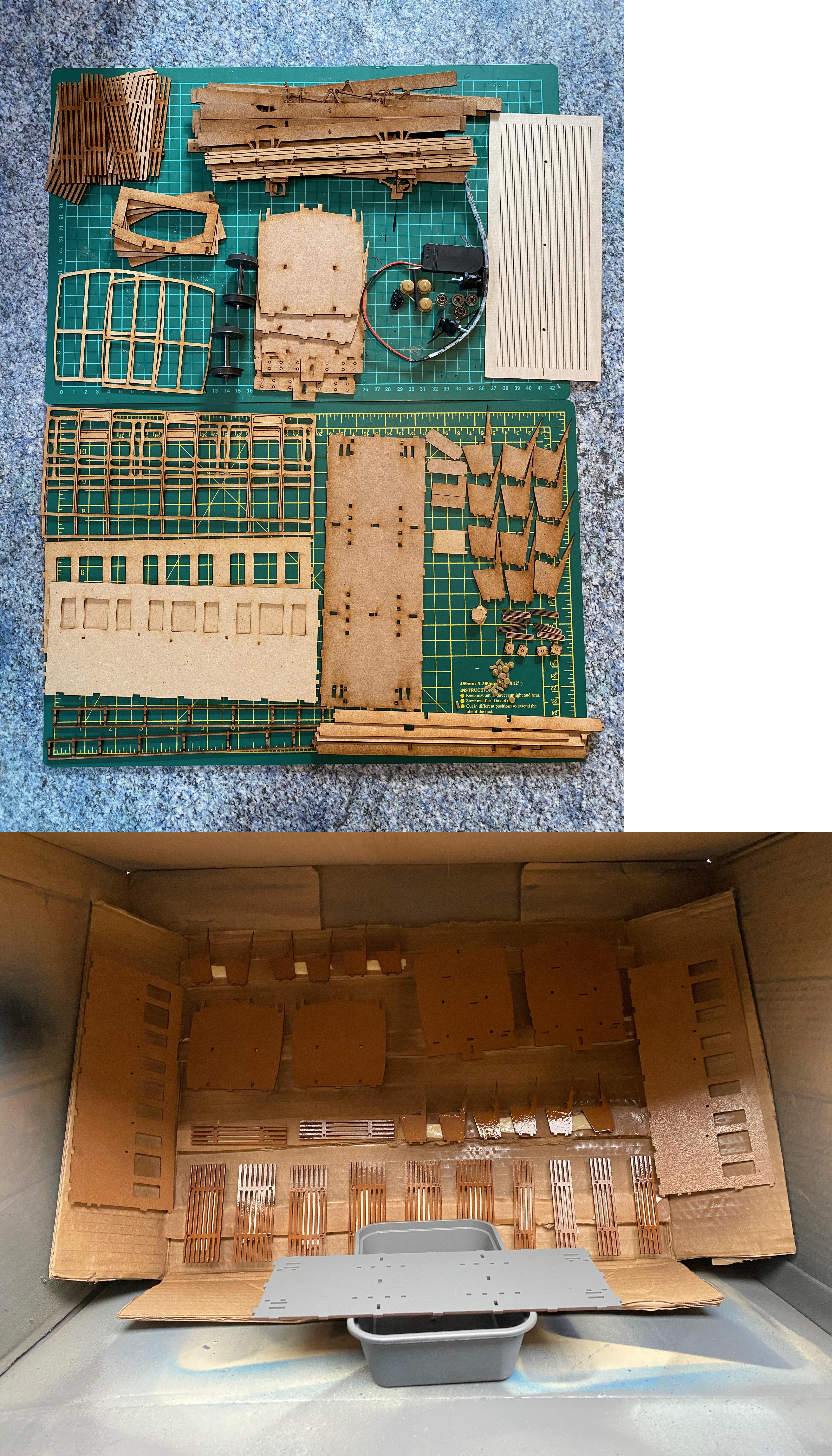

The first photo shows two stages with some bits skipped. The first half is all the kit parts laid out on the kitchen table. The second is during spraying lacquer after staining with antique pine wood stain + sealing with MDF sealer. This was a now seemingly obvious tip I picked up from Jerry's build videos where he uses small pieces of rolled up masking tape to attach pieces to a piece of cardboard. This makes spray painting much easier than my previous method of balancing pieces on various sizes of takeaway boxes.
I wanted to share some photos of the roof construction as compared to others I think it's really top notch. It goes together really nicely. The strange looking notches are to fit the supplied LED lighting strip & battery pack.

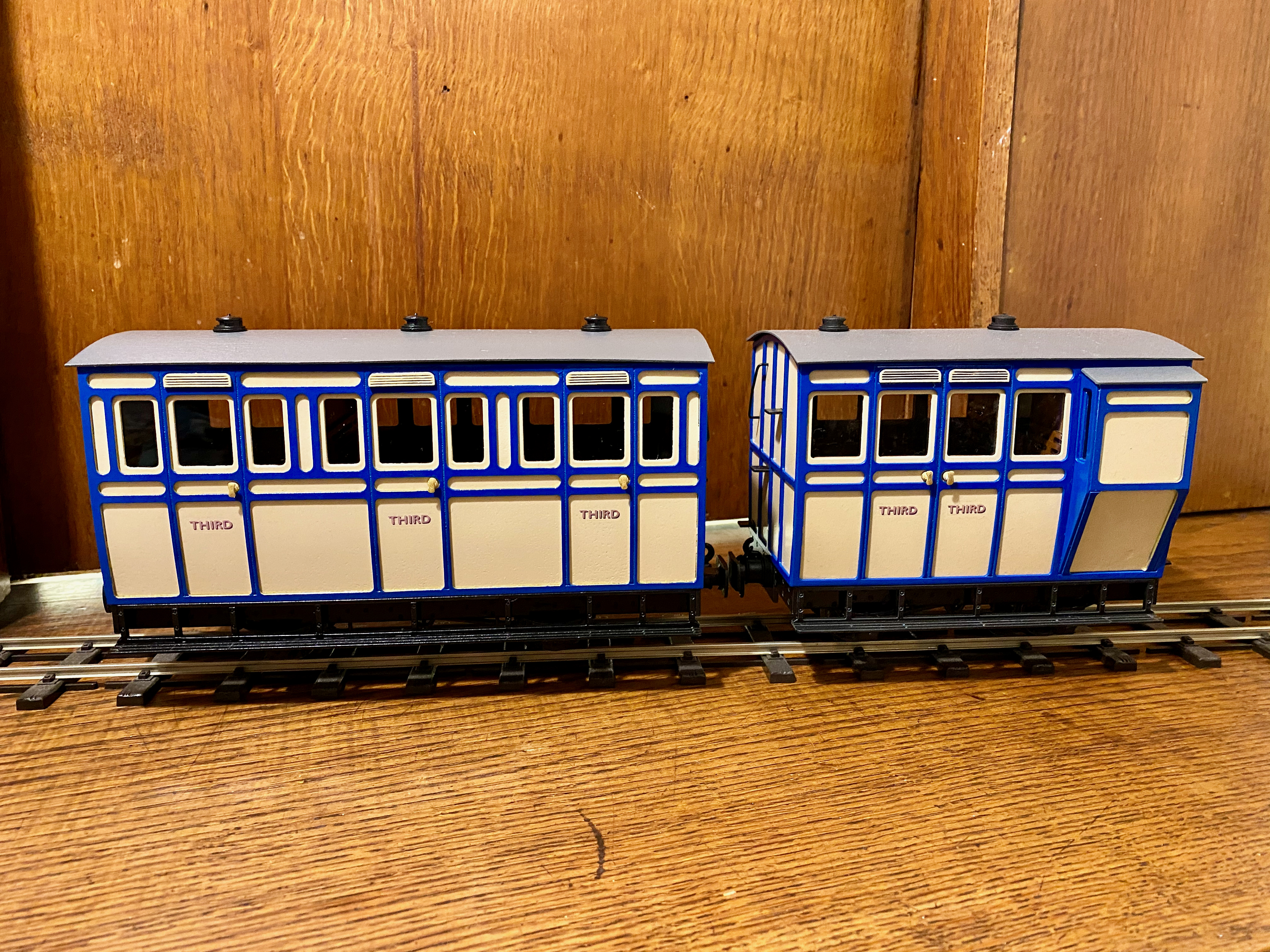

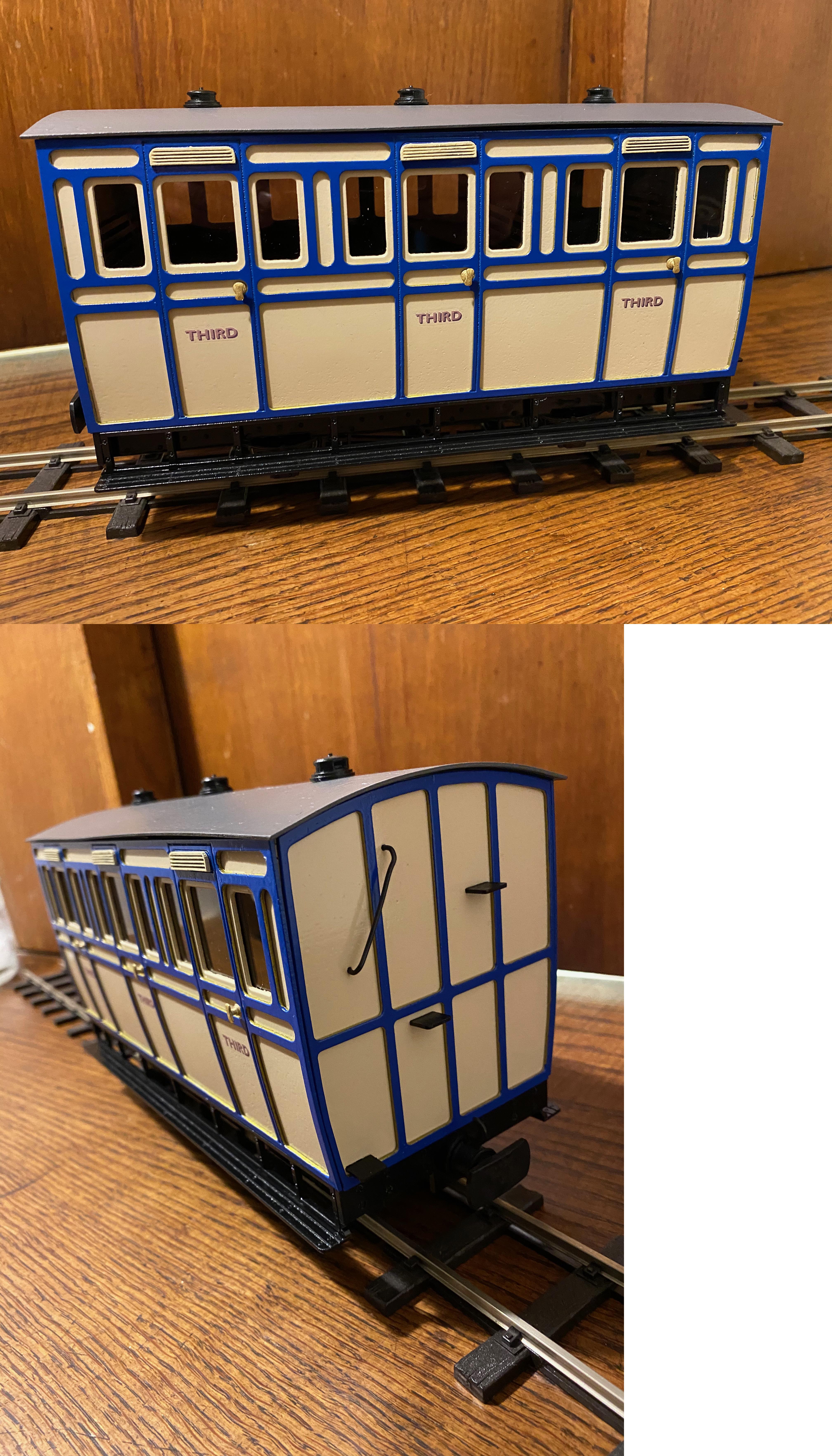

Skipping to the end, here is the completed carriage (bar interior finishing). I decided to try gold lining the inside edges of the overlay which I think adds a little extra to the look. Thanks for the tips earlier in this thread!
Here is the two carriages I've completed so far.
They look pretty good together in my opinion!
