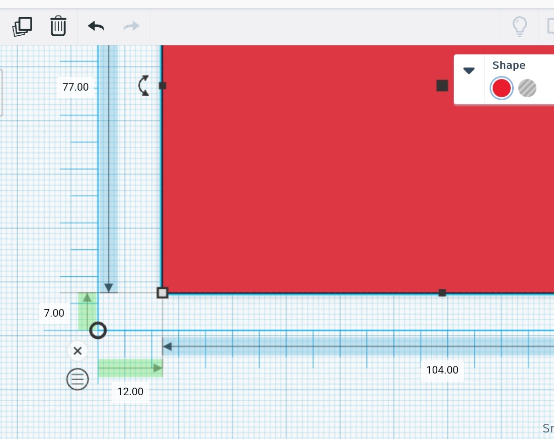

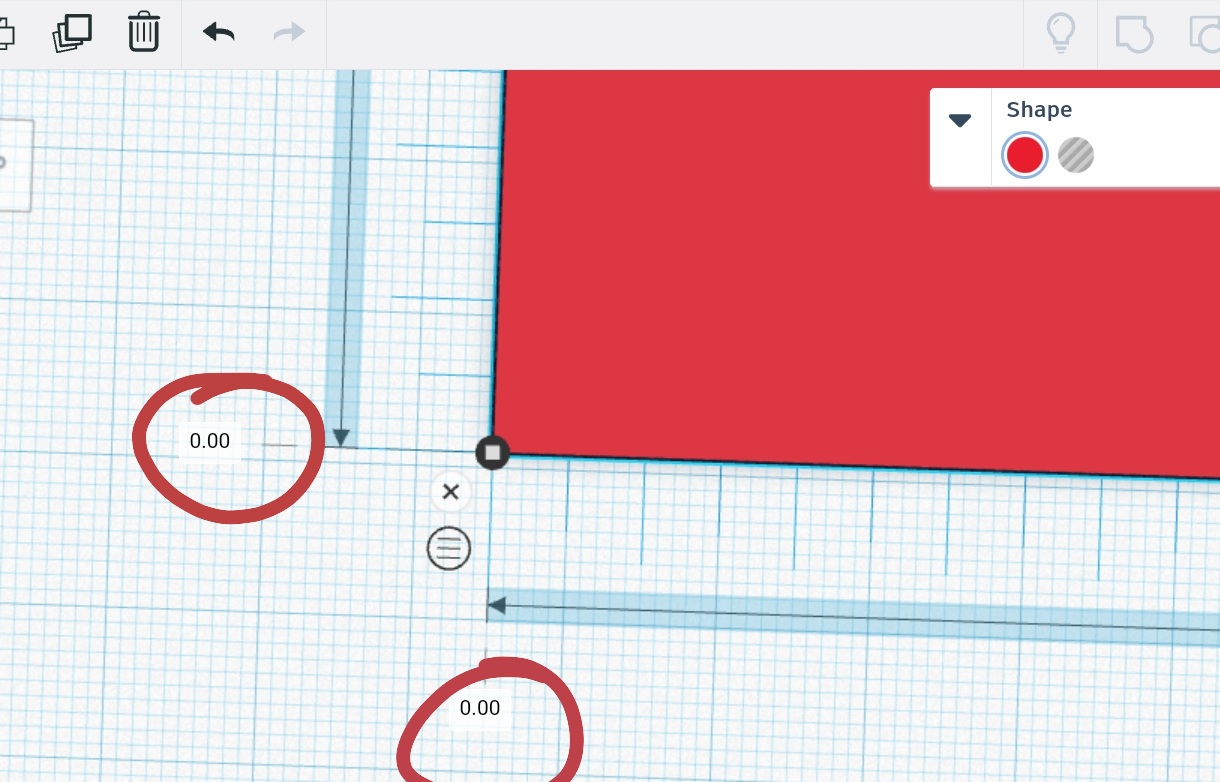

How to align a ruler with the edge or corner of a shape
1. Position the ruler roughly near the shape
2. Click on the shape to select it. It will then show two dimensions indicating how far away the shape is from the ruler
3. Click on each of the dimension boxes and change the dimension to zero
The ruler will then be positioned exactly over the corner of the shape

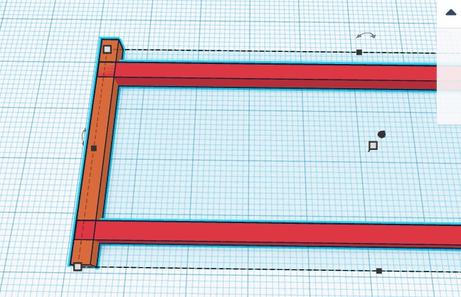

I found your blog before you started this thread. I have tried to make a gate, but I am having a lot of problems with the two horizontal bars at the top and bottom of the gate. For the life of me I just can't get them to go onto the rest of the build. Any help would be very much appreciated.

Have you found the group button? It is what makes lots of small things into one larger item or items? You can always ungroup if you need to, but be careful as it may not go back together again in the same order and therefore change what is there in an unexpected way. Ask me how I know!
Also I think you need to upload the stl file under the shared area as it doesn't work in here, by design.

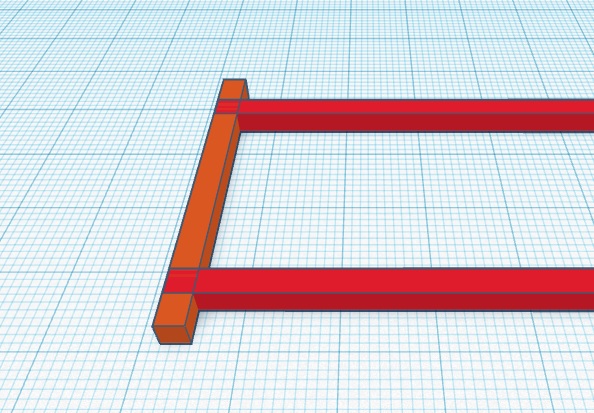

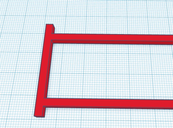

As Steve has said. To join shapes use the 'Group' button. They can be ungrouped later if you need to make a change.
Firstly, make sure the shapes you want to join are touching or overlapping
Then select all the items you want to join together - either by dragging the red dotty box over them or by clicking on the first shape, then holding down shift and clicking on the next shape(s) - ie shift-clicking
Then click on the "Group" button. Notice that the Shape Properties pop-up is showing three shapes have been selected.
After a few seconds the shapes will become joined together. You can see that there are now no longer any lines where the shapes overlapped and the object has become a single uniform colour
I hope that answers your question.

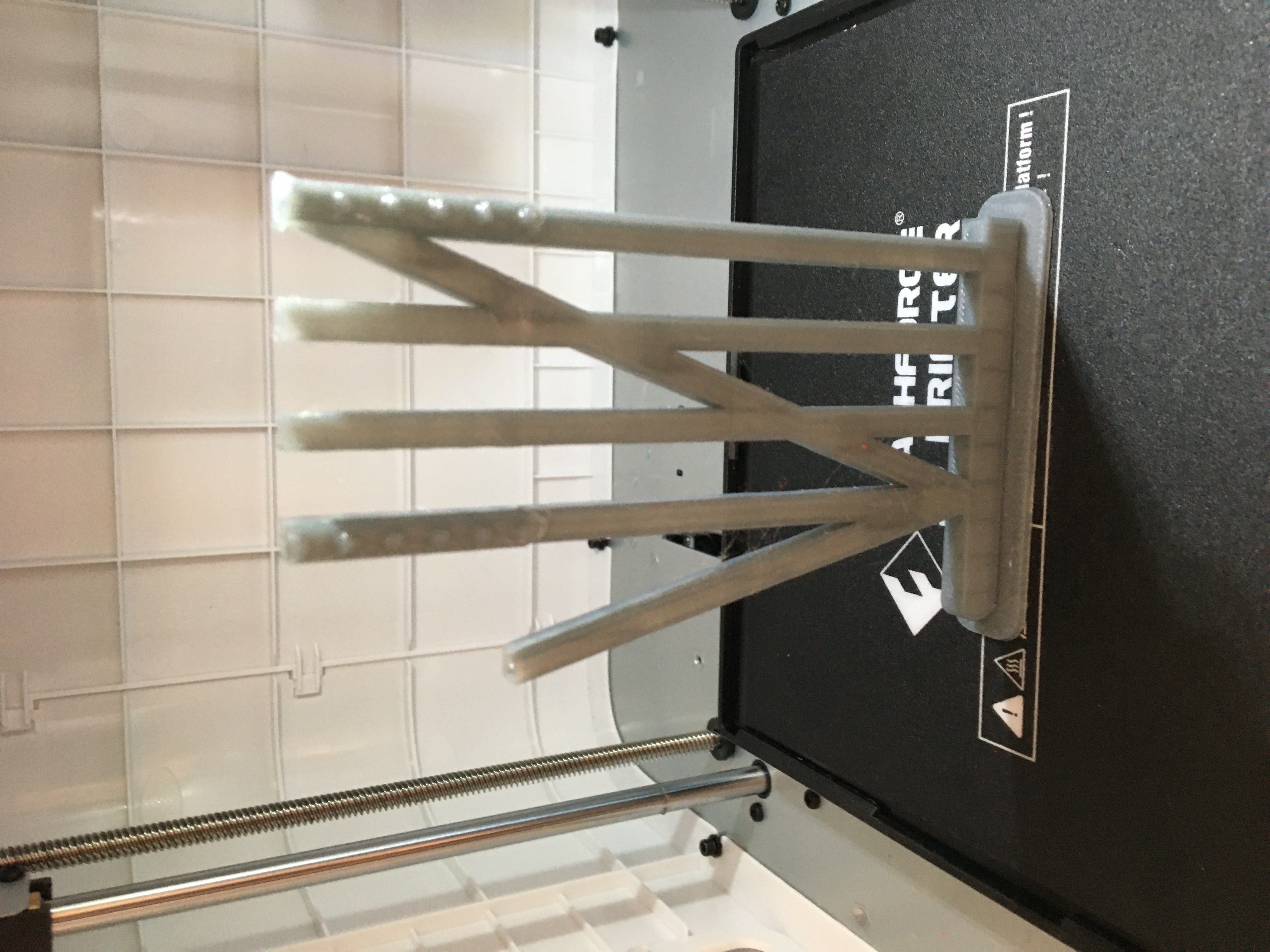

I have done an hinge for my gate, but it has turned out not that brilliant. The first attempt saw the top diagonal plank snap off. That was due to the fact that I didn't use any supports and the nozzle head hit it. Shows though that the The next one I did with supports and it did print it pretty well. Now though I have found that the hole for the gudgeon pin is pretty thin and flimsy.
How do I make the walls thicker..
I also thought it would be better if I printed it on one end

It came out so much better with supports.
It was much better now. Shows that sometimes you do need to have supports. Though I think I would print it as is seen fitted to a gate post, it would be a lot better I think.
