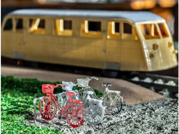

Anyway this is a photo of it.
And this is the file,
https://www.thingiverse.com/thing:3886096

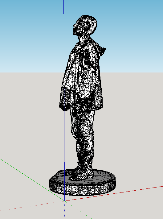

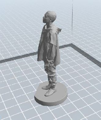

These two pictures show the mesh effect: The first one is screenshot of the stl of a small figure (67mm high) in Flashprint. I then imported that stl into Sketchup, which took about an hour, and the second picture is a screenshot of the same figure in SU and shows the mesh. The blackish areas are where the triangles are so small and close together that the screen can't separate the lines.
Screenshot 2021-01-06 15.48.30.jpg (22.16 KiB) Viewed 5600 times
Screenshot 2021-01-06 16.10.31.png (32.91 KiB) Viewed 5600 times
