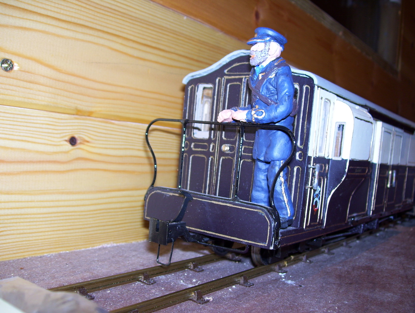

So what am I trying to achieve? If you look at photos from the Victorian period, you will see that everyone wore a hat, and all dresses were long. I want to replicate that in my models. Passengers on station platforms, engine drivers, seated passengers in coaches, etc.
I have done this in the past using modelling clay - the sort you bake in the oven. A couple of examples to highlight the issues: Festiniog Railway guard uniform from the Victorian period - well as close as I can make it by hand. Frock coat, beard, and money satchel.
Festiniog quarryman's coach with quarrymen: Bowler hats in evidence - and not all the same shape, lots of beards, and the way the jacket is buttoned at the top, and the rest hanging open. White linen suits. All to be seen in historic photos.

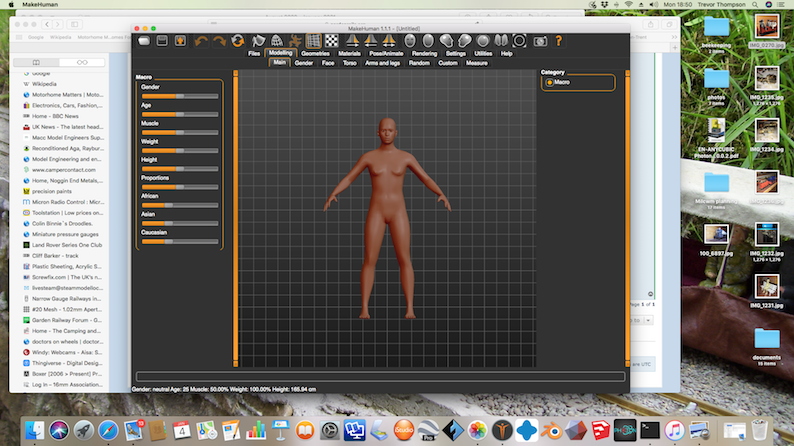

So "Makehuman"
Use a google search and you will find a forum and download area. You will have to register and log in. Initially it is a matter of just downloading the programme and following a set of instructions to instal it.
A word of warning for iMac users. The latest version does not support iMac, so you have to download a previous version which does work on a iMac. Download it ,and in a Mac, move it into the applications folder. You are likely to have to override the default setting which only allows installation of approved applications.

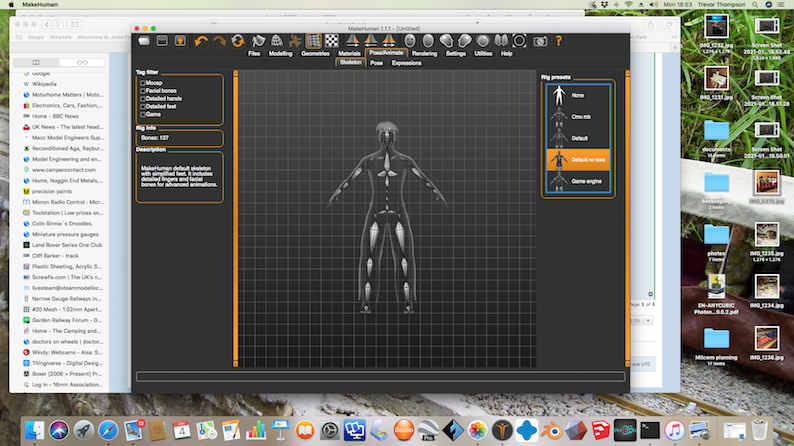

So what does it do? It allows you to create "anatomically accurate" people. Any age, any gender, muscular or weedy. everything that varies in real people seems to be adjustable: This is what the programme looks like. All the adjustments are on the top two rows. You just need to experiment to see what changes. Under geometries there is a set of adjustments on the lower row which allow you to add hair, clothes and the like. There are some basic clothes in the basic programme and others can be downloaded from the makehuman forum. They are called "Assets".
The other important feature is under "animate" and it is "skeleton": It does not seem to matter much which you use but the figure needs a skeleton if we are going to be able to move its arms and legs later in another programme.
Downloading clothes. There is a tutorial on the makehuman forum about installing clothes from the "Assets". Basically there are 4 files which need to be placed in a folder of the same name within a Makehuman folder which will have been created in your "Documents" folder. If you use an iMac beware the operating system will change the file extensions on the four files and you will have to change them back. The clothes which can be downloaded don't exactly fulfil the requirements of model railways but there is a Yugoslavian train driver uniform there! It is possible to make clothes - I have not got that far yet but I am going to have to try eventually.
Next post on using "Blender" to change the figures position, move arms legs and make them sit down.

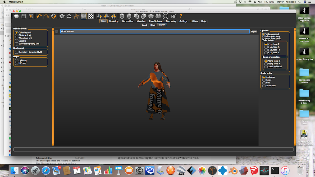

Before I describe how to move the arms and legs of figures in "Blender" it is worth explaining how to get a model from "Makehuman" to "Blender".
Rememer that I said that when you instal Makehuman it creates a "makehuman" folder in your documents folder? Inside that folder is another folder and another until you eventually find a folder called "data" and then one for clothes, exports and so on. When you save a figure in Makehuman it puts the file in one of these folders. The way I have been transferring figures is to export the file. Under the main heading "files", there are three subheadings, save load and export. Export gives options and the best one to use seems to be "collada". This ensures that the skeleton is part of the exported file. This skeleton is important as it is the base for moving the figures arms and legs:
This file has the extension ".dae" and will be found in the folder "exports"( we need to find it to import it into Blender).

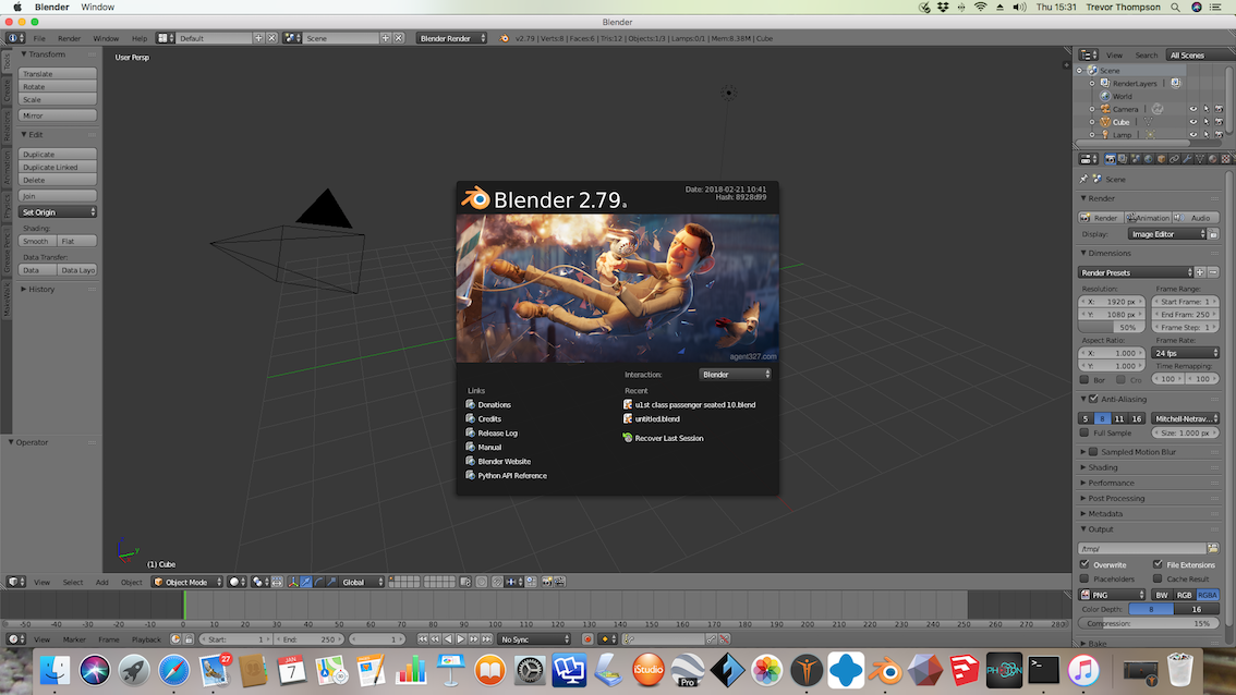

Installing Blender. Search for Blender using your favourite search engine as normal. You will find the download for your operating system, and instructions for installing it. So far so good.
I mentioned earlier that iMac users have to use an earlier version of Makehuman. When you export and import files as described it doesn't matter that iMac users have the latest version of Blender. However if you ever get to "make clothes" you will need to get the earlier version of Blender to go with the earlier version of Makehuman. The "Make clothes" function for "Makehuman" is an extension added into "blender" - and for that to work the versions need to be compatible.
So Blender.

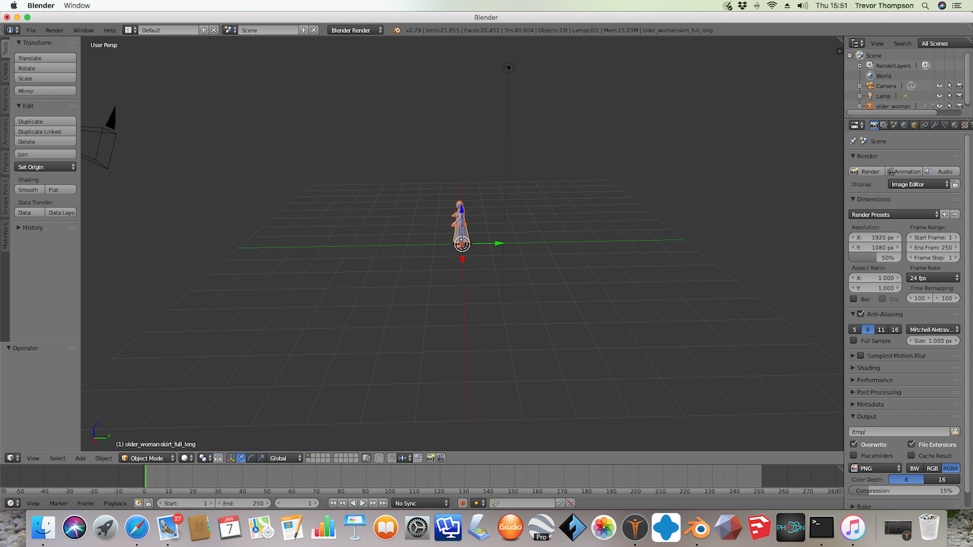

When you open Blender on an iMac it looks lay this. Note that this is the earlier version of blender because I work on an iMac, and the later version is of course slightly different.
So Blender.

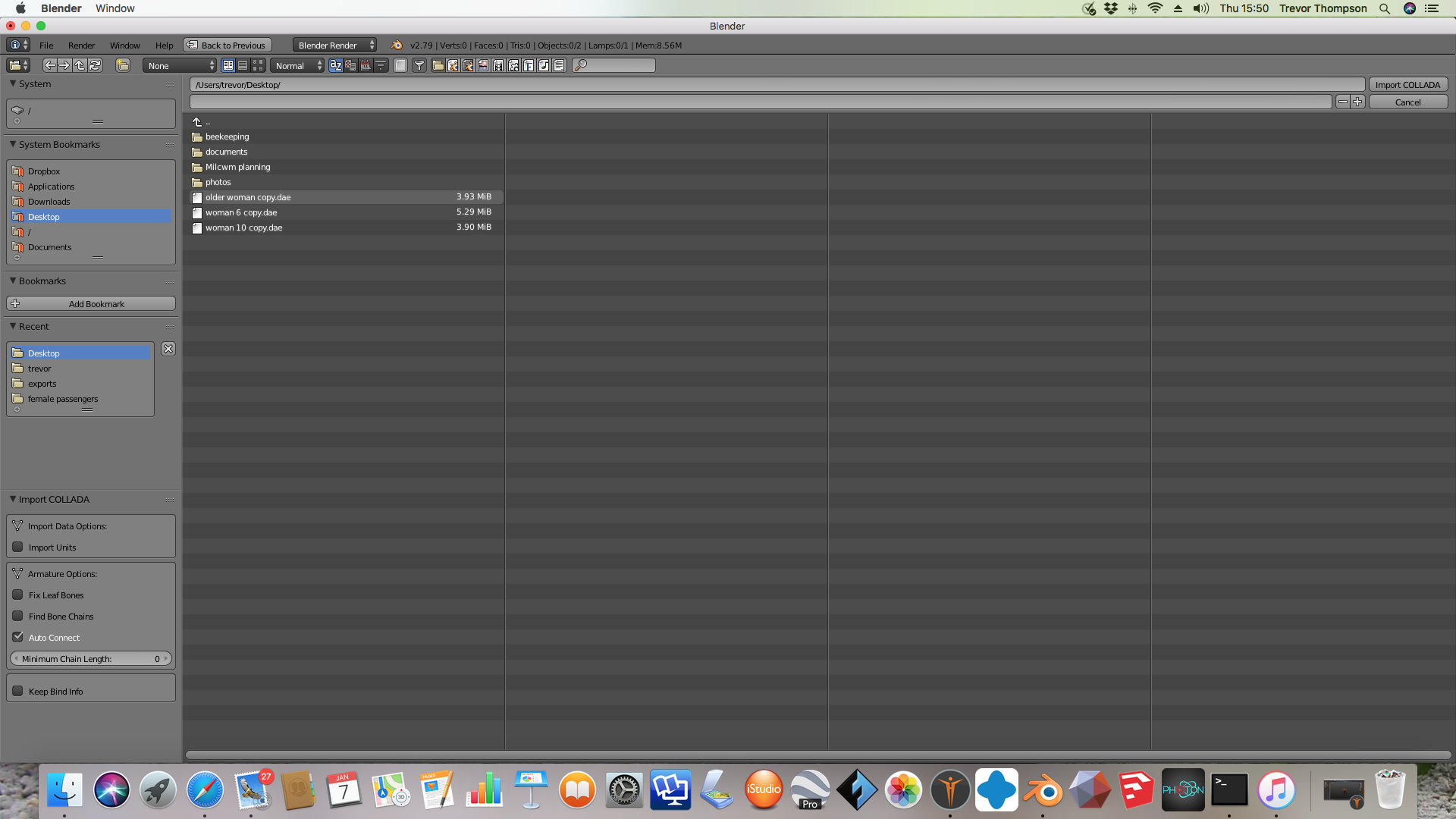

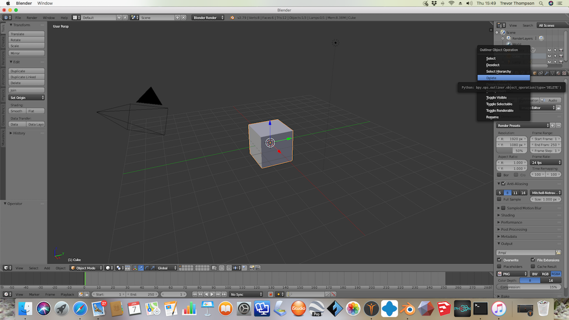

From the last screen right clicking gets rid of that message. Now you are presented with a box sitting at the origin:
we need to get rid of the box. So up on the top right hand side is a menu showing a list. In the list is the word "CUBE". Make sure it is highlighted in white - or if it isn't click on it to make it highlighted. When you right click over the word cube you should get a pop up menu and half way down is the delete. So having deleted the cube:

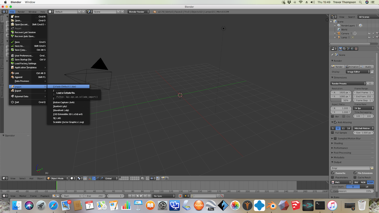

Now to import the file from makehuman. On the top left is the word "file". Click on it and "import"and "collada":
Now choose the file. Ensure that one of the boxes at the bottom left is ticked. Under "armature options" - I ensure "auto connect" is ticked. Others may work as well its just what I have done which has worked!
The end result of this should be the figure I created in the centre of the screen:

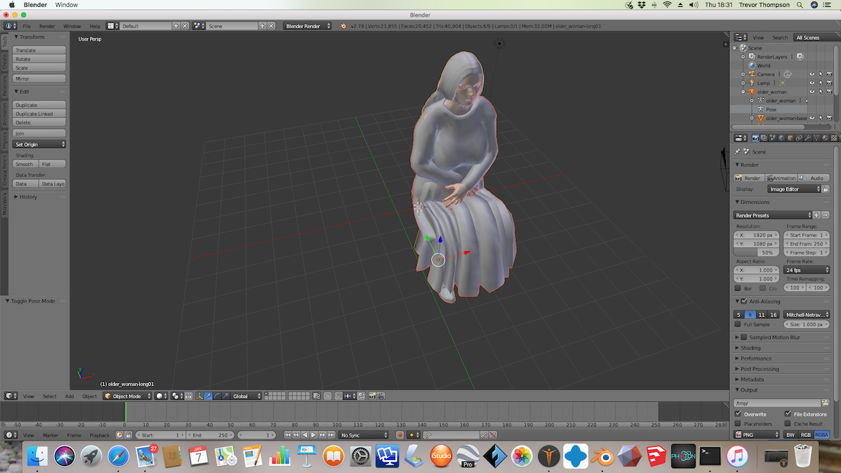

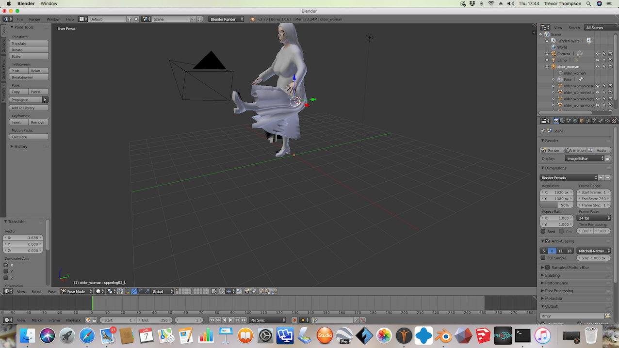

Now to manipulate that figure in Blender.
On the left of the screen you will see a number of file inserts - headings if you like running up and down the extremes left side. The top one is clicked in the next view and you can see the word scale which I have highlighted. Click in it ti engage scaling, and move the mouse to the left and the image will increase in size. ignore the arrow going all over the place just keep rolling it left until you can see the figure properly.:
the result:
Now look on the top right of the screen There is a list which includes words like camera, and older woman. That is the file name by the way.click on the "+" sign to the left of the file name, and it will reveal the elements within the file. The work "pose" is what we want and you will see the symbol for a bone next to it. clock on pose to highlight it and then click on the bone next to it.
As an aside changing the view - rotating the figure - is important next. and it is achieved by using the mouse. Moving mouse scroll wheels seems to rotate the figure - well it does for me. You might have to experiment.
So you should now see a circle and a red green and blue arrow showing three dimension directions centred on the circle. Move the mouse arrow to rest over a joint - say the hip joint. Right click and hold on the red arrowhead and move the mouse - the result should be one leg moving to a sitting position:
Now right click on the knee joint and use the red arrow again:

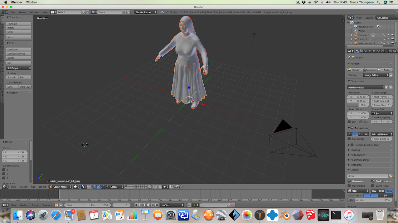

Now its just a matter of moving the figure to see it from different sides and moving the different joints, for arms and legs. You can move the neck as well if you want the figure to be looking out of a coach window. Individual fingers can also be moved. You just need to experiment!
When you are satisfied use the file menu (top left) to get to export and then export the figure as an ".stl" file for the next steps. Better to modify the file name as well.
Note that my slicing software for the filament printer can repair the file from this stage and make passable print from it. However at this stage it has lots of errors and holes in its mesh which will prevent it printing properly on a resin printer.
Next step will be to use "Meshmixer" to repair the figure.
the result:

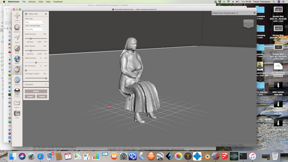

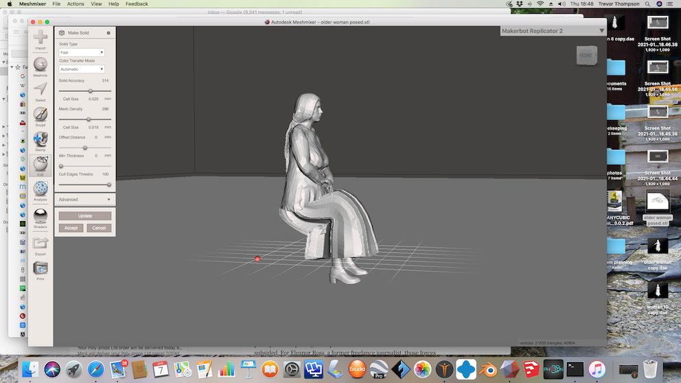

Meshmixer is another programme you will find by searching, and downloading it. Again its free.
So having opened it this is the screen"
import, and open the file you saved from blender:
Here is the figure I sat down. She is to be a passenger in a coach.
There are as far as I can work out two key tools for fixing figures here. Firstly under the heading on the left hand side "analysis" an option at the top of the menu which opens when you click "analysis" is "inspector". This generates a list of all the errors in the mesh. Magenta ones it can fix automatically. You can vary the size of the mesh with the slider. experiment. Fix automatically or click each individual magenta ball.
That is some errors fixed.
Now under edit there is an option "make solid"
This is the default repair which is carried out when you click on make solid. It can be rather crude as default, but it is adjustable. Move the different sliders. The top two moved to make the repairs smaller have a better effect - but the smaller you go the more processing time until eventually it sits there with a message "checking for errors" Effectively a crash! So experiment.
So here is a reasonable result:
When we started these repairs the file had a thin skirt, and if you looked up it the legs were represented only by the bones - and the boots were just hanging there. If I tried to print it the legs fell off. What I can't show you here is that the bottom of the skirt is now solid with boots sticking out. The model really is a solid object with a complete mesh surrounding it. It will print.
I can't give you definitive directions for getting the best out of these repairs - you will just have to try it. You may be able to tell me how to do it properly!

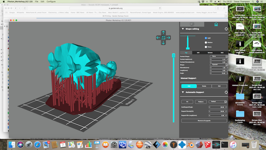

So to the slicing software:
Now I can show you underneath the figure and you can see that the underneath is indeed solid. Auto supports plus a load more added manually. Having sliced it I have also previewed the sliced file which shows each layer as I scroll up and down the print. It looks as though this will print OK.

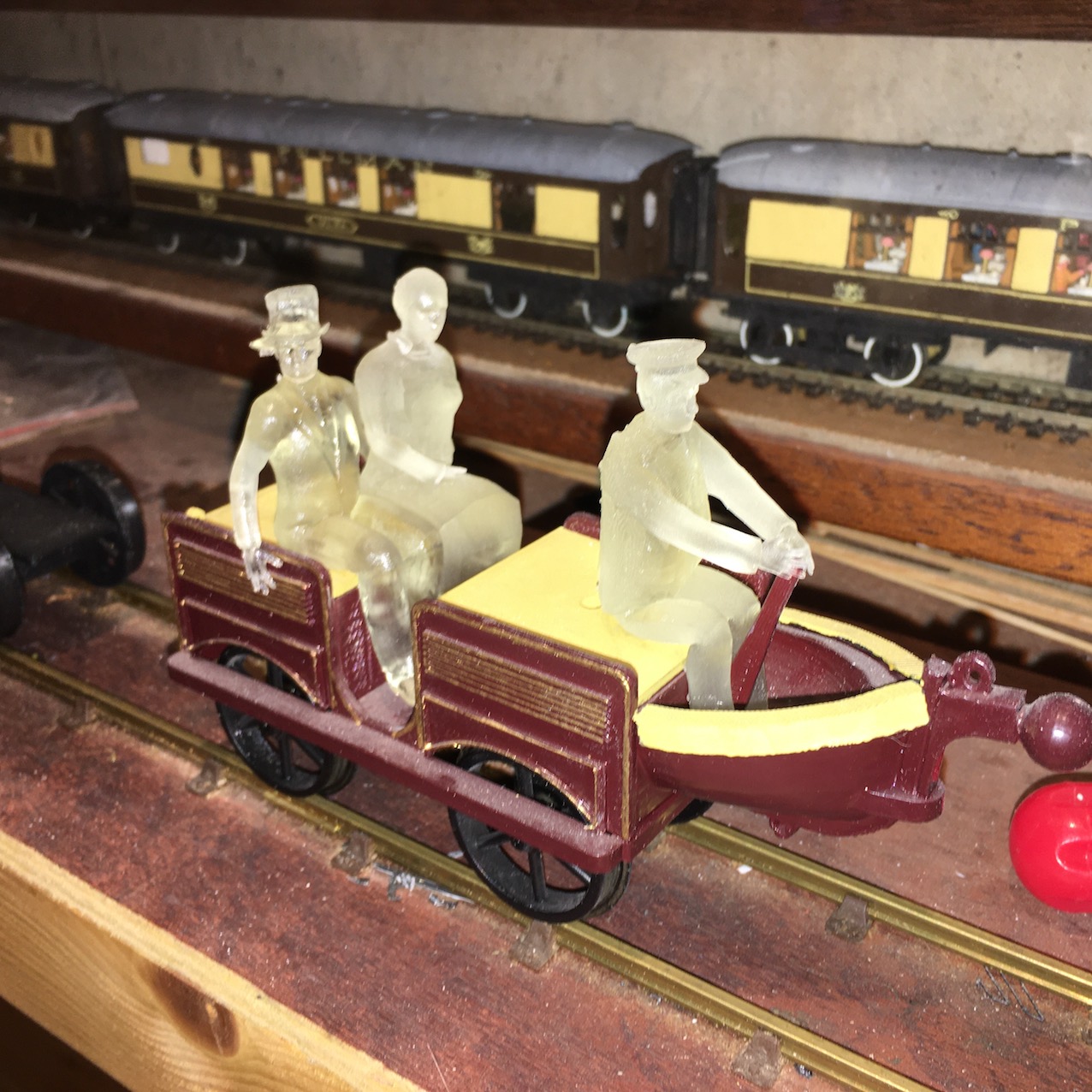

Spooners boat.
There is an illustration used in books to show what this was like which show a couple on the main thwart and a driver in the front holding the brake lever. I have tried to represent this with the figures I have made:
They actually fit into the boat correctly. They do need the final clean up of the supports, and painting.
So success.

Here is the end result:
I thing that will pass muster!
One final detail will be to make a second set of seats. The people are glued onto the seats in the photo. However the seats are just a firm press fit, so a second set can be substituted.
Why?
Well I am sure that on its way up the line any passengers would have been in a first class carriage. Only on the way back down under gravity would they have been sitting in the boat! Well with a second set of seats I can simulate that on the line now.
Why?
