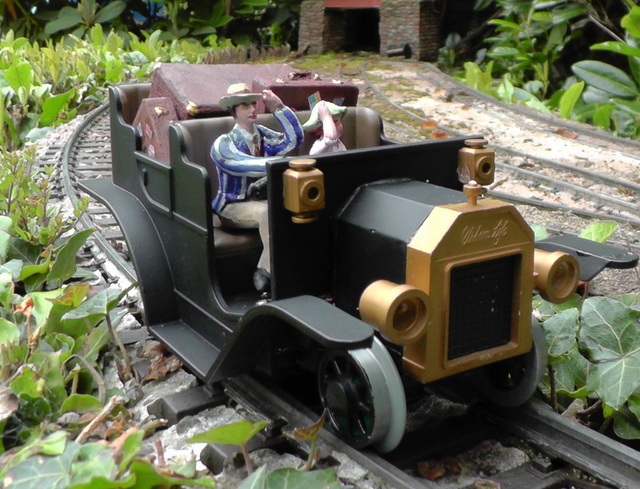

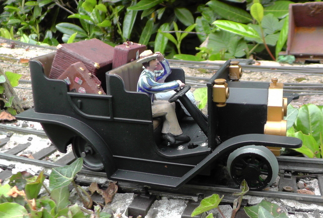

Another project which has been sitting on the shelf for a while has now emerged from the workshop - a car railcar
Not sure where the donor body came from for the car. But it seems to look OK
The passengers are those cheap figures which come from China - butchered a bit. Slightly under scale (1:25) but they don't look too out of place!
The luggage hides the motor. One of those cheap worm gearbox motors with the 3v motor replaced with a 6v version.
A couple of li-ion AA sized batteries and a Deltang Rx60 receiver/controller and Bob's your uncle.
The premise is that the Hon Frances Tollemache (daughter of Lord Tollemache of Peckforton Castle) is reuturning from her hols with her latest beau.
Hope you like it

I love it Rik... is it usually the case that steering wheels remained after conversion to rail use?
Posts: 8037
Re: Car railcar
Post by ge_rik » Tue Jul 21, 2020 10:40 pm
Peter Butler wrote: Tue Jul 21, 2020 9:58 pm .... is it usually the case that steering wheels remained after conversion to rail use?
Not sure, but I decided that the steering wheel would have a hand throttle at its centre and so they kept the wheel as something to hold on to, rather than just having the column with a lever on it.
It is actually a brake wheel from Cambrian Models, so it might even have a secondary function.

Nice one Rik, I like it that you altered their arms to hold on to their hats! Many of our road to rail conversions kept the steering wheel.

Post by ge_rik » Wed Jul 22, 2020 8:33 am
LNR wrote: Tue Jul 21, 2020 10:49 pm ......, I like it that you altered their arms to hold on to their hats!
Thanks Grant
I felt this would probably be the most natural pose. The hands were the most difficult to model in milliput. The chap's hand holding the wheel is more like a flipper. Maybe he's a keen swimmer🀭
LNR wrote: Tue Jul 21, 2020 10:49 pm Many of our road to rail conversions kept the steering wheel.
When I bought it off eBay, it had originally been converted to have a front bogie and sit very high off the rails. I thought it looked unprototypical and so lowered it to do away with the bogie. I should have done more research. Reassuring that they retained the steering wheel though.....
Less clear whether the wheel is still intact, but the driver looks as if he's leaning on something.

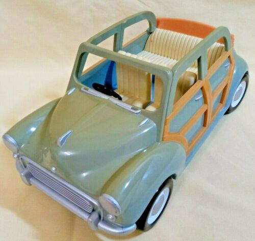

BTW I've discovered that the donor vehicle is from the Sylvanian Families range. It's called the Vintage Wedding Car.
I've also noticed they do a very interesting version of the Morris Minor, which could easily be adapted to look like the real thing, sitting in a station car park. Not my era but I'm sure it could be of interest to some of you.
