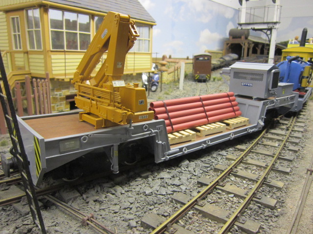

I have been following this build from the start but had nothing to contribute before, however, I am impressed on two counts, one being the way you have planned out the build and the materials used to achieve it and the other being the railway equipment used to supply sections to site.....
https://gardenrails.org/download/file.php?id=10778
which has a remarkable similarity to mine..... ...both probably incorporating the same Italeri HIAB kit?

Yup! Yours has more interesting detail. Very nice build. But I’m intrigued by the the difference in appearance of the HIAB itself. They must be the same but yours looks a tad chunkier. Shows the effect of a different paint job. I notice you, like me, didn’t feel the need to add extra air hoses on the jib joints. I felt they were too vulnerable.Peter Butler wrote: Thu Jul 09, 2020 10:16 am ...both probably incorporating the same Italeri HIAB kit?
Also have you written about those very nice point rodding stools you have there in the 6 foot?
Andy

Andy, I don't wish to stray off thread but the rodding is hand built and not commercially available.
More viaduct please... it's great!
