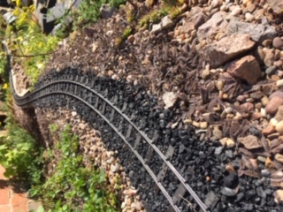

I've been contemplating the subject for some time for my Charnwood Forest Light Railway. Being fictionally (and physically!) set in the Charnwood area of Leicestershire, with one end at the granite quarries at Shepshed, I was thinking of a scale granite ballast, but it needed to be pink to match the local stone. I found some in the same place as steamyjim but cost and volume brought me up a bit sharp and the project paused. I've revisited it a couple of times but it was only about a month ago when I realised that there was no way a piddley-poddley little narrow gauge railway, built on a shoestring even thinner than you're average country branch line, would ever be able to afford granite ballast - not even if it was on the door step. My line would have had to cut through some granite in construction but you can bet the company chairman's salary on the fact that it would have been used in bridge construction or sold to earn some dosh! Even the incredibly high engineering standards of the Great Central Railway (which would have had a hand in the Charnwood Forest Light) didn't run to granite top stone. They effectively cobbled the formation with rough granite boulders, but these were blinded with ash and the track laid on top with ash ballast - of course! Ash ballast! Virtually every railway company was using it by the last quarter of the 19th century and continued to do so for the first half of the 20th. It was available in vast quantities from industry as a waste product so it was cheap. It drained freely (when clean and new) and it gave excellent support to the sleepers. It also formed a solid mass so it held them in place laterally too.
Here was the solution to my problem. I have a coal fired Rayburn at home and I work on heritage railways so I'm fortunate to have a free and easy supply of the stuff but I'm sure anyone turning up at their local heritage line and asking for a carrier bag full would be able to obtain a supply (and possibly some sad and pitying looks!). You may well need to crush it down but it's an easy (if messy) job. I gave it a trial run last week, fixing it with the tried and tested Peter Butler ABR technique as described on this 'Time to build a railway...' topic.
It's early days yet to comment on durability but so far I'm quite pleased with the results.

Andrew, your ash ballast looks pretty good.
Yes the delivery cost from Resin Bonded Aggregates is extreme. I managed to get 2 x20kg bags for a tenner some years ago when in their area of Derbyshire for work. Just called in, paid cash and loaded it in my car.

The ash ballast looks smart indeed! Perhaps a darker ballast may be a good idea seeing as being indoors my line will not naturally weather...
I've normally got a ready supply of the stuff but she hasn't seen a fire this year yet!

Love that ash ballast Andrew.

Thanks for the compliments Rd and Philip.
Steamyjim,
You not only have the means of producing your own ash but the 'production unit' will also reduce it to scale size!
Steamyjim,
