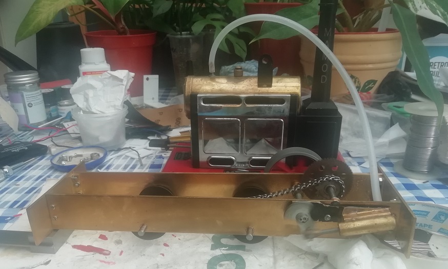

After removing the steam unit from the Mamod, and attaching it to the chassis, I hooked it up temporarily to the boiler using silicon tube... and it works! I am almost unreasonably happy about this.
It did throw up a couple of issues though. The chain seems quite loose when running, I'll try removing a link or two. Also, the engine only runs in one direction - this I was expecting, but for some reason I thought it would run the other way! This means the engine and flywheel are at the back of the chassis, not the front as expected. Could this be changed around by swapping the steam and exhaust pipes around? (nb. I really don't know much about this stuff).
Next steps will be to fit the boiler and firebox, and deciding whether to use the Mamod solid-fuel burner, or construct a meths one. The latter would probably perform better but would involve learning to silver-solder, so I haven't made my mind up yet. The bodywork also needs some thought; if anyone can advise what the best material to use for this is, and the best way of cutting sheet material (tin snips? hacksaw? jigsaw?) I'd be really grateful for the advice.

Good to see it working - well done!Tom85 wrote: Tue Jul 07, 2020 3:12 pm After removing the steam unit from the Mamod, and attaching it to the chassis, I hooked it up temporarily to the boiler using silicon tube... and it works! I am almost unreasonably happy about this.
Swapping the inlet and exhaust will reverse the engine.
What about tracking down a Mamod meths burner, or one of the aftermarket replacements. Personally, I'd learn to silver solder - it's not the 'black art' that people say it is, and it's very handy!
I'd suggest you hunt down a copy of Building Small Steam Locomotives by Peter Jones, he talks through various methods for bodywork and then describes a step by step example.

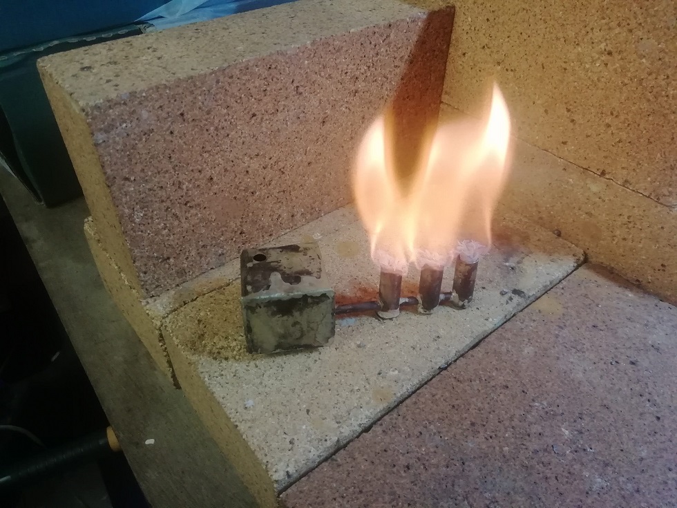

Just silver soldered myself a burner!
- Posts: 1192
Re: Mamod SP2 stationary engine loco conversion
Well done. Certainly better than the burners I've tried to solder up..
Once you get those wicks fine-tuned, that should make an excellent steam producer. If you've not already, it might be worth adding a filler pipe running out and away from the hole in the reservoir. As the burner heats up over a run, the meths will expand and vapourise further. An open hole in the reservoir so close to the lit wicks could result in a fireball!
