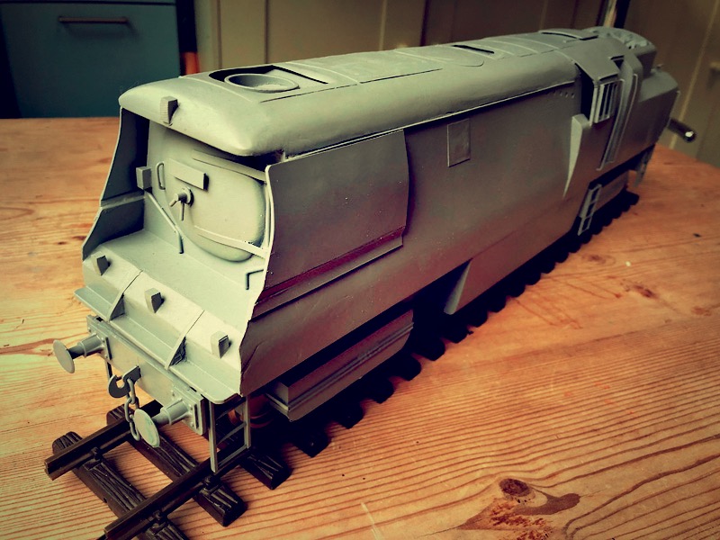

Post by BertieB » Fri Jun 05, 2020 1:38 pm
A couple of months hardly leaving home got it built reasonably quickly

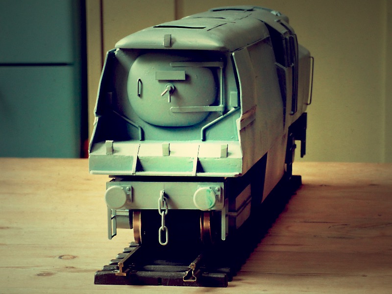

Always seems a big deal getting to see it in primer (though I’ve done a bit of filtering to make it look a bit more chirpy)
As usual, there are annoying mistakes and sloppy bits. I’m not going to list them
I’ve cheated a bit here and there and ‘improved’ Bulleid’s 3D design
This time the figure is possibly a bit small (a 1/24 bloke on a previous model seemed a bit big)
I don’t think it’s too difficult to imagine one of these trundling between seaside towns along the south coast

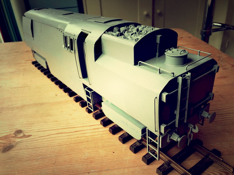

Hello again from almost three months of lockdown – and the fantasy Southern Region that seems to be 3’11” gauge – this time with a go at Bulleid’s challenging, 1946 ‘well wagon’, 0-4-4-0 proposal (two power bogies with the firebox sitting in the ‘well’ between them), one of the many ‘total adhesion’ concepts he investigated.
Published drawings show rods and inside cylinders (6!) but I’ve done it with the external chain cover thingies* (which helpfully give the bogies a bit more width) as seen on the (slightly later) Leader. Water tanks are hidden by the ‘air-smoothed’ cladding (and under the boiler), or at least seem to be... a neat solution, at least for me. Weight distribution was considered to be an issue apparently and subsequent proposals grew more axles – and eventually a cab at each end.
Aside from the awesome aesthetics and wonderful weirdness, of course, an attraction for me is that there’s no long, coupled wheelbase (difficult to source, let alone make) to struggle with (my) tight garden railway curves or, conversely, no need to use an under-scale motorblock that would dictate a shortened model.
It’s largely plasticard, on customised motor blocks from G-bits, battery-powered with Deltang R/C and not too much in the way of detail (or accuracy). Looks the part though, I hope...
It’s 22in (560mm) long, 5lb 11oz (2.6kg) and, when you add everything up (quietly), the best part of 300 quid...
I’m arguing with myself about how to paint it. Don’t know yet. Wondering whether to do each side differently; after all you can’t see both at the same time…

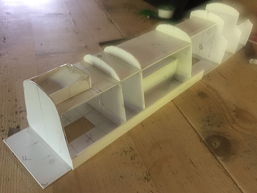

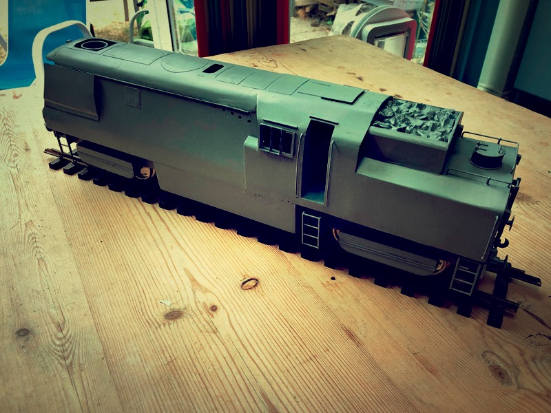

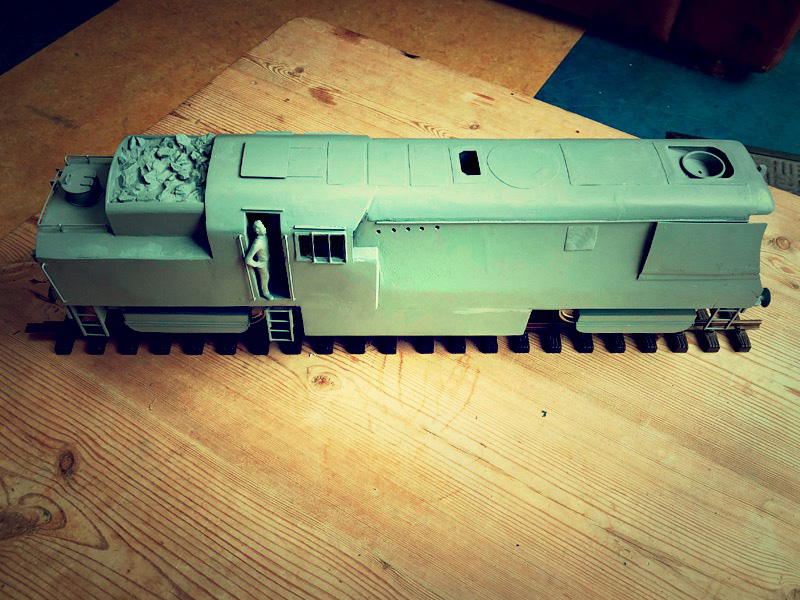

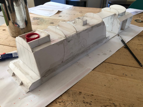

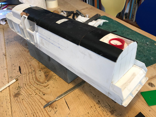

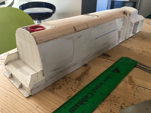

Here’s a sequence of scruffy, early build pictures, as threatened.
Self explanatory, I think: pretty basic stuff really, which I suspect many of you achieve with rather more polish and precision. I rely on industrial quantities of filler and enthusiastic sanding.
However, I did adapt / draw up a more usefully accurate plan this time and made templates for the formers, sheeted roof sections and various other awkward bits, which I’m usually too lazy or impatient to do – and which certainly helped.
The cowl above the smokebox door is simply layers of foamboard cut and sanded to shape. I abandoned any idea of moulding it in celluloid (like a cockpit canopy) as being too much like hard work.

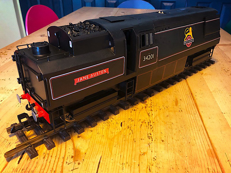

invicta280 wrote: Fri Jun 12, 2020 2:34 pm "...I'd suggest one or the other. Green or Black. Malachite? BR green?"

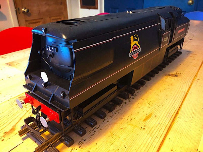

I’ve stared dozily at the thing in primer for weeks – and then gone for another interpretation of ‘large logo’, BR mixed traffic, lined black (as usual), which makes sense, sort of. It’s not an express passenger engine, after all.
Tank engines don’t generally get named but clearly the chaps at Waterloo decided this class were special enough, so it’s from the ‘Distinguished Literary Figures associated with the Southern Railway Area' class (they’ll have come up with a snappier title than that). Predictably, as you can see, this one’s ‘Jane Austen’.
Lining and graphics done in Photoshop, assembled into an A4 ‘page’, exported to PDF and inkjet printed on to white decal paper. Had to be careful (and quick) not to cause ‘stretch marks’, when applying the particularly long decals (the ink and varnish surface can split revealing the white layer underneath, if you fiddle with them for too long). Fortunately I’d printed off duplicates. A lot of white edges to touch up afterwards, unavoidably.
R/C still to be fitted, should be here soon, one hopes.
If some of Bulleid’s bonkers reinventions of the (British) steam locomotive had been properly developed and in service, who knows... Perhaps British Railways might have removed the ‘air-smoothed’ cladding in the mid 50s, or built BR Standard 0-4-4-0s and 0-6-6-0s?

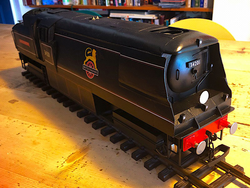

I’m assuming the panels between the bogies incorporate lift-up flaps, allowing access to the ashpan and other gubbins hiding down there
Wilco rattlecan black; inkjet printed, Photoshopped decals; matt varnish
Difficult to photograph without it looking like a murky black blob; hence the added 'brightness'
Love the curved sides on Bulleids. The Brighton-designed Standard 2-6-4T has them too, which I imagine isn’t a coincidence
