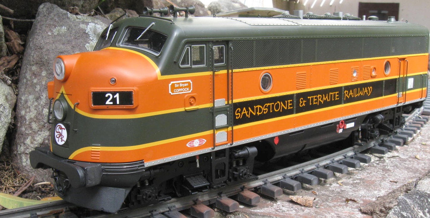

Externally there is virtually no change. I added the lettering along the sides by printing onto glossy photo paper and gluing on. I named it for my late mate (and Knighted him!)

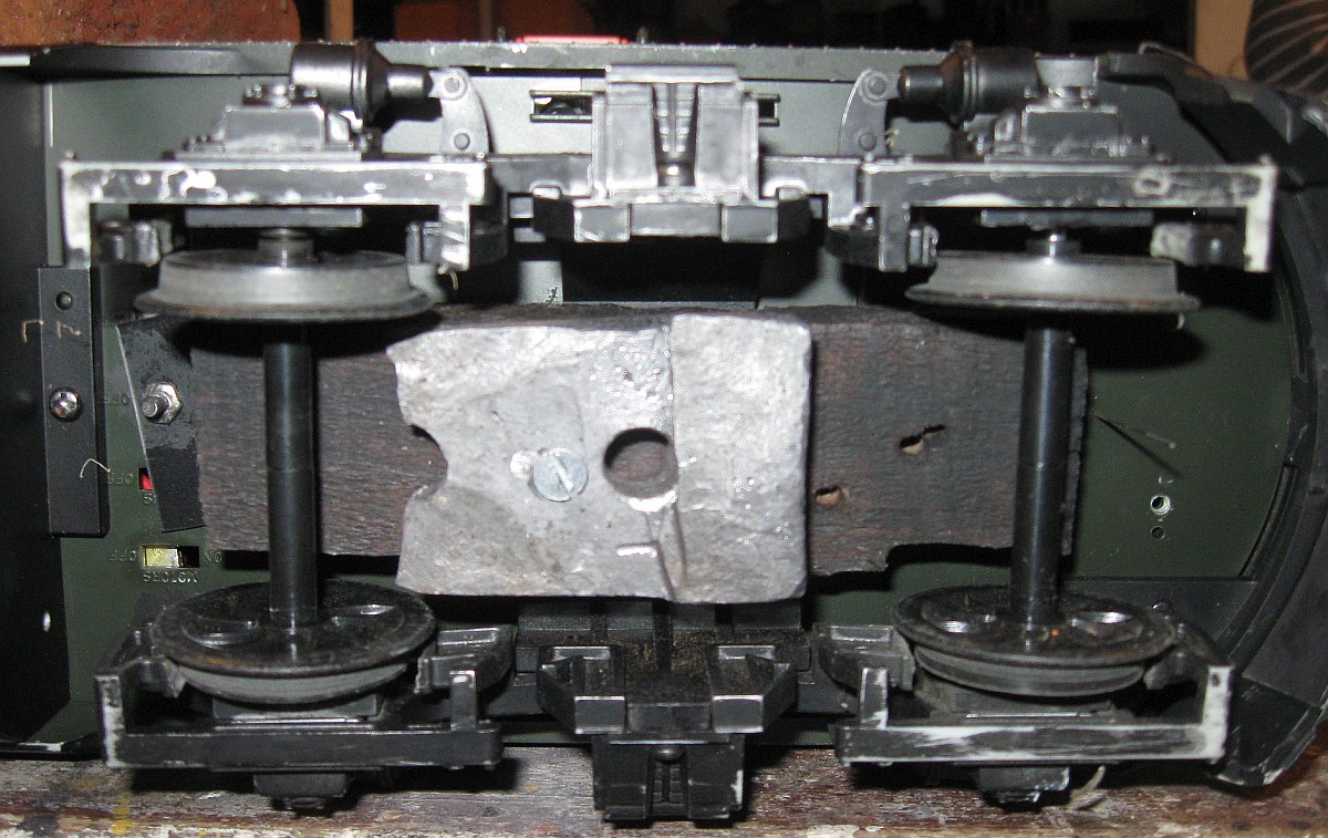

It comes with two motor blocks, but I always consider that an overkill, so I removed the front one (for a future scratchbuild). I kept the side frames and used a piece of wood and some plastic wheels for the front bogie. I also removed the lead weight over the rear, powered bogie as it has rubber tyres and I didn’t want to ever stall the wheels.

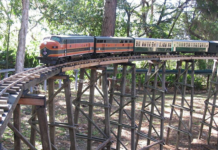

So imagine it is 1953 and the loco is newly delivered to the SaTR.

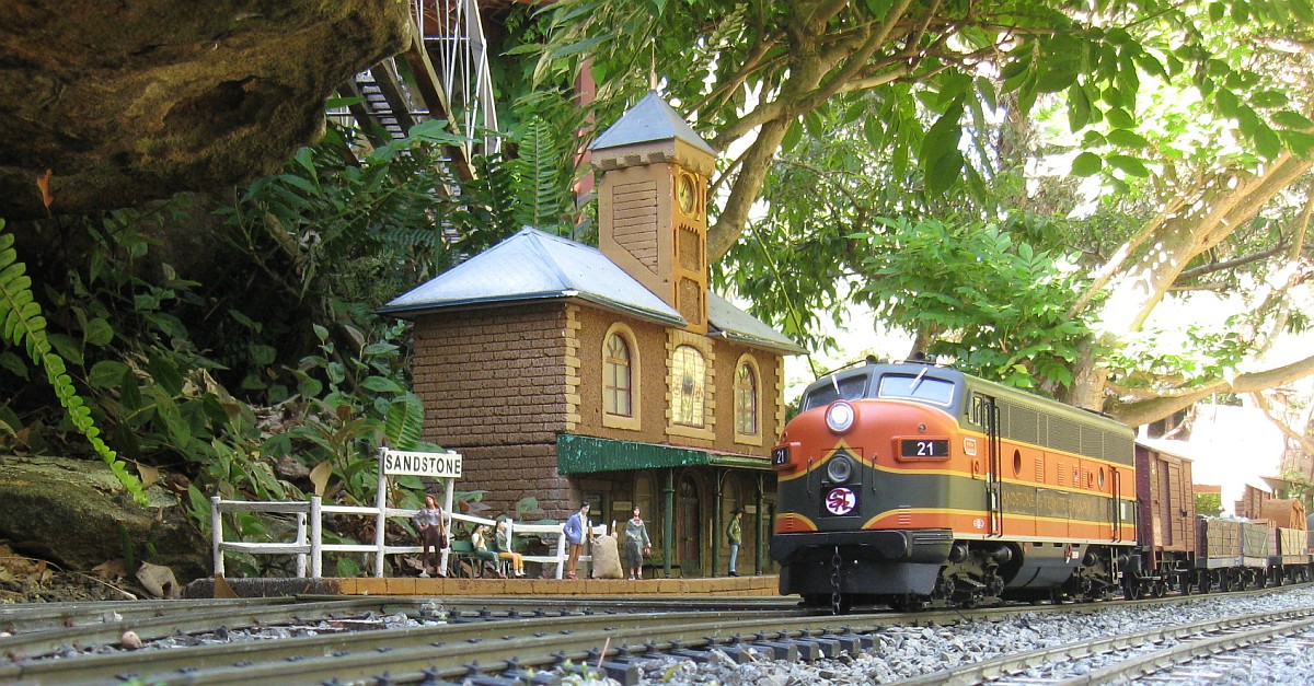

Arriving with a goods train at Sandstone.

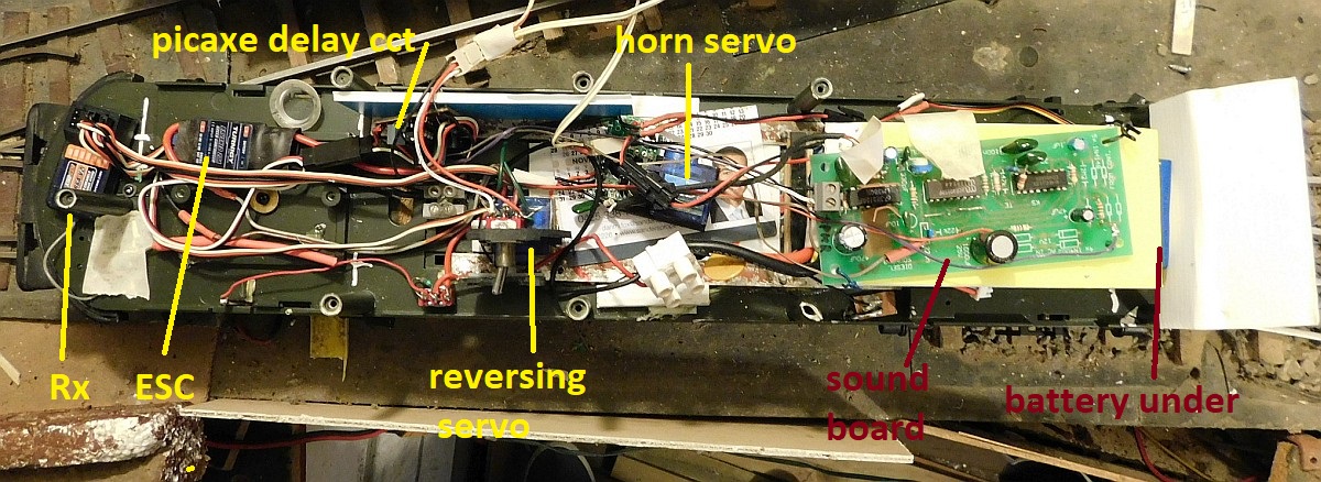

Jut to complete the description, here's a pic of my 'neat' wiring inside. Since there wa so much room, I made no attempt at tidiness.
Greg from downunder.
