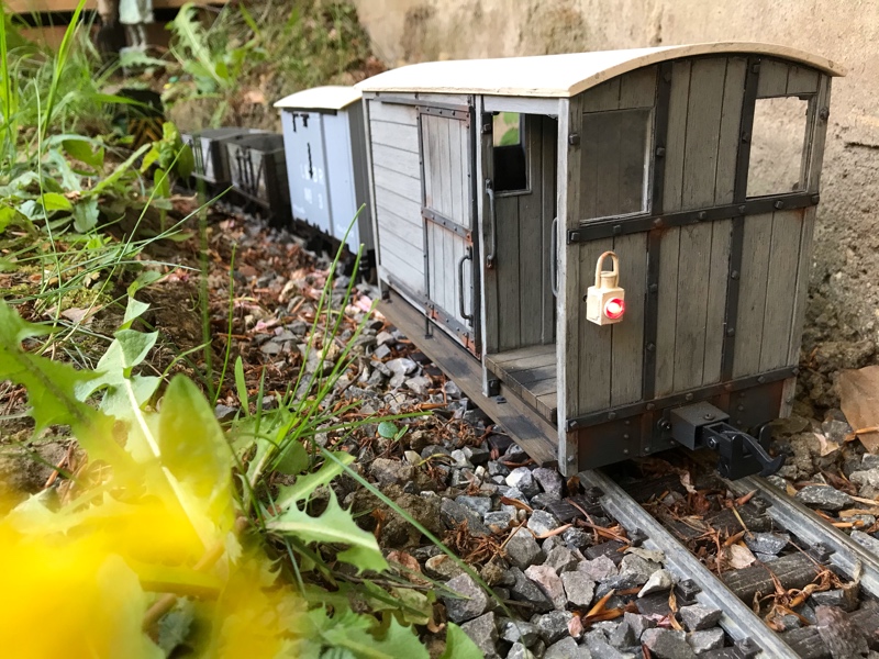

I spent a bit of time yesterday making a working tail lamp for my brake van using a 3v led, on/off switch and 2 AA batteries. It worked fine with some old batteries I had kicking about but they only lasted a couple of hours before they died. When I replaced with some new ones the led immediately went pop, any ideas? Thought a 3v led on 3v should be fine but electrics aren’t my strong point...

Back in business!
