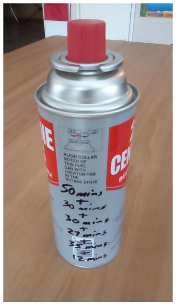

These are the most economical cylinders for me. I got 184 minutes of burner-on time from this cylinder. It's the first time I've recorded how long it lasts.

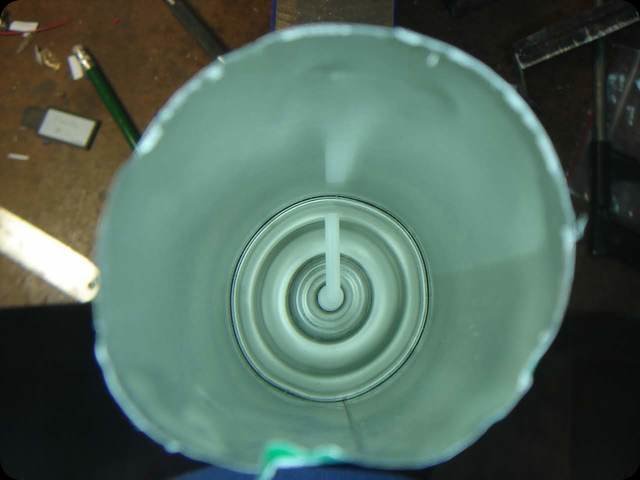

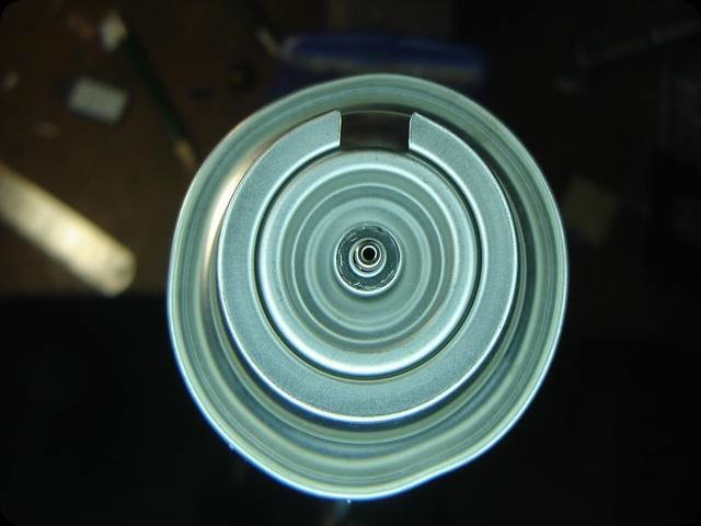

These images are worth seeing again to show the internal arrangement of the 220g can
Best wishes,
Dave

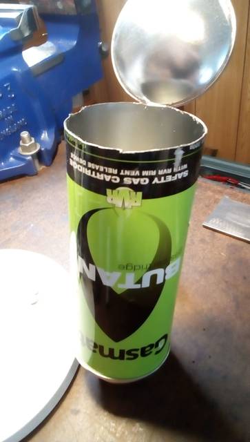

Post by dewintondave » Fri Mar 27, 2020 1:38 am

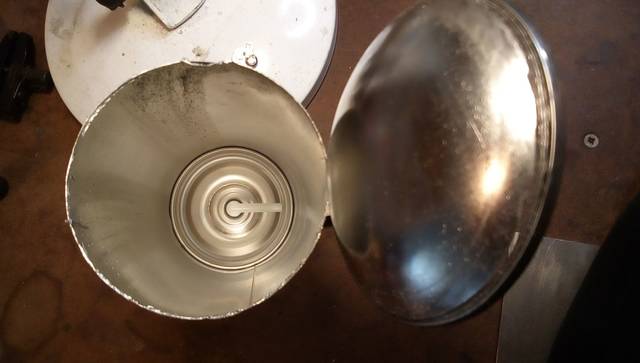

GTB wrote: Tue Jan 28, 2020 12:27 pm
I used a can of Gasmate butane a few years ago and have avoided it since. The only loco gas jet blockage I've had was when using that can, as a brown waxy residue built up on the jet. Somebody else in Oz reported problems with Gasmate butane around that time, so it might have just been a dud batch.
I just cracked open my first Gasmate can, it looks nice and clean inside (sawing debris in pic), no worries with this gas
Best wishes,
Dave

The 220g cylinders are great Jimmy, but you can't get the last bit of liquid out when filling
gas tanks, due to that little internal plastic pipe - these cylinders are designed to be used on their side
Best wishes,
Dave

I have a gas torch that fits on the 220g cans. It's big enough for brazing pipe fittings, etc. and it uses up the last 20g or so of butane left in the can.
ps. I also opened up the Gasmate can that caused the problem when it was empty and it was as clean as a whistle inside. :roll:
