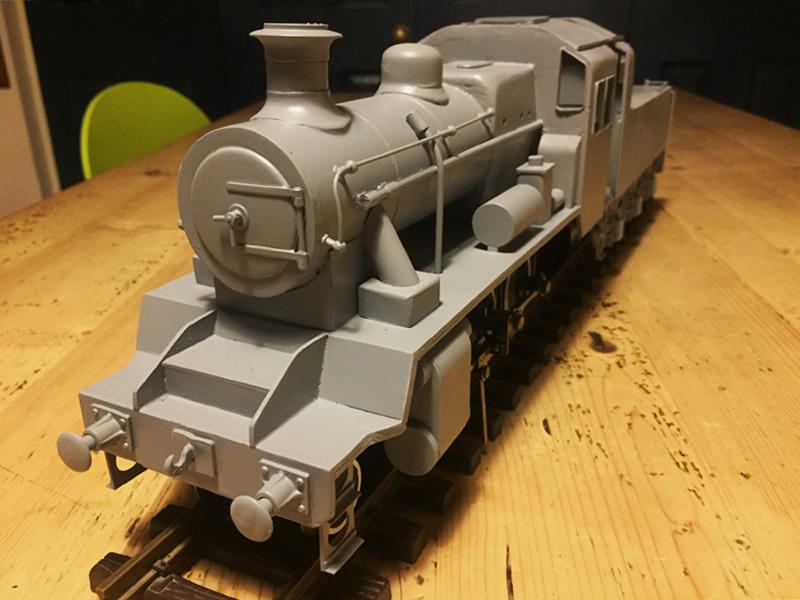

Festive Greetings from a fantasy world of semi-scale, 3’11” gauge British Railways, with a new build based (rather loosely) on the BR 2MT.
It’s a caricature, obviously: wrong gauge, shortened boiler (the wheelbase of the motor block isn’t really long enough – but if it was, it would likely have problems negotiating the curves) and featuring ‘approximated’ (or missing) detail. It still manages to convey something of what I like about the original though, despite the dodgy bits. My central conceit, however, is that these sort of issues aren’t necessarily obvious when they’re trundling round the garden anyway.
It’s mainly plasticard, with a few (narrow gauge and G3) fittings. The chassis is from a broken Bachmann mogul, bought some time ago from the well known auction site. Length is a little under 560 mm (22”) overall. It’s surprisingly heavy, though unfortunately, possibly too much of that weight is the tender. We’ll see. It’s battery powered with Deltang R/C.
Estimated total cost would be approaching £300, I suppose, though spread over the eighteen months or so it took to do it (I was busy): way more expensive than anything I’ve built before (shopping list of motor block, R/C, batteries, white metal components, Piko tender wheels and so on).

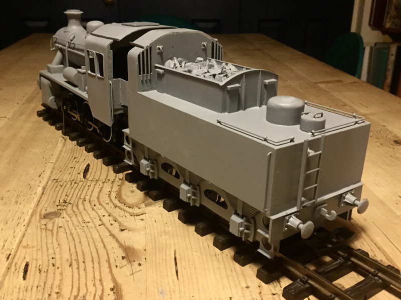

Thank you very much for all the flattering comment. To be honest, I’d feel a bit awkward claiming too much expertise here though: I make all sorts of messy mistakes and miscalculations - I just haven’t posted photographs of the worst of them!
The structure is largely 2mm plasticard sheet (from 4D Models at Aldgate), glued together with Plasticweld - but there’s also plastic tube (including the boiler), strip, angle, rod, mouldings; wire; plastic and white metal fittings (usually not quite the right size) as well as other weights of plasticard sheet.
2mm cab sides with enlarged window cutouts, for example, are glued to an outer 0.5mm plasticard layer which features more precisely scalpel-cut windows. Tender frames were handled similarly. I try to use double thicknesses of 2mm sheet or strip for important joints, or where they need to be sanded to shape (like the corners of the cab roof).
Much of the detail (such as it is) is usually approximated, with the materials available, using photographs as a guide.
It’s been fun (and probably therapeutic) doing it - and generally, I‘m quite pleased with the ‘solid’ and ‘chunky’ appearance of it sat on the track, despite the ‘dodgy bits’. Cheers!

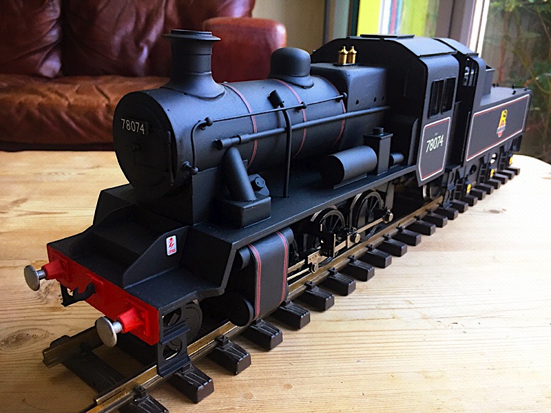

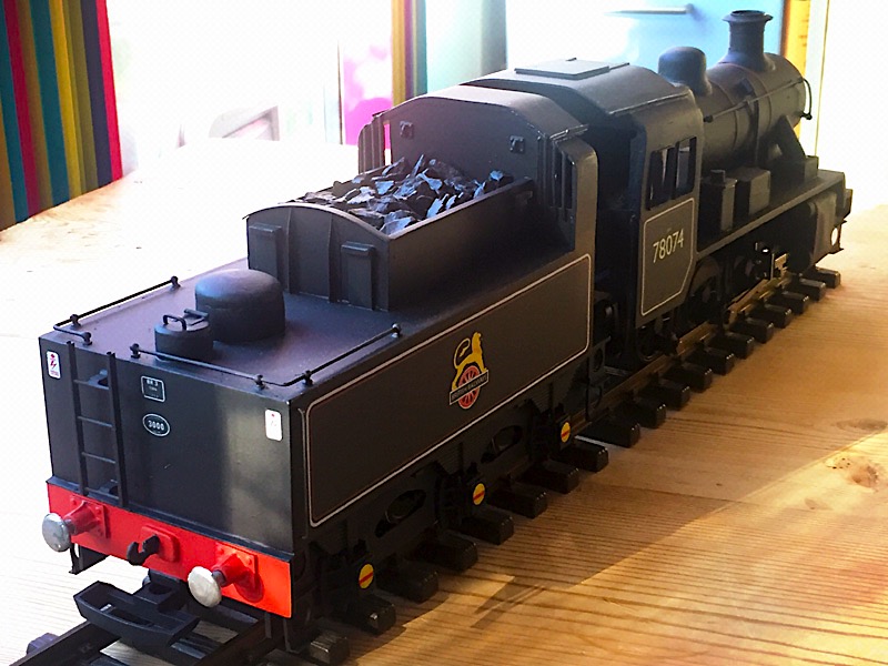

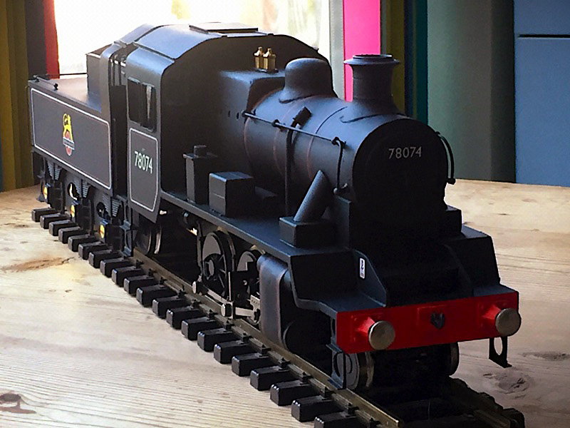

A few weeks later and it now has a couple of coats of Wilko spraycan black and Humbrol varnish.
And at the risk of arguing the bleedin’ obvious, things look different when you paint them another colour. The removal of the US style white band around the wheels, for example, must have overcome some sort of powerful, optical illusion magic, as the wheels now seem much smaller (they are small, of course).
And perversely, it seemed to me that the initial black satin finish, with full-on, lined, mixed traffic finery, actually emphasised the toy-like proportions. The matt finish has sobered it up a bit perhaps.
The lining, numbers and so on were printed on to white, DIY waterslide decal paper from ‘MrDecalPaper.com’ which, I’m pleased to say, seems to deliver more consistently usable results from my cheapo HP inkjet than other papers I’ve tried. Needed a bit of touching up here and there but not much – edges mostly.
I don’t even attempt weathering but want the sort of crisp, simplified finish (and helpful absence of difficult detail) you might see on architects’ or industrial designers’ models. Hope to achieve it one day.
Unfortunately, I then went and knocked it off the coffee table... Repaired now but the right hand side is slightly skew-whiff. It’s not too obvious but I’ll have to make sure it only goes round the garden clockwise.
The Deltang stuff is yet to be installed (I’ve been advised to use a smaller battery, not 14.4v) and the garden’s in a terrible state, needing a load of work and a few trips to the dump, which I’m not up for doing right now. I suppose it might be a while before l actually get to give it a go. Let’s hope it works!
