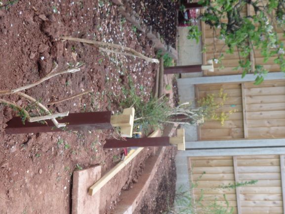

Site of the planned Garden Railway by Gary Smith, on Flickr
This is planned to be the start of my empire - as you can see its probably just about the worst location for a beginner that could be imagined - the ground isn't level there is an impressive slope up from the patio to the shrub at the top end of the garden in the corner. Now phase 1 is planned to be a 'shelf' line initially planned to be cantilevered off of the fence posts for support - the idea is for a station of sorts down near the garage and a balloon loop around the shrub in the corner to return along the fence. With this in mind, Phase 2 actually impacts on Phase 1 (oddly enough) it is planned for a removable bridge section to take the line inside the garage once its clear for an indoor run & to provide a dry workshop area for repairs and maintenance - however as the garage is a complete tip this section will have to come second in theory! :D
So the line will be more or less level, taking a datum line from the planned indoor garage workshop area running along the fence. With the recent weather however I have been concerned about the amount of weight the fence posts will be able to bear and I am now questioning if the line will need support mid-fence panel. So perhaps I should be thinking more of posts in the ground rather than cantilevered off of the fence.

As you have fence posts already in the garden for the fence why not use heavy duty brackets attached to them?
Matloughe
Posts: 19
Joined: Sat May 13, 2017 8:28 am
Location: North Devon
Re: The Start of things to Come!
Post by Matloughe » Sun Aug 18, 2019 8:55 pm
That's what I was planning, heavy duty brackets and using gravel boards as a baseboard for the track & scenery.
I was concerned that it might sag in the middle between fence posts without more support. The better half doesn't mind what I do so long as it doesn't look like a building site or cost the earth.

Hi Gary and welcome, you have some good ideas about the size and style of your railway build but, and there is always a but!..... stay clear of the fence posts.
They are not new from the look of the pictures you posted and if they are party fence panels they might suddenly be replaced by a neighbour, or landlord, without consideration of their dual purpose... i.e, supporting your railway!
Far better to be self supporting and independent of the fence posts with no future concerns.
It might add a little to the initial build cost but will save both money and material in the future if you have to return your garden to its present condition and transfer the railway, and all of its structure, elsewhere.
Also,the idea of the fence panels flexing in strong winds is a concern which could cause considerable damage to your track-work and affect the ability to operate your lightweight stock.

I agree with Peter 100%. Stay well clear of the fence for the reasons he gave. If it's the neighbour's fence they could get proprietorial.
As you're tenure there is uncertain you obviously don't want to invest in heavy earthworks but a raised track on PVC drainpipe posts anchored into small blocks of concrete set into the ground (fill a large ice cream tub with concrete stick drainpipe in and shove it into hole in ground). Join the pipes with guttering , metal cable trays or timber trackbed. Should you move its easy to take down and re-erect elsewhere and the holes can be filled.

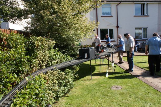

I would agree with Peter about the fence posts. Also in stong winds the posts may move a little ( a 6ft panel catches a lot of wind).
I usualy suggest using plastic downpipe for the posts set in a bit of postcrete with some inside as well
Garden line 2.JPG (59.24 KiB) Viewed 12734 times
but that might mean more disruption when you remove it. So I would suggest using treated round posts like these
https://www.amazon.co.uk/s?k=round+fenc ... _ss_i_8_12
To minimise the number of posts I would use 2x1 treated roofing battens as bearers with shuttering ply on top. I then use the bitumous adhesive to stick felt down
garden line1.JPG (68.69 KiB) Viewed 12734 times
Although it wastes a little ply a slightly curved line will be much more rigid than a dead staight one.
You can use plants in tubs and pots to soften the appearance somewhat.
Don
ps you say you live in North Devon. The Two Moors group covers that area. This was taken at a group meeting at Paul James line
garden line 3.JPG (88.07 KiB) Viewed 12734 times
