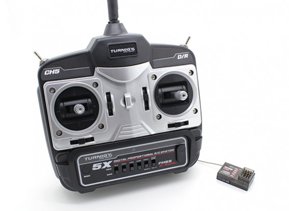

Ok - this is a pic of a similar transmitter to what I have -- I think I use the LH stick for the regulator - so if I want to extend the travel of the servo, which bit do I fiddle with?
Busted Bricks
Re: Trims on Radio Control
You have the dual rate switches on the top/sides of the TX. The reduce/increase travel. The trims are next to the joysticks. All they do is adjust the center position of the servo. If you want to extend travel you need to move the pushrod out one hole in the servo arm (or fit a longer arm).

From the factory my Lady Anne wouldn't allow the regulator to fully shut even with the trim (digital on my Tx) fully adjusted.
Simply resetting the trim to the centre position, undoing the grub screw & ensuring the regulator was fully closed before tightening the grub screw solved the problem at the first attempt & so in your case it sounds as if something else is amiss. The fact that the angle of the linkage won't allow the grub screw to tighten up is wrong & that needs addressing before trying to mask the problem by adjusting the trims. They are really only for fine tuning.
Can you post a picture of the linkage assembly?

Radio controlled regulators on Roundhouse locos not fully shutting off has been a regular occurrence in both the West & East of Scotland 16mm NGM groups. We've had to change a few internal 'O' rings (available from the factory).
Many of the loco manuals (not the Millie one) including the following information -
Part of the problem is that Roundhouse state to fully close the regulator between operating sessions, thus that 'O' ring is going to be compressed all the time. I leave my R/C regulators partly open between operating sessions but I loosen the safety valve/filler plug once pressure has dropped to prevent a vacuum forming.
I recently obtained a pre-owned Millie which has an R/C regulator & been having problems with the regulator not fully shutting off. I found that running the Millie on blocks (do not have an outdoor layout at present) to get the wheels to stop on shutting off the regulator was not accurate enough, and had to adjust it whilst running on track.
Chris Cairns
http://www.roundhouse-eng.com/ss06.htmRoundhouse Engineering wrote:REGULATOR NOT SHUTTING (R/C models)
The steam regulator seating and seal can, after a period of time become worn or compressed so that when the lever on the radio control is fully closed, the locomotive still moves. To overcome this, a trimmer is fitted to the transmitter. This is the small lever at the side of the main control lever and is set at the factory to the top of its slot. As wear takes place in the regulator, it can slowly be moved down the slot to compensate. When it reaches the bottom, it is time to reset it to the top and adjust the linkage between the servo and the regulator in the cab. If adjustment does not cure this problem, the internal '0' ring is probably damaged and requires replacement. Contact the factory for further advice.

Thanks for all your replies - had a steam up at the weekend and managed to adjust the linkage length - the linkage has a screw end at the bottom which in effect tightens it up - this allowed me to put the reg at a closed position and get the grub screw through the hole and re attach the linkage.
Chris - have seen your point above and you are spot on - when the reg is closed the wheels do turn a little on the blocks - but when I place it on the track it holds still - especially when its attached to a heavy coal wagon slomo that it usually pulls around to keep it under control.
